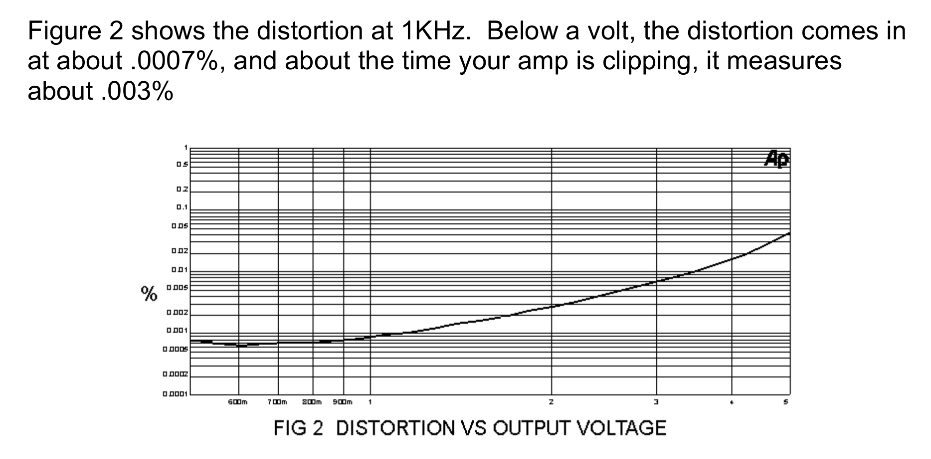

Okay. I see that B1 is a Class A buffer preamplifier. I emphasize that Class A because it is essential here. The design is also such that there is no long feedback. I would expect that the relative distortion would continue decreasing as long as signal voltage keeps decreasing. But what do we see? There is a minimum at 600 mV.
What is this phenomenon?

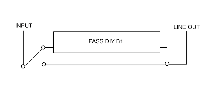

Pardon the crude drawing and the likely idiotic question, but if I want to add a complete circuit bypass switch for the B1 would it be as simple as this?
......bypass switch at the output:
switch between B1 output and bypass line.
Ahh, so instead of placing the switch before the B1, place it after? If so, that's a piece of cake.
Thanks - at the input or both in and out? Would love to just have one switch as a total bypass if possible.
Bypass input and output of B1 buffer.
