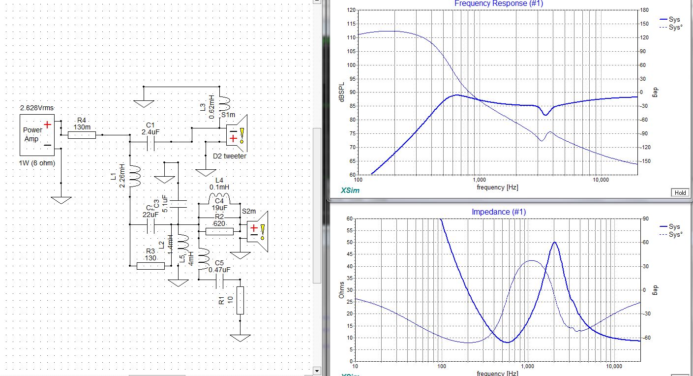

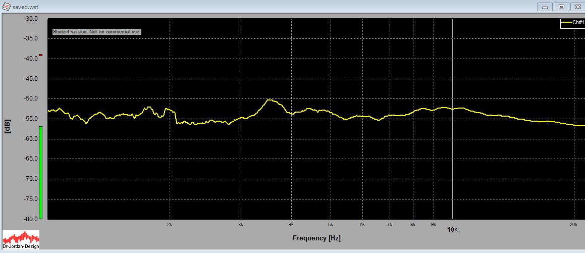

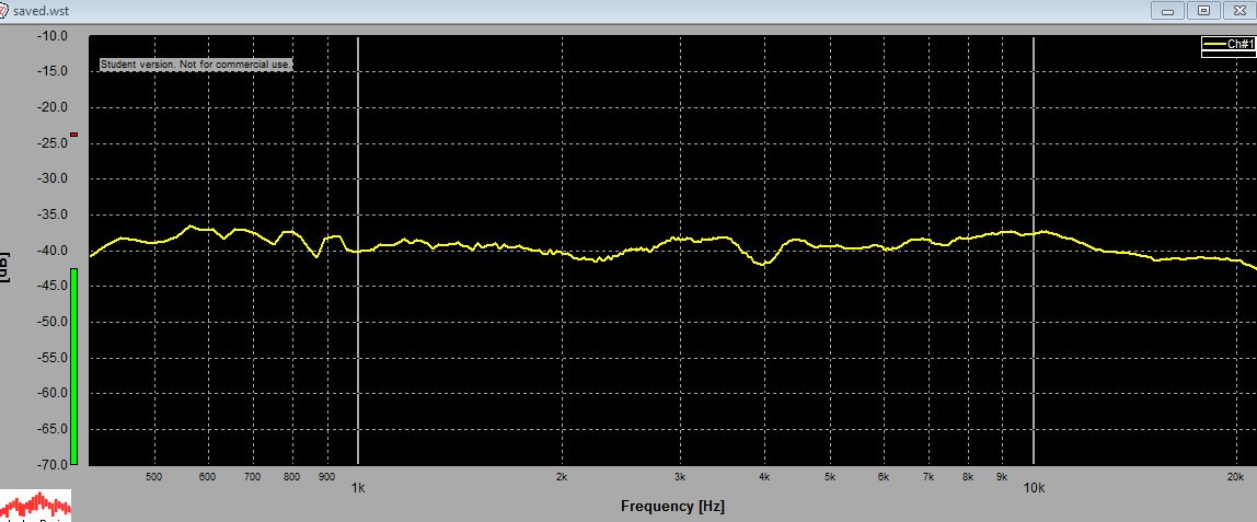

Well, here it is. The filter is now installed at crossover output in the plinth.
(I've only done one channel at this stage)
The bump has now gone but there's now a new suck-out at 4kHz, so there's some fine tuning still needed. On a positive note, the flattest response is now bang on axis and at a very slightly lower angle than before, which is perfect because it's now exactly in line with my ears when seated on the couch.
Actually, the suck-out isn't as serious as I first thought.
At double the measurement distance it's barely noticeable, so I'll mod the other speaker and see if the measurements are similar.

This is actually one of the main reasons I disliked the parallel connected notch that is placed in series with the rest of the passive crossover. As you can see in the graph I posted above, the transfer function of the low pass has a high Q target and results in a hump around 4-5kHz. Adding in the series notch filter affected this hump and it seems like something similar has possibly happened to you, reducing the output around 4-5kHz and producing a small dip in the frequency response.

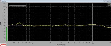

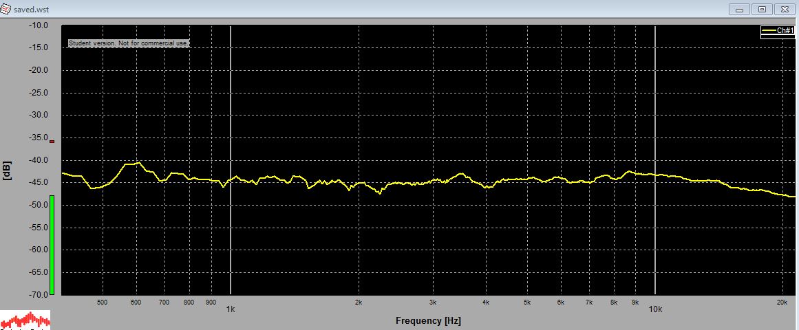

And now the other (right channel) modded
Very similar, thankfully. Now it's time for a listen. 🙂
I am very curious to know what you think about it compared to the original XO.

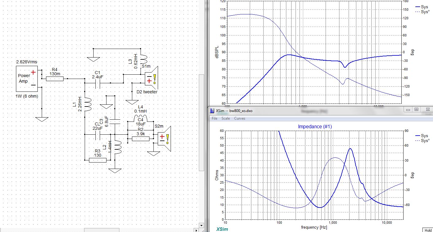

Yeah, the 100% solution is a combined parallel RLC in series with series RLC in shunt, which nicely cancels the asymmetries. When I simulated the networks within the full M-T crossover the parallel RLC network looked the best but I needed to fine tune the mid HPF crossover element cap value (10 > 13.3uF) to remove a peak at 2.8kHz, at the expense of creating a minor dip at 4kHz, and that's exactly what's happened. When time permits I'll play with the notch values to optimise as best I can but it's clearly better than it was before and after a lengthy listening session last night I'm very convinced that the on-axis performance is not only better than before but it's also as close to (subjectively) perfect as I've ever heard from my system. Interestingly, the slight undulations in the mid treble (4 - 7kHz) seem to have disappeared, which is an unexpected bonus. I previously never listened on-axis because the mid > treble transition didn't seem completely correct and overall the balance was a bit hot on top, whereas it's now perfect in every way.

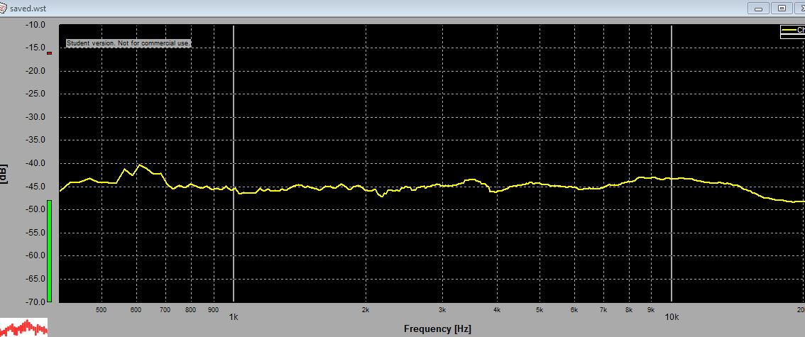

I should add that I've also connected a 5W 68R in shunt with the 44uF Mundorf SIO to reduce the 600Hz bump by 1dB, and I've removed the additional resistors that were in series with the MT input as a temporary fix.
When I'm happy with the values I'll order the Mundorf caps and coils and will install them off the PCB in some free space. (and I'll provide some pics of course)

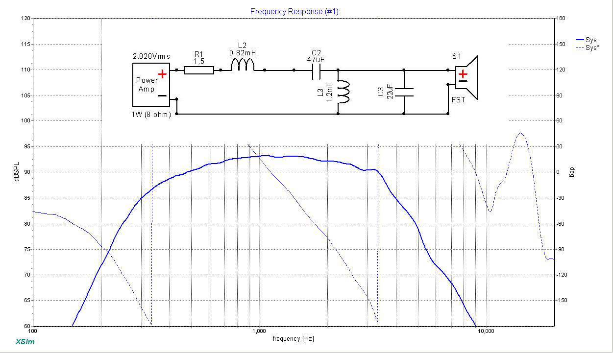

The B&W drive unit in question has a DCR of 3.2 ohms and an Le of 0.18mH which can be used for effective simulation of the low pass function of the FST.
I have attached a ZMA file that one can use to simulate the transfer function for the FST too if they so desire. Attached as a zip to simplify file extension rubbish. If you wish to simulate the high pass behaviour of the driver then you need its resonant behaviour included and if you want to simulate the low pass correctly then you need its inductive rise included.

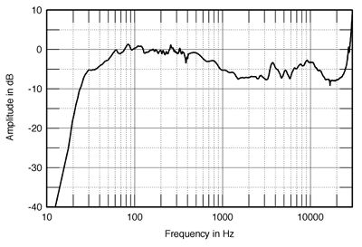

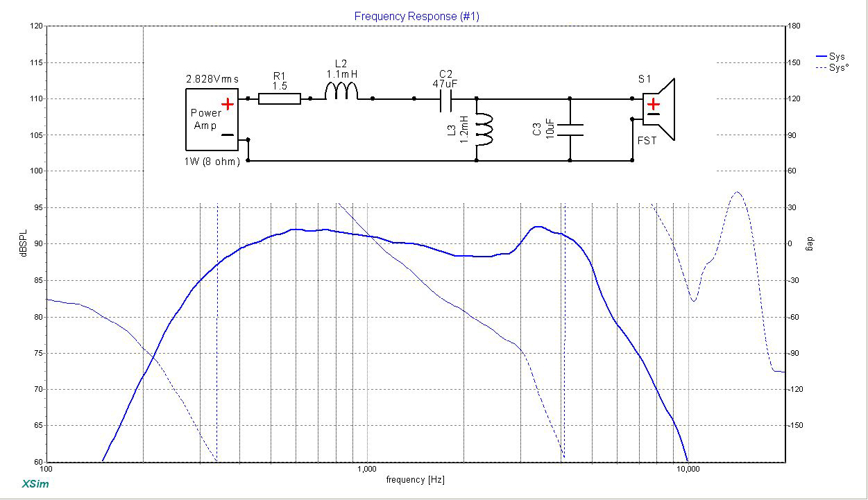

Starting from the Zaph's measurement of FST and with the
5th's zma file, I have come up with an approximation of what
is wrong with B&W's original filter. Namely, as Stereophile's
measurement of anechoic response averaged across 30 degrees
horizontal window with the complex sum of the nearfield response
plotted below 400 Hz in the 3rd photo shows, there is a response
depression caused by the values of original midrange LP filter.
With a little bit of playing around with the values, one ought to
expect something like the modded plot shows.
