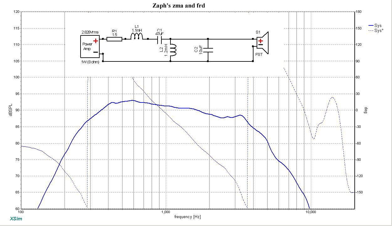

Starting from the Zaph's measurement of FST and with the
5th's zma file, I have come up with an approximation of what
is wrong with B&W's original filter. Namely, as Stereophile's
measurement of anechoic response averaged across 30 degrees
horizontal window with the complex sum of the nearfield response
plotted below 400 Hz in the 3rd photo shows, there is a response
depression caused by the values of original midrange LP filter.
With a little bit of playing around with the values, one ought to
expect something like the modded plot shows.

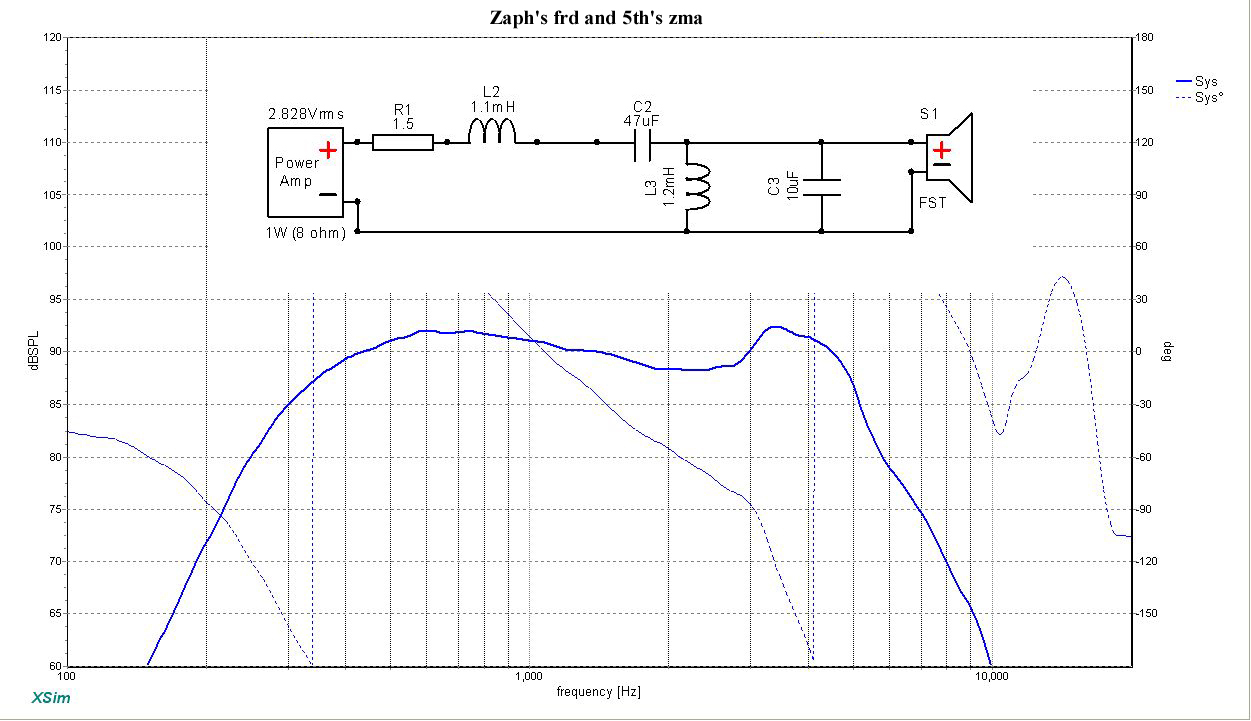

I get the same results using 5th's zma but upon closer inspection there seems to be a disparity between Zaph's impedance plot and the zma file, which shows impedance at 20kHz to be 23 ohms. Zaph's plot indicates 11 ohms and when you use an equivalent curve the crossover response looks quite ok, so there's a better than even chance that 5th's data is incorrect.

I took an existing measurement (Zaph) of the FST midrange, loaded
it to a simulator, applied the baffle step, let the software calculate
the phase and used it in another simulator (Xsim) to try out virtual
XO filters.

Regarding your question on FST 3,5 kHz resonance, it appears
a huge 22uF cap has introduced enough of a change to call it
an improvement over what it was before.
Interesting, I used Zaph's T/S parameters Le to calculate the inductive rise. I do not use passive filters in my loudspeaker so I had no real need for measuring the impedance of my own unit and had to simulate/calculate the impedance I posted. It's possible there's some error in LspCAD or more its that Zaph's Le value is calculated in a different way. I will post another zma when I'm at my PC later on today.
Wouln't it be best precision for modeling in XSim to sweep your real world FST as it sits in box and do it for both left and right.
Right, there is a difference between Zaph's and 5th's zma.
Now it resembles even more to Stereophile's measurement.

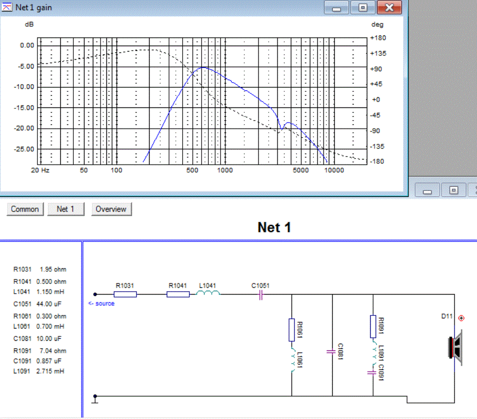

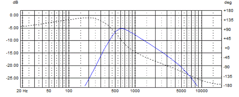

Now onto the updated impedance file. Unsurprisingly this makes quite a difference. I had forgotten that Zaph's measured Le is usually quite different than the actual spec. Le is typically measured at a specific frequency and its possible that Sound Easy does it at a different frequency either way the updated ZMA has been attached.
For completion here is the updated transfer function based on the passive filter provided by B&W.
attachment.php
As can be seen this is far more in line with what you'd expect. The filter first counteracting the slight rising response of the FST and then adding in the required attenuation for the 2nd order 4kHz xover point.
Then here is an updated version of the series connected notch placed in parallel with the drivers terminals.
attachment.php
Its values are more attractive too! A much smaller inductor.
With regards to redesigning the crossover for the loudspeakers, as far as I am concerned the crossover between the bass and midrange is fine and does not need altering, its the xover between the mid and the tweeter that is less than perfect.
If one wanted a different xover to be designed then to do it properly you'd need to make a good set of measurements. The design guide I posted details exactly how to go about doing this. But briefly you'd need the combined response of both tweeter and midrange, then the individual responses for both the tweeter and midrange, properly gated including both magnitude and phase responses. Of course proper impedance measurements for the drivers would be necessary too.
