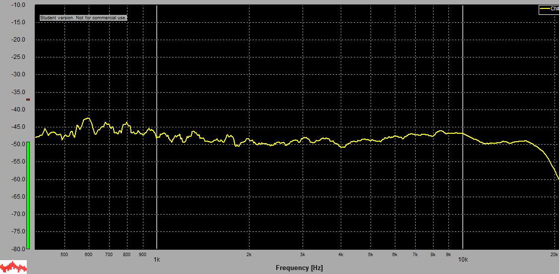

It's even flatter on the listening axis
Fwiw, if there's any difference between before and after it's difficult to detect, but I'm leaning in favour of the original unmodified response.

fwiw, I constructed a RLC network to reduce the slight peak at 3.5kHz, and a 1 ohm series resistance also reduces the slight rise below 1kHz. I haven't listened as yet but will do so this evening.

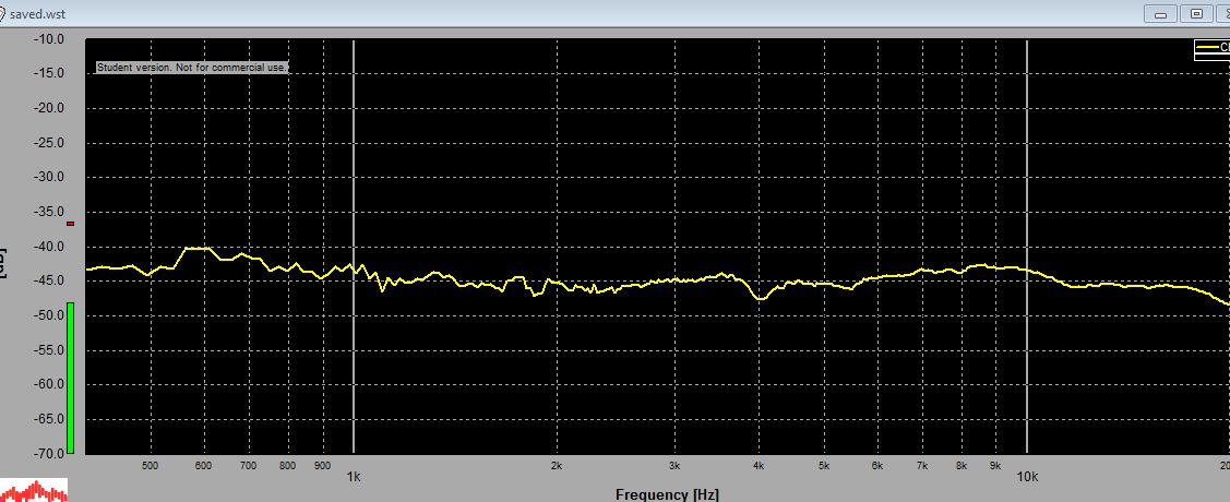

I've fine tuned it a little more, so here's the latest plot.
The difference is very subtle but there's just a tad less vocal presence than before. Note that there's a very gentle saddle in the presence region anyway so the slight peak probably compensates for that.
I could easily live with it either way but I'll listen some more before giving my final verdict.
Note that the network is in series with the M-T input on the rear of the speaker. I haven't gone inside the plinth at this stage.

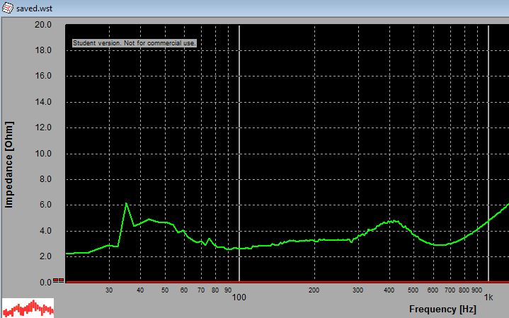

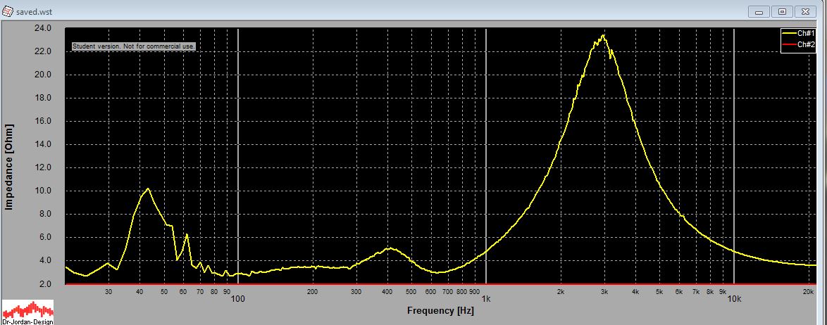

I did an impedance plot several months ago but I'll redo one tomorrow sometime. (earlier plot is attached)
edit. I also constructed an impedance correction network to reduce the ugly phase angle in the bass

Thanks the impedance plot from before the mod was done, unfortunately think the RLC network sits in wrong place because now it is working for both FST and tweeter as a EQ in a preamp would do, it is important it sits after the XO components only for FST midrange. Another helper could be do a frequency response measurement with FST or tweeter phase reversed then if the RLC network is tweaked with right component values the phase canceling slopes will show to be more perfect symmetrical in the canceling slope compared to the nonsymmetrical canceling slope the FST resonance ought to look like.
Don't think the components need to be audiophile grade others it benefits ageing and keeping values precision better under varying temperatures.

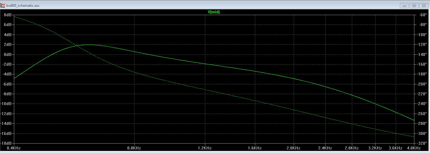

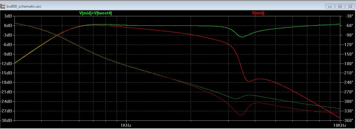

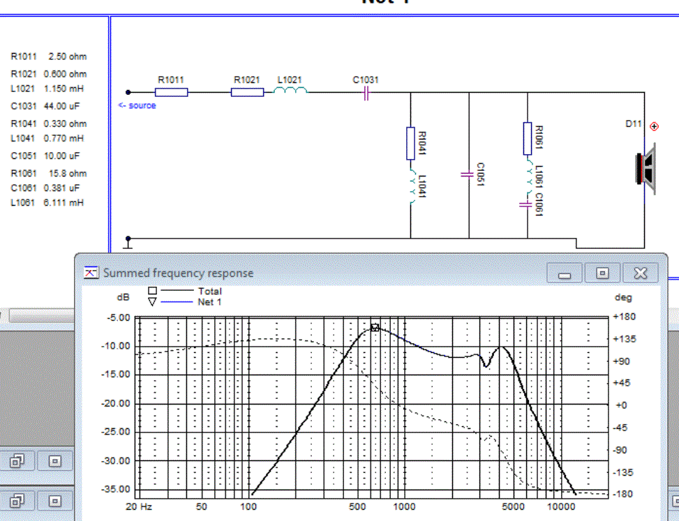

Looking at the FST crossover response (in LTS) it appears to be designed to correct the driver's on-axis response (from Zaph's measurements), but I'm inclined to want to tweak the values so that it's flat at 15 degrees off-axis, which then flattens the power response over a 60 degree window.
I've attached response of the FST with B&W's crossover values, crossing over to a tweeter with a 2nd order L-R filter, and I've also attached the revised crossover with a series notch installed. The best looking Q seems to be achieved with a parallel RLC network; L=0.05mH, C=39uF, R=12. (and assuming that the inductor has a parasitic resistance of 0.1 ohms)

I did a little bit of simulating with this and from my quick playing around with LspCAD the parallel connected notch filter, in series with the driver doesn't appear to be work anywhere near as well as as a series connected filter placed across the drivers terminals. The series connected one has the added advantage that nothing is going to be placed in the signal path, but it does have one caveat, the inductor size required is immense. Now the series resistance of the notch string is very high, so this does mean you could use very thin wire for a high DCR then reduce the size of the resistor.
In this case the notch in question is comprised of R1061, C1061 and L1061.
I vote for a series RLC in parallel with the driver.
You can probably do exactly the same job with either
type of a network, only a parallel one with the driver
seems cheaper. 29 awg Jantzen coil has dcr of 11ohm
and costs a few bucks. Beats the price of a 39uF poly
cap.
