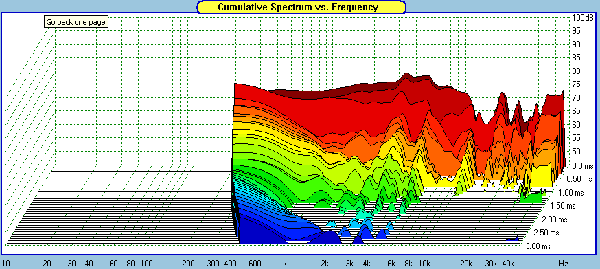

There's nothing really to explain, one has to interpret CSD diagrams and the mechanisms behind what's causing the issues to understand wha'ts going on.
In the case of the 15kHz problem you will first notice that there are twin peaks either side of the very narrow dip indicating that a resonant system, or two, are at work here. The raised output either side of the dip correlates extremely well with what you'd expect to find in the CSD with two pronounced ridges. The resonance however is centred on 15kHz and not the two ridges either side of it and the nature of the resonance itself is that whatever is resonating is doing it in antiphase with the system as a whole and this creates the sharp dip seen at 15kHz. In other words the dome of the tweeter will be producing output where the dip is centered on, but the anti phase resonance within its construction is causing the dip to occur as it interferes destructively with the tweeters nominal output.
Once the excitation of the system stops, ie the impulse response is over and the energy present within the system starts to die away, we see the dip reach a maximum as the resonance and the tweeters primary output presumably start to balance one another more equally, then as the tweeters primary output decays the resonance takes over and can now be seen as a ridge entirely of its own because it isn't being cancelled out by the tweeters nominal output.
There is nothing unusual about this and if you were to measure the tweeters dome output alone and then measure the output of the resonance alone, the CSDs would follow exactly what you'd expect them too, it's just in this case you've got both playing together and they do not add together constructively.
The notch at around 1kHz could be similar, but the trouble here is that the window applied to the impulse response is too short to really be accurate down that low so it could be a limitation of the system coming into play. Certainly the ridge that shows up at 1kHz doesn't look anything like what you'd expect that would account for the shape of the dip centred on 1kHz and neither does it decay in the way you'd expect either. In fact the frequency of the ridge appears to shift all over the place as time goes on, which isn't how resonances behave.

Zaph's own measurements of the FST show the presence of the 3.3kHz resonance. His measurements are done on a large flat baffle so don't obscure the measurement with any diffraction issues. For sure the peak doesn't look so terrible in his measurement because the scale is so large, nevertheless if one looks to the harmonic distortion you see its presence once again as an increase in 2nd, 3rd and 5th order harmonics.
You can see, if you like, the presence of this peak (and its associated decay) in the CSD plot.
Regardless of your opinion on these things it's clear that the peak should be avoided and most certainly filtered out if it is to be present within the transition band of the driver.
My own measurements of the same driver are basically identical to Zaph's so I don't think there's an issue of consistency here.

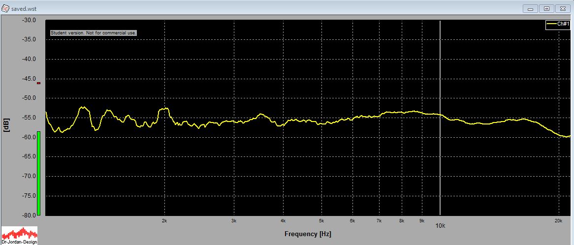

If somebody helps me out I can make some measurements on my unit in my treated room. I have a dedicated microphone with calibration.
We can see if that peak shows up on my sig800 or not. 😱
If you've got a measurement mic then that's as good a start as you need. This should help you get started with taking measurements though.

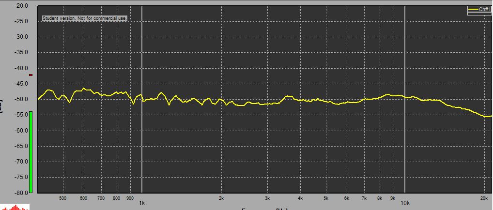

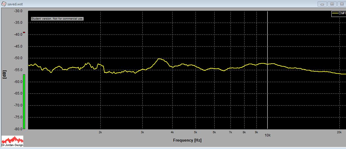

fwiw, I constructed a RLC network to reduce the slight peak at 3.5kHz, and a 1 ohm series resistance also reduces the slight rise below 1kHz. I haven't listened as yet but will do so this evening.
It definitely looks flatter.
