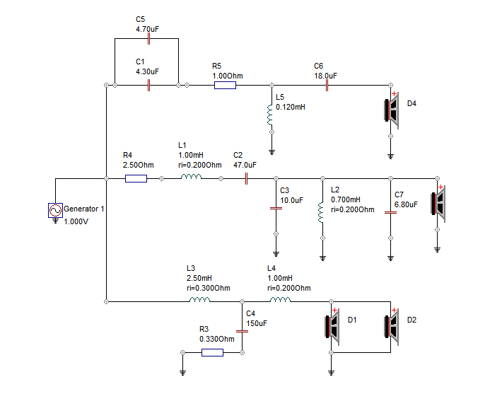

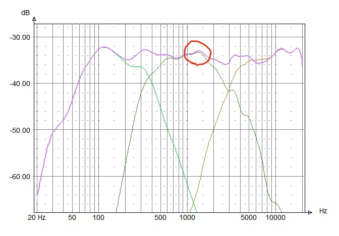

Things improved with 2.order on the tweeter. But maybe 3.order is even better - I have to try it as well.
But before modifying the crossover again I would appreciate any thoughts on Shc’s schematic and in particular if the elevated level around 1500 Hz is a problem. And if so, can this be adjusted easily?
