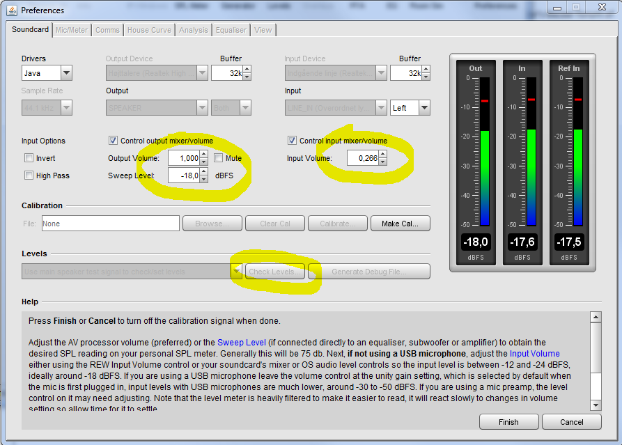

Yes output signal hardwired to input and think to find working level settings its smartest to start up REW go to "Preferences" then "Soundcard" tab and run "Check Levels" as seen below, if it happen you can not control level from there as you see i could then adjust levels into Profire 610 control panel while watching those VU meters in REW. After that run the loop test in APL_TDA and capture window with SnippingTool.exe or use keyboards capture screen button to save the documentation.

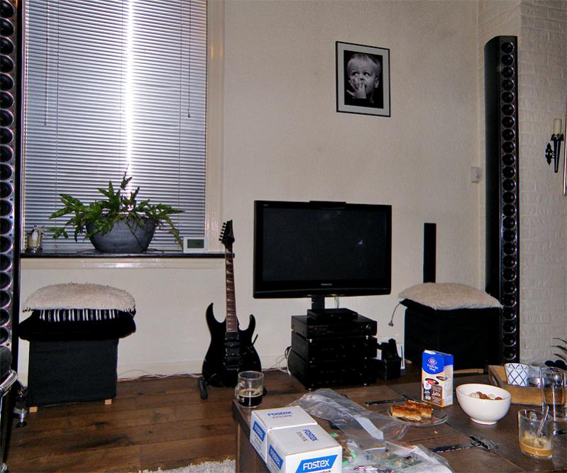

Took this while having my best cup of coffee seen in light of audio interest and the high acoustic quality, maybe seen from outside it looks skinny but fact is membrane area a side reflect as 3x 10 inchers and Mms a side is only 60 gram to move, you probably wont call amp prober compared to your own and that's alright 🙂.
nice wow!!! That's an interesting speaker....very well clean and organized setup!!!
I would be curious to know how the system sounds! and nice guitar
Thanks, I'd be thrown out on the street if it wasn't 😉.

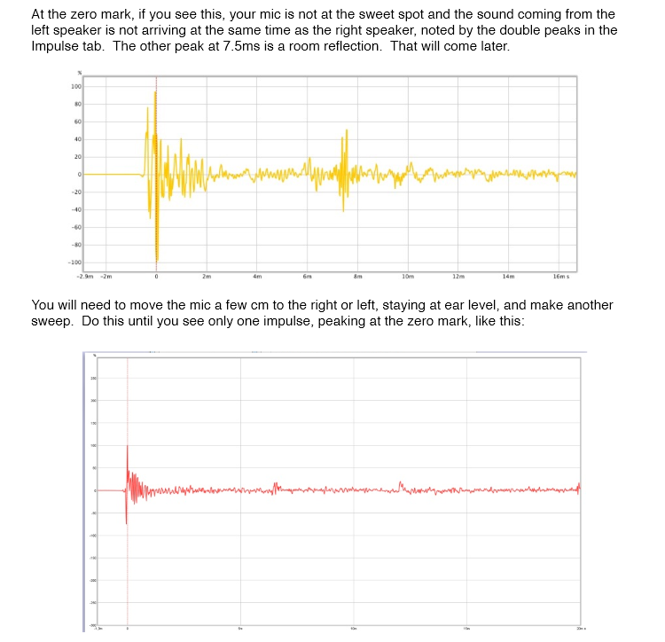

Take it step by step. Run a sweep (with REW) with a single speaker first. Look at the impulse, if the peak is nice and clear to see, run the other side. If both look clear and you have an idea how they each look you can run a stereo sweep. Be sure to watch the SPL levels during the sweep. I always use an SPL meter from RadioShack to calibrate my SPL level within REW at the microphone. This gives me repeatability. One of those handy SPL apps on a phone could do that too though.
Chances are the left and right IR will be recognisable, meaning you can determine which is which in a stereo measurement. That makes aligning the microphone in the exact sweet spot easier.
It (the mic at the listening spot) should be equal distance to each speaker so even a piece of rope can get you very close.
Confirm with the sweep

The more you show, the more we have to analyse together. It doesn't look like Erik will come out and play anyway.
Yes, the idea is to place the mic in the sweet spot over at the listening position. In an ideal world left and right output would be very similar. Similar enough to make the stereo pair sum 6 dB higher. For that to happen, a lot must be right out in the room. The mic being in the right spot is the easiest requirement.
The list I made would be a good start. I'd love to see separate left and right measurements as well as a combined stereo sweep. The stereo sweep, when it sums right at the listening spot (meaning in phase) will have the best graphs, as direct signal to indirect will be higher.
It all depends on what you're willing or wanting to do. Once you know what to look for, you can try and optimise what you have.

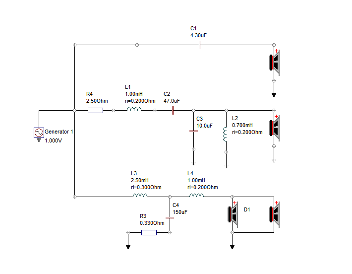

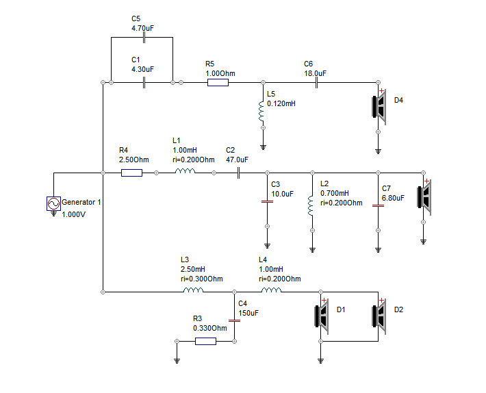

Here are the schematics for the original and modified CM9 crossovers. Tweeter at the top, woofers at the bottom.
The modifications are implemented in a way that permits easy removal. I was originally going to make one concession and solder-in the C5 caps but access to the crossover board is quite awkward when it is in the enclosure. I didn't want to remove the boards so I soldered a couple of big alligator clips to each C5 and clipped it across C1. 😱 Not quite mil standard construction, but they haven't fallen off yet.
The other four components (R5, L5, C6 and C7) are mounted on a small piece of 1/4" ply located inside the midrange chamber. Faston connector tabs are used for the board inputs and flying leads and Faston connectors for the outputs. The existing speaker leads connect to the board and the flying leads to the drivers.
Original: View attachment 494151 Modified: View attachment 494152

Before making significant alterations to the crossover - such as the proposed mod to 3rd order filter I would simply add a 0.5R resistor in series with the tweeter plus also add a 0.68mH in parallel with the tweeter.
This will reduce the tweeter level by about 1dB and reduce the 2kHz dip by 1-2dB.
Changing to a third order, without moving the tweeter for phase alignment will likely alter the vertical lobe significantly in the crossover region.
