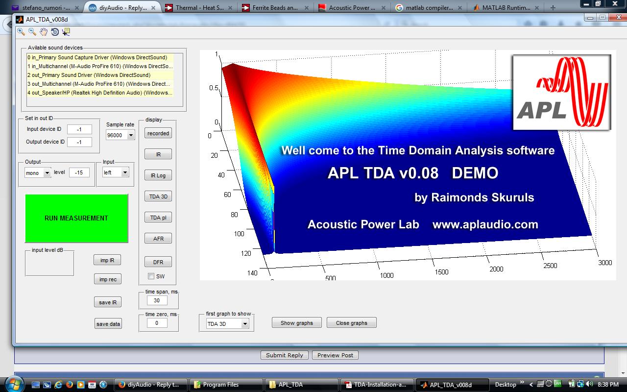

I'm pretty much done with this discussion. I do show you everything, the APL_TDA plot should tell you what you're looking for. Here's another example:

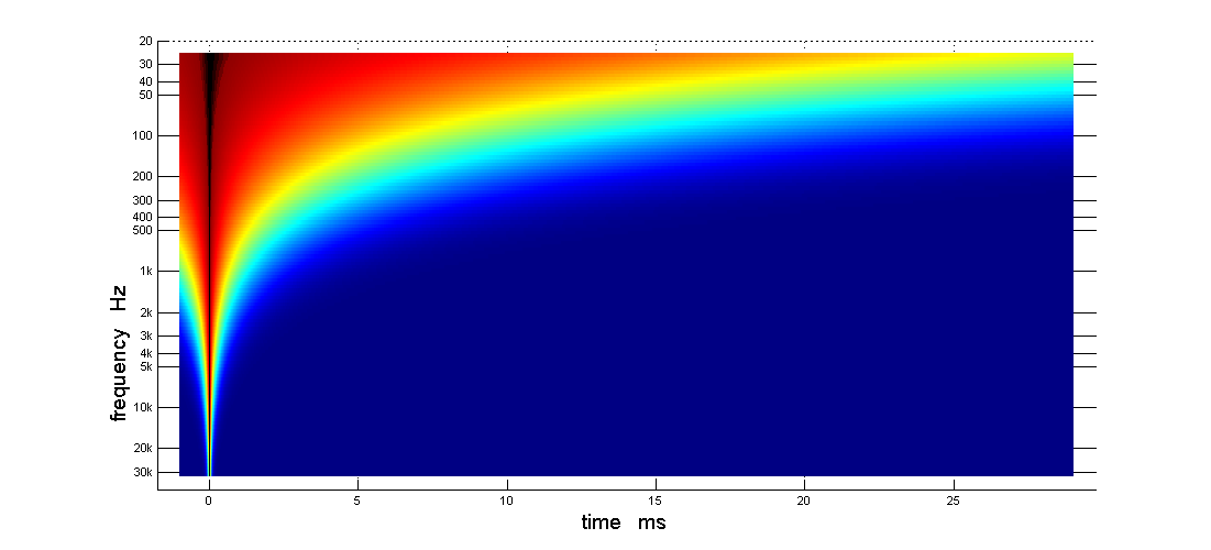

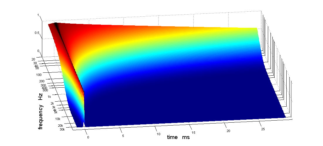

From this page: http://www.diyaudio.com/forums/full-range/242171-making-two-towers-25-driver-full-range-line-array-148.html
My thread is literally filled with this stuff, front to back with numerous measurements and only gradually improving. I did not get there in a day.
Even though this does not tell the whole story, it is a start to show I'm down with reflections, goal is -20 dB in that first 20 ms, at least in this particular graph. The truth is this graph does not show all frequencies that equally, so no, I can't call this reflection free, I call it: down as far as I can get it without getting into trouble. This isn't DSP, this is room treatment + speaker choice and placement.
As said, I loosely follow the LEDE concept from which the RFZ theory originates. Why? Because I like a good listening experience. I'm not mixing, I'm enjoying music. So I add reflections as a Haas kicker, look up the concept, it used to be a big hit, until the studio guys found out it can make songs sound a bit too good. Not that bad in my book for a listening room as it give me a chance to "forget" I'm actually in a small room. It helps hide my real room. And it enhances the listening experience by making it more "3D". There's theory behind that too, it's in my thread. I didn't make it up, but thankfully use it.
So with the added reflections I can control at will in content, SPL level and band pass:
The Haas kicker is coming in from a lateral angle, diffused (as planned) at 20 ms. That's mimicking a bigger room than I have. Does it mess up the image? No, not at all! Not if it's diffused enough. So what does it do? It enhances the music coming from the front, you'd never know there are speakers there. They can't even be seen as they don't point at the listening space, they reflect off of the sides/back of surrounding furniture.
Looking why I cannot call it reflection free? If you look close enough there is still output above 15 dB.
A wavelet looking 10 dB down:
Not a reflection in sight, nor any crossover shapes or resonances.
15 dB down wavelet:
So what do you know, the filtered IR looks like everything is down by 20 dB. Yet there is still some stuff showing up when I show a 15 dB floor in my Wavelet. Even more important, sometimes it's just a little different, could it be that I am in a fully functional living room? Not in a Studio? With an office chair that I'm sitting on right now not always in the exact same spot?
Can you guess where that stuff is in my APL_TDA plot?
I know what it is I'm seeing, that's even more useful.
So why would anyone chase down all those reflections? Because they mess up your step response, no matter how much DSP you throw at it. So if you want a shot at decent output, with or without help from DSP, take care of those first reflections. Don't name it a reflection free zone until you reach levels like jim1961 gets. Reflection 'reduced' would be a good term in a living room. These reflections give away speaker position and room size to our ears. That's the last thing I want. I want to be at the performance.
Look at this impulse, this one actually is with DSP applied:
Still a lot of reflections in there (not good! Early days of measurements)
By no means are you going to fix that with DSP without serious consequences. The minute you get out of the sweet spot only a little after hammering something like that into shape you will get a way different response.
Look at my later impulse:
Does this look the same to anyone? This is with carefully placed damping panels. Weird looking STEP? That's what a downwards curve frequency response looks like when its following minimum phase band pass behaviour.

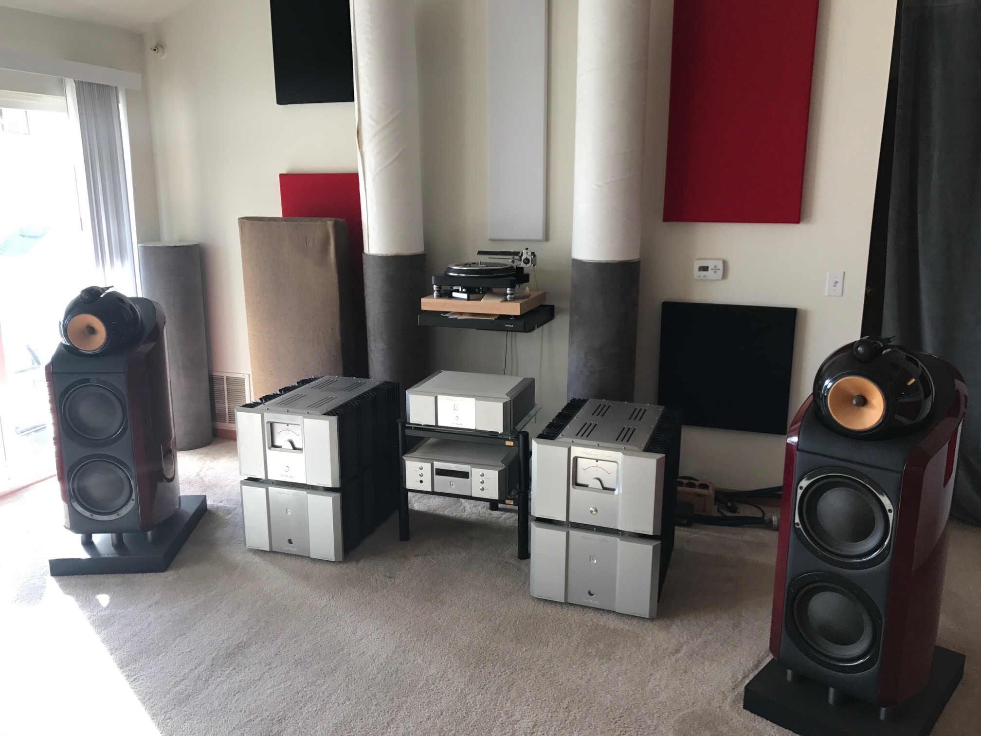

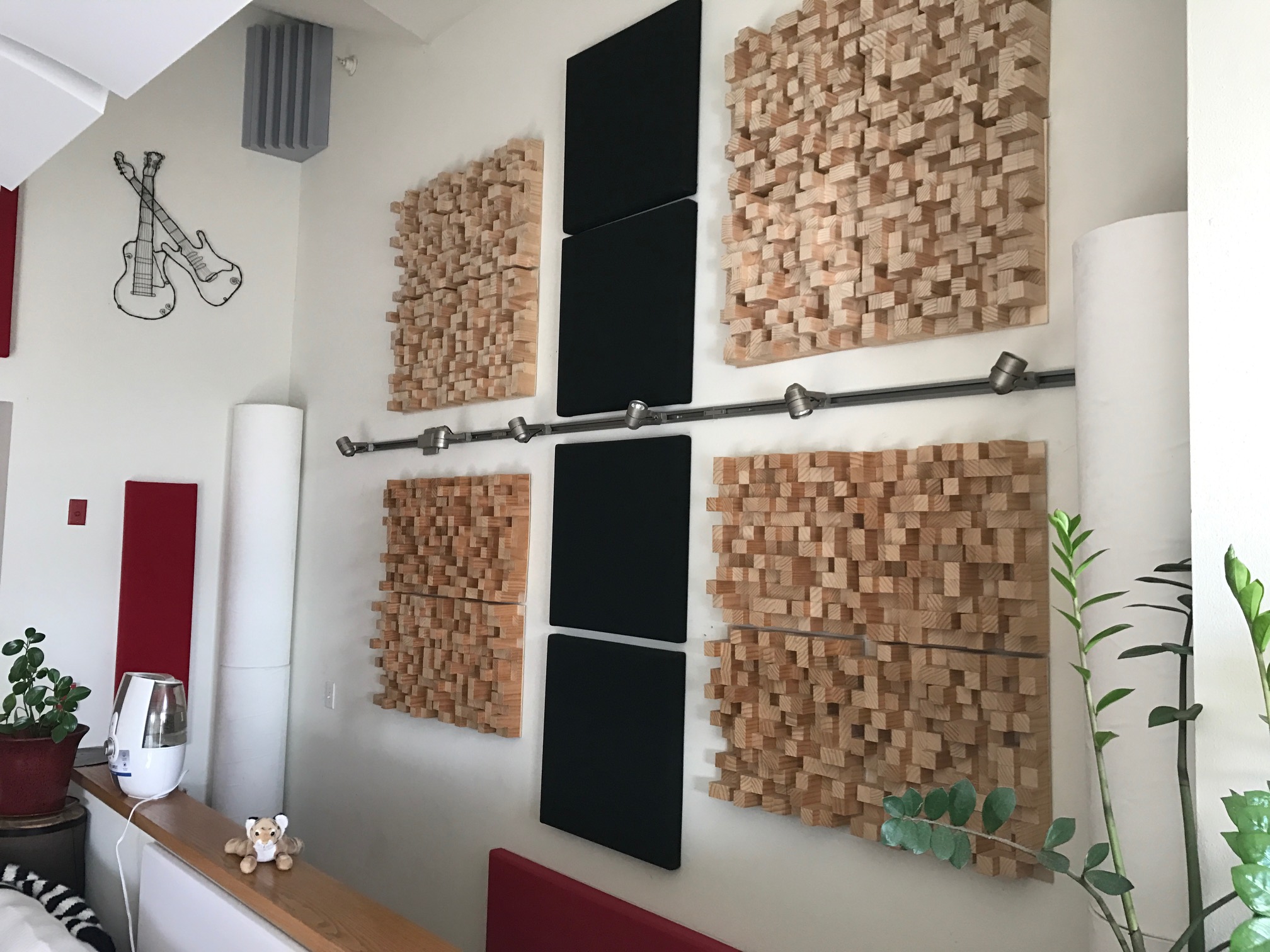

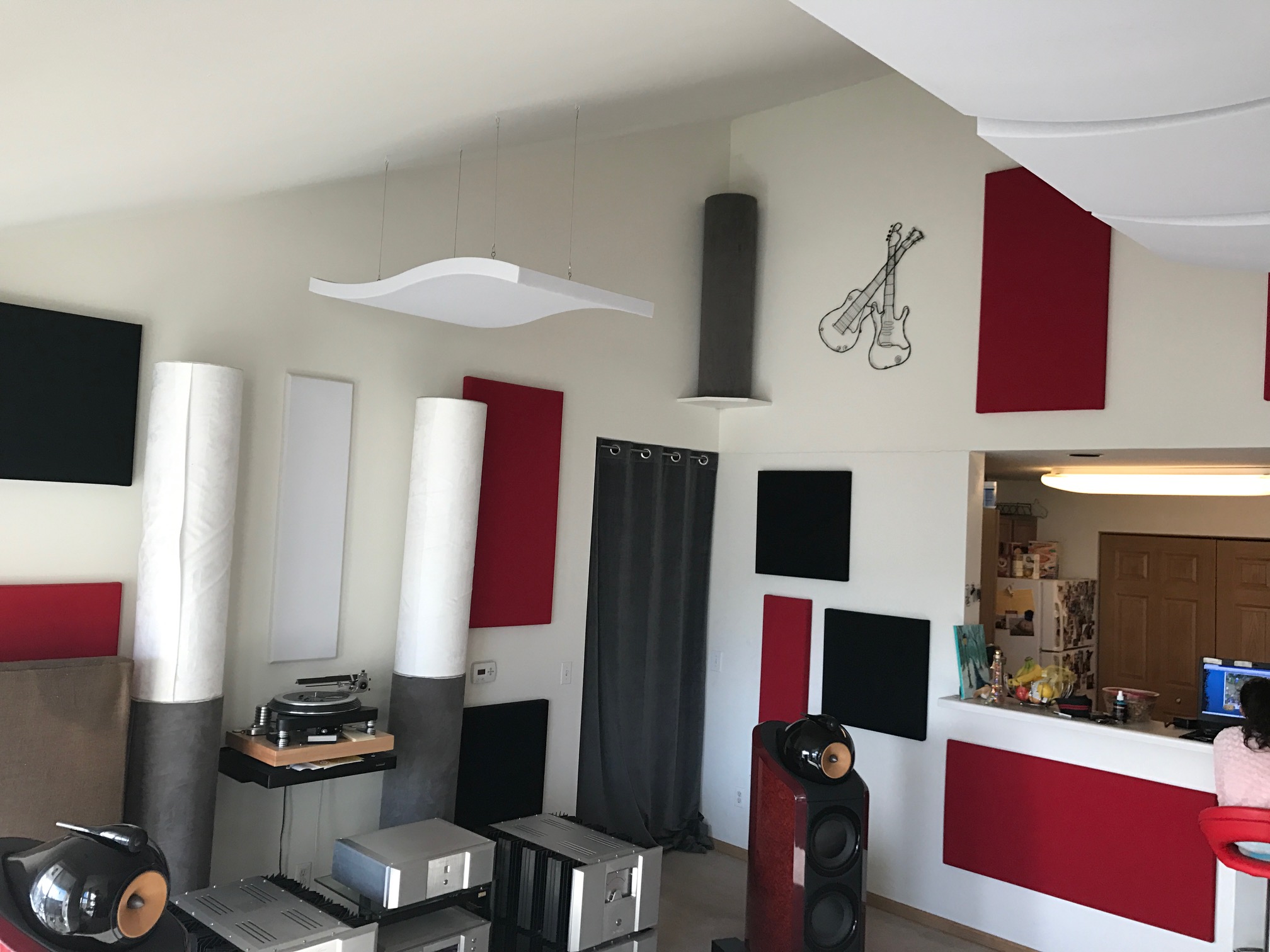

Pictures of my setup, still not completed I am still working on the center product, but it gives an idea of what my room treatment looks like.
This is far from ideal of course, and I hope to make improvements with the help of experienced people here, but I think it is a good start.
