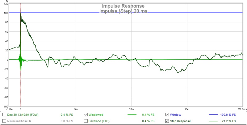

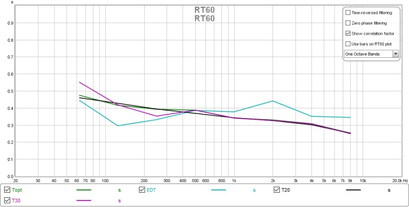

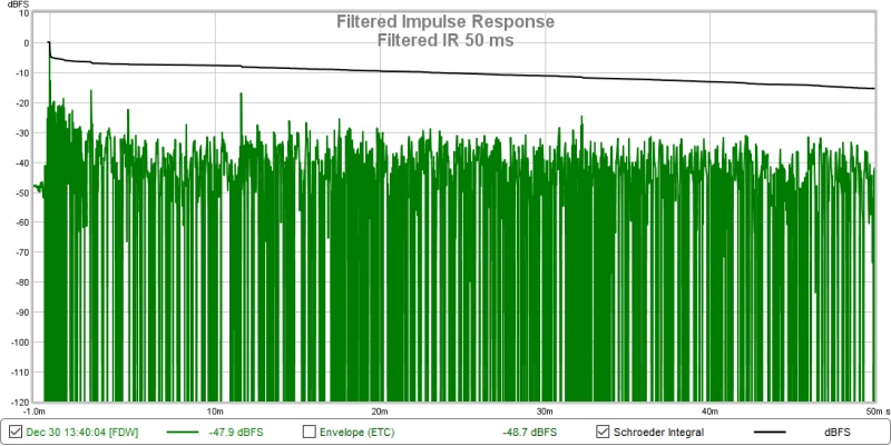

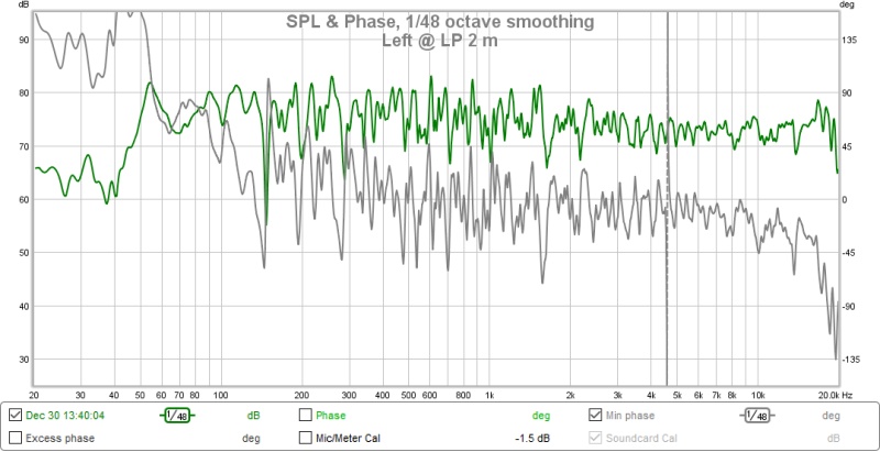

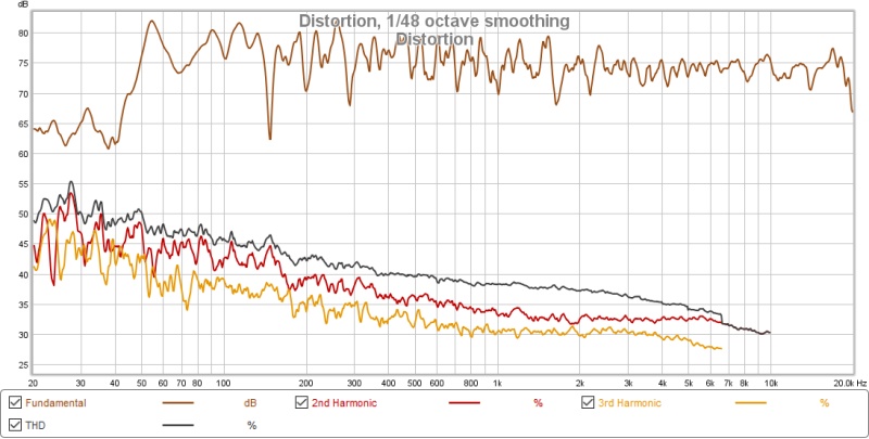

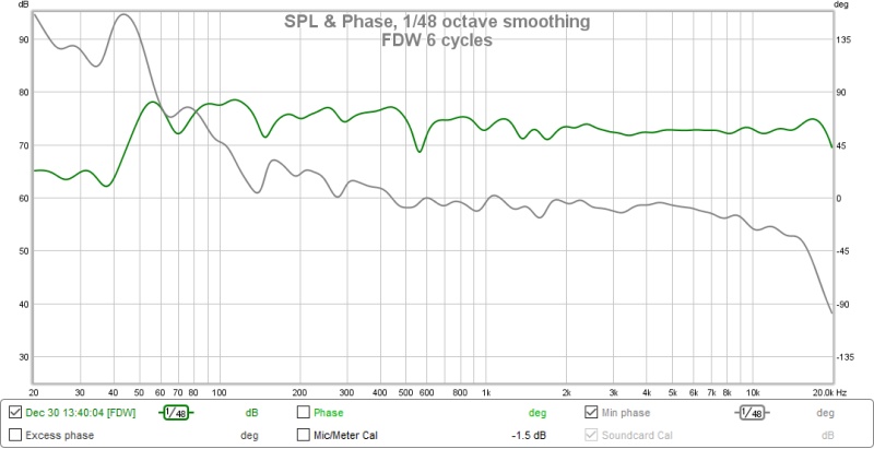

Hi Stefano, any and every measurement can help us all learn. I hope you can get APL_TDA to run using the above post by BYRTT. If you were to run REW some things would be fun to see, regarding speaker and room integration.
Measurement taken with microphone at the listening position.
- a FR plot showing phase 1/48 oct smoothing if needed.
- The same FR plot but this time with a frequency dependent window of 6 cycles, no smoothing.
- Distortion plot showing the complete 20-20K range.
- an IR, normalised to 100% and set up in %FS in upper left corner. 0 to 20 ms scale visible on bottom -100% to +120% on left side
- Filtered IR (one tab further) set upper left to "dB FS", the first 50 ms being of interest (bottom scale).
- an early waterfall plot, showing the first wave front that hits our ears. Set it to these variables:
- RT60 data
The above, together with an APL_TDA plot shows us a lot of data how the speaker interacts with the room, but also shows us useful data of that first wave hitting our ears. An additional wavelet in REW is interesting, but APL_TDA tells us so much more.
The mentioned plots would be the first thing I look at. But I do look at many more little details. This gives a good overall first impression of the speaker and it's room integration.
This is the data I would hope everyone would post. Just as a learning opportunity for us all. I promise I will not be rude or harsh in comments in any way to what I see. We might help each other get to a better sound here.
I really appreciate you're willing to do this. As said, we can all learn something here. We should all share info like this to get ahead and move forward.
I noticed Erik was still stuck on repeat. 😱 I do hope if you post this data, he will do the same on his end. It might just end the bickering 🙂.

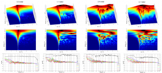

Byrtt,
thank you very much for your detailed post. Let me ask you:
what is the advantage of using this SW instead of REW?
REW is a proven free tool that doesn't require many other SW to be installed and it's widely used around the net and I am sure it can do all the basic measurements required to analyze room interaction.
Will this other tool offer a different set of measurements the other doesn't?

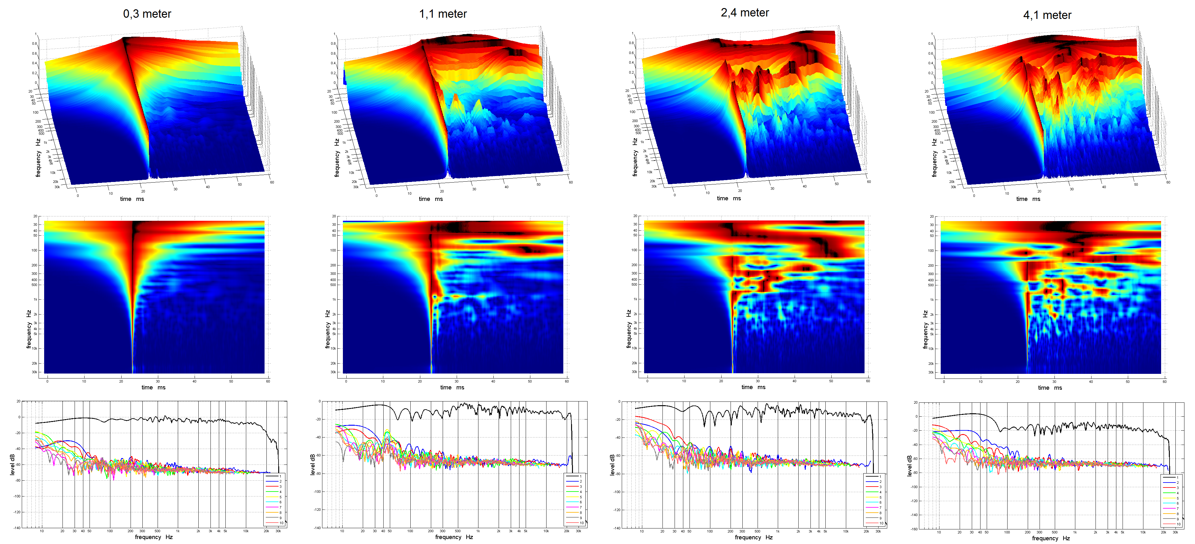

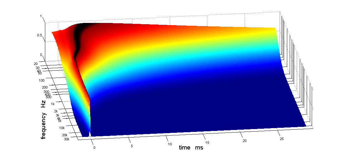

Look at these two plots,
- RT60 data
And:
While looking similar, their function is not the same. Nor is the amount of info you can extract from it. Both have their own purpose to give information to it's user. I use both for different reasons. If I had to choose? It would be APL_TDA.
The Demo only requires one extra piece of software installed beside it's own installation. The other (third) file is a pdf. Even REW uses something else, it does use Java.
If you really want to see if all the hard work done to the room paid off, APL_TDA can tell you a lot. Pretty much the same info can be gained from REW, but it takes a lot of interpretation and shuffling trough tabs. Here you get a visual representation of that interpreted data. None of REW's outputs can give it to you this clear.
ok you convinced me and thanks for your explanation. I will install the APL_TDA tool today.
What is the difference between free and license version and how much is the license version cost?
P.S. since I don't have your knowledge on acoustic aspect, the second plot really doesn't tell me much as opposed to the standard waterfall plot, but I know you know exactly what you are talking about and therefore I just trust your judgment!
REW measurements as per Ronald's
Sorry if not appropriate for this thread (moderator pls remove if needed) but since I have a fresh measurements I am posting them, following Ronald's parameters (4way: 2xSS21W8555 sub sealed/ 2x12 MCM 55-2982 OB upper bass/ Faital 6HX150 coax sealed mid/high; sub>upperbass 80Hz DCX; upperbass>mid 250 Hz DCX; mid>high 1K7 passive; all LR4 acoustic slopes)
Stefanoo,
Here is your target curve before room acoustics set in 🙂
Data is set as BW2 band-pass 32Hz-28kHz with IRR XO LR4 350Hz and LR2 4kHz.
Stefanoo,
that's the ideal response...if you have that you live in a surreal world...
But isn't what you are plotting a waterfall graph that can be plot with any other SW including REW or is there something special about how the other tool plots it?
Tonight I am installing the SW on my laptop as per your instructions.
Can someone tell me the difference between free and license edition and how much the license for the program costs and if it is necessary?
