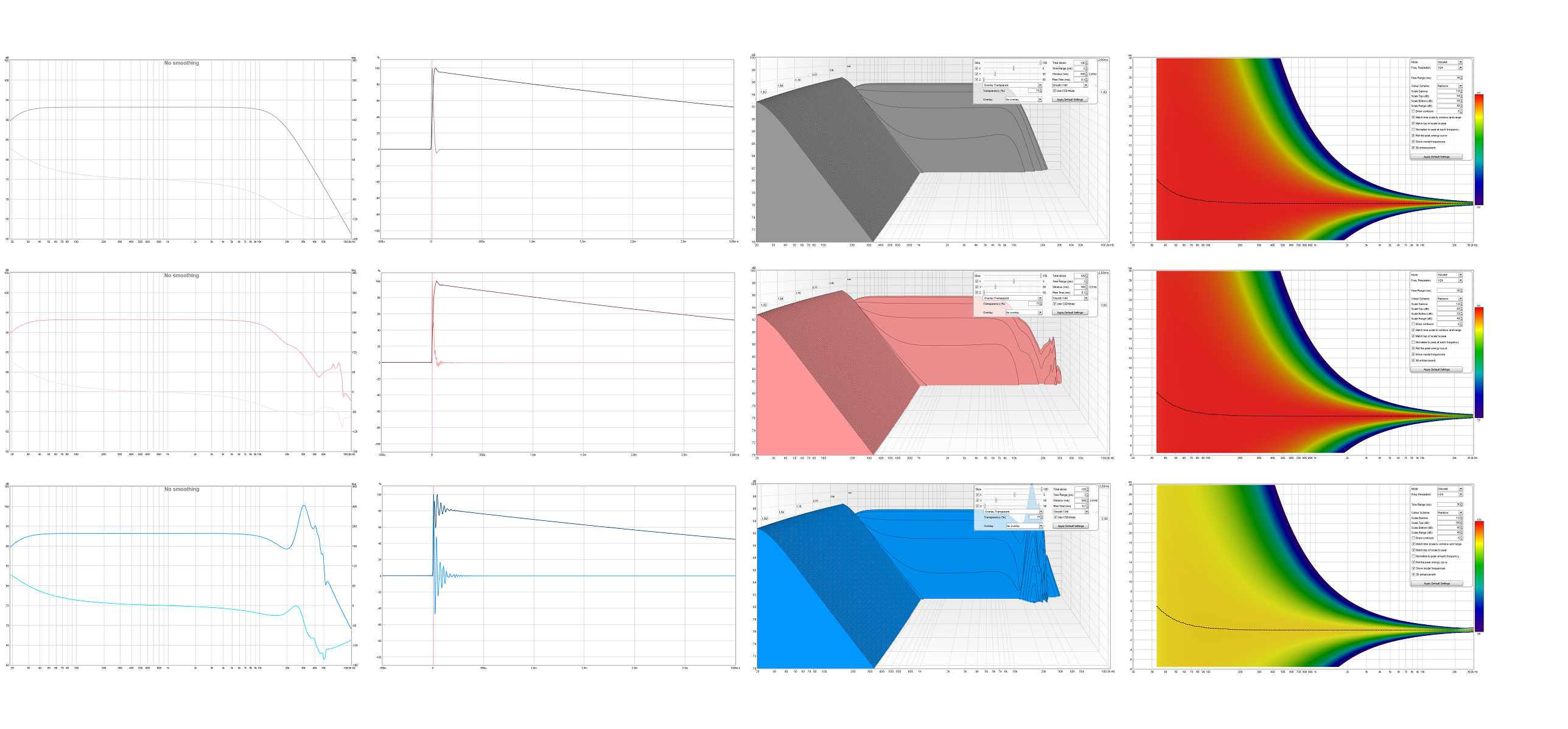

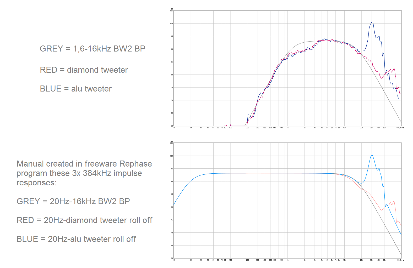

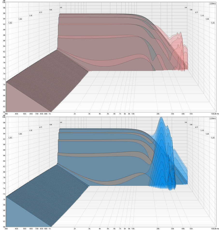

Some simulated visuals based on the raw tweeter measurements Art Vandelay shared into post 591, system band-passes is minimum phase domain based but real XO points is omitted because i don't know the exact data and if added will make a huge difference to time domain seen in waterfall and wavelet.
First picture show the creation of replica roll off impulse responses in Rephase program, second picture show their performance and third picture waterfall plot diamond and alu verse a perfect impulse 20Hz-16kHz BW2 bandpass.
