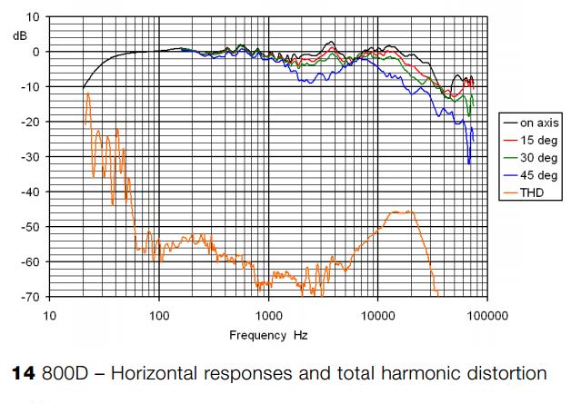

This is from the 800D development paper.
Distortion is quite low to below 100Hz (<0.5%) but rises steeply below 70Hz. (-40dB = 1% THD.)
Art,
Thank you for linking to the development paper and the FR. At the best listening angle, +/- 4 dB, that is just not up to modern standards. Some components seem to be very nice, especially the tweeter. I would love to put it on the bench. The yellow thing in the middle was a bad idea from the beginning. The ripples in the FR in the mid region are caused by something! Most likely diffraction though. A ball is optimum according to Olson and it is, but not just any ball. It has to have a certain minimum size to work. B&W's balls are too small. The huge dip of the blue line at 45 degrees shows that the alleged flexible size of the midrange moving diaphragm, smaller at higher frequencies, just doesn't work. It behaves like any over sized midrange does. The power response of this speaker is ragged, but the dip around 2-3kHz may be appreciated by some.
Distortion above 60 dBis commendable though. But it doesn't specify at which SPL. Many speakers can do this at 80 dB @ 1 meter or so.

Vac, Re distortion, from my own testing I can confirm that it's likely correct for 1 watt / 1m. The Kevlar FST is a very low distortion mid driver.
Re FR, B&W optimise their floorstanders for normal far field listening so the end result is better than near field measurements suggest. Using Dirac software and my Earthworks mic, the response averaged over the 2m length of the sofa (prior to crossover mods) was essentially flat apart from a dip at 2-3kHz, and of course some expected room boundary gain in the bass.

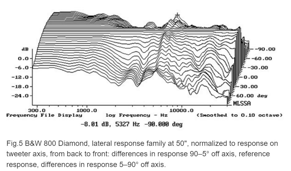

The dip in the presence region isn't just a function of FST beaming though. See the attached lateral response measurements of the 800 diamond Vs the older Nautilus 801. Both speakers use the same sized FST mid and the FST low pass filter network is identical. Both tweeters are crossed over at 4kHz. The only change is the electrical HP feeding the tweeter, and the additional 90 degrees of mechanical alignment.

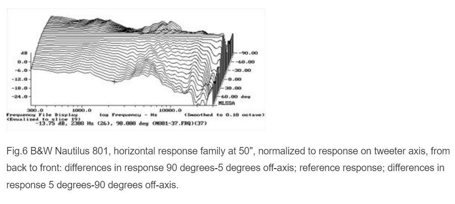

The Nautilus range employed a 3rd order crossover with the tweeter set forward by a distance equivalent to 90 degrees at 4kHz, whereas the Diamond range uses a first order network with the tweeter moved forward by a full 180 degrees @ 4kHz. This is what causes the uneven response on and off axis - in conjunction with the peak at 4kHz which is partly from the controlled FST driver break-up. Below 3kHz the tweeter generates destructive interference at the listening height, and because the polar response is much wider than the FST's at 2kHz, the interference is more pronounced at >30 degrees off axis, laterally as well as vertically - below the listening height .
IMO, the dip in the power response in the 2-3kHz is a little too excessive with the diamond range. Sure, a little dip is nice for classical music, and is also catered for by most recording studios, but > 3dB in the far field is excessive IMHO.

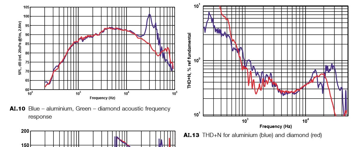

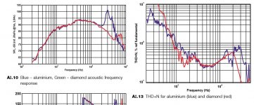

See the attached measurements of the old and new tweeter. Aside from slightly lower distortion down low and above 20kHz, the diamond tweeter is essentially identical within the audible passband.
I doubt you would be able to hear any difference at all if you ever did upgrade your Signature tweeters to the Diamond version.
