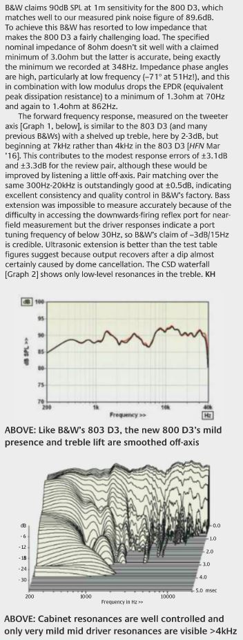

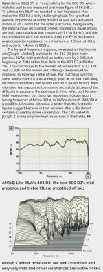

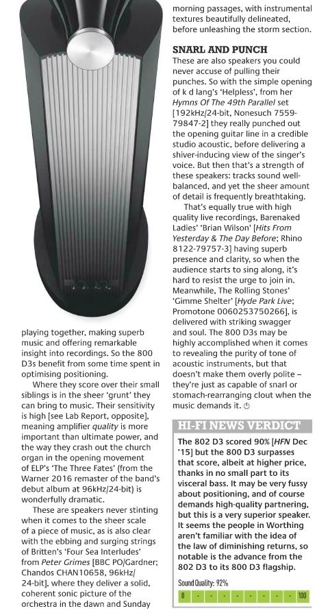

so basically they are monstrous speakers accordingly to the review?
By British standards perhaps...
Unfortunately, the full review isn't particularly helpful for prospective buyers IMO, and it's clear that the reviewer spend too little time actually reviewing.
The technical measurements raise more questions than provide answers, so we'll need to wait for Stereophile to test them using their standardised methodology.

The response has the "W" shape characteristic of B&W 3-way systems with first order tweeter networks, suggesting that the crossover is a repeat of the 800D / 800D2 crossovers. The midrange response is somewhere between third and fourth order at the high end. The phase mismatches between the midrange and tweeter result in the W-shaped response, a messy radiation pattern and a (very) small listening area where things work properly.
I really wish someone at B&W would explain why they think this is a good idea, because I can't figure it out.
The last two D series and the GE tritons (or some such model) measured very closely in the mid-treble region. If they are consistent, they'll call this a failure. Honestly, this looks more like the mag got a pair with bad crossovers, or that they were measured off the listening axis. I think the 802's are meant to be listened to on the mid axis, right? It solves the treble somewhat.
Ideally, measurements should be taken at the specified reference, which B&W claims is just below tweeter height, but it's desirable to measure over a +/- 30 range in the V and H plane.
Measured on axis with the mid FST, a suck-out will develop at 2-3kHz, and at the tweeter height on--axis, a suck-out is evident at 6kHz. In both cases it's because the FST and tweeter are not in-phase.
The problem is created by the decision to move the tweeter forward by a half wavelength of the crossover frequency rather than invert it and align it for time-coherence - which is the Wilson approach.
The B&W alignment means that the drivers will be 90 degrees out of phase above and below the crossover frequency (0.5 and 1.5fx) when listening on the reference axis. You can listen at a lower height to fix the suck-out at 6kHz but that creates a 180 degree relationship at 2kHz, and conversely, listening slightly above tweeter height fixes the 2kHz suck-out but moves the full 180 degrees of phase error to 6kHz.
Listening 15 degrees off the H axis reduces the dip at 6kHz because the amplitude of the FST is about 10dB down due to beaming.
So if you read between the lines it appears that the designers expect the listener to be slightly off the H axis and seated just below tweeter height.
They claim that absolute phase is important, hence the need to have all drivers connected with the same polarity, but my guess is that the tweeter suffers from diffraction effects unless it's moved forward of everything below it.
Focal did this for a while as well, to a much lesser extent. As far as I could tell all it did was prevent great phase matching and require more parts in the crossover.
Hopefully B&W's design did not require as much effort.

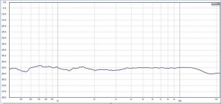

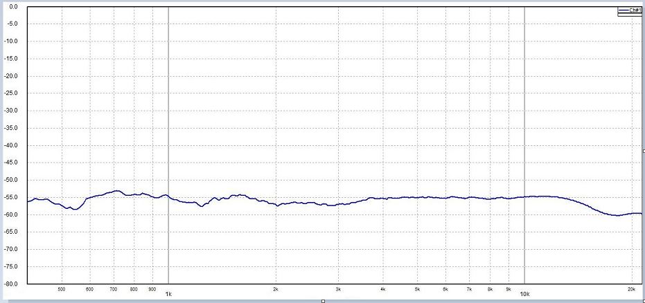

I read this blog post before, and I tried to mimic the same FR with my speakers with DSP EQ. The result is very interesting.
Plasnu, you should have told me, I would have sent you my files! I just sccanned the Stereophile graphs.
Anyway, please please please tell me what you found! I was going to try that wiht my MiniDSP but real life keeps getting in the way.
Seriously, man, tell me!
I'm actually thinking of doing that for a listening party next month, as part of a larger wine, listening thing.
Erik
But how can you simultaneously also mimic the off-axis response?
Fwiw, I also own a mini dsp, + Dirac live correction, and I've generated correction profiles for on-axis as well as various degrees of off-axis conditions, but I've now arrived where I started, dsp-free and with a very flat response in the listening chair.
