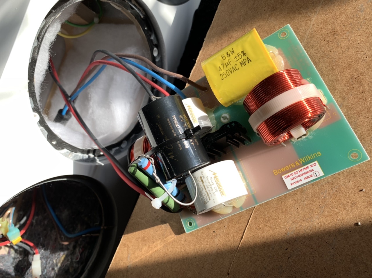

Before making significant alterations to the crossover - such as the proposed mod to 3rd order filter I would simply add a 0.5R resistor in series with the tweeter plus also add a 0.68mH in parallel with the tweeter.
This will reduce the tweeter level by about 1dB and reduce the 2kHz dip by 1-2dB.
Changing to a third order, without moving the tweeter for phase alignment will likely alter the vertical lobe significantly in the crossover region.

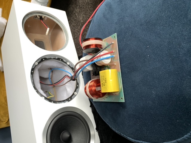

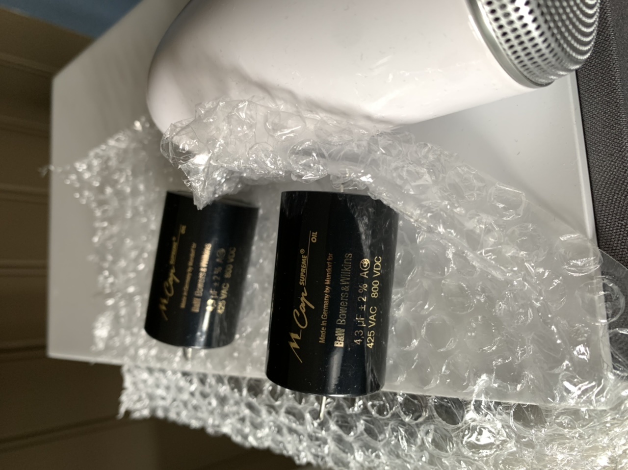

Hi Art
Where should the resistor and parallel coil be connected with respect to the existing capacitor? The most convenient for me would be to install the resistor after the cap and to connect the coil either forward or after the resistor. But i guess it makes a differerence and should be wired according to your simulation assumptions for the correct result 🙂
Regards, Bjarne
Hi Art
Regards, Bjarne
Hi Bjarne,
Resistor must be before the cap (input) and inductor to ground after the cap (output).
Art

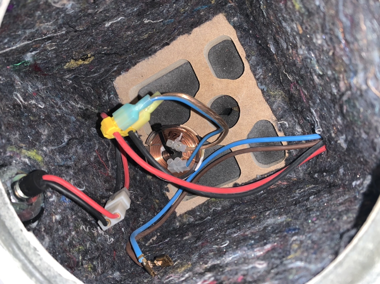

Mod ongoing. One of these rare occations when I wish my hands and fingers were the size of a female pornstars.
Ok, soldering next.
Ok, soldering next.

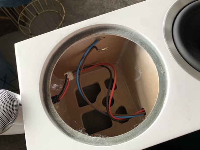

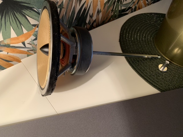

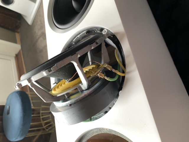

My plan was to line the mid chamber with felt, but I cannot access the inner half due to bracing. Kind of surprised of the build quality, the bottom side is actually «shelfed» with an inclining angle, my guess to avoid parallel walls.

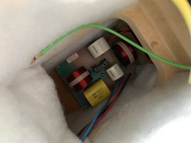

Up and running with Art’s proposal. Tried some different coils and settled for 0,8 mH for now. The resistor ended up at 0.6ohm (1+1.2 Ohm in parallel, close enough).
Also the midrange front chamber is now lined with 8mm felt.
First impressions after 1 hour of listening:
- more balanced sound, i.e. more bass vs highs.
- phase seems to be improved. Q-sound effects much more clear: Roger Waters dog is barking waaay outside the house instead of inside the speakers
- i can listen to metal again, yeah!! This is the biggest plus 🙂
Now for some more listening. I will live with this for a while before potentially going for 3.order approach.
