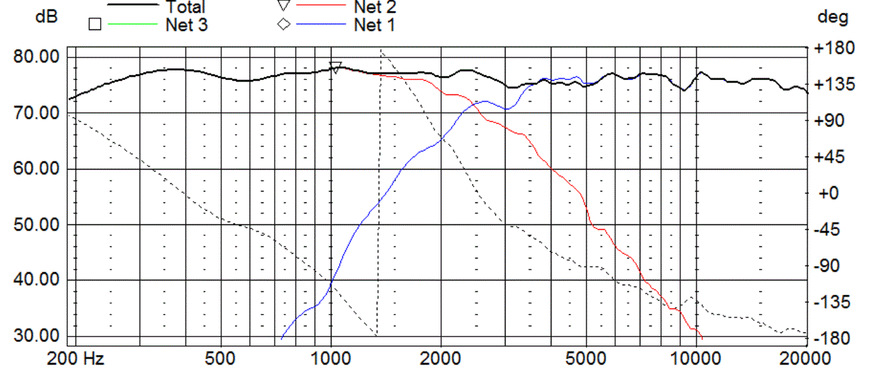

It depends. As a first pass design, yes I could simply redesign the mid range crossover to control the issues that the FST presents with and most likely reuse most of the crossover components. Art is currently on the way to doing this quite successfully I believe, but I get the impression that the loudspeaker would benefit significantly from a redesign of both the tweeter and the mid range crossover.
The idea here would be to build a 'perfectionist' type crossover that aims to provide the flattest on axis response, controlling any resonances and ensuring excellent phase integration between the two drivers.
Primarily I would like to lower the crossover point down so as to achieve the above, whilst also vastly improving the off axis response. But that would require knowing how capable the tweeter is and would require a distortion measurement be made at a suitable drive level.
What I am saying is that, I can give a try with a different cross over. The modification is not permanent as I would take the original midrange XO out of the plinth and put the new one and run a comparison. If this doesn't work out the speaker can be put back to the original condition.
Since I think 5th is a very skilled person and he seems is not talking out of his butt, I decided I can evaluate a new crossover for a listening test.

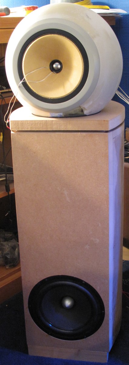

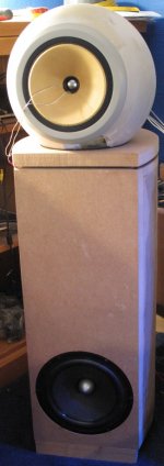

I figured why not give it a go eh? The FST seemed like the perfect choice for a decent coaxial as it has a very smooth profile without any irregularities, like half roll surrounds, to get in the way. The trick was to find a tweeter that would work suitably well. The ND16 from Dayton Audio worked as a proof of concepts, but wasn't ideally suited. I managed to procure some new old stock Aura NT1 titanium dome tweeters and after carefully milling them down, they fitted perfectly. These tweeters are little gems and have very low distortion within the range I wish to use them over and also have nice underhung motors. Plus the rigid dome gives pistonic behaviour which I am partial too.
Here's a shot of the loudspeaker itself.
attachment.php
I replicated B&Ws enclosure for the FST out of polyester resin filled with marble dust. This is very dense! The bass module uses Jantzens JA8008-HMQ in a ported, floor loaded, enclosure with the over sized port located in the base of the loudspeaker and firing down towards the floor. They provide solid extension down to 50Hz with 95dB re 8 ohm sensitivity up until the 300, where the FST takes over, offering similar or greater sensitivity, but at a 4 ohm load. Wave guide loading the NT1 with the FST cone gives it much higher sensitivity around the xover frequency, so it operates up to around 94dB sensitivity at its maximum (around the xover frequency) before gradually declining down to its usual 88dB by 20kHz. This set up is very dynamic with ridiculous levels of transparency and due to the coaxial, wave guide loading has awesome off axis response.

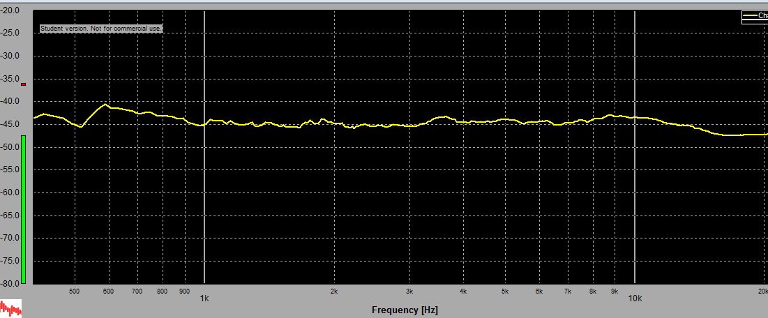

Here is how the on axis response looks, which is quite something considering the coaxial nature. The ND16 didn't look anywhere near as nice in the top octave, which is usually one of the accepted trade offs when using wave guides, you get suck outs, on axis, in the top octave. Not so with the NT1!

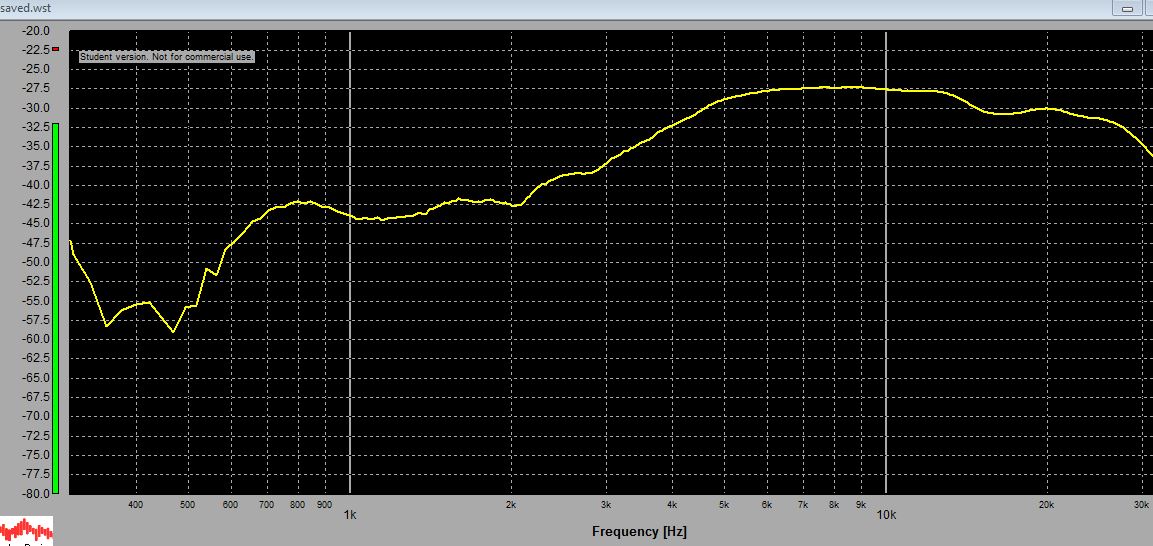

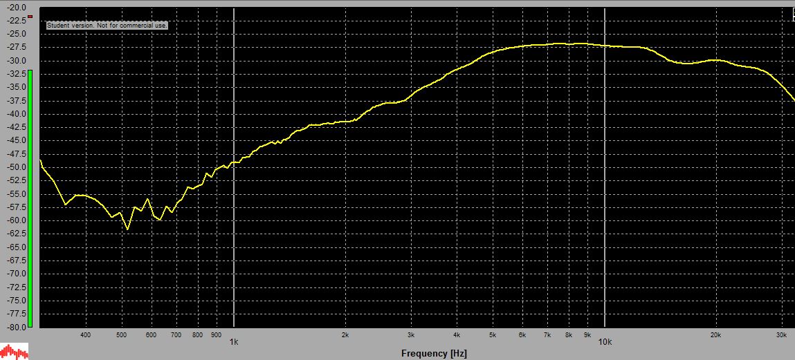

Today though I got around to taking some measurements of the tweeter response with the (simple) B&W crossover. You'll see that it's not quite the ideal second order L-R response, but the main problem is the untreated resonance at 800Hz.
So I decided that some impedance correction might be worth implementing. (Note the before / after plots attached)
I'll hook the system back up a little later and will report any subjective changes. Overall, measurements wise it's not too different, although the response between 800 and 2000 Hz appears to be a bit smoother. (I'll provide the before and after's in a subsequent post)
Definitely worth implementing. Looking at the tweeters plot I am surprised that B&W didn't implement this themselves. Running a simple 1 cap xover on a tweeter provides minimal protection vs overload and this is especially true where the tweeters resonance is concerned. As the impedance increases at resonance the effect the cap has diminishes significantly, which is why the response deviates away from the L-R slope and exposes the tweeter to low frequency stuff that it should really not be seeing. Impedance compensation is usually employed specifically to prevent this from occurring.
Like in your case here it is usually out of band, so has minimal impact on the overall summed frequency response, but the tweeter will definitely appreciate it.

Not putting it in will only stress the tweeter more around resonance and increase distortion, especially intermodular.
This is relatively far out of band, but nevertheless the impedance compensation network cuts the output by 10db! Around resonance. This is not insignificant as the tweeter will most definitely not be happy playing signals that low and will already show increased distortion down there that'd you'd rather not be exposed to. Granted the diamond tweeter is likely going to have a rather beefy motor with a healthy amount of linear excursion, but nevertheless, at high listening levels it could quite easily be a problem.
