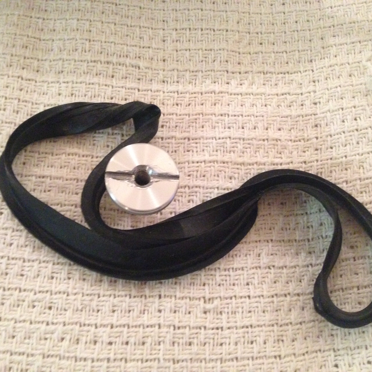

this is the drawbar fixing after the initial try with the coin, it actually worn down significantly.
The gasket on my signature for some reason seems to be a soft rubber/gel material.
However on the B&W's video it seems to be a stiffer material. I wonder if the replacing part I got for my signature will be a gel like that or a more solid thing like the one shown on the video.
I am assuming that it is much easier to put on and dress properly the gasket when it's firmer.

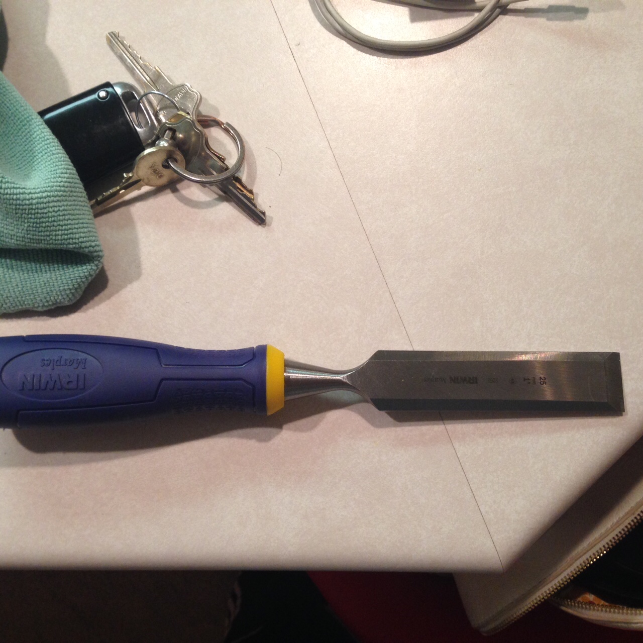

this is the chisel I have used for the job...if anybody needs to know how to solve the problem they can buy the same or similar tool and they can be sure they will be able to remove the midrange.

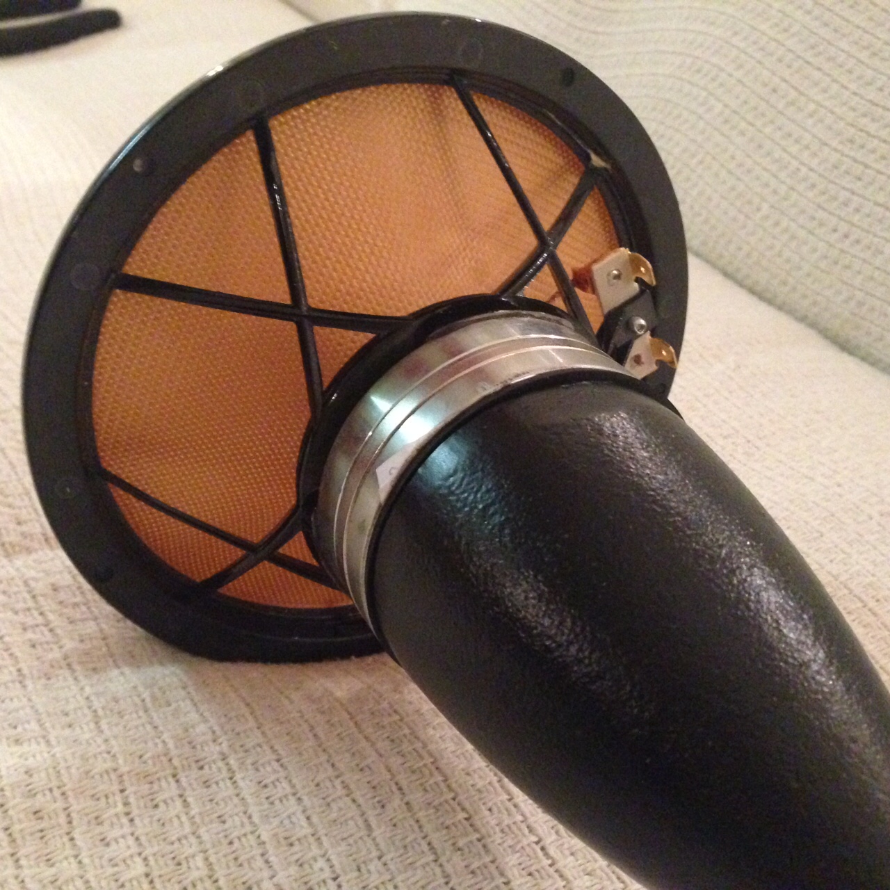

and here is the midrange for the signature. what I can notice is that
1) the trim for the midrange is not removable like shown in the video for the diamond but it is pressed fitted together. This means that there are no screws in the back to hold and/or remove the black shiny trim in the front, which I find it very odd.
2) On the mid for the signature the reinforces look like spokes while on the diamond they look more sturdy (?!) not sure. I remember on the marketing ad, advertising that midrange had a more sturdy body. Not sure which one would be better and if there would be any sound improvement by changing one over the other.

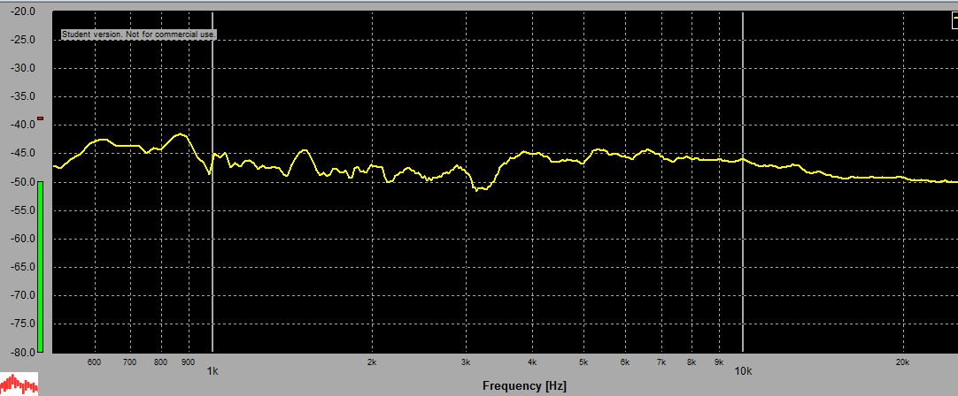

Can you recall if you were listening below the tweeter axis when listening to the 802Di's?
The optimum height is just below the tweeter. If you listen at the FST height the response is shelved down below 3.5kHz, which makes the treble sound too bright and somewhat detached.
