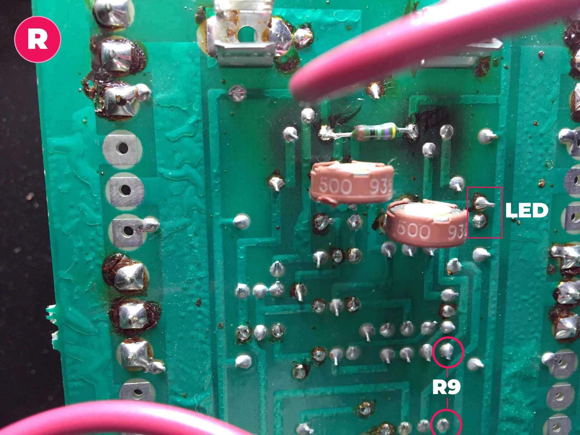

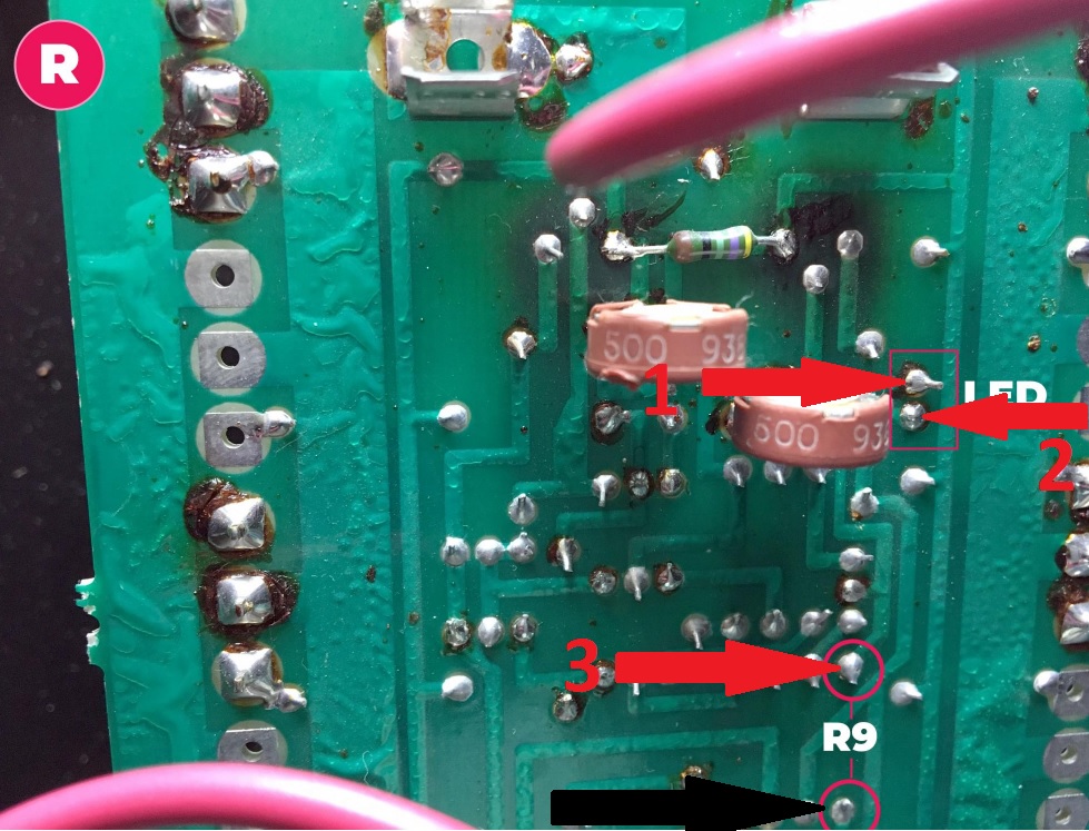

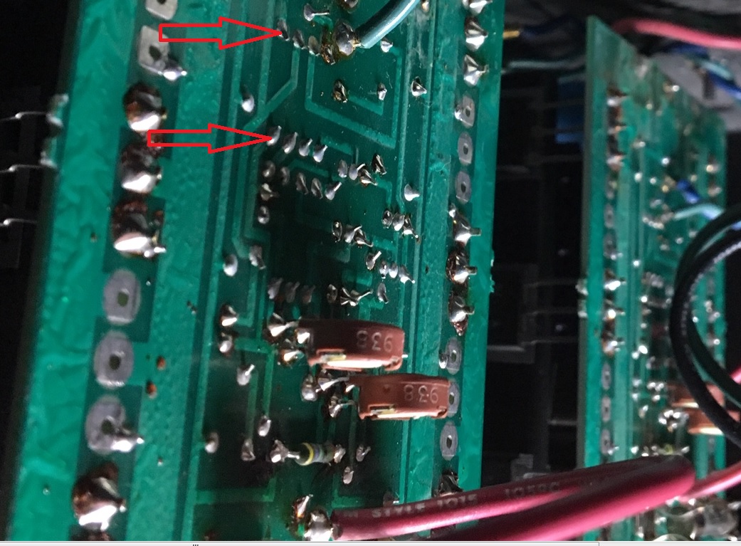

I traced it out with your earlier pics. The arrows are pointing to the leads for R9.

Measure the following 3 points in reference to the bottom of R9 where the black arrow is pointing. #1 & #3 should measure the same unless the trace is opened up somewhere.

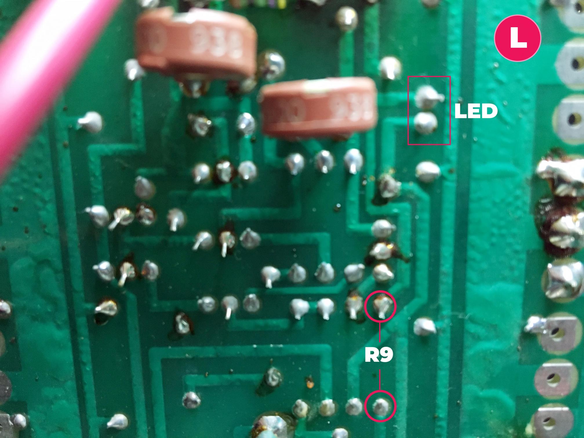

#1 & #3 measure ~33k on both boards. Consistency = good
#2 give me values all over on BOTH boards ... depends on getting a good spot on the pins ... at first, the values jumped up, then finally settled down to the values below. The bad R channel seems to be dropping a tenth every second ...
R = 8.xM ohms and decreasing value, as I hold probes
L = 4.31M ohms

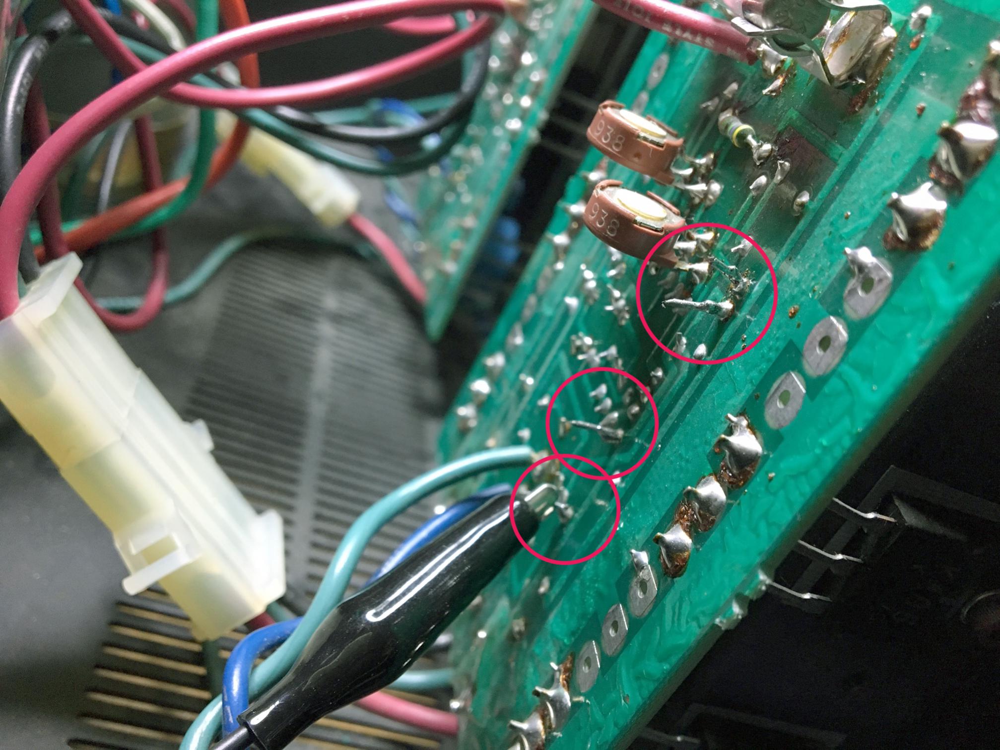

Boy ... I'm really not willing to take a mighty chance of arcing the board when I'm probing. I think what I would need to do is solder a short length of wire (from surplus capacitor) so I can use a clip, without it coming off.
I tried on the bad board with #3 and got 0.000vac reading ... but as I mentioned before, I have to move the probes around the pin to get a solid connection, ie, reading.

Okay ... soldered test pins on each of the four pins ... this gives me enough "material" to grab onto with micro clips.
#1 = -0.000vdc (LED)
#2 = -0.624vdc (LED)
#3 = -0.000vdc (R9)
