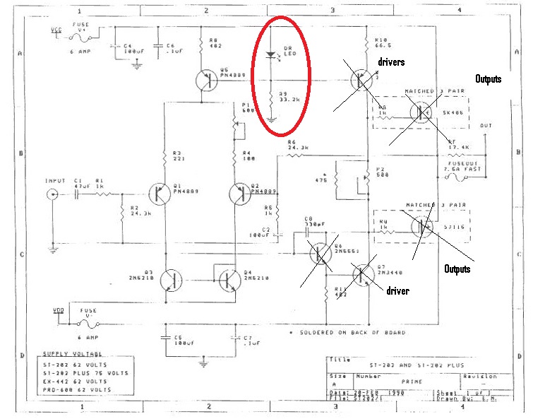

The K405 & J115 devices are not lateral mosfets, see this thread for more detailed info. There are no equivalents that are produced any longer.
B&K used the laterals you referenced in their later amps however I'm not certain what changes were made to the circuit to allow for their implementation. Its possible that the new laterals could be used in this older B&K amp, but he would have to dig to find out what, if any, changes might need to be made.
Also, the LED which is shown in post #19 of this thread should absolutely be on all the time. It is the voltage reference for the LTP tail. If its going out then there is a serious problem somewhere. There are only a few reasons that LED should go out when the power switch is ON and that would be,
1- Loss of +DC RAIL voltage. Which could be due to a blown + rail fuse (if its blinking then its not blown), cracked intermittent traces, solder joints or bad wiring).
2- Open resistor or failing LED
3- Loss of ground or poor ground continuity on the affected channel.
Although the LED or R9 could be going bad its doubtful.
I'm leaning towards cracked traces or problems in the wire harness. The fact that it seems to blink when a heavier load is placed on the amp tells me that either the DC volts are dropping too low under load due to a high resistance in the DC supply voltage circuit or the ground is insufficient to support the higher power output. This means that as the load rises the ground is likewise rising up to some level well above zero volts due to a high resistance (open wire, bad pin in a connector, cracked trace, etc) in the ground path.

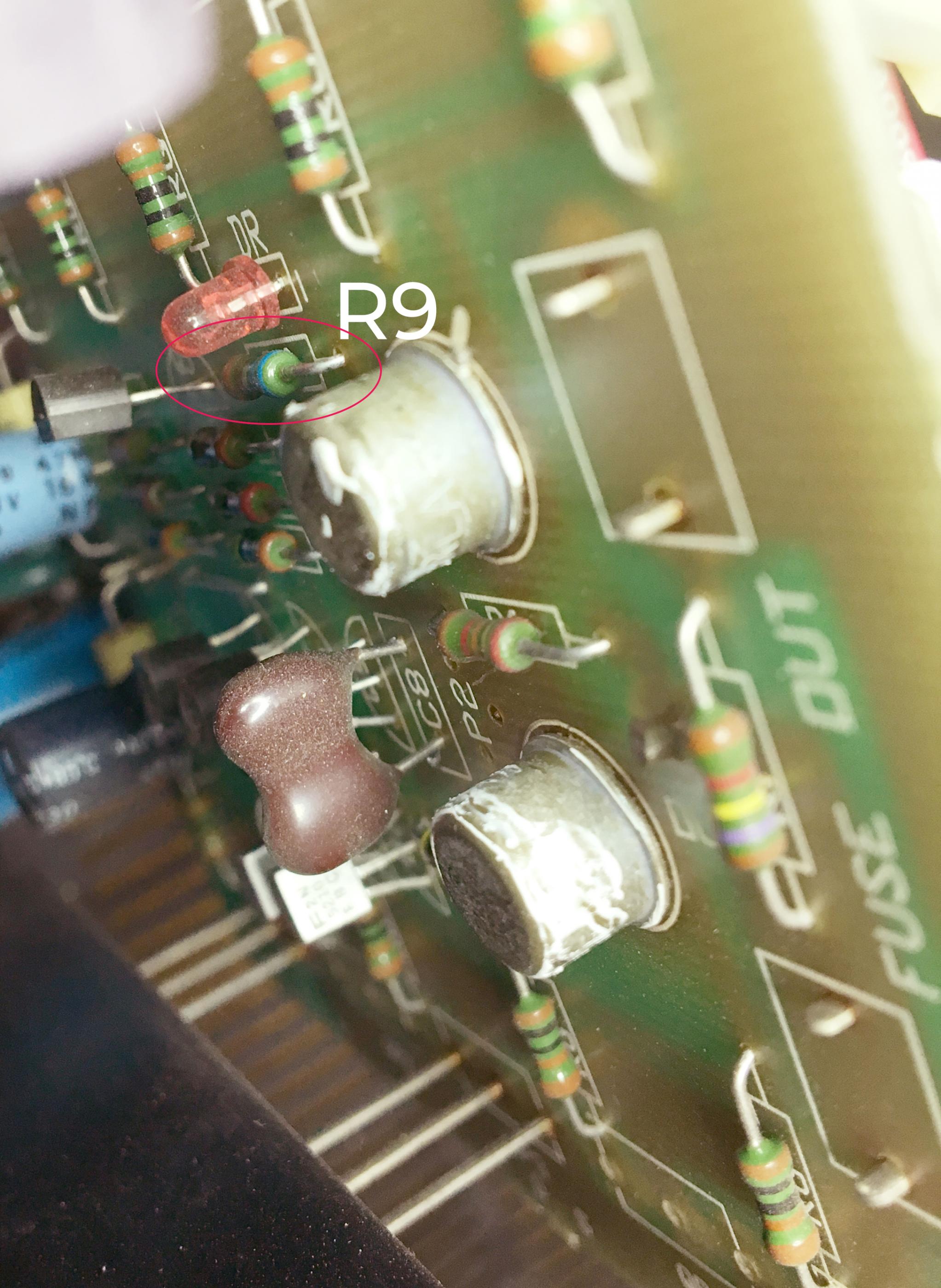

Kenwood61,
I wouldn't buy or do anything to the amp at this point. I would first focus on why this LED is not illuminated, it should always be on. If you find the problem with the LED you may inadvertently find the source of all of your other problems.
With the amp powered off measure the resistance of R9 is it approximately 33k?
Power the amp on and measure the voltage drop across the LED, it should be probably 1.7V - 2V.
Then measure the voltage drop across R9 it should be just a few volts lower than the main +DC rail.
If either of those voltage measurements is not right then measure voltage from the top of the LED to the bottom of R9 (ground). You need to do this right at the pins of those components because this will help to pin point if you have a supply or ground problem or if the LED or resistor is bad. You should see full +DC rail voltage here. If this voltage is drastically low then either the supply or ground path is compromised somewhere.

R9, if it's the right resistor, has following values, after connecting to power supply ... not powered:
R = 67.1 ohms
L = 69.9 ohms
I had to move the probes around on the pins to get a good reading.

Pull the rail fuses and try reversing the probes. You likely are getting a sneak path through one of the transistors.
Not connected to power supply ... pulled fuses on output boards and values are the same. Maybe this resistor is not R9? The resistors are so close to the board, I can't read them, and I'm not confident of my ability to read the schematic, if it is indeed correct.
Not connected to power supply ... pulled fuses on output boards and measure is the same. Maybe this resistor is not R9? The resistors are so close to the board, I can't read them, and I'm not confident of my ability to read the schematic, if it is indeed correct.
Based on the schematic it could be R8/R9/R10, at 67 ohms that must be R10. But its still is measuring wrong in the bad channel.
R9 must be located elsewhere possibly down by the where the ground enters the board.
