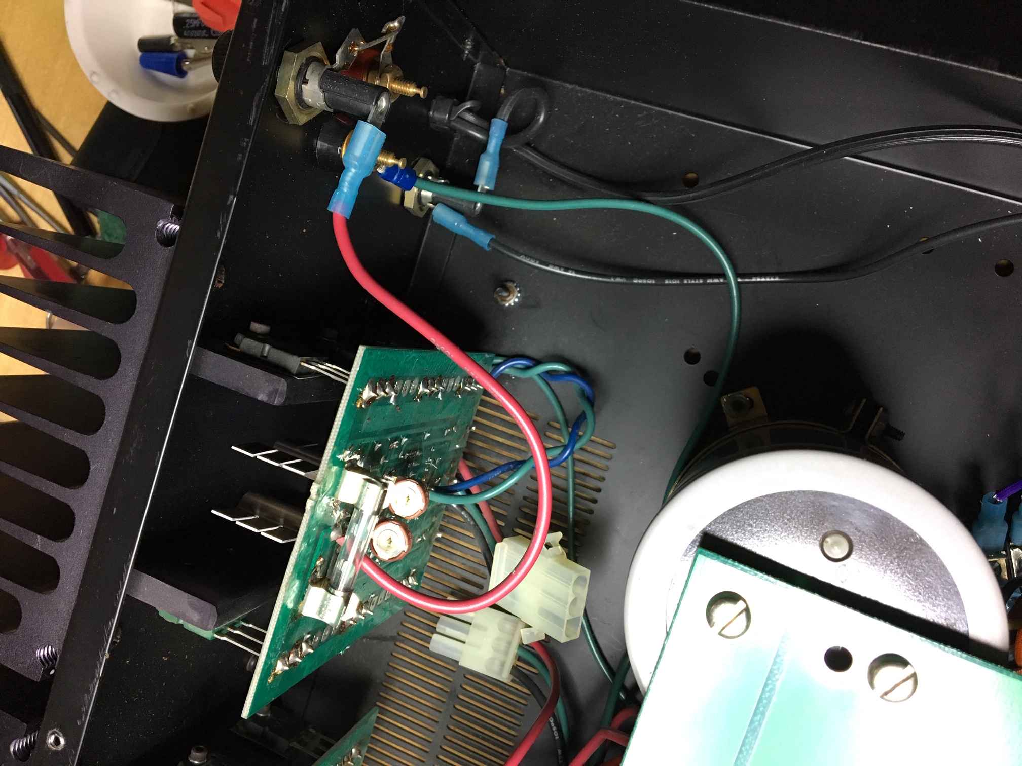

How many wires are attached to each amplifier module? I see: the red/black/green on the molex connector, the red that goes out to the speaker fuse, and the blue/green twisted pair that connects to the input RCA. Are there any others?
Also Kenwood61, I see no 'protection' circuitry on this amp. Leave the speakers disconnected until we can confirm the output offsets are good. Wouldn't want to smoke your speakers.

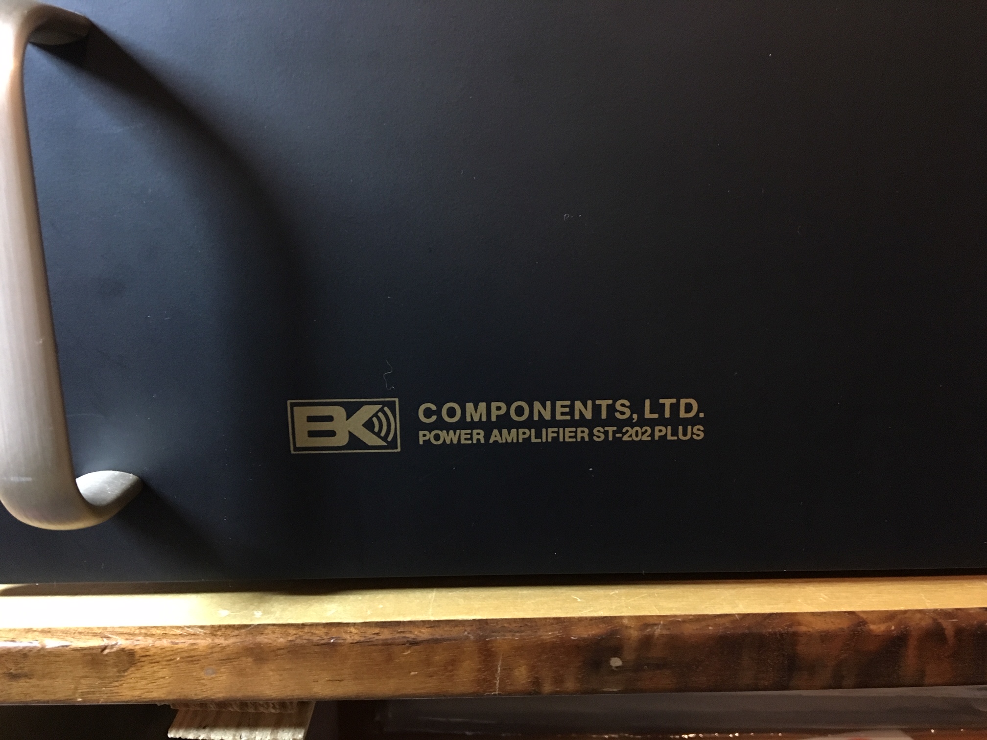

First off, my amp is the gold lettering, older version, unless there were later models that used the early faceplates. I can't find any information to support this.

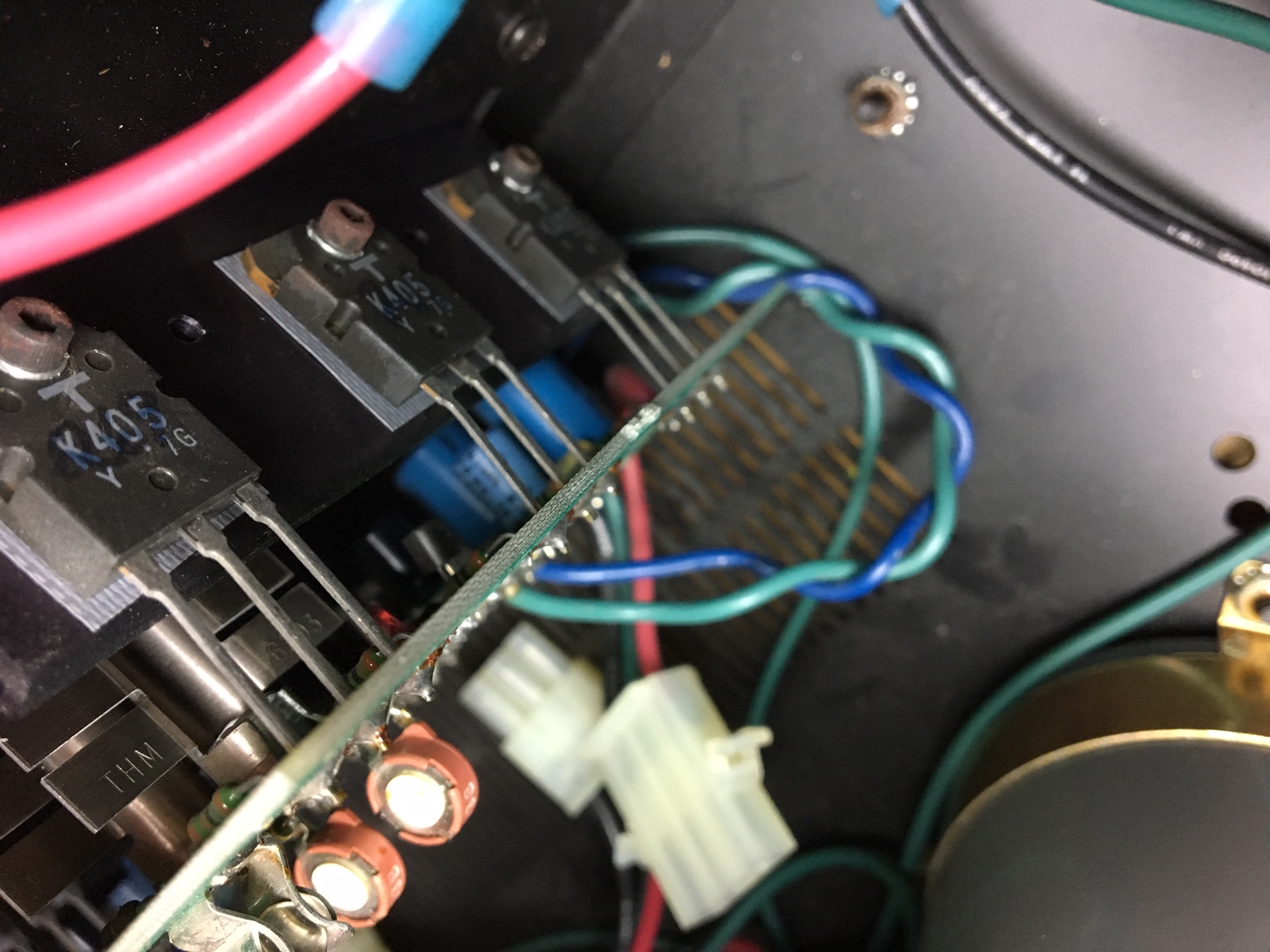

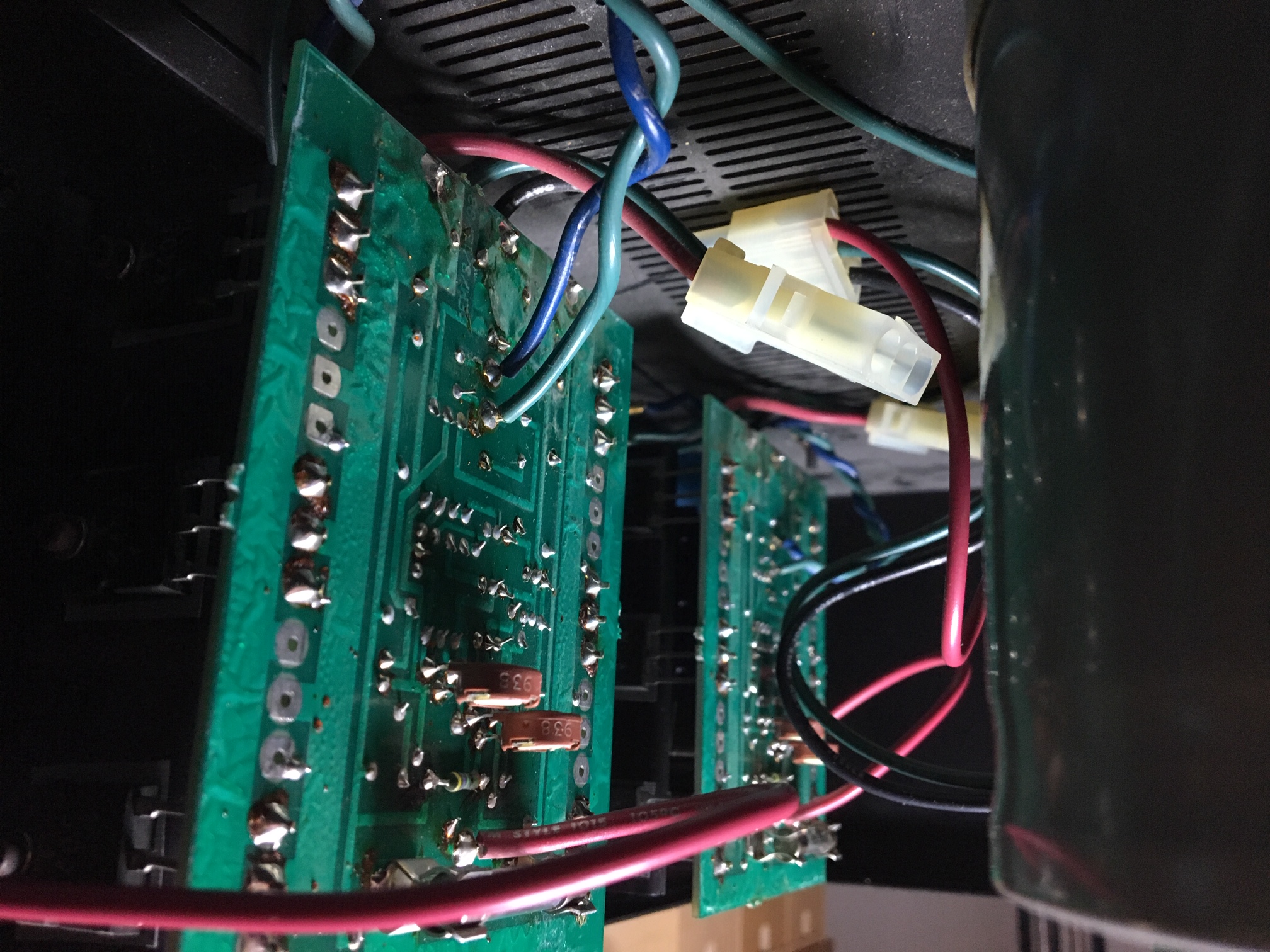

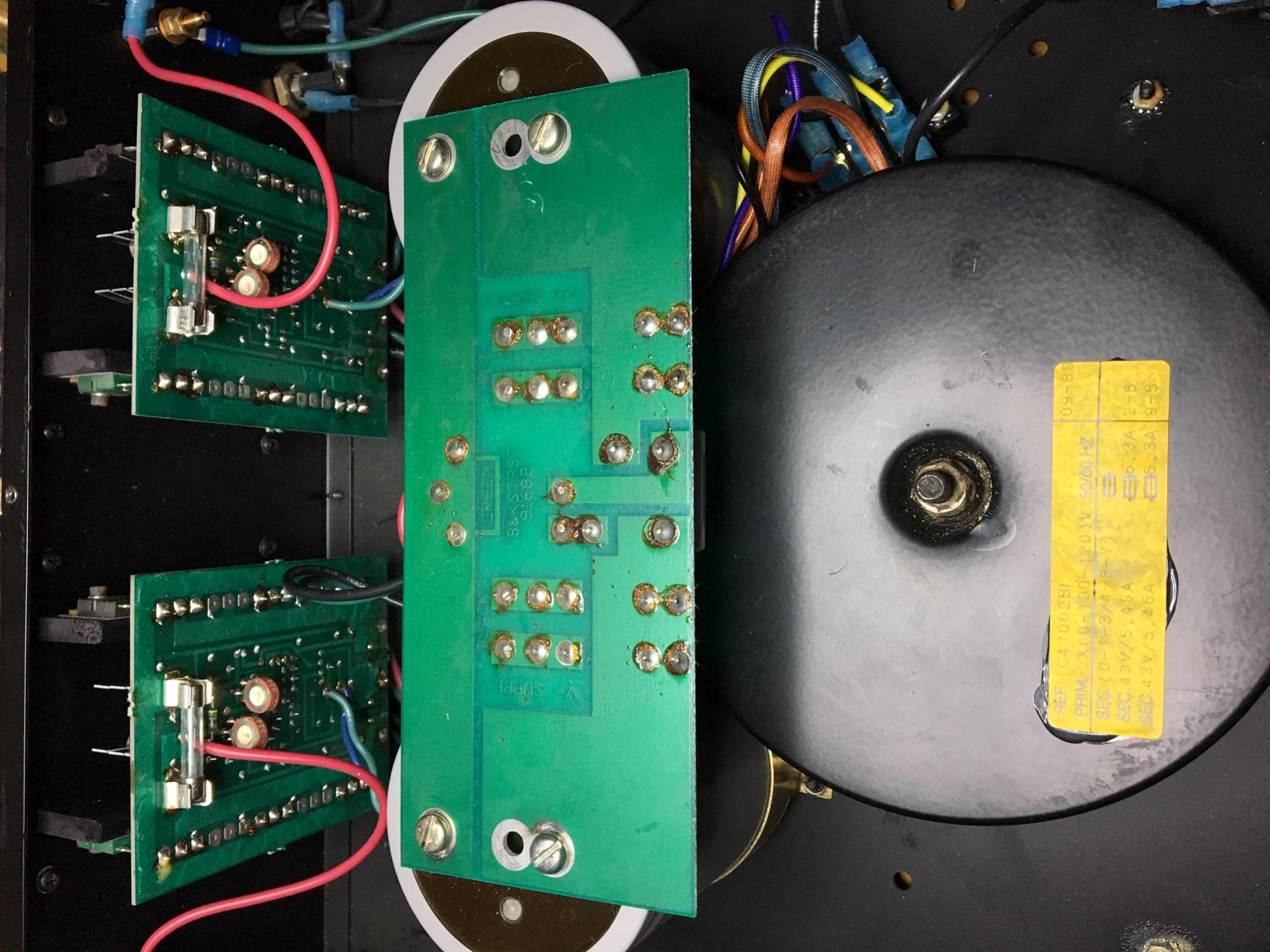

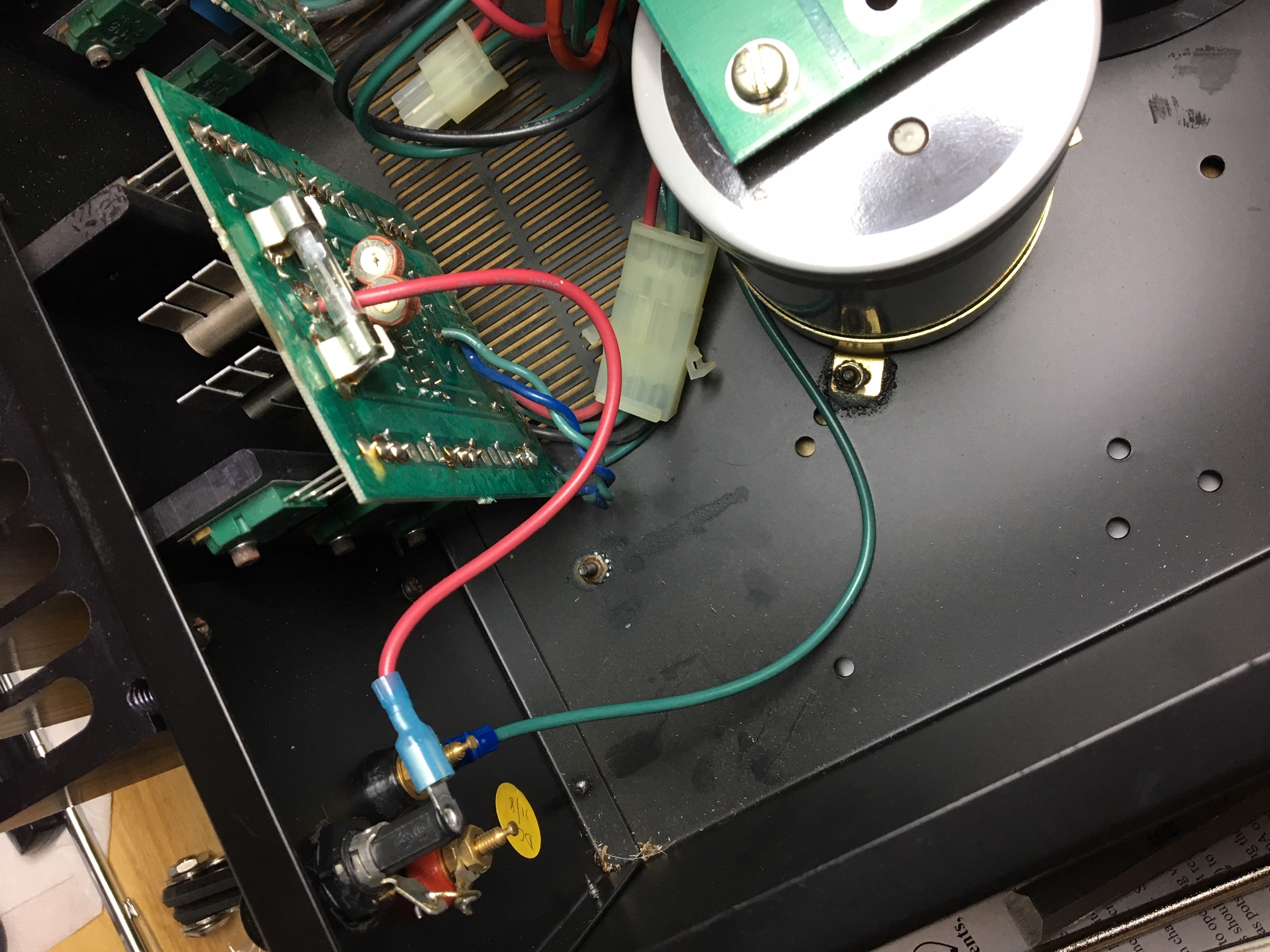

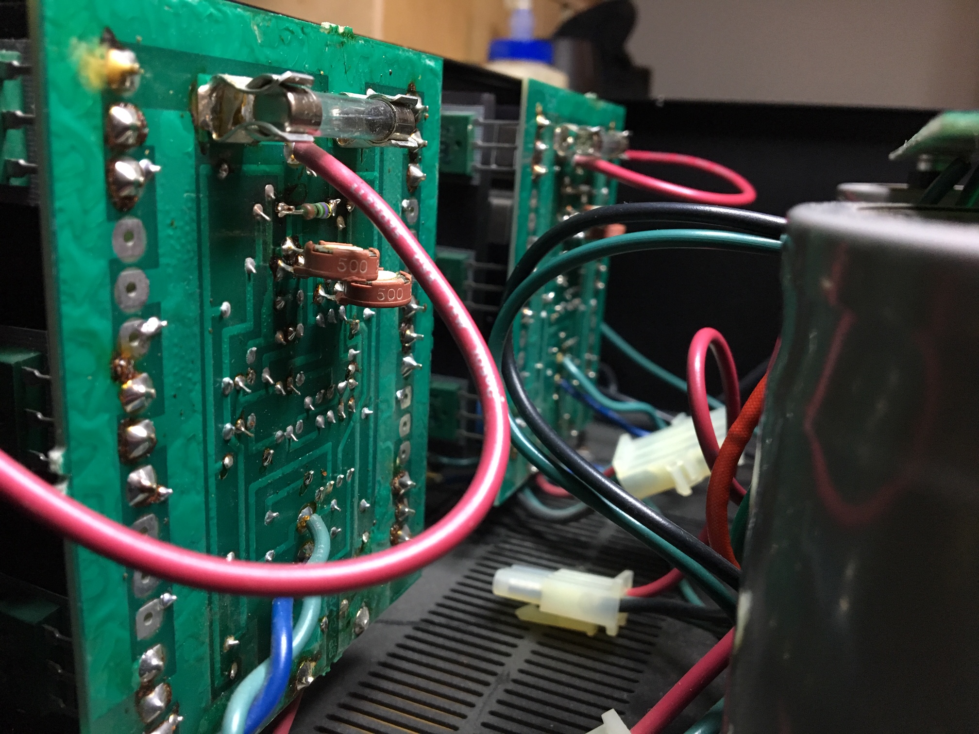

Here are some pics that we can reference.

Correct, there is no protection circuitry. That's why each channel out has a fuse, as well as AC fuse. Fuses galore.
There are ONLY five wires attached to output boards ...
- blue/green twisted pair is from INPUT
- red/green/black wires from the molex connectors
The green wires going to black speaker terminals and input ground are all coming from the chassis star ground, between the power filter caps.
There is a black square plastic housing on the underside of the power filter cap board ... is that a rectifier?

Yes, a bridge rectifier. The rest is as I expected.There is a black square plastic housing on the underside of the power filter cap board ... is that a rectifier?
I couldn't wait ... so I plugged the molex connect on the R channel back ... powered up on the variac/dim bulb tester, went bright, then dimmed ... extremely low hum, barely there, just like I like, but no LED light on the output board showing current. I adjusted bias, as the tech turned it to zero ... I had noticed before in my adjustment process that the lights would go dim/out when bias was turned off. So now that the light is not on, and no fuses blown, that I can see ...?
With power on, measure the DC voltage at the filter caps. One side should be positive, the other negative, and could be quite high (60 volts or more). Now put the voltmeter into the AC mode and see if you can measure any significant AC voltage across those filter caps.
DC = 65V each side, within ~ .2V rang
AC = 0V ... I get some values bouncing around quickly, but settle to 0VAC

Fuses
All the fuses under the filter board have a zig zag look to them. I don't want o pull one now an spark things up ... but there is one just like them in the fuse for the L channel speaker terminal.
From what I can find, and what is stamped on this, it's a Cooper Bussmann Buss Fuse BK/AGC-6 Amp 250V.
The other speaker terminal fuse is a 15A fuse. Doesn't say anything else on it. But the fuses on each output board are the same.
Then there is a third type of fuse that is only on AC power on back. That is 8A 32V 313, and looks like two tightly twisted wire filaments.
So there are three types of fuses. I did swap fuses on each channel out, but no difference.

On the subject of the fuses you listed. The 6A fuses in the power supply rails sound correct for a 200W amp. The 8A 32V fuse in the AC mains location is incorrect and should be an 8A - 125V or 250V rated fuse.
The speaker protection fuses both those in the rear fuse holders near the binding posts and those mounted on the channel boards can be whatever you want them to be. Instead of one of us typing out a lengthy reason you should read this Hafler XL-280 manual page 5 about the speaker protection fuses.
