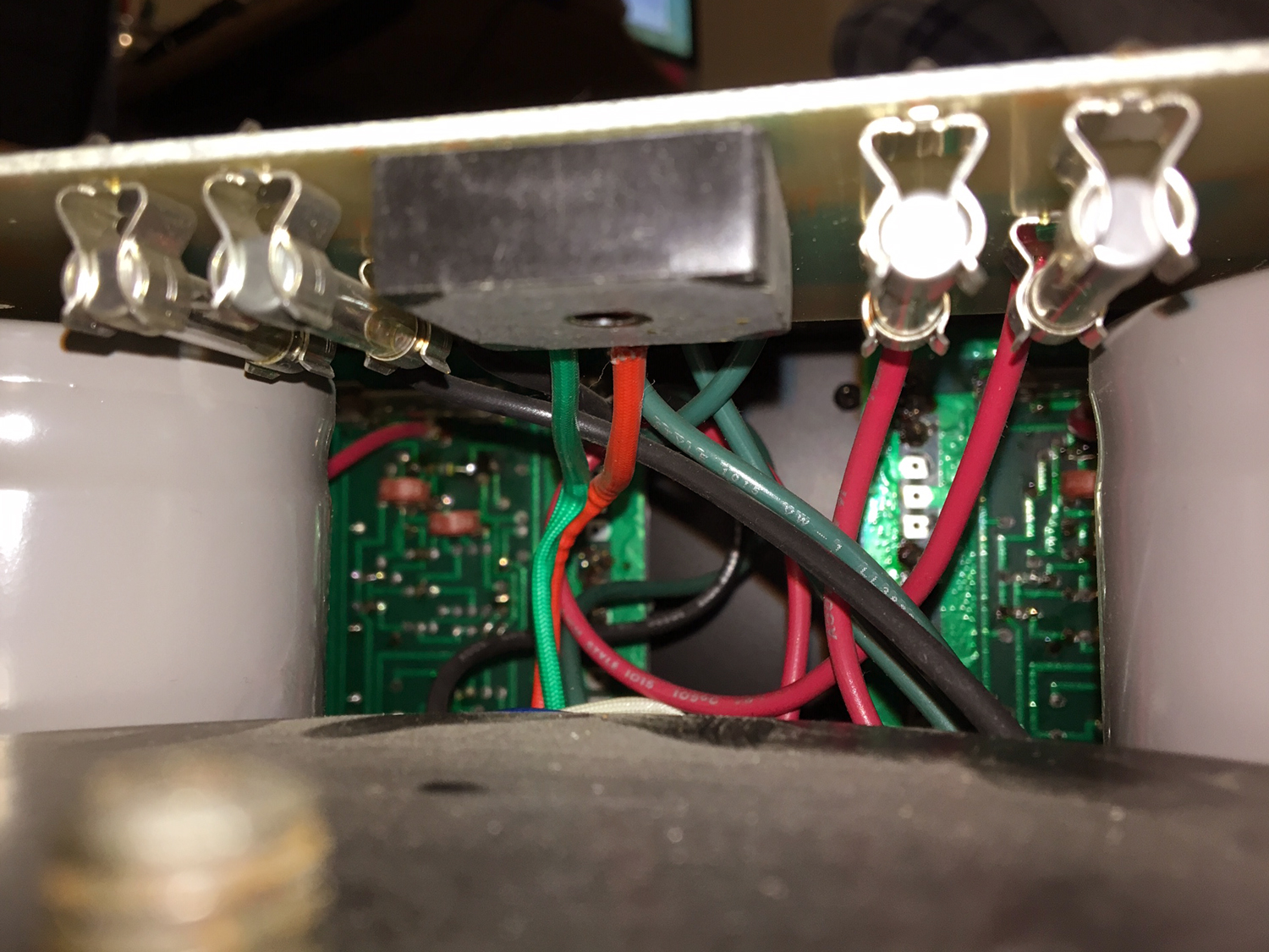

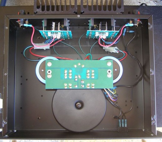

I'm pretty sure the DC rail fuses you need to remove and measure across are under this board.
Blue wire is the negative rail, red wire is the positive rail. You may have to get creative to attach the meter probes under there.
****Nevermind on my comment about the wire color, it looks like B&K didn't follow the normal convention in color coding, I think the black is the neg rail. ****

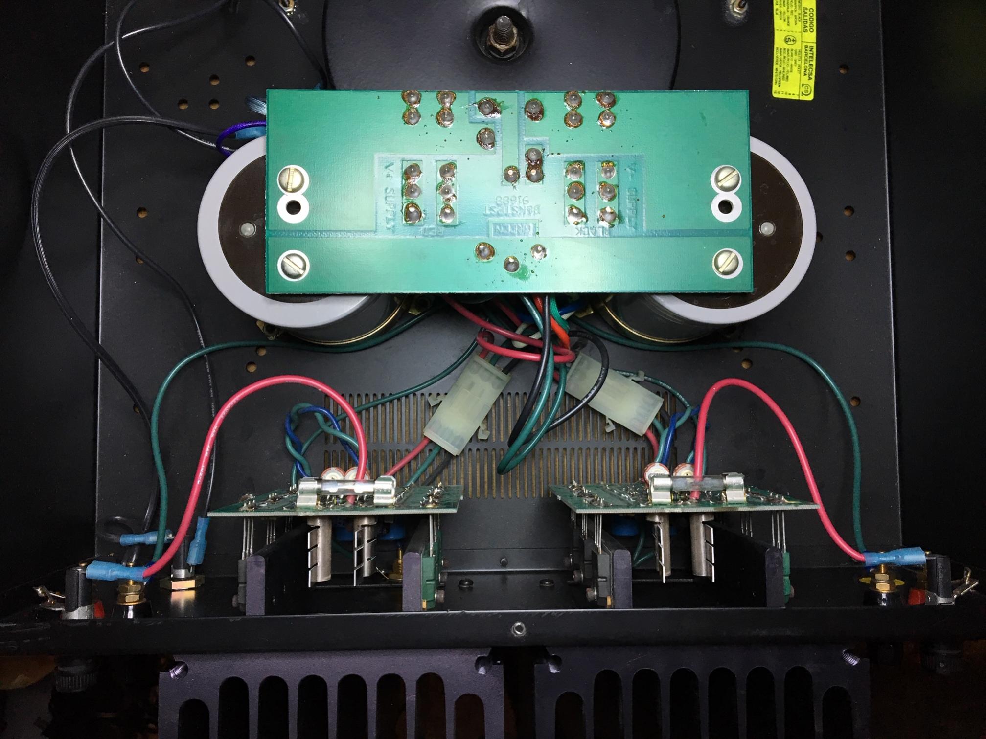

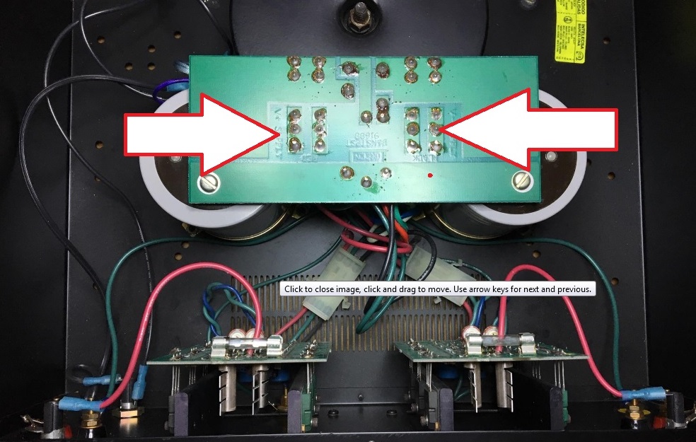

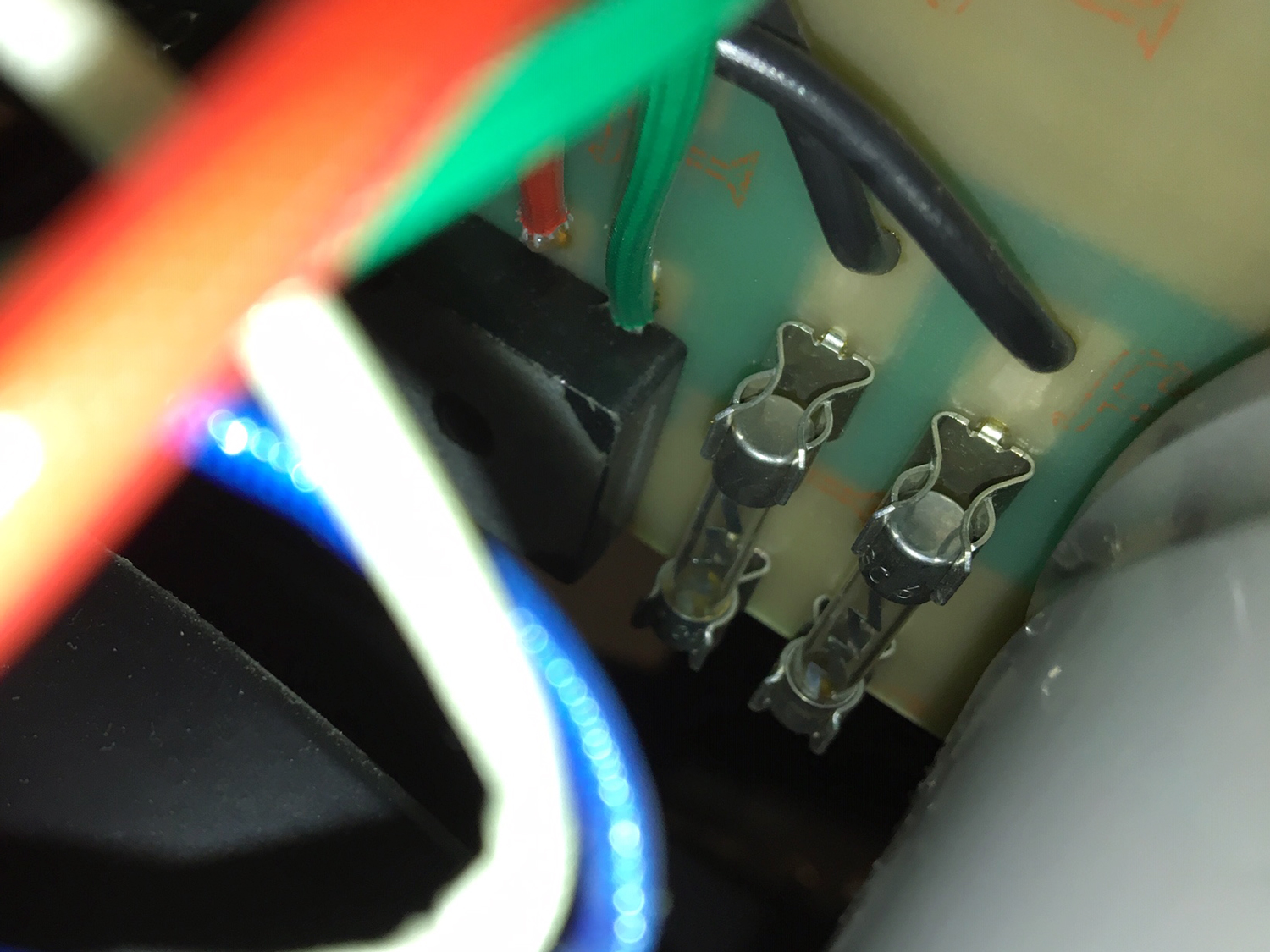

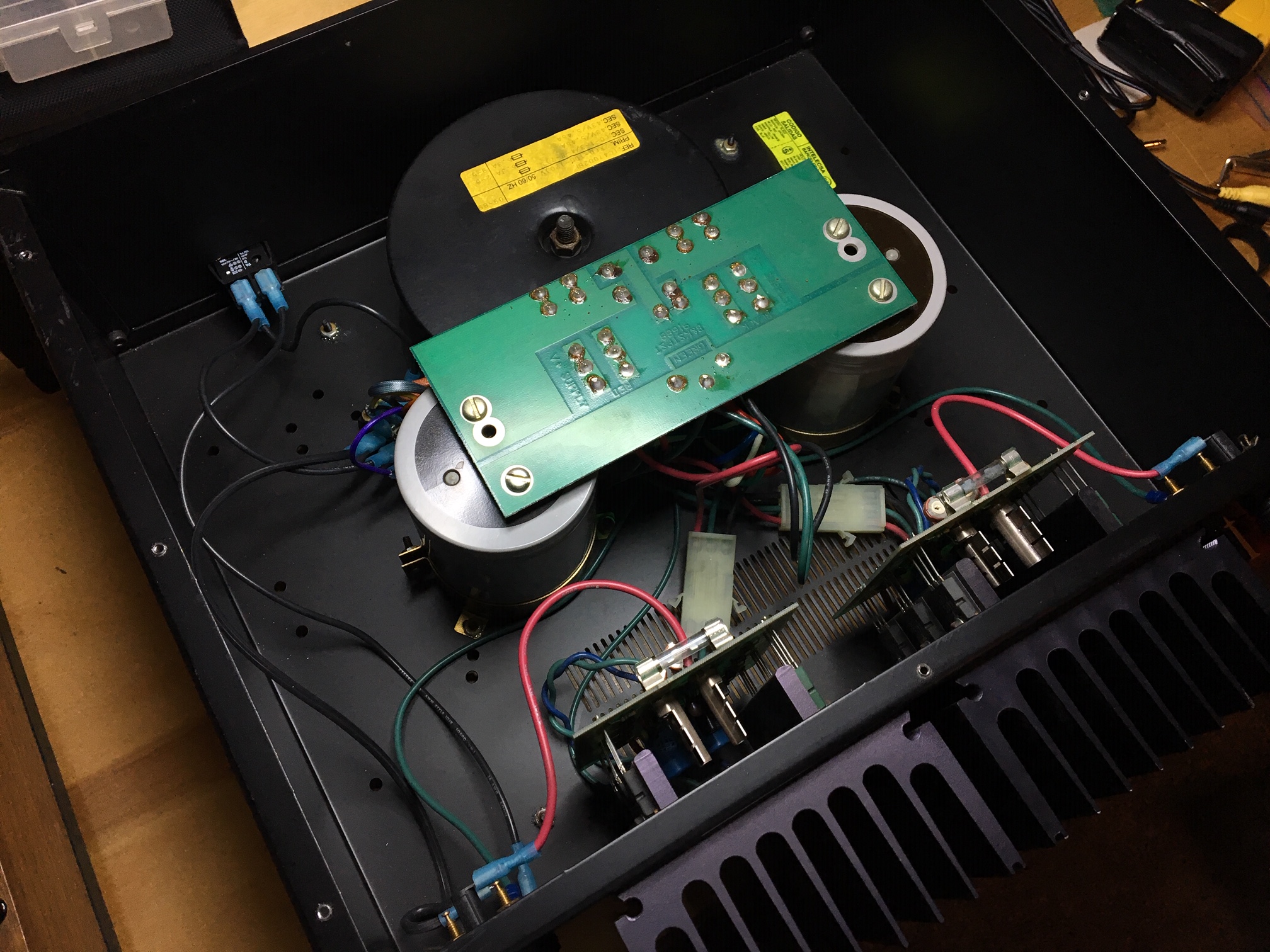

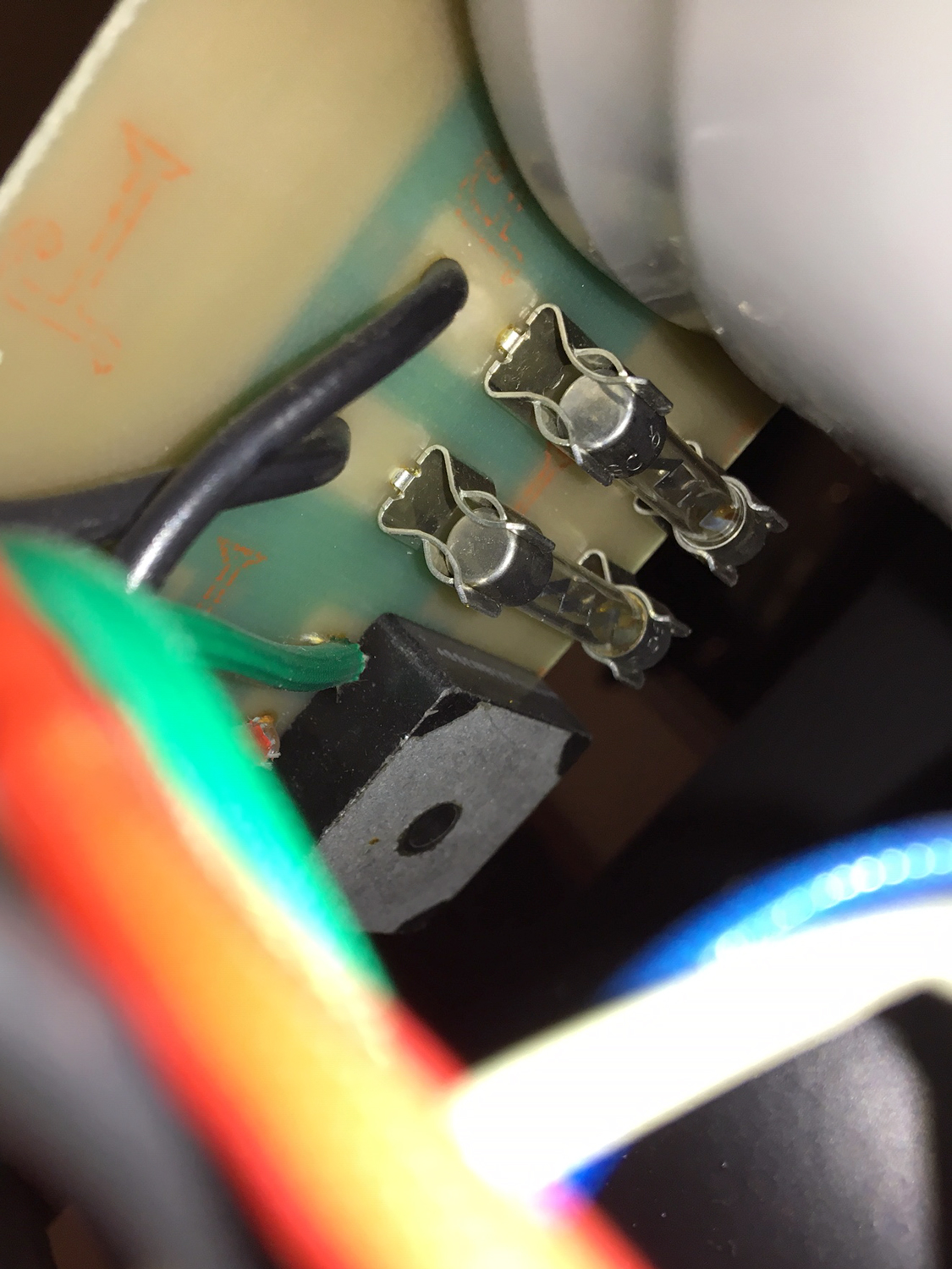

Here's some pics of under the board ... one of the times I'm glad my phone has a camera

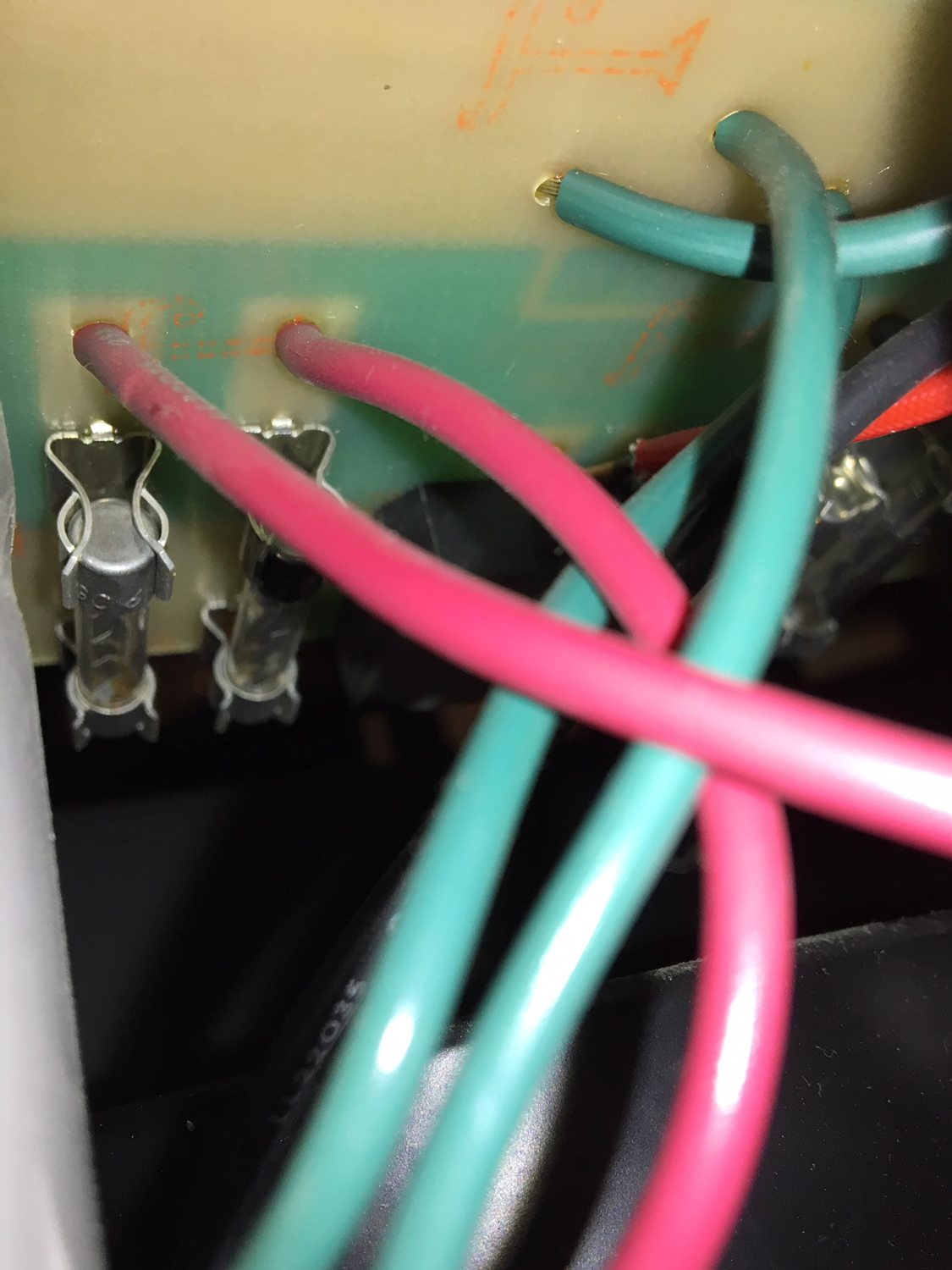

I see two fuses for each channel. Are the outside fuses the pos/neg rails I need to meter?
Red = pos
Black = neg
Red = pos
Black = neg

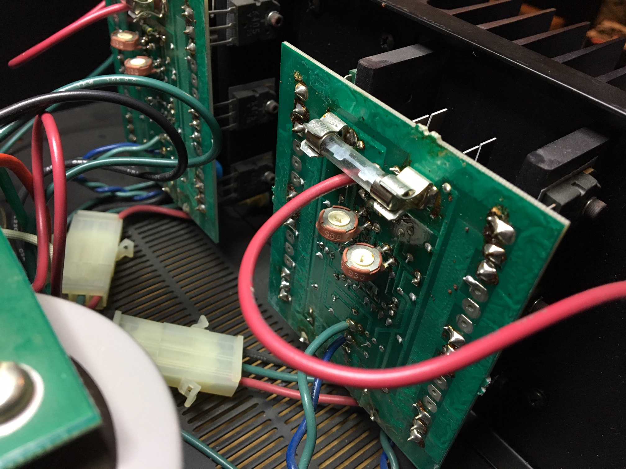

The B&K procedure says to remove the neg rail fuse in each channel for setting the bias. So pull one of the black wire fuses, trace out which channel that black wire goes to and that's the channel you'll adjust once you power it up. Then power down, reinstall that fuse and move to the next fuse.
Make sure you let the amp sit for a couple of minutes between power downs to allow it to bleed off the voltage. I do not see any bleed resistors on the power supply board or across the main caps, they might be on the channel boards, but be careful. You may want to measure the volts across the caps before you pull those fuses to make sure they're bleeding voltage off when powered down.
Also don't forget to turn the bias pots to minimum before you power it up the first time or you risk blowing the meter fuse on the 400 mA range.

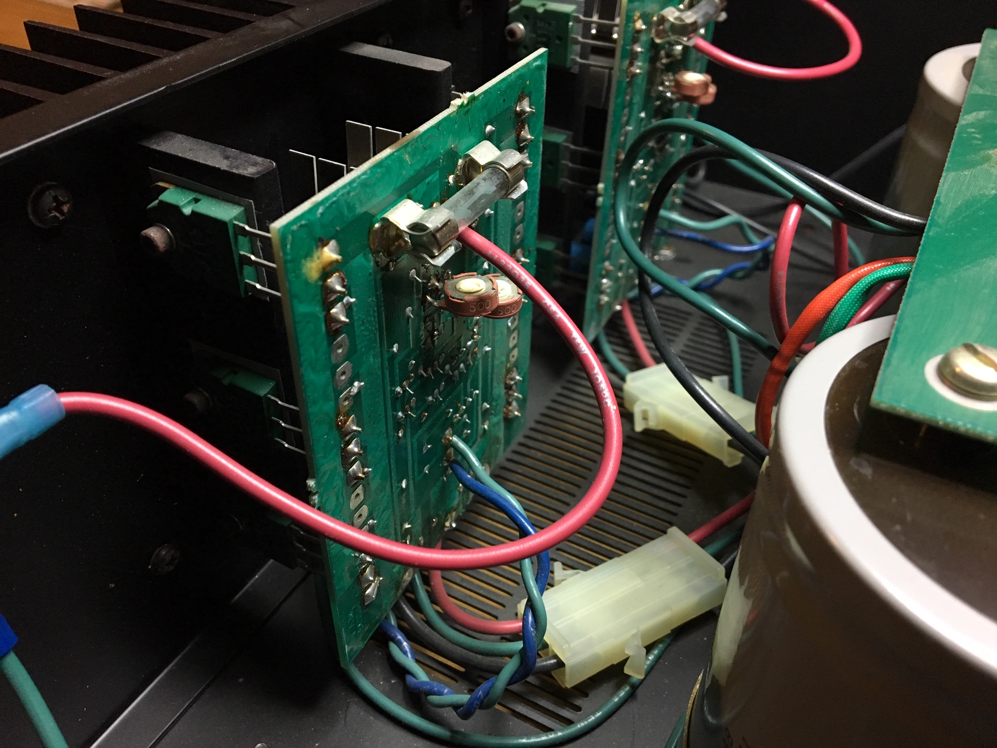

Ok. One side done. Strangeness.
Never got above 101mA, as I increased voltage on the variac. Settled at about 99mA ... as I turned the trimpot a little in either direction, readings always stayed within ±3mA ... but after a few turns, the hum level dropped, and the red LED on that channel board started to blink.
After power off, the LED lights on both boards stayed lit ... with the L channel I was working on, still blinking. Previous times of shutting off, both lights went out. So something is different now.
I'll wait awhile and try the other side. If I keep this, I believe at the very least, I would recap output boards and replace trimpots to better multi-turn units. These are 180 degrees.
If the LED you're referring to is the same one shown in the schematic back on page two of this thread then that LED just sets the voltage reference for the LTP tail transistor on the front end of the circuit. It should stay lit continuously. Is it just dimming or actually blinking off/on?
Also those LED's should go off completely when the amp is turned off and the large capacitors bleed off. It should take 10 - 30 secs or so but if its taking a lot longer than it did prior to bias adjustment for those LED's to turn off then you've turned the bias a lot lower than it was. With the output stage bias turned lower (or OFF completely) the main capacitors will stay charged for a much longer time which means the front end LED's will stay on longer.
