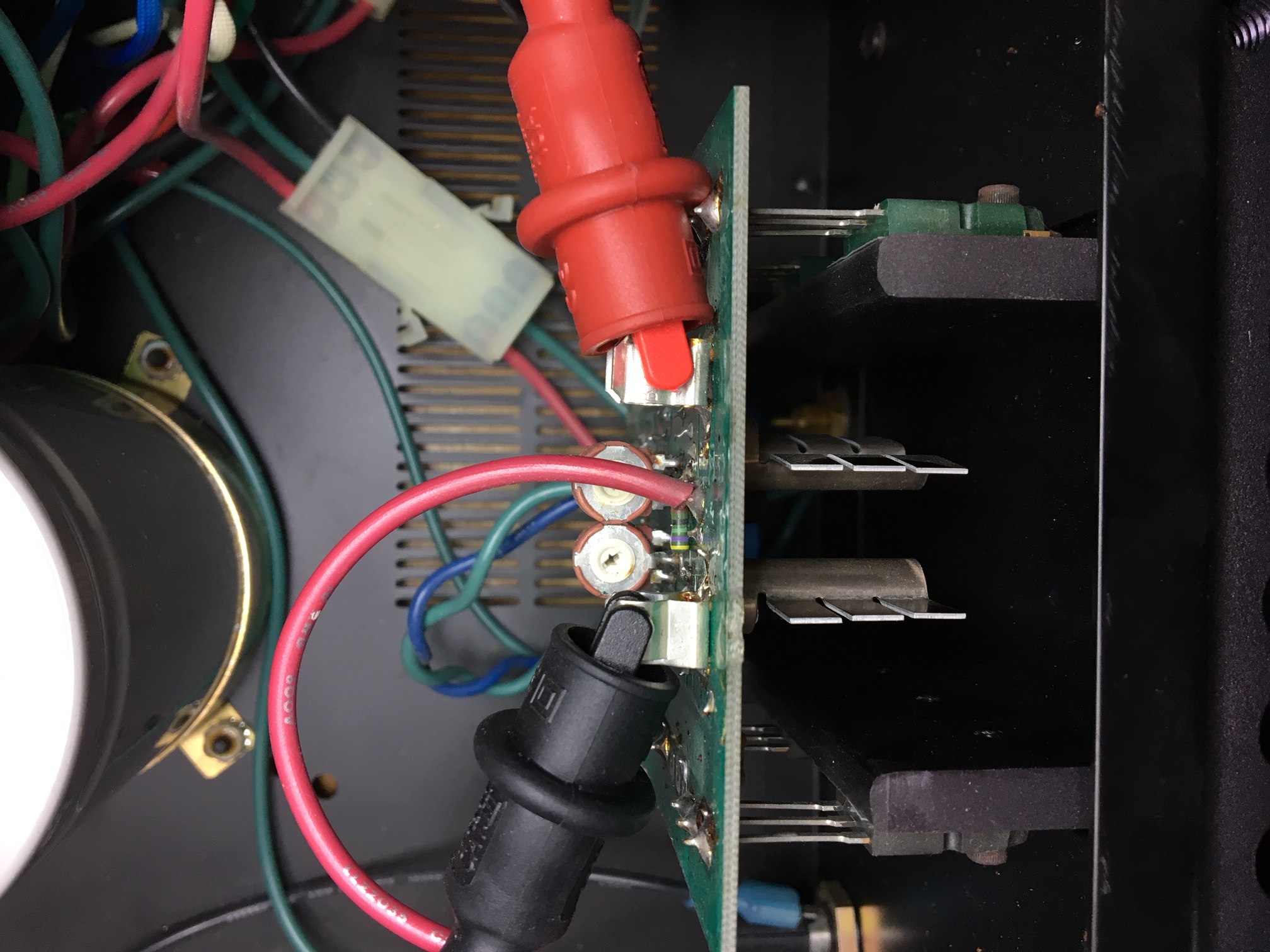

if you have an ampere meter, you remove a power supply fuse and then replace the fuse with the dots on your multimeter to Ampere dc
I just want to confirm ... using my DMM set on VAC, can I clip the probes on the fuse holder to act as the resistor? I'm guessing "dots" mean the probe tips?
The B&K instruction sheet mentions connecting an 8 ohm load to each channel ... is that just connecting a preamp to the input? Is this without speakers hooked up?
I ask since I have to power up to a variac to do this, and I may put my dim bulb tester in between just in case.
Pics below show my probes clipped to fuse holder ... and meter set to VAC. Ignore the reading. The amp isn't plugged in.
B&K instruction pdf says:
1. Plug the amplifier into a variac. Monitor the (-) negative rail of each channel by removing the fuse and placing a current meter across the fuse clips.
2. Connect an 8 Ω load to each channel. Supply an input signal of 100 mV RMS @ 20 Khz. I don't have equipment for this part of #2.
3. Slowly turn the variac up to operating voltage while monitoring the rails for excessive current draw. The meters should not read more than 400 mA DC. If one or both read more than 400 mA, turn the bias pots (P2) to minimum and retry.
4. Set bias of the amplifier by adjusting the bias pot (P2) mounted on the solder side of the board to achieve a reading of 200 mA on each channel for models ST 140, ST 140M, ST 202, and ST 202+. The bias for the Pro 600, EX 442 and M 200 amplifiers is 250 mA. Setting the bias higher than stated only causes the amplifier to run hotter and burn out faster. It does nothing for the sound quality of the amplifier.
5. Set the DC out of the amplifier by monitoring across the outputs. Adjust the DC pot (P1) for 0 VDC ± 5 mVDC.
