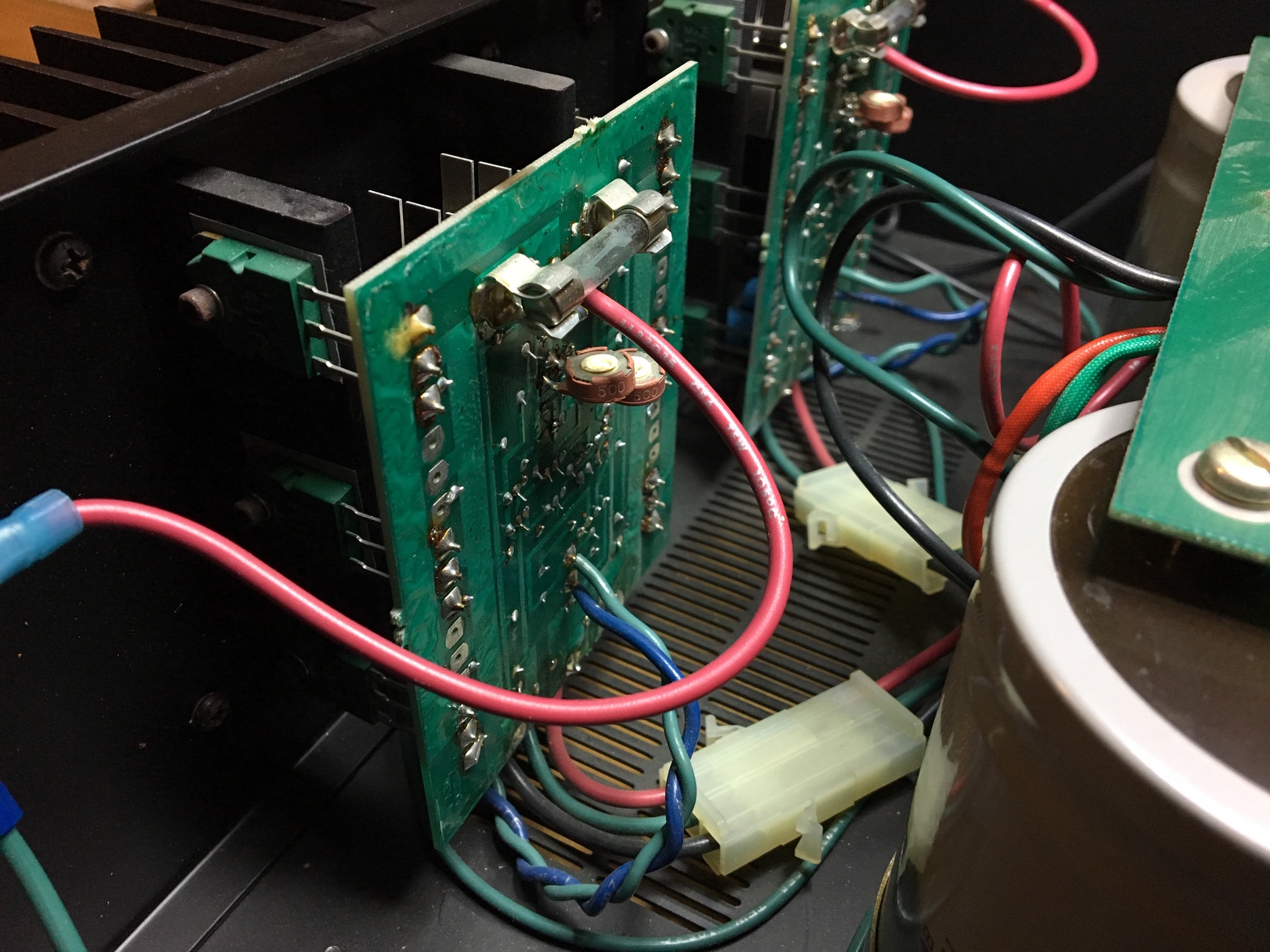

Here is a pick of the connector the tech unplugged ... it's the lines going from filter board to output stage.
In the picture below, it's the white plastic connector. This picture was before going to the tech. I don't have a shot yet of it unplugged, but that's really not necessary at this point.
One other thing ... I'm thinking to be a good steward of this fine piece of audio history, I should replace the power filter caps for longevity. Even if they are "good". Any recommendations? This is one area I don't feel like I have to go for boutique caps ... rather, anything that will be at least equal with original parts.
