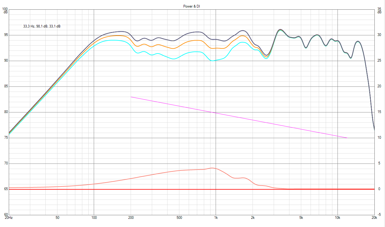

Here are normalised directivity measurements for DE250 in PTWG
Source: Red Spade Audio: Waveguide shootout 2 - measurements

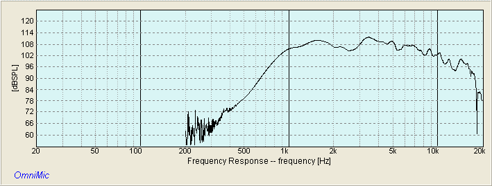

Hi sheeple
Just saw your post.
I've attached a new plot of the DE250 with the PH612.
This is the RAW response. No crossover and eq was used.
Taken on axis, mic at 24 inches.
Hope it helps.
Mike
https://www.diyaudio.com/forums/att...3943-de-250-frd-zma-questions-de250_ph612-gif

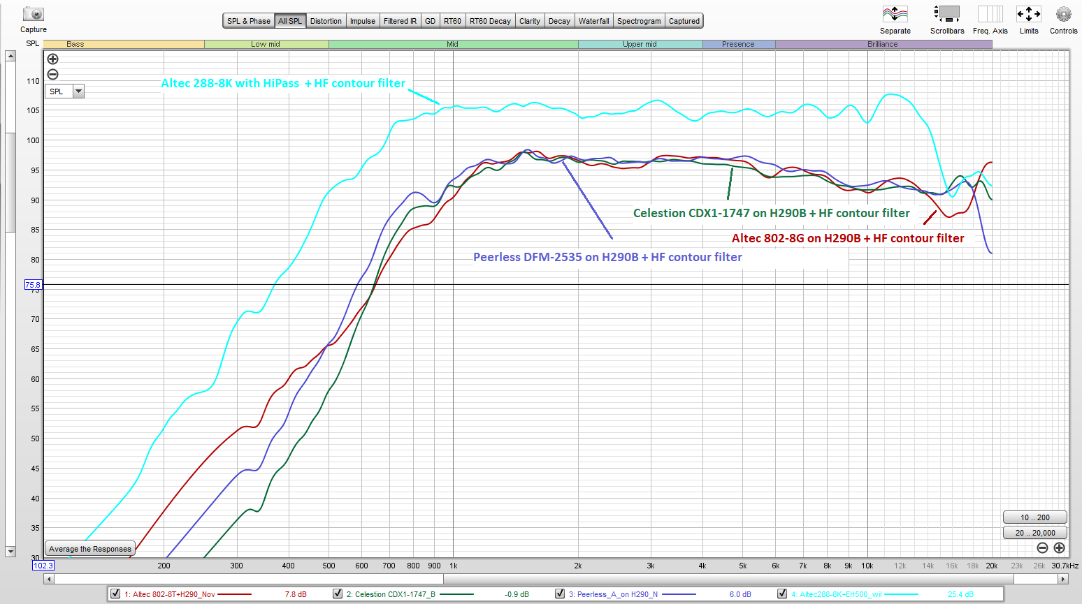

Here's a pic showing 3 different drivers on one of my H290 horns .
One will not ( typically ) find an Altec driver performing this smoothly on Altec's own "Sectoral" horns .
- The reason for that is the large vanes in the sectorals create chaotic diffraction effects which adversely effect linearity of the response ( seemingly this affects metal diaphragmed drivers the most ).
It's worth reading Joseph Crowe's blog on his results obtained from measuring a TAD 2001 on an Altec 811b vs his own ES-600 BiRadial .
Truly worth noting is that many many people love their 811b horns ( especially in their Altec M19 speakers ) irrespective of any response anomalies ( this fact drives many pure "hornies" nuts ) .
