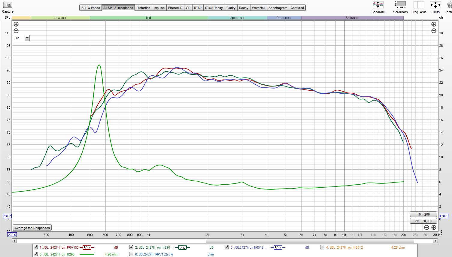

FYI, I also tried 30 ppi foam ( 1.25" deep ) filling the "tube".
Here's what's achievable on that JBL waveguide ( as well as 2 other horns ) when one uses a driver with a low Fs and which has a builtin threaded snout.
This same driver on 3 different waveguides produces ( statiscally ) just about the same response.
The "tangle of traces" makes it very hard to see but the H290 does arguably have the most linear response ( fwiw ).
- The traces are from 2016 thru to 2018 .
Similarly, here's a trace of a JBL 2425H ( + a Celestion ) on one of my 18Sound 1464XT horns.
Both drivers perform equally well on this waveguide and would afford a 700hz ( ish ) crossover point ( for home use ) . Check out the distortion specs.
Ya know, just to muddy the waters.

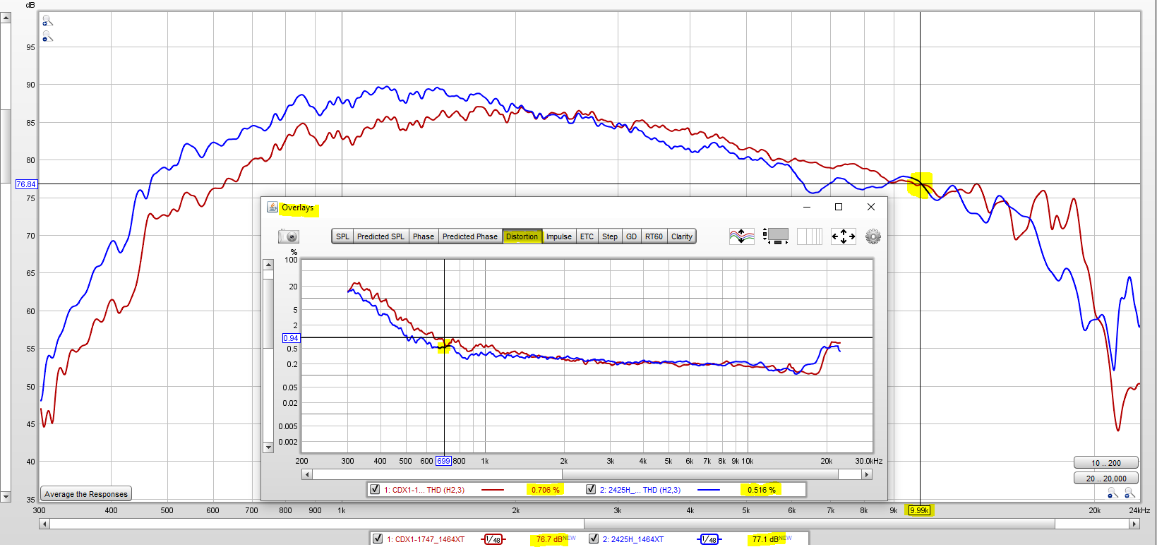

Maybe in theory but that doesn't seem to be borne out in practice .
Both QSC ( Pro ) and DIYSG use the Mylar diaphragms in the Celestion drivers that they implement in their products .
I honestly can't tell the difference between a 1745 and a 1747 ( at home listening levels ) when the crossover point is above 1500hz.
The 1747 does go a bit lower ( likely due to the diaphragm being a bit more pistonic/stiffer at the lowest range .
Distortion specs can be really misleading // I make mine at home listening levels ( I never listen above 80db ) .
Distortion is quite inaudible to me until it gets past more than 3% ( 3rd HD ) .
I mostly have a quick look at the distortion profile of a driver to make sure it's diaphragm is properly installed//centered ( when it's not, the distortion traces will typically display this as the odd order harmonics being elevated above the 2nd HD in random regions ) .

You maybe have a measurement of the Celestion 1747 on H290? I would like to see how it works.

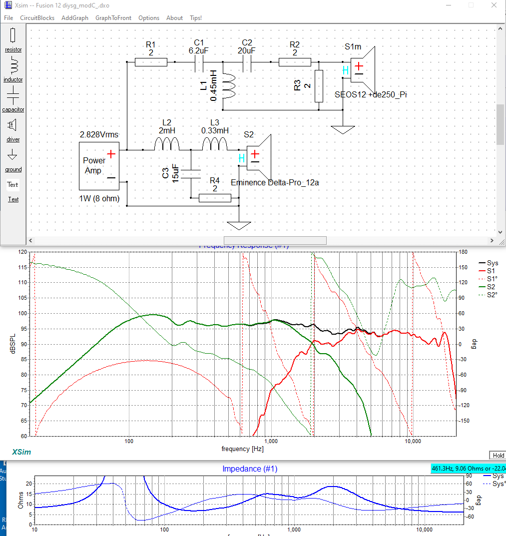

@sheeple
Okay , here ya go ( plus bonus frds + zmas for the small Peerless driver and an Altec 802-8T ) all measured on the H290B BiRadial ).
This is an XSim file ( with the frds + zmas embedded ) from an Altec project that I'm currently involved with ( the file location waylaid me ).
Download the XSim exe > open my attached file ( within a newly created folder that you are confident that know the location of ) > Save the file > Close XSim and upon closing, the XSim software will create a new "DATA folder for frd + zma files" and has extracted ( + placed ) all the frd's + zma's used in the original .dxo ( XSim ) file into that new folder .
I would recommend against the ECM8000 and instead suggest you get a calibrated Dayton EMM-6 from Cross Spectrum Labs .
- One wants a calibration file that's recognized as being accurate ( which leaves out the Behringer ).
Also, You really ought to be studying the designs + words of the late Jeff Bagby ( RIP ).
He designed the "Tempest" Fusion12 and the Zepher for DIYSG using Eminence 12" woofers.
- His observations on both those designs are words ( that I feel ) one can take to the bank.
- Your rush to order the Eminence 3012LF is a bit hasty and premature ( IMHO ).
- One eWaver ( over at AK ) who has both the 3012HO and 3012LF ended up preferring ( by a far margin ) the mids of the HO over those of the 3012LF.
For him it was a matter of choosing his poison.
- JeffB's compromise ( with the Delta Pro 12a seems a better way forward from my perspective ).
Read Jeff's Words Here!
The crossover workings of the "Tempest ( Fusion12 ) " was recently unraveled HERE!

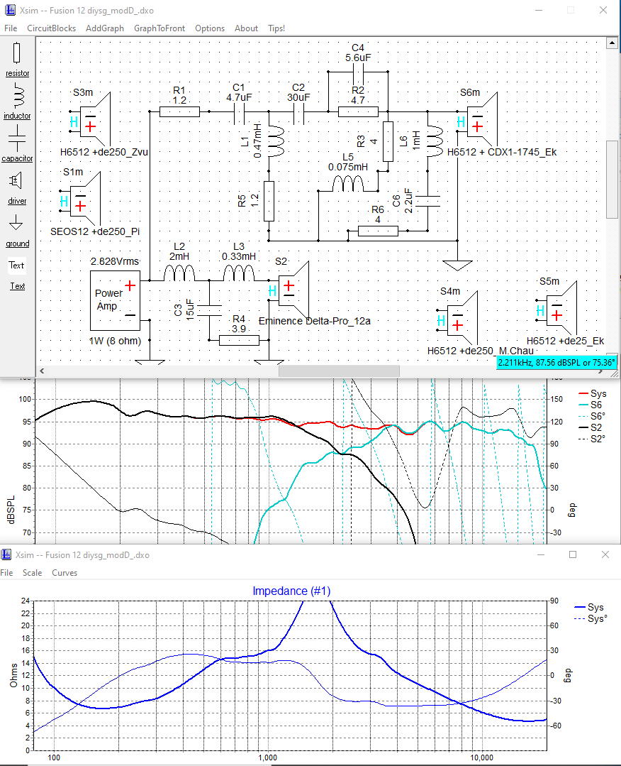

I've also uploaded an XSim file that has a bunch of different drivers on the H6512 horn ( for you to play with ).
Some of the responses were created with my own drivers while some are traces or files from other contributors within this thread.
The upshot here is that to use the H6512 is quite doable ( one will just need to be creative in the crossover design ).
Within XSim, simply swap in one HF driver for another ( drag + drop ).
Then play with all the included passive elements ( some are needed while some aren't >> it all depends on which HF driver is being used ).
- "Right-Click" on any passive to either Engage it ( Normal ) , Short it out , or Open it ( break the circuit ) .
- Clearly Jeffs network design was the core beginning to what I've posted ( I just had to add in a couple "Kitchen Sinks" to tame the H6512's ripples.
Have Fun!
