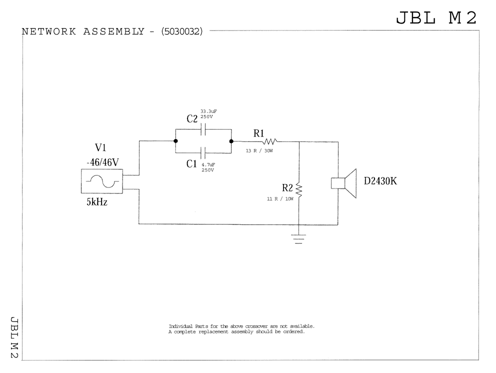

One thing though. You are making high eff two way so you might have to use some passive attenuation for tweeter. Given that it is about 107dB raw, you don't want to destroy S/N ratio. I'd also advise a largish capacitor in series with tweeter - for safety reasons. JBL M2 uses about 30uF if i'm not mistaken, but you check at LH forum anyway.

Yes, MKP is good enough. Value is largish so it doesn't influence their tweeter lower end response given that it is crossed at 750Hz.

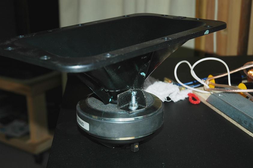

Lately I was in doubt whether it was too smart to ditch the Dayton PH6512 JBL-clone Progressive Transition waveguide for an exponential horn. I almost wanted to get myself a CNC'd custom-build done but that is probably rather dumb. But when I departed from the JBL-clone Dayton, it was because of the ditch in the lower frequencies and there was the assumption it could be caused by the straight tubing of the screw-on. Now when I was searching the Google image search for the older, bigger PT-F95HF I found someone over at the audioroundtable forum who actually sawed-off the thread-on section (image attached). Can this improve the performance? I was wondering whether JBL would not have optimised the waveguide for the thread-on section an its removal cause more problems than benefits. Anyway it is tempting.

I finally found out the reason why ...
... that JBL waveguide produces it's own roller-coaster ( peaks + dales ) to the response ( I think due to the reflective knuckles built into it's expansion profile ).
It is all resonance. Zilch actually got Earl Geddes to meassure the smaller, thread-on JBL waveguide, and it happened here at diyaudio: Horn vs. Waveguide Just out of curiosity I would appreciate if someone has the summarized findings file that he offered for download on his website but that is not online anymore, as mentioned in thread where the meassuring originated B&C Compression Driver and Horns It should follow the name "Horn VS waveguide.pdf"
In short, Geddes had to say the following:
Per an agreement that I made from another thread, I received, measured, and evaluated a very inexpensive JBL horn ... .
As I said before, this is not a waveguide, it is a diffraction horn. It acts just like every other diffraction horn that I have measured and nothing about the measurements that I got surprised me.
And now what EarlK said ealier in this thread here:
Lots of people like the sound of these // and that's what's important ( at the end of the day ).
My question to the experienced is: If the JBL (clones) is only a diffraction horn and it features considerable resonance, how does the Emimence H290B compare? As an exponential horn it does seem to be much smoother, no resonances there. What is the trade-off? What is it's defficit?

I understand. How did Wayne Parham got the H290B to work so well then with his designs? His directivity meassurements always looked quite good. Is this specific exponential horn different?
The H290B is different than a usual exponential horn in that it uses an oblate spheroidal / elliptic cylindrical flare profile in both the horizontal and vertical planes, with a mouth radius borrowed from LeCleach.
Wayne explains here:
AudioRoundTable.com: Pi Speakers >> H290C Horn/Waveguide
