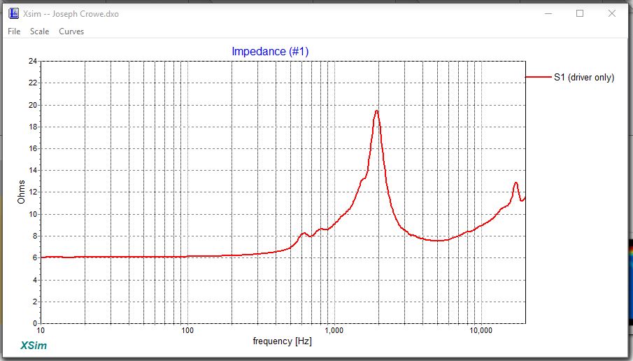

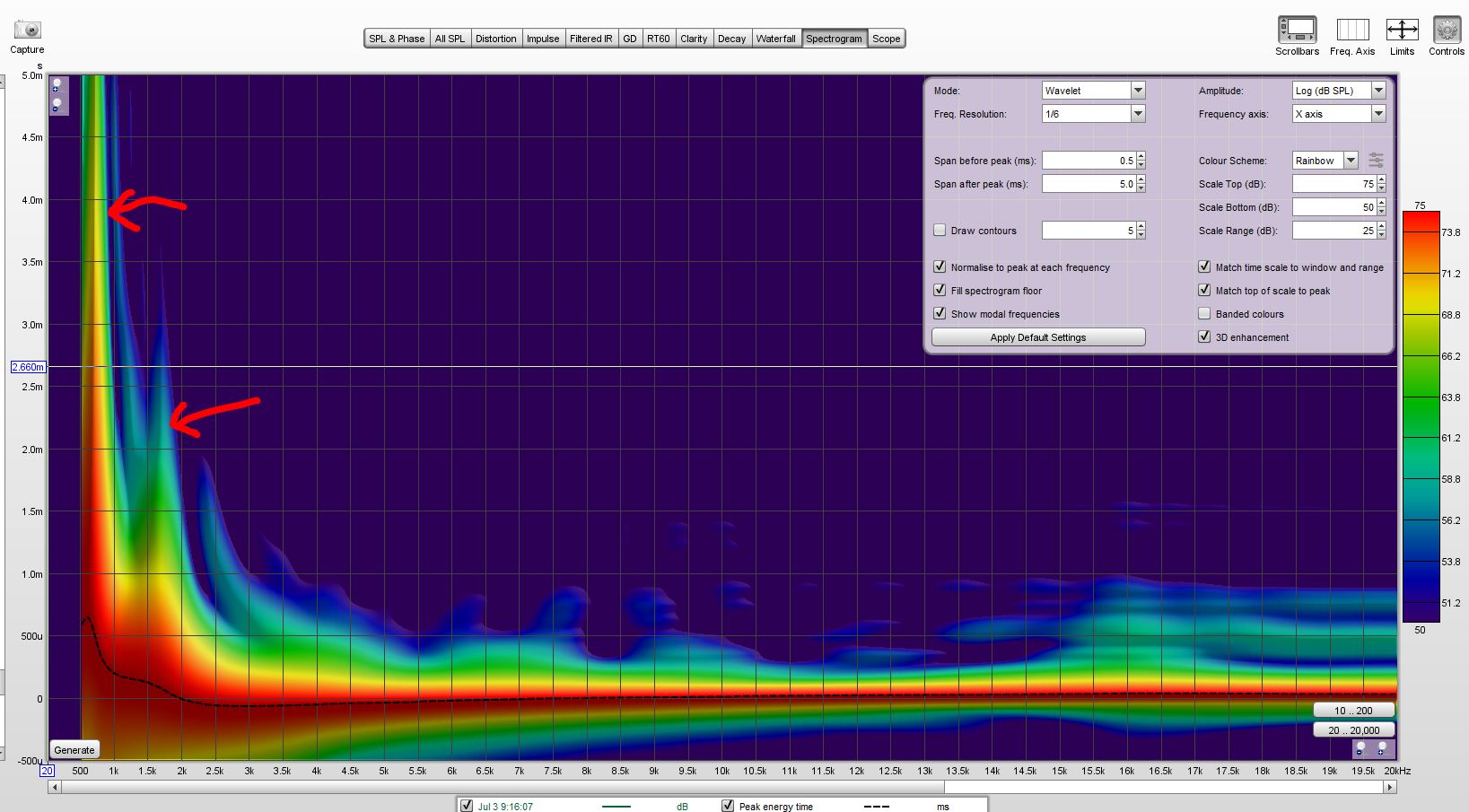

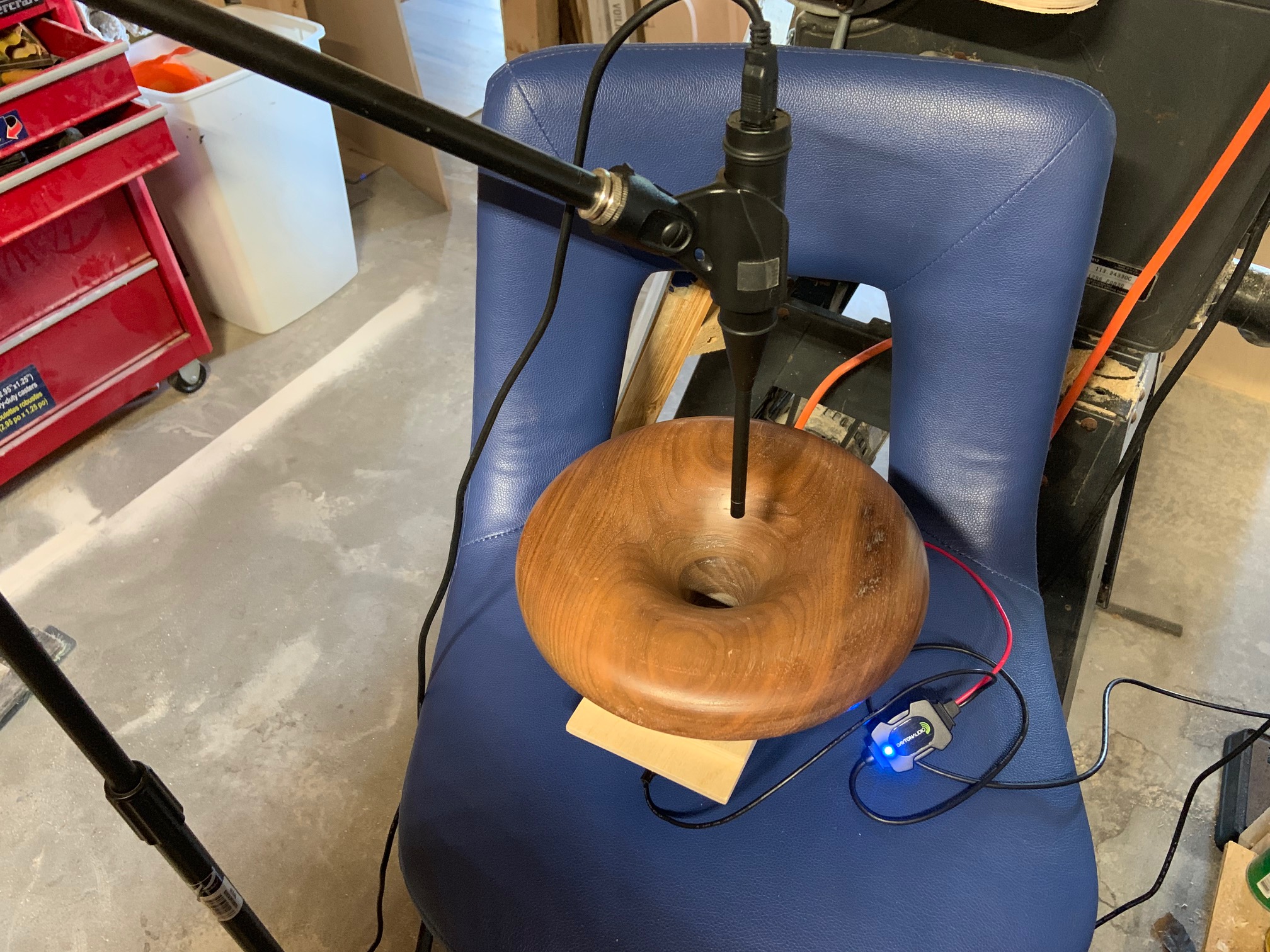

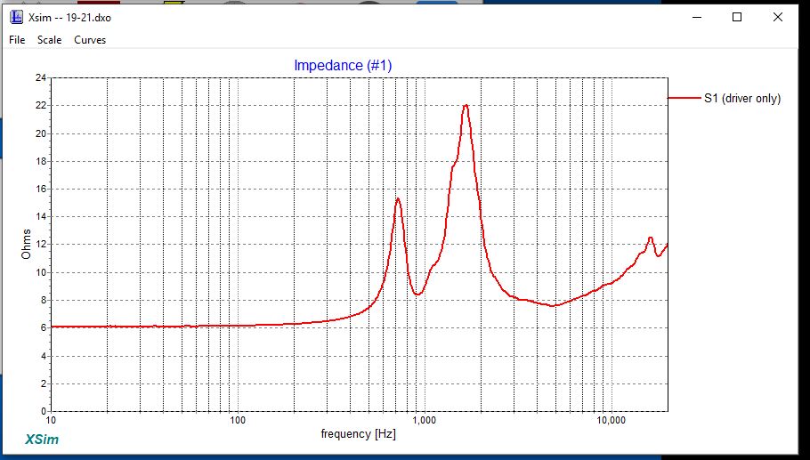

I understand what you are saying. It's my pet peeve as well when people make claims that are not backed up by measurement (conjecture). I just felt that it was clear from the published manufacturer's specs that the driver diaphragm has resonance as high as 1.8kHz as indicated by the impedance curve. While I can't speak against what others do with the DE250 I can only show you what my observations have been with the DE250, as well as other friends that have attempted to use them but were disappointed by their performance below 2kHZ. I've attached pictures of my impedance measurements, as well as my friend's measurements. I've also attached a picture of the test setup...Dayton UMM6 with DATS V2 to get the spectra measurement (which is also shown below). This shows clearly stored energy just below 2kHz...wavelet scale for the time axis...which shows that decay is not quick enough at 1.8kHz since modulations should have a dynamic range of at least 25dB which it clearly does not. Decay at 1.8kHz takes around 3 cycles to fully decay...so not audiophile quality.

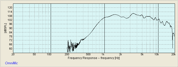

I tested the DE250 with various horns.
Click HERE for more info.
There is a Pyle PH612 right at the bottom of the page.
I believe it's the same horn as the H6512.

Hi Mike, thanks for the curves, very nice! A beginner's question: Which db-level-graph is to be used in conjunction with the other Ecnowave driver, the Eminence KL3012LF? -1,5db? Or do I have to raise the graph to match the Eminence factory data taken from their product sheet? (I used FPGraphTracer)

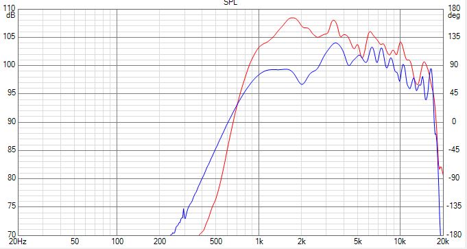

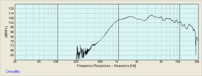

Thank you both Earl and Zvu. I did follow your instructions Earl and generated a frequency response file, using Mike's -1,5 db meassurement in vituixCAD and setting the amplitude to 108,5 db. This is 14,5 db higher than the graph of the meassurement, so I accordingly bumped the low end from 40 db to 54,5 db. I don't even know if one can do this in a logarithmic scale? Anyway, the graphs are there, very satisfying, yet if compared to one another, one can see considerable differences. Red is the file created from Mike's meassurement, blue the data Zvu kindly provided. Probably the error is sitting in front of my computer, I don't know:
I don't follow what you're referring to.
- It doesn't matter though.
Zilch's frd's for ( raw ) woofer ( located over at TechTalk in his thread called Flex Your PCD Mettle ) are usually pretty close to manufactures spec. .
- If they are off, it's usually only a few db requiring a small bump-up in the crossover software.

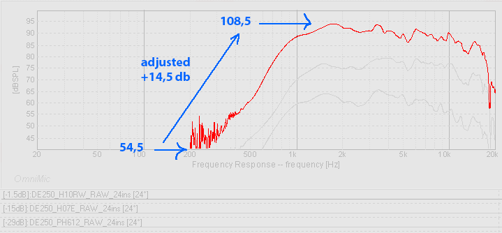

Sorry Earl, I didn't explain it very clearly. I meant the compression driver's low frequency, which Mike meassured down to 40 db at around 200 Hz. If I set the high amplitude as 108,5 dB, I do have to adjust over the whole frequency range too, right? This is at least what I thought. So I also set the scale at the bottom 14,5 db higher before I extracted the SPL. An illustration:
