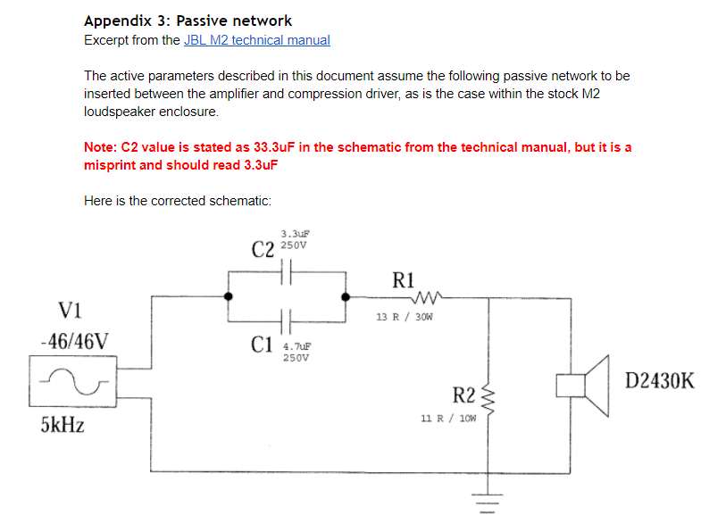

JBL M2 crossover - Google Docs
On the CD protective circuit: What is the benefit of two half value capacitors vs. one full. i.e. 3.3 + 4.7 vs. 8 uF? Is this a security feature in case that one cap fails, the other is still there? And the different values would also lead to one cap failing before the other? Or is it for bypass/sound reasons?

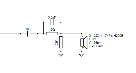

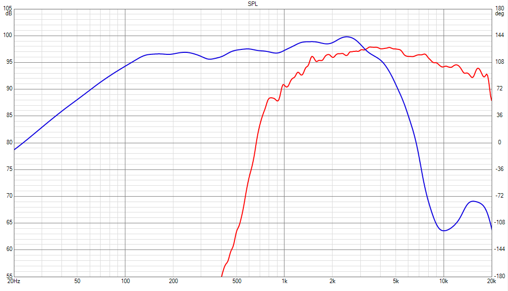

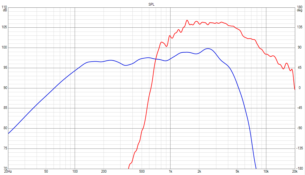

I may have found a used pair of hypex plate amps that I can afford. While I've been waiting, I figured out the following values for the analogue tweeter protection (capacitor 10 mF) and equalizer (to reduce noise). Would someone like to critizise what I have been thinking?
