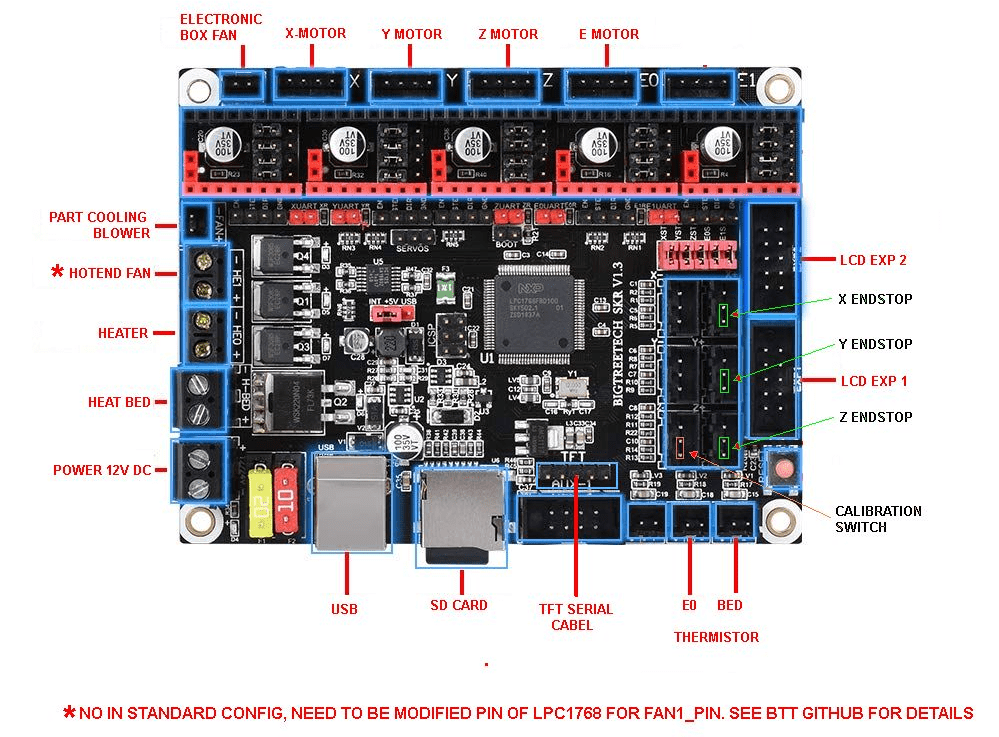

I'm working on a prototype now 🙂 got a BTT SKR 1.3 board with marlin and a stepper attached. Python script now takes command line arguments and saves to a log file and also connects to control board and issues a currently prr programmed command.
I just need to figure out exactly what commands arta will need to send and then covert to exe.
A nice thing about marlin is it can use s curve acceleration which doesn't wobble the turntable as much. Plus of course TMC silent smooth stepper drives.
I believe this should work. It currently turns a motor sitting on the floor 🙂 Connects by USB to the PC and auto detects.
All the setup for the axis itself such as speed, acceleration, limits and homing switches happens in Marlin firmware. There is looooads of videos and guides on setting up Marlin online. A lot of it can be done without having to compile the firmware, just connect to the mainboard using pronterface.exe and set and save the settings.
I'm using the BTT SKR 1.3 that costs about £20. You'll need firmware for it (Marlin) I'll share a compiled firmware later.

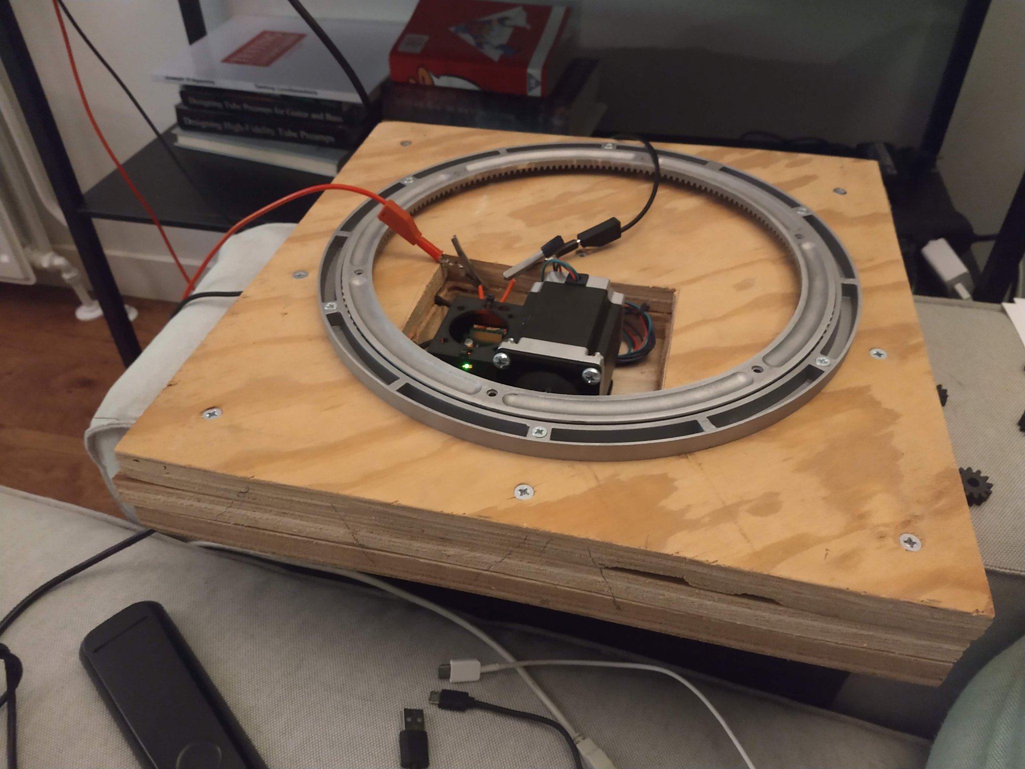

@jcga I hacked together a (half) prototype:

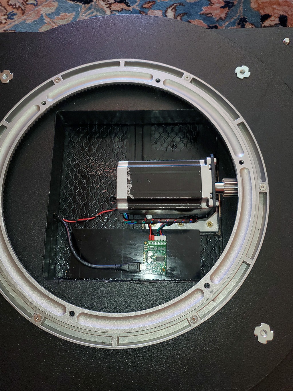

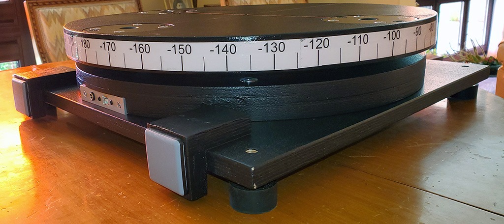

Now I have some additional questions...
  • Do you have some adjustable feet on the square bottom plate to level it?
  • What are the teenuts for?
  • How do you attach the top plate? Is it just held in place by some pins and gravity?
  • Does your stepper motor also make a lot of noise when moving?
  • Where is you power supply located?
  • Are the 4 circles with holes in them for cooling?
  • Is your stepper mounted to the bracket with 2 bolts only? If not, how did you get the bottom ones in and tightened?
  • What do the electrical connections look like? Do you have a panel where you can plug in a usb cable and power for the stepper? Or do you just have some wires permanently attached to the rotation device?
  • Do you have any means of adjusting the position of the stepper to make sure the gear is position correctly wrt the 'lazy susan'?
Reactions: Kravchenko_Audio
Sorry for the delay but I was on travel, just back home now
Yes
To fix the bottom plate (18 mm birch plywood
Of course not, I Tapped M6 in the original hole of the sleewing ring and top plate (2x18 mm thick) are locked via M6 screws. I did this to easily fine adjust the stepper motor gear
Yes, quite noisy but it is not a problem for the measurements
I use an external 9A/12V power bloc from some old laptop (easily found on Ebay)
Yes, it is for cooling (not really necessary I think but to stay on the safe side)
No, due to the force in presence, I highly recommand to use all the 4. You are right, it's not that easy but it is feasible
see pictures
  • power for the stepper? Or do you just have some wires permanently attached to the rotation device?
The stepper motor is fixed on the bracket, the whole thing is fixed on a 5 mm thick alu plate on the bottom plate in a recess by six scews. Exact position is determined in situ with everything in place but the top plate , the recess depth has to be determined after the slewing ring is fixed. on the bottom ring (2x18mm in my case)
In short I have bottom platform (18 mm), bottom rings (2x18mm), slewing ring, top plate (2x18mm) !
Hope this help

Thanks @jcga! I was thinking of 3D printing stuff with places for nuts to be inserted. You've realised the same using teenuts and tapping holes.
I really like 3D printing stuff, but I still have a lot of problems designing stuff in Fusion 360. It's getting better, but even though I think I get the concepts, I just can't seem to actually realise what I have in mind. I was thinking of a circular support below the 'lazy susan' consisting of 3 circle segments that could be customized for a particular preference. So one could choose one segment with just a hole to feed the cabled to the tic or one with a connection plate like yours. Or mounting holes for a connection plate customized for you needs. Banana plugs for a lab power supply, laptop connector for someting like you power supply. And I think it could also simplify mounting all 4 bolts on the servo/bracket. You could first place & tighten those and place the circle segment later giving you better access to the bolts. But up to this point I've mainly been cursing at Fusion....

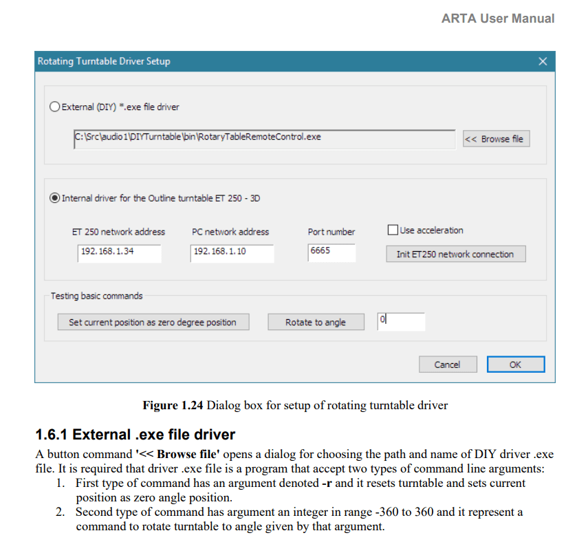

Tom, I'm not sure to fully understand the concept but in my case, I started with the original Arta application note (with the DC motor) first, later I switch to another motor and finally upgraded to the Tic/Stepper/your_soft state.
Again, if I had to start again from scratch, I would certainly use the original Fluid idea: strong enough belt, 3D printed counter plate, Tic/Stepper/soft. Much easier to handle adjustment, quieter, easy to find suitable slewing ring...
