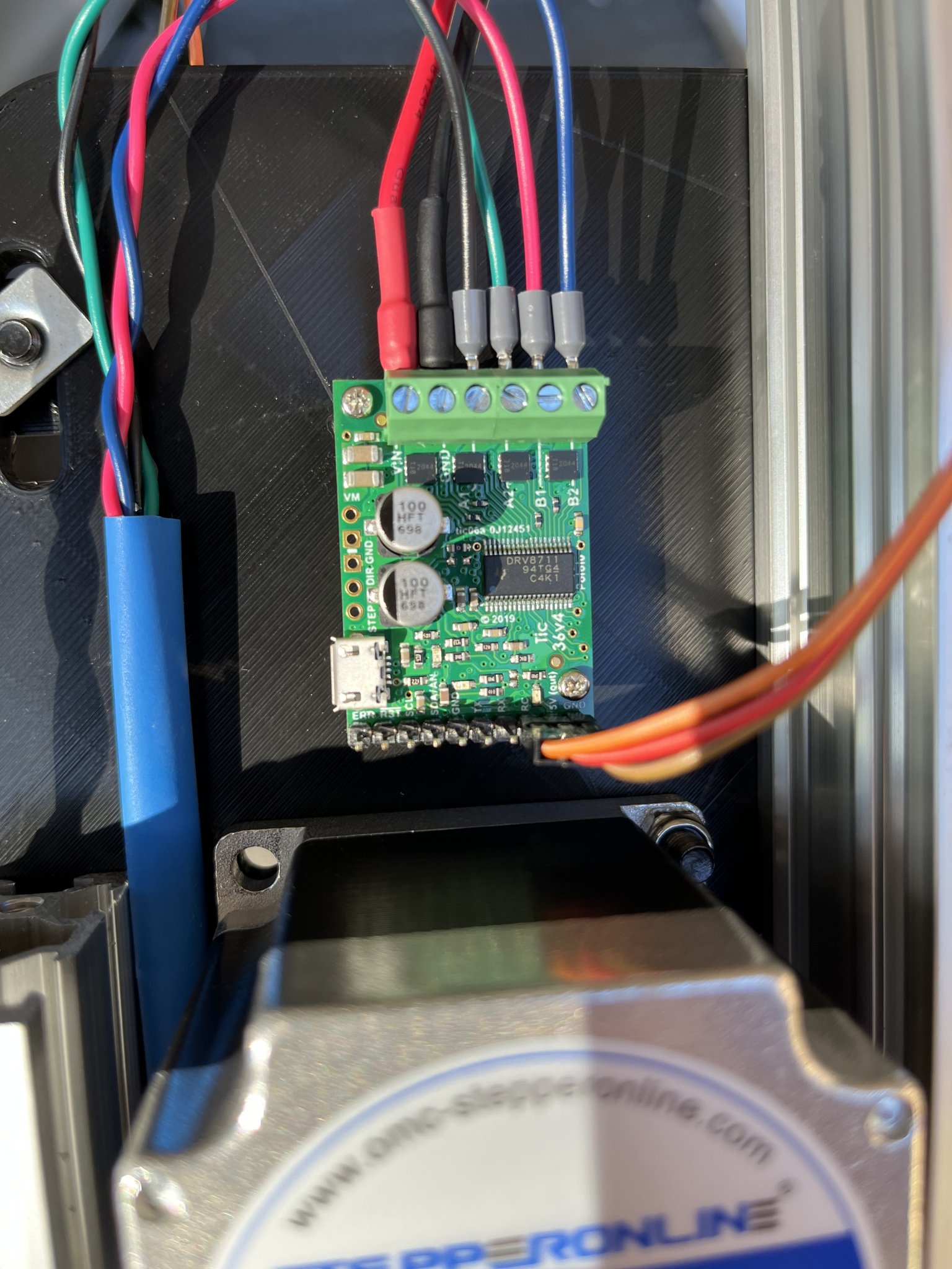

This software was created to control a Tic stepper motor controller from Pololu via the ticcmd command line utility. ARTA sends commands to the turntable driver exe which interprets and passes the correct commands to ticcmd.

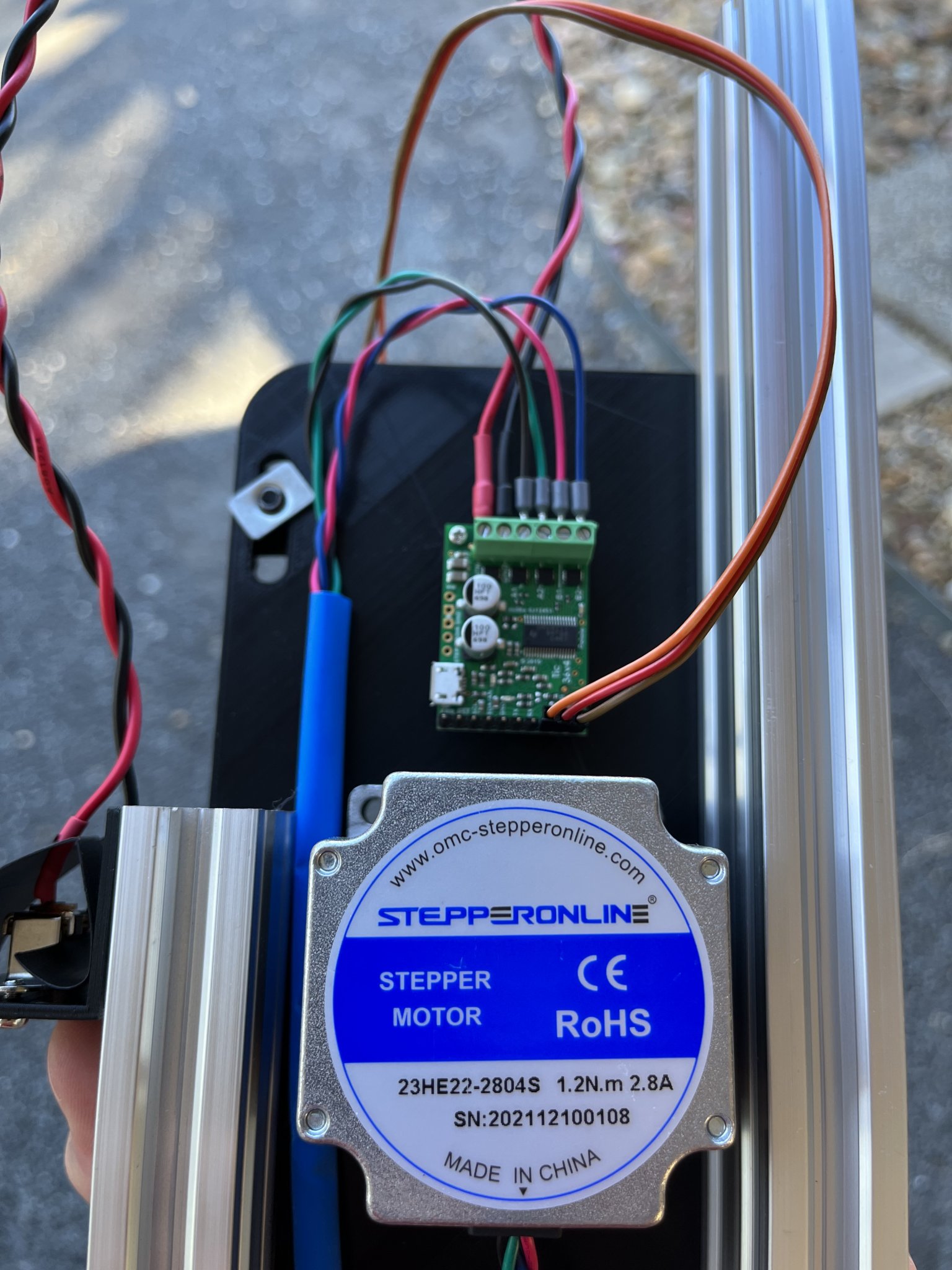

I have chosen to use the Tic 36v4 as it has the maximum current capacity (4.0A without extra cooling) and a NEMA 23 stepper with a 2.8A maximum current rating. These are probably overkill in most circumstances but I wanted to have the option to move heavier loads. In theory if the friction can be kept low enough these components can move more than 100Kg in the configuration I am building.

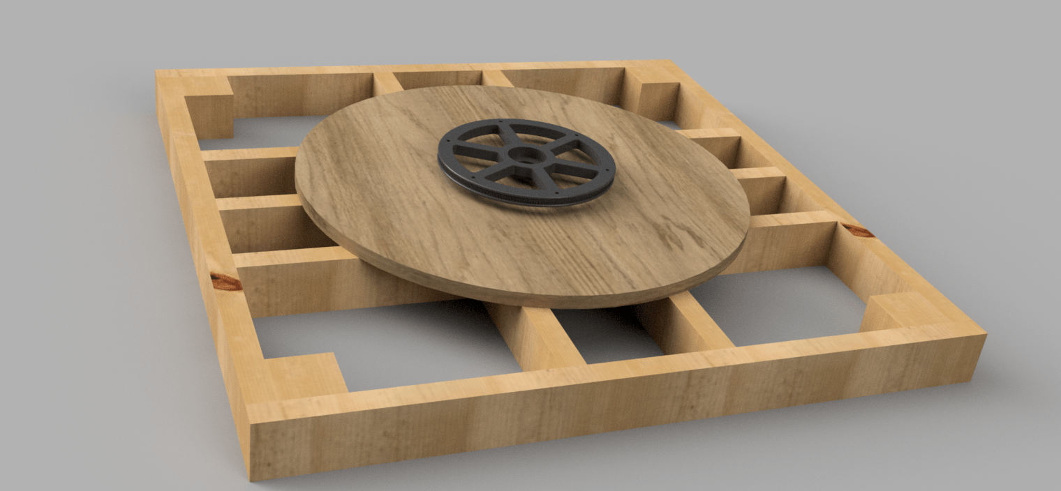

My setup will use two 600mm pre cut red oak circular table tops with ball castors in between. The red oak was chosen as it was stiff, solid and on special for on $10 AUD each.

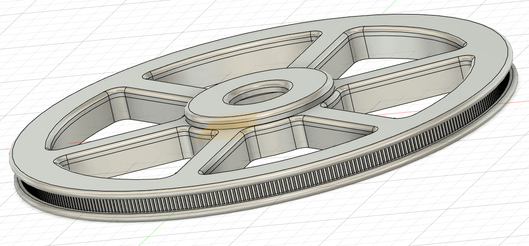

The gearing will be a 360 tooth GT2 main pulley mounted to the table top underside with a 20 tooth pulley on the stepper with a closed loop GT2 belt. Very similar to that in the above measurement platform article. Underneath there will be a pine base frame to aid in stability with levelling feet.
The pulley I have designed contains a 1" bearing that fits a 1" OD Aluminium tube piece used as a centre pin. I wanted to make this solid and low friction so the large bearing and tube seemed to fit the bill. I will make the pulley STL available once I have printed and tested it to make sure it works.

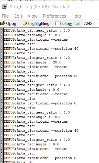

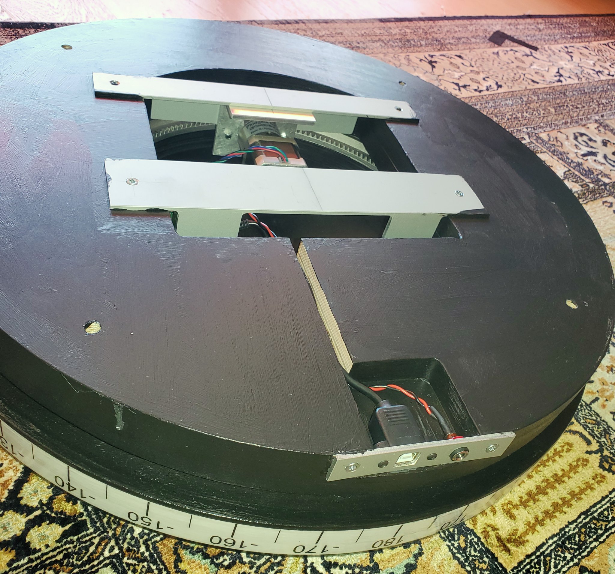

I have made a prototype without gears that functions as intended. I was able to make a 0 to 180 (10 degree increments) set of test measurements with ARTA on my laptop that took only a few minutes to complete.

I went through a couple of different mechanisms before going back to belt drive. The final outcome can be seen here https://www.diyaudio.com/community/...-motor-and-tic-controller.387325/post-7776912

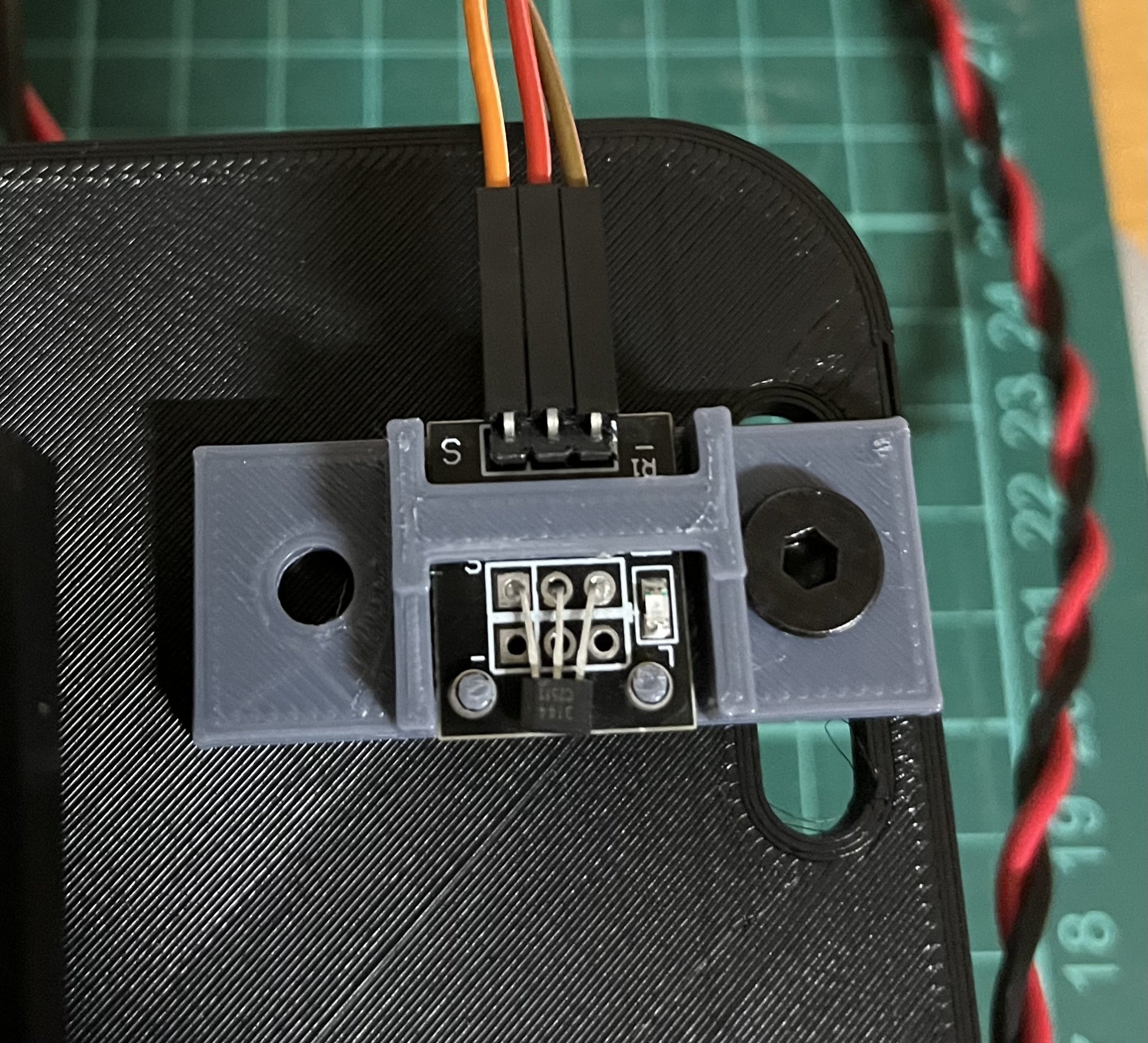

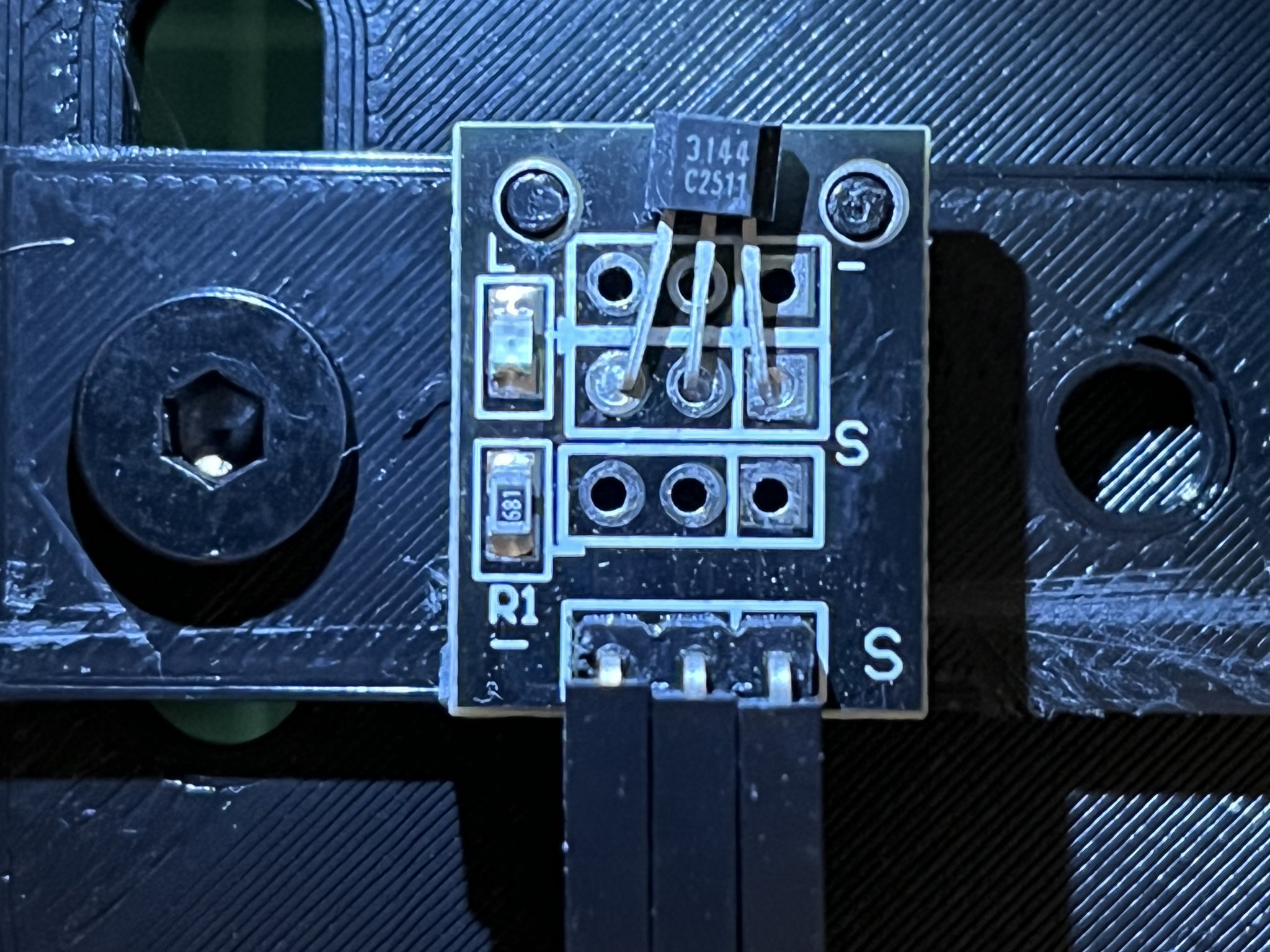

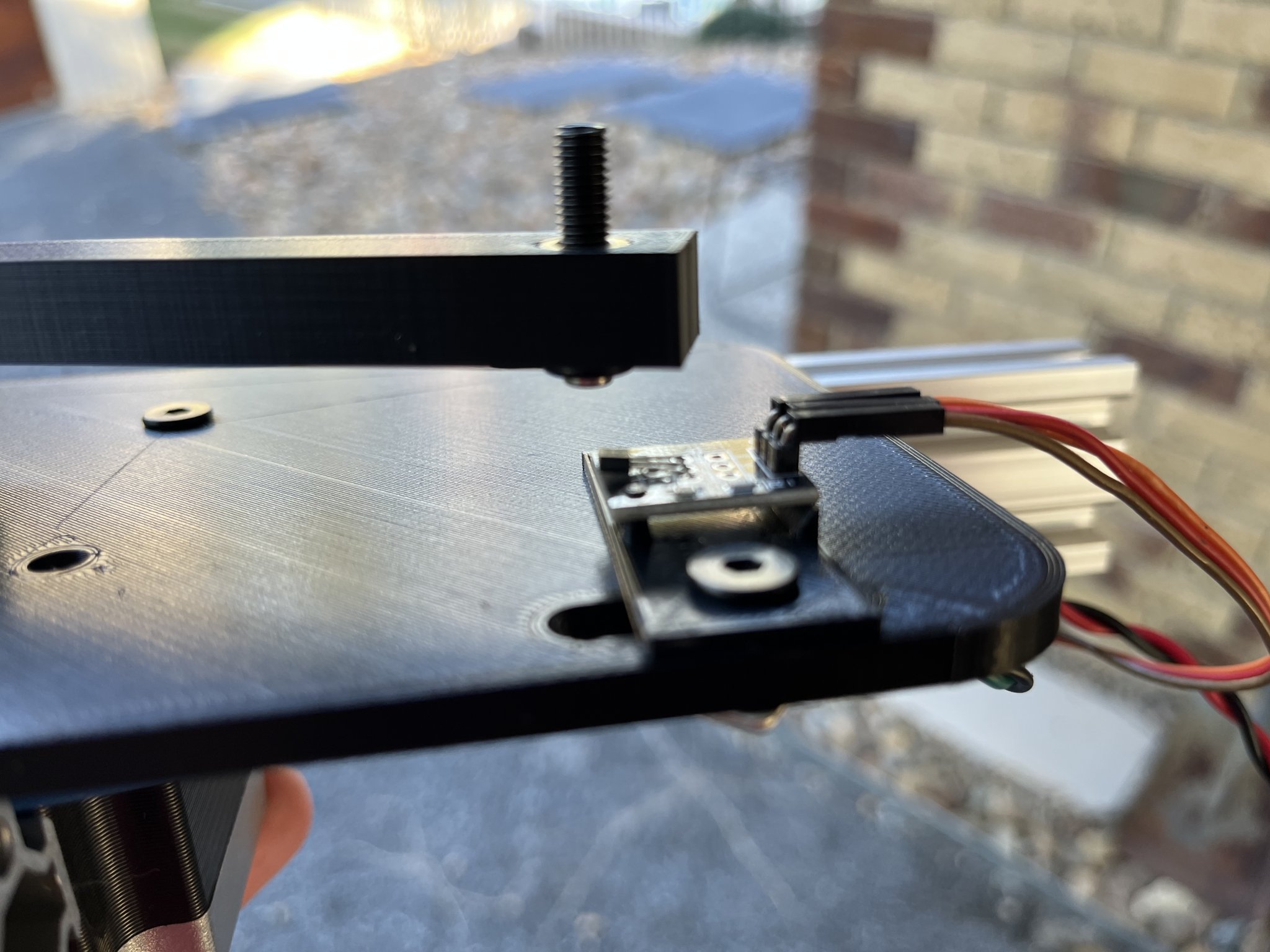

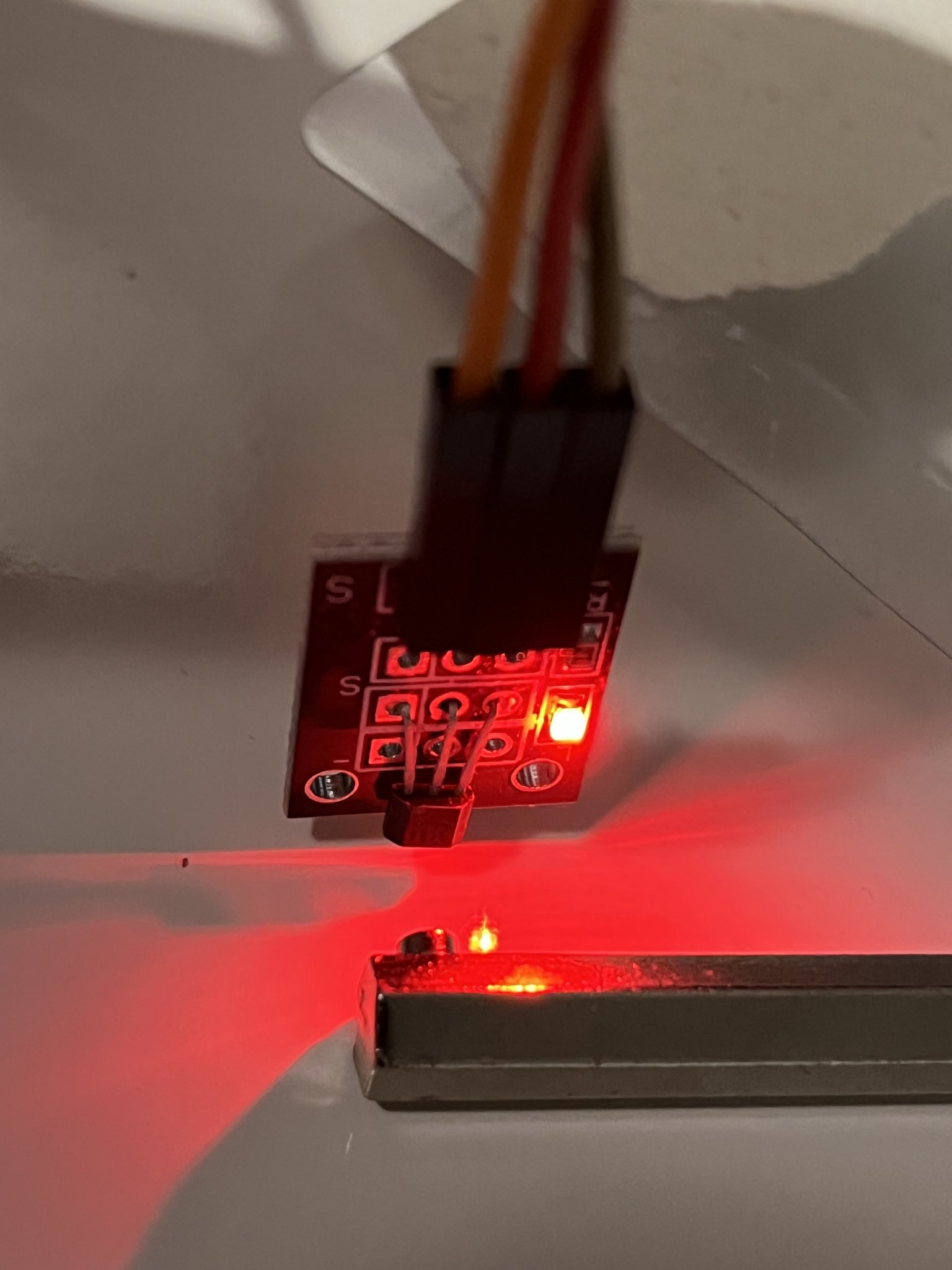

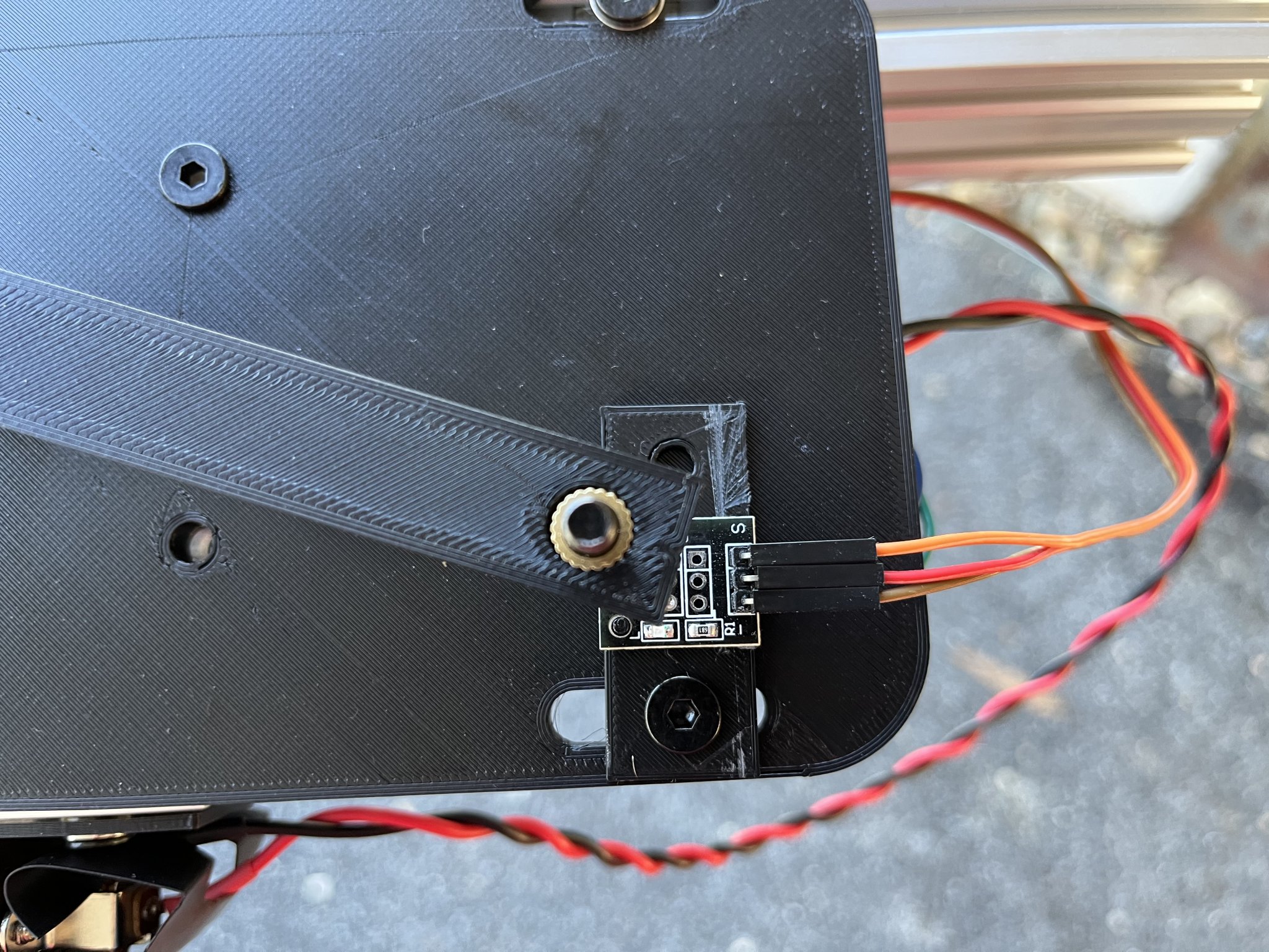

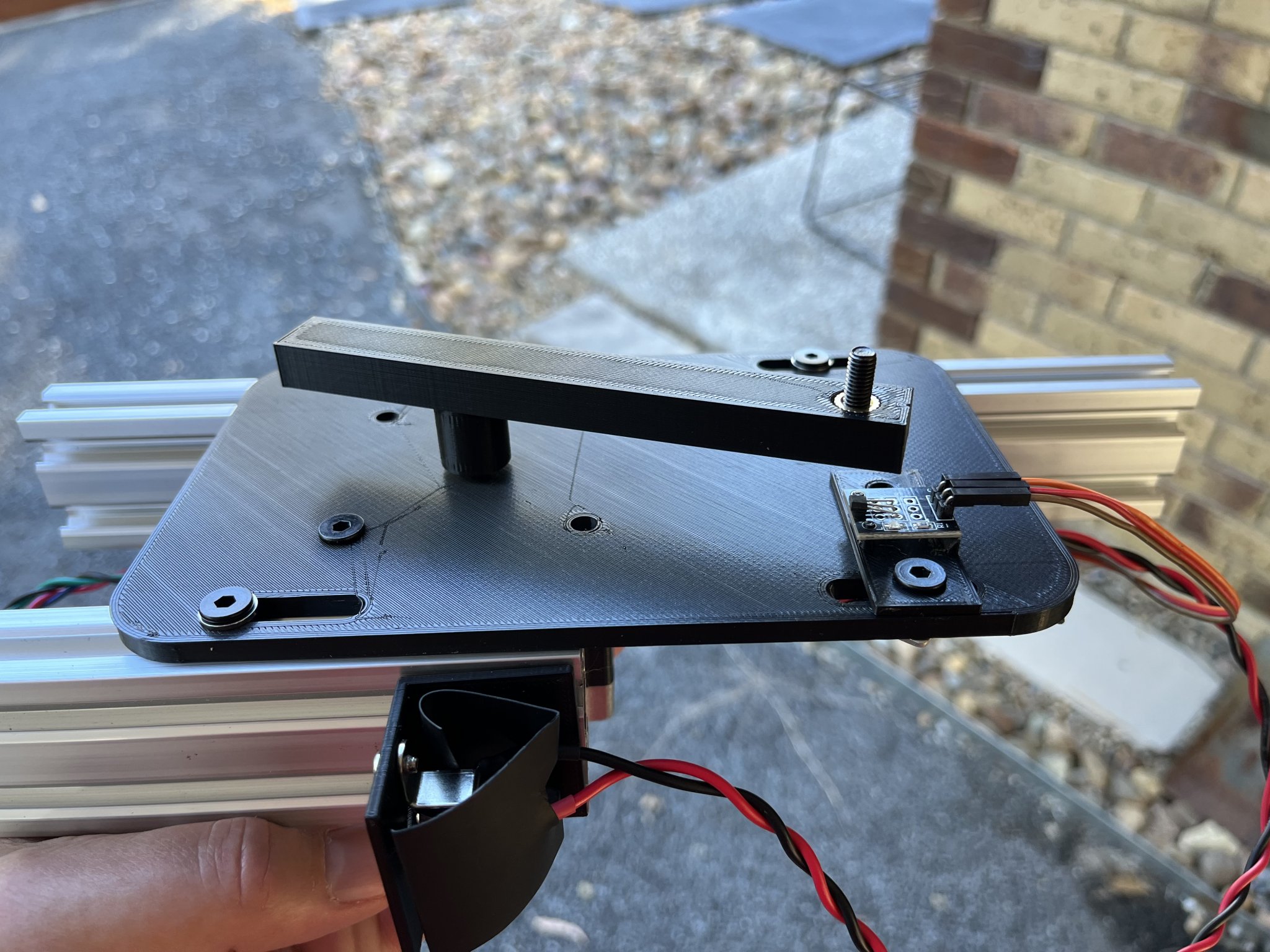

This is what the prototype looks like. I have used the motor mount plate from Nicholas Smart, custom 3D printed power supply bracket and Hall Sensor mount. I made an arm model that contains a heat set insert. A bolt goes through the insert with a rare earth magnet on the end this allows some adjustability of the sensor position. The Hall sensor is a digital trigger that sends a signal when the magnet is sensed. The homing routine moves forwards until the sensor triggers then moves away until it resets.
The down side to the switch I have is that it is Active low and can't easily be switched out of circuit for measurements. The Tic treats the switch as a limit and will not rotate beyond it. For now I run a manual routine of activating the limit switch in Tic Control Center, running the Homing Routine in Tic Control then disabling the limit switch.
It is debateable if the limit switch is even necessary as the table can be manually rotated to the 0 position and held there while the Tic is powered up. That setting then becomes 0 and seems to be returned to accurately by issuing a zero angle command through any of the command options.

I forgot to mention one thing about the software that it writes all the command line prints to a log file which can be viewed with a program like Baretail in real time. When the exe is used with ARTA and not called directly through a command prompt everything is hidden and hard to work out what is going on if nothing is happening.

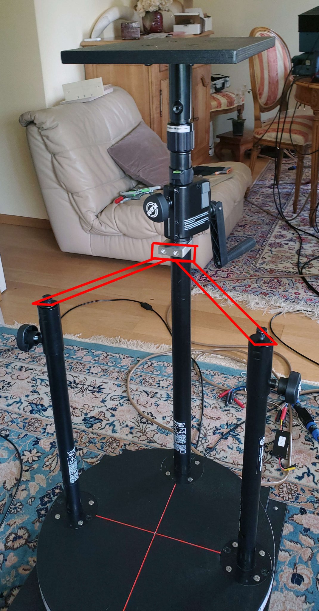

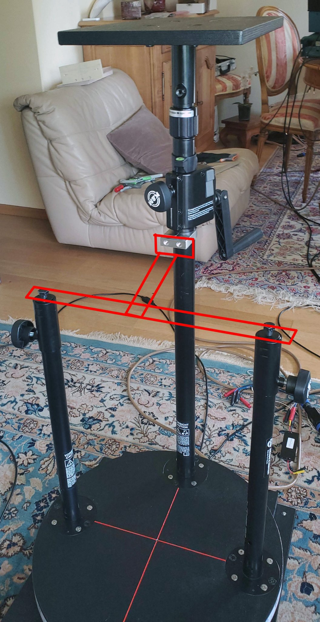

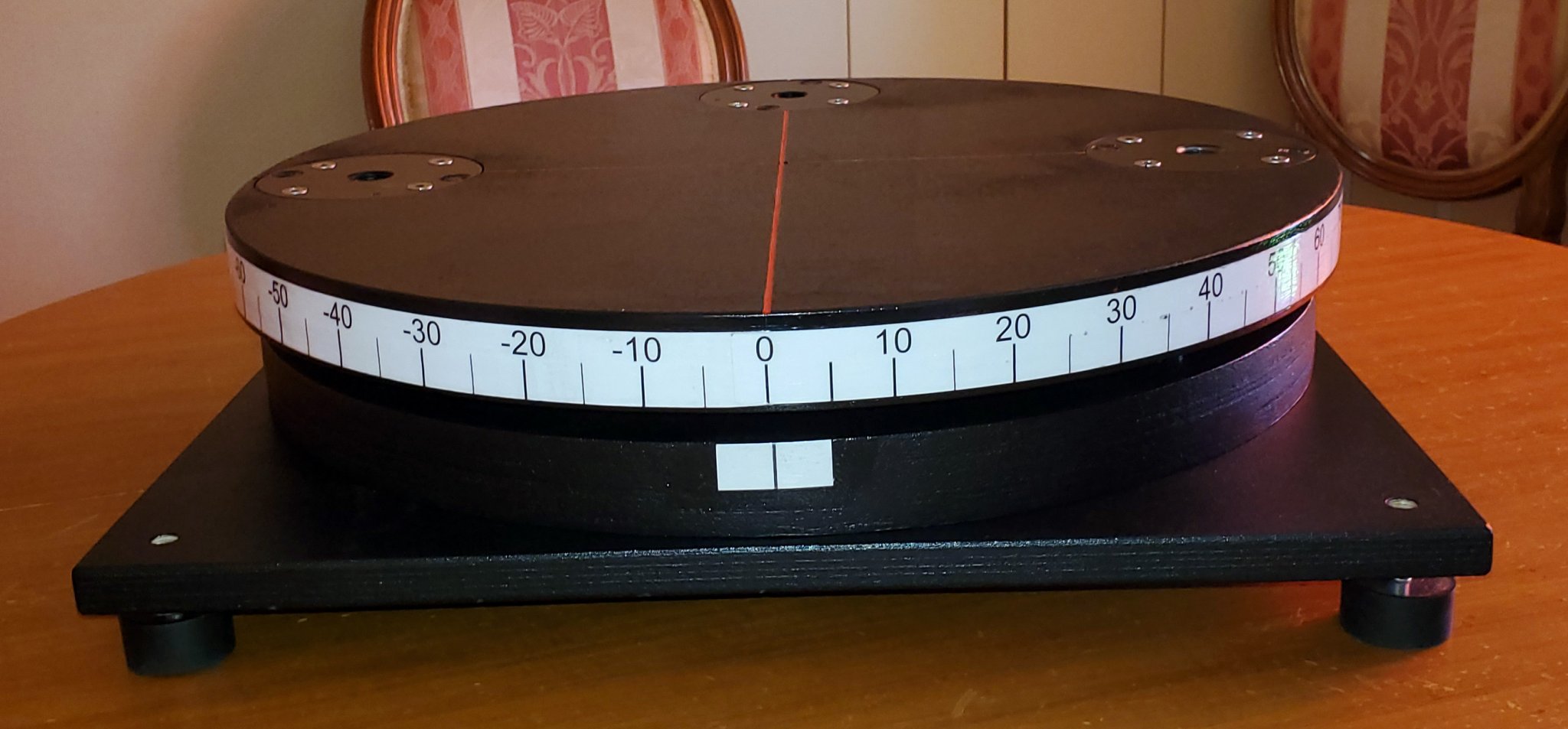

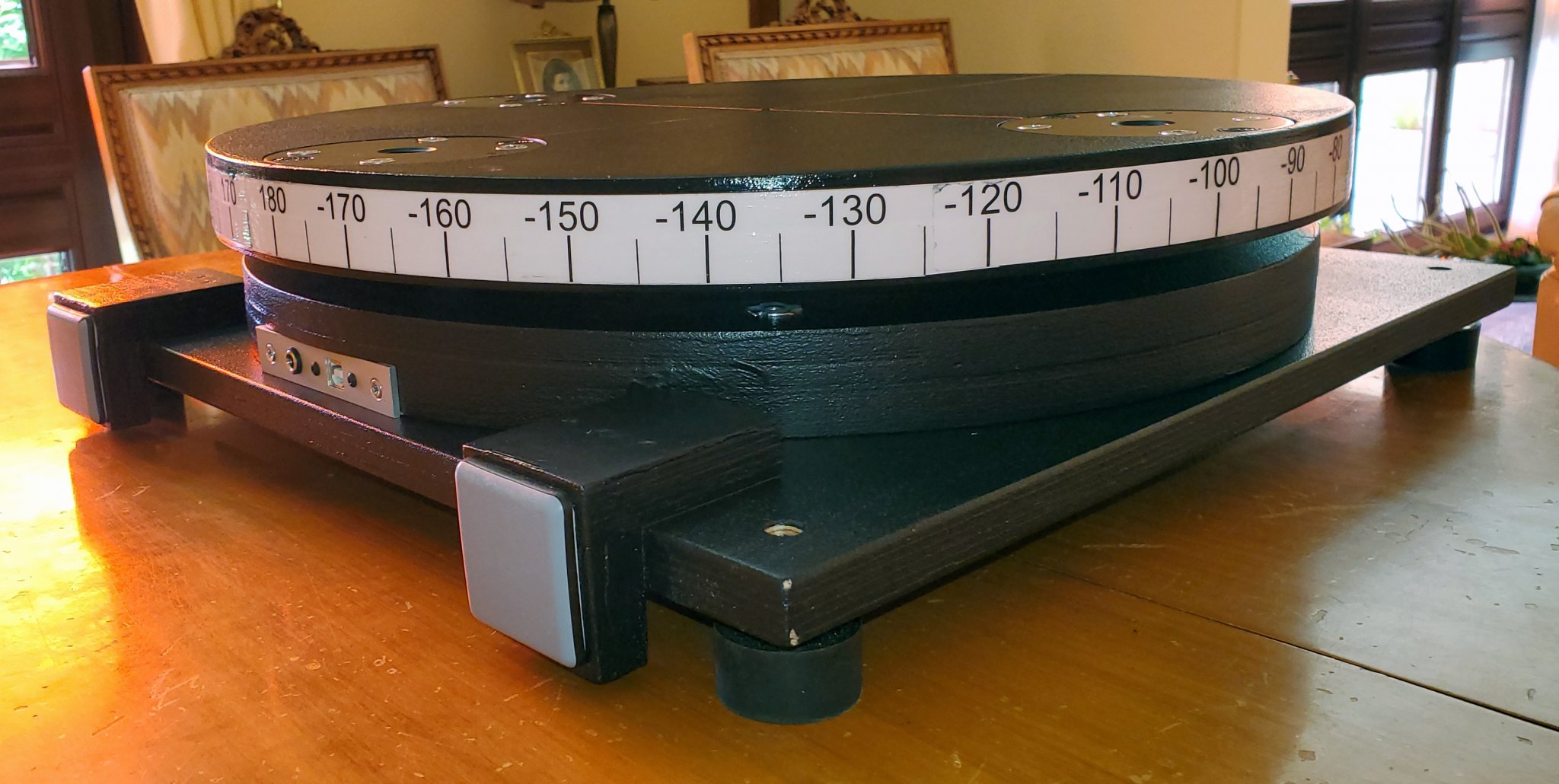

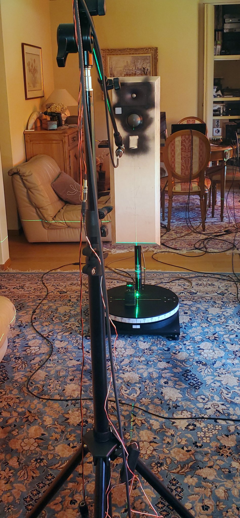

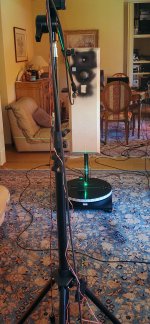

Here are some pictures from my rotating table based from Arta application note modified with a stepper motor, Tic controller and Arta_Tic from Tom
Really nice design work. This should save a lot of time when making measurements. I manually rotate my unit-under-test, and walking back and forth 36 times does get tedious...
j.
j.
Yes, once I did my first iteration of the table in 2020 during the first major Covid peak and guess what, it's simply impossible to go back manually as before.This should save a lot of time when making measurements. I manually rotate my unit-under-test, and walking back and forth 36 times does get tedious...
Now, automatic 5° steps recording in full space is a snap. I even do that from other room (office) by taking my measurement gear remotely. Big big thank to Tom et Fluid. And I'm sure Fluid will come up with improvements like auto homing and more...
Jean-Claude

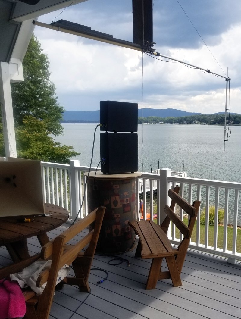

My setup is (and will always ,be I'm afraid) very manual.... and lacking real precision.
Lazy susan's of various sizes sit on a fabric wrapped compressed fiberglass steampipe tube, pointing out over a deck.
Also have a 3-mic rotatable boom off the deck as shown in photo...
My red neck, poor man's spinorama !!!
It's not so bad doing manual because with the speaker pointing out into space i can be behind it, and make a quick manual rotations and measurement grabs.
Worst part for me is the damn file naming....
