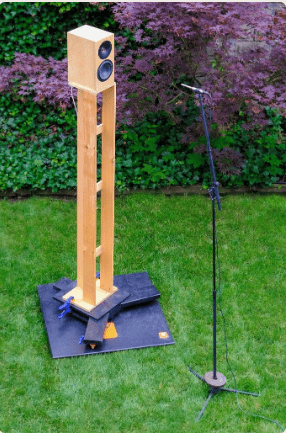

I'm going to build something like the tripod tower shown in the article I linked before. The Top plate will be small and easy to add larger ones to for bigger speakers. I'll mill a cutout in the columns so that a ratchet strap can be used to hold the bigger speaker to the platform.Yeah, it would be awfully nice to have.

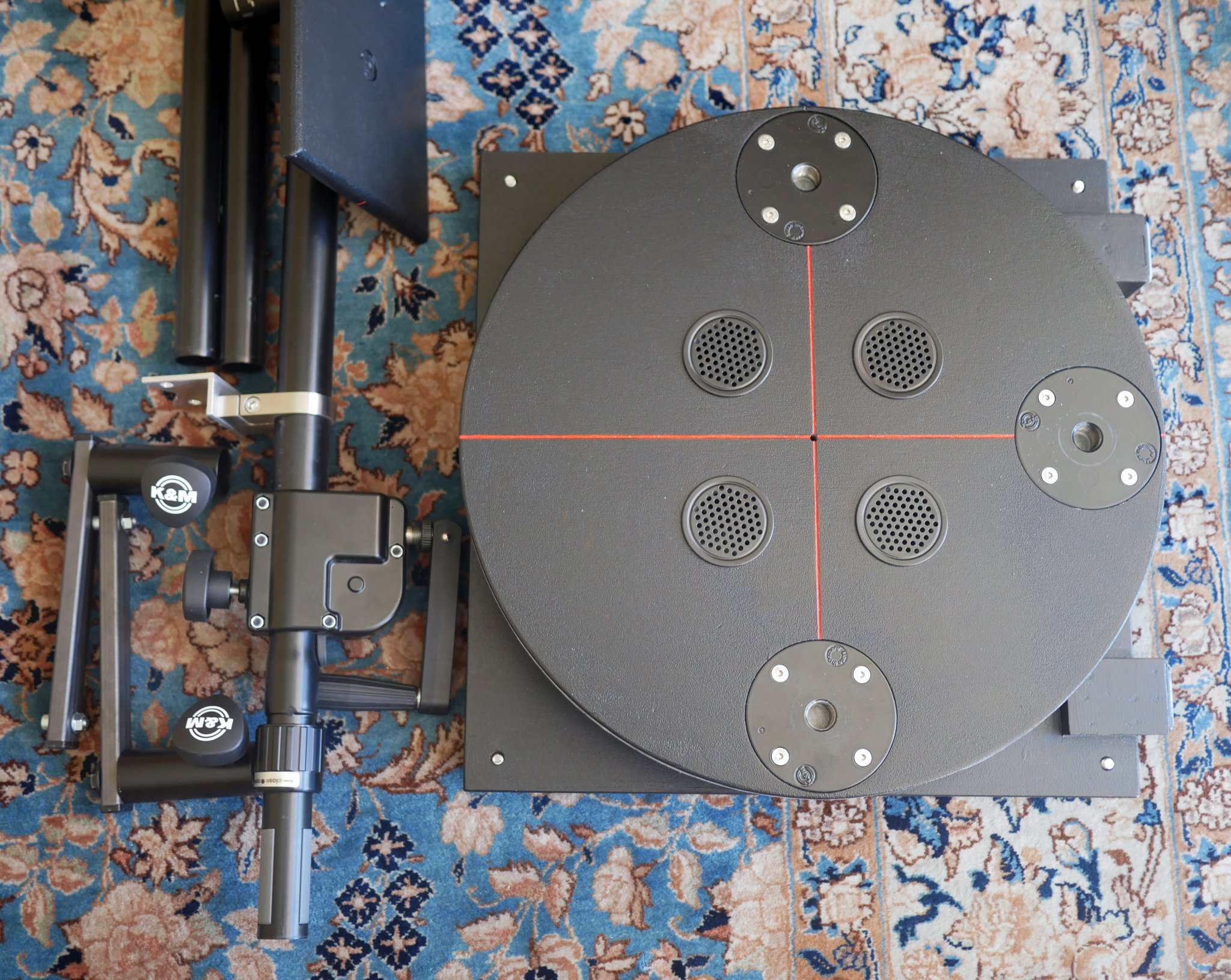

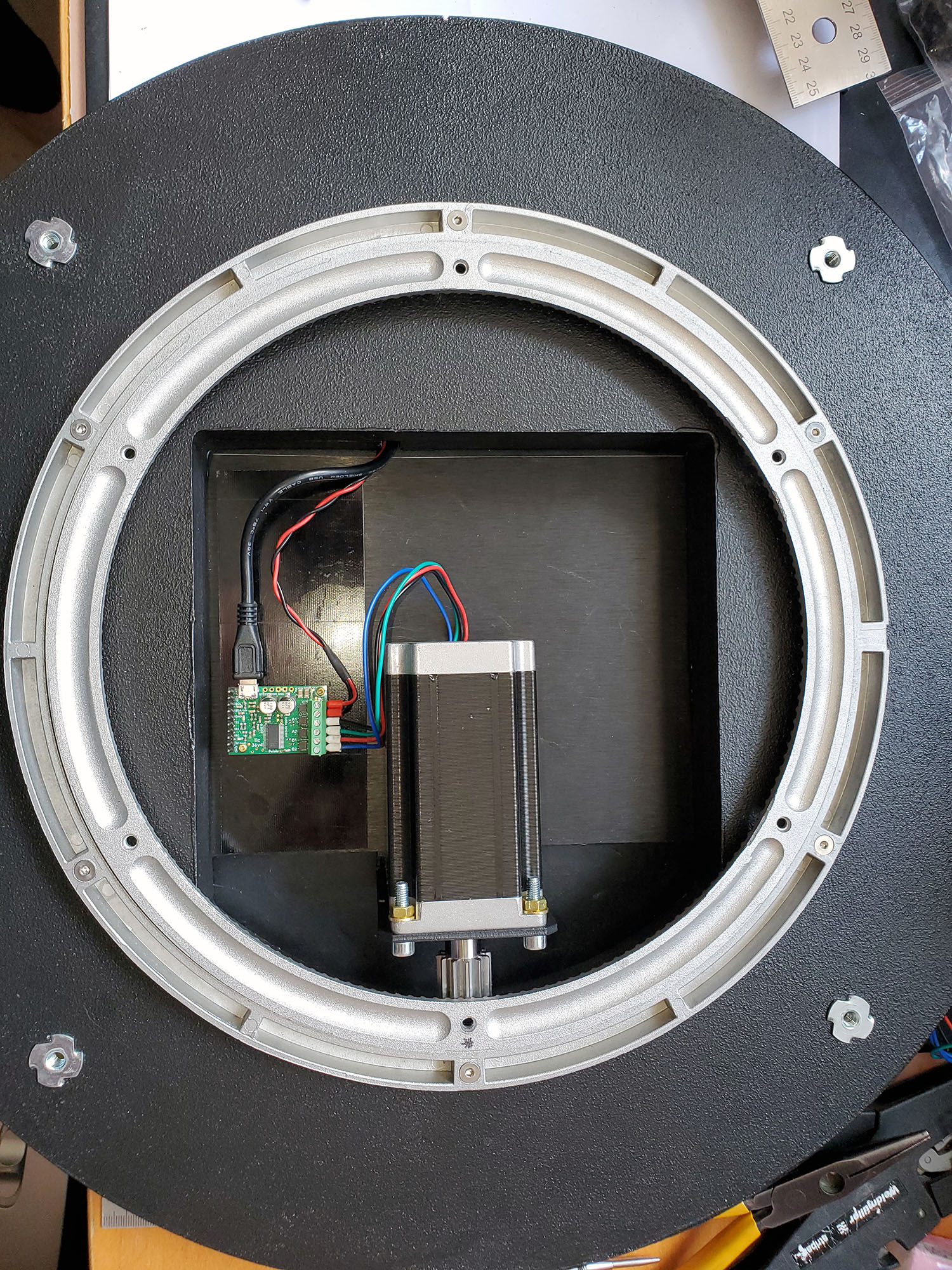

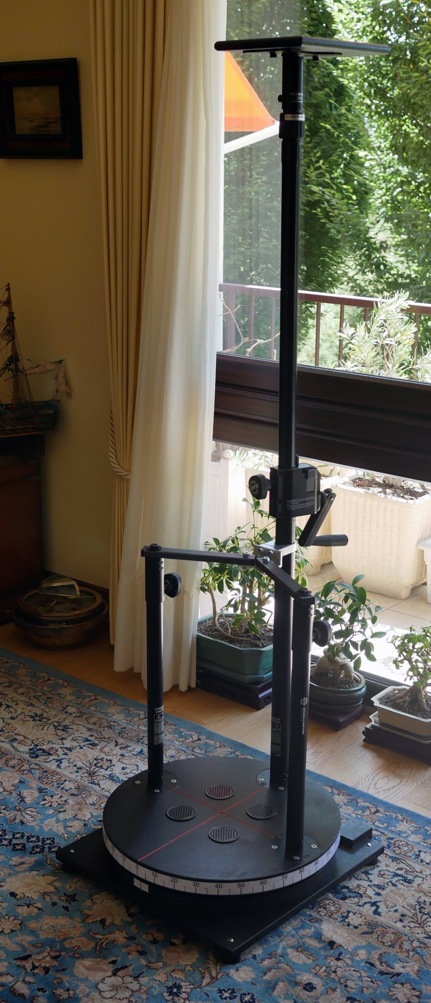

Here is the final (I hope) iteration of retrofitting my rotating table. I change the Nema 17 stepper motor + gearbox to a huge and heavy Nema 23 direct drive stepper motor.
I was wondering why I had to adjust the theoretical value for the gear_ratio in the config file to go to the correct position. Error was around 3-4%
The reason was simple, I forgot the fundamental of mechanical engineering : play in the gearbox ! And as it accumulates with number of steps, it's a dead end.
Bingo, with this direct drive stepper motor, everything works as it should, the value to be inserted for the gear_ration is the theoretical value (in my case (177/12 x200/360)
I did several tests from within Arta ( 0 to +/-180° in 5, 10, 30° steps and it always go back exactly to the 0° position by using the "go to zero" button in Arta
I'm happy, the only remaining task will be finish the reinforcement of the supporting gear for very heavy loads. The lazy seven bearing is able to support more than 150 Kg by itself...

Jean Claude, that is now a really neat and clean solution and you bought the big Nema 23 too 🙂 I decided to start with the smaller one like I have on my CNC as I will be mounting it the other way. I've hit a few snags printing across the entire bed so my progress has taken a hit.

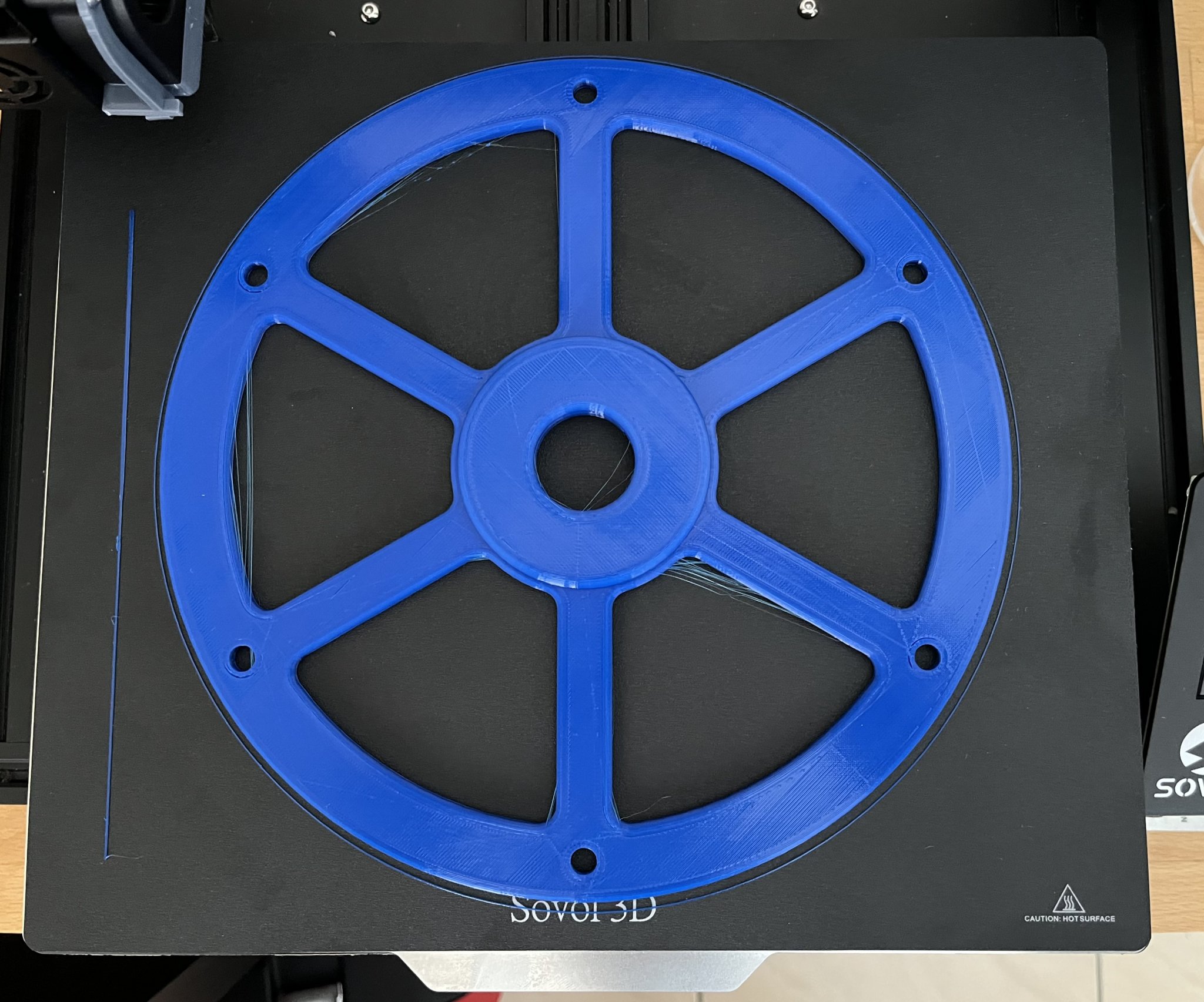

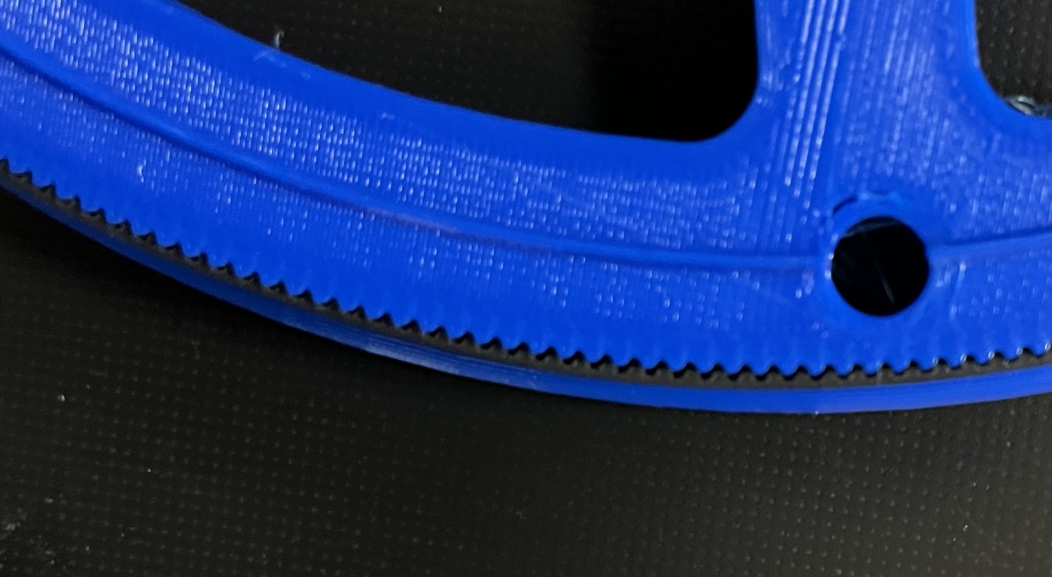

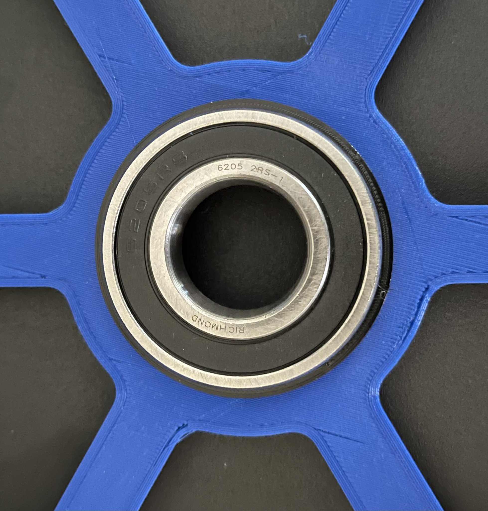

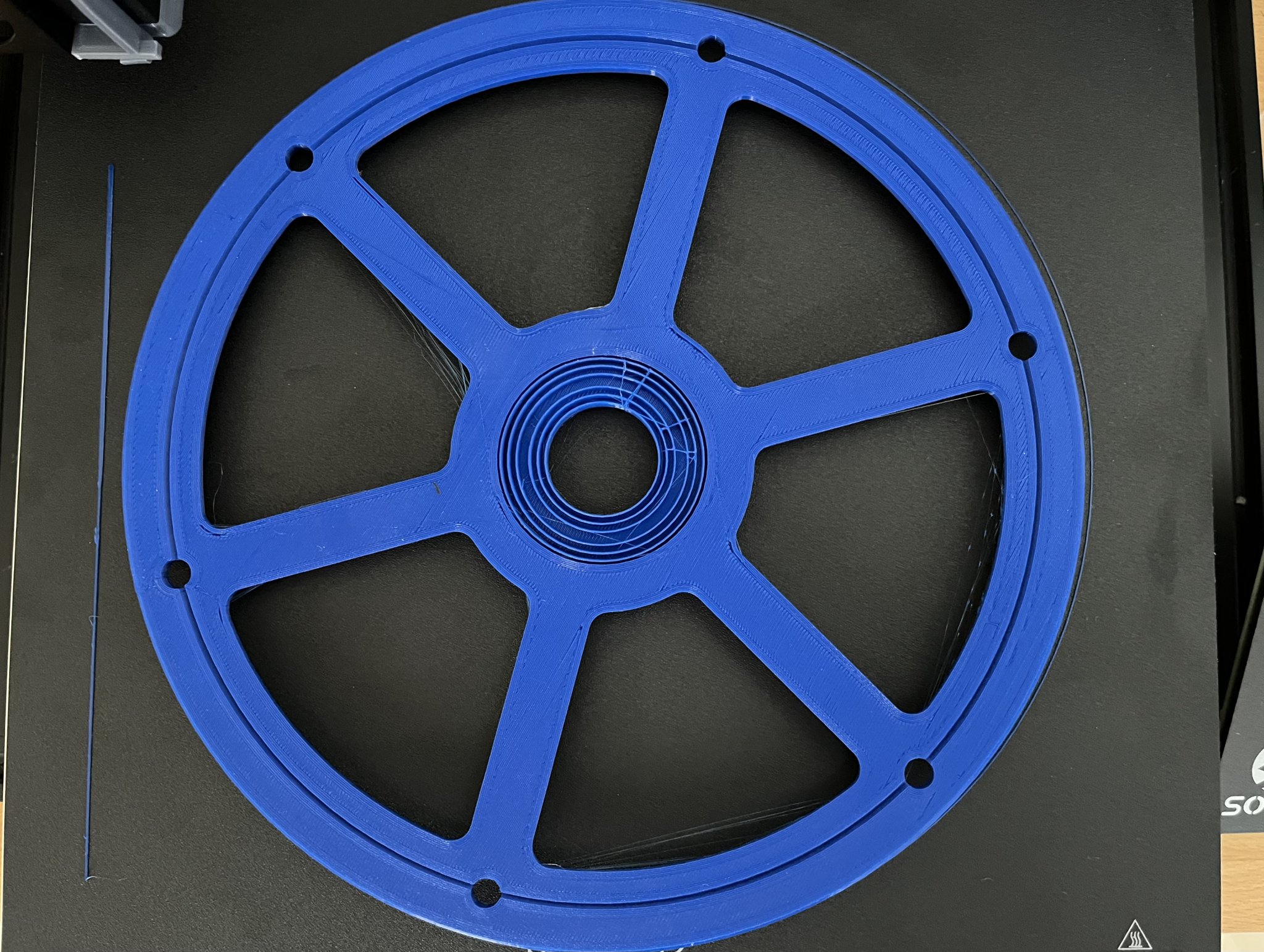

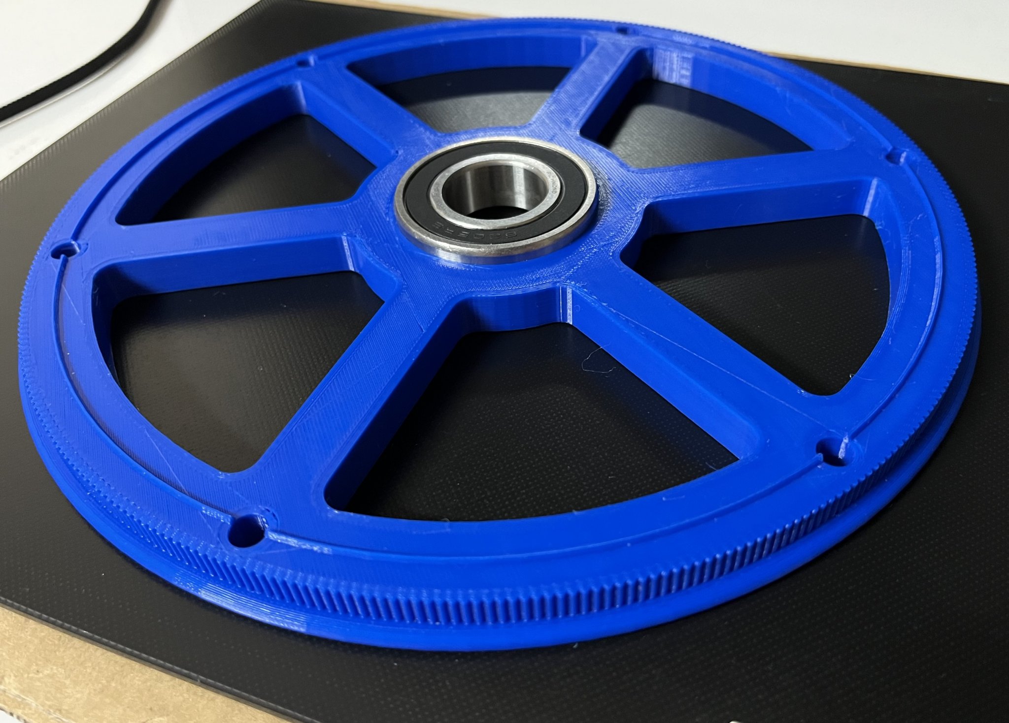

Some progress on printing the gear, bed and fan issues resolved. A successful print of the top piece in PLA+. When warm the bearing can be pushed in for a friction fit. The PETG was a nicer feeling more flexible plastic I think I’ll try the top in that before deciding which way to go.
Concentric support worked quite well for the overhang and was easy to remove. As you can see from the images I couldn’t have made it much bigger.

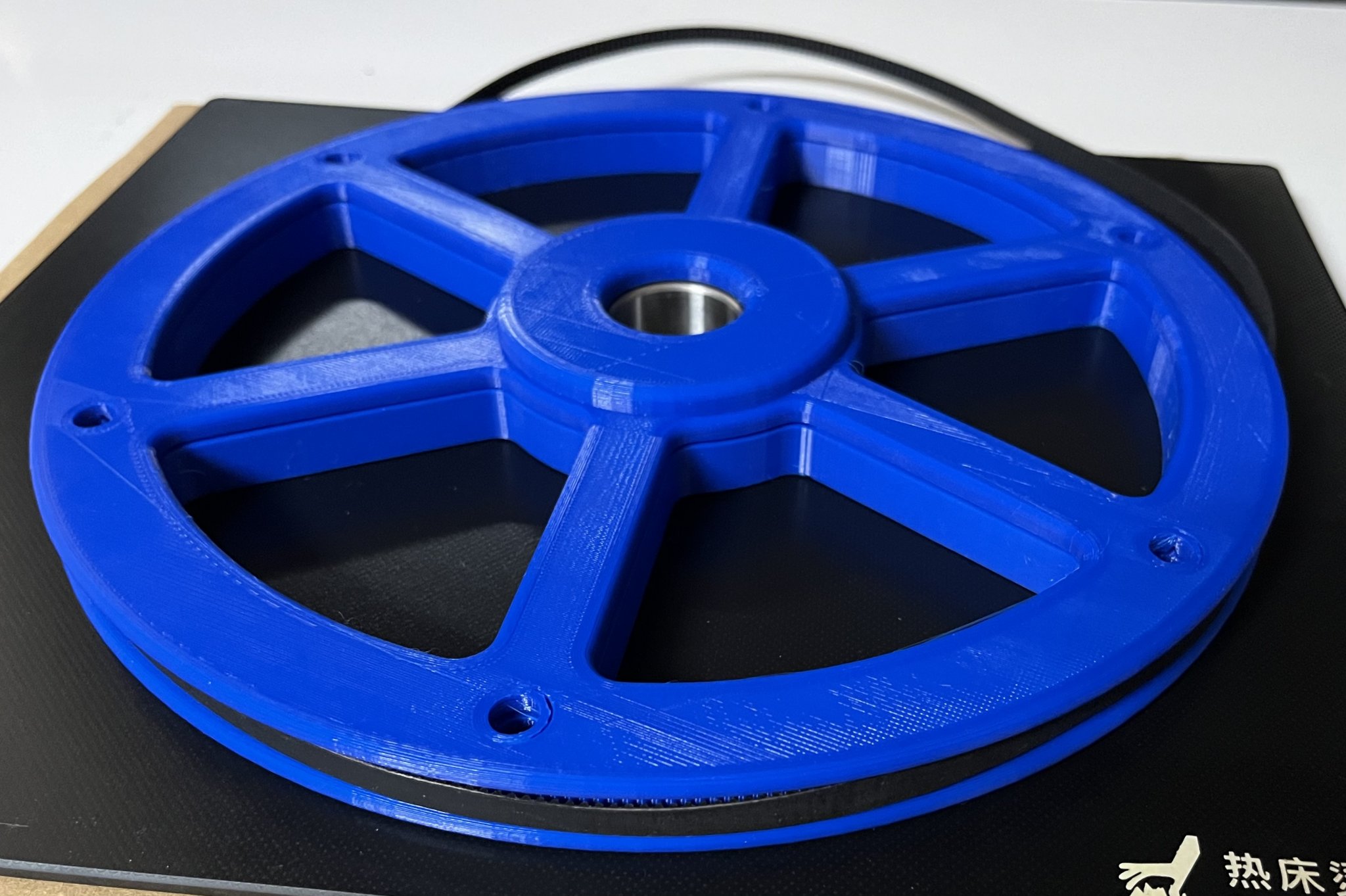

Duncan,
Great work, ingenious use of 3D printing, No, you have no excuse anymore to complete your gear 😊

I tuned the printer but for some reason PETG was a dismal failure separating halfway through so the bottom gear is currently printing in PLA+.

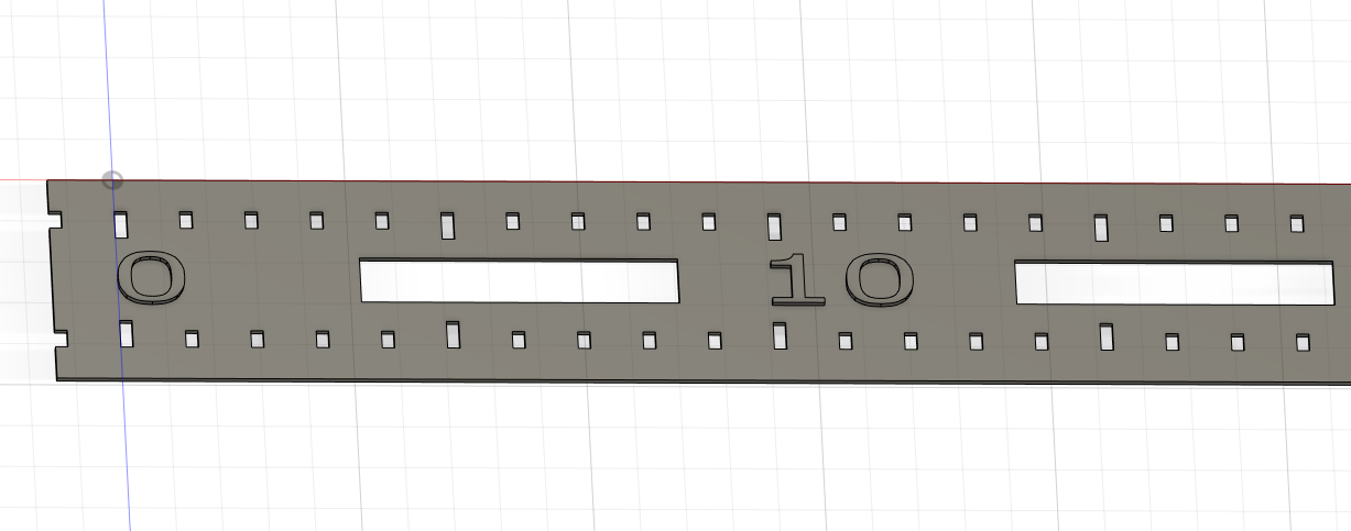

The next printed idea is a degree "tape" 0.5mm thick

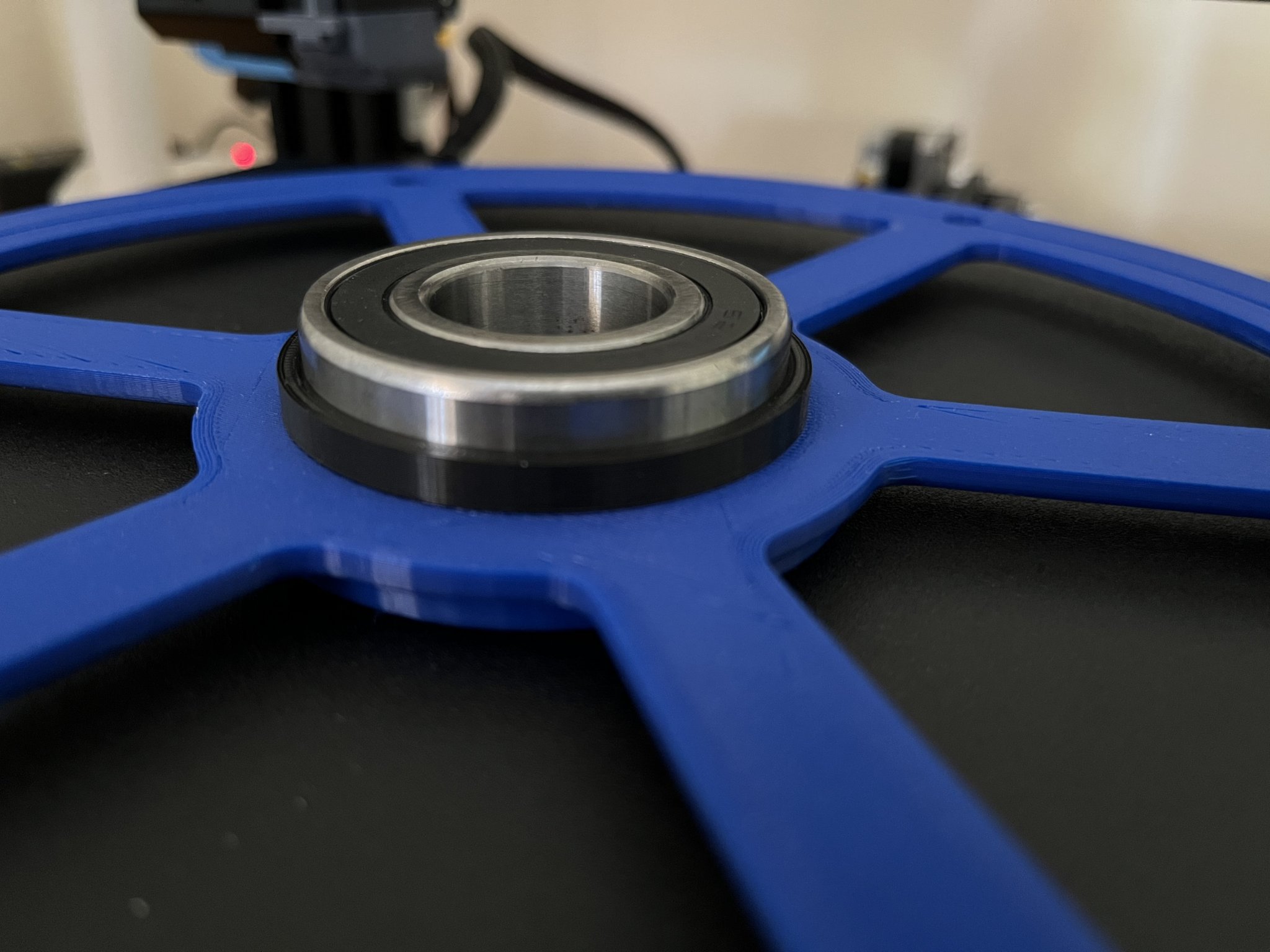

Toothed gear printed without incident and the teeth fit the belt perfectly. Some glue and heat set inserts and this piece will be finished.

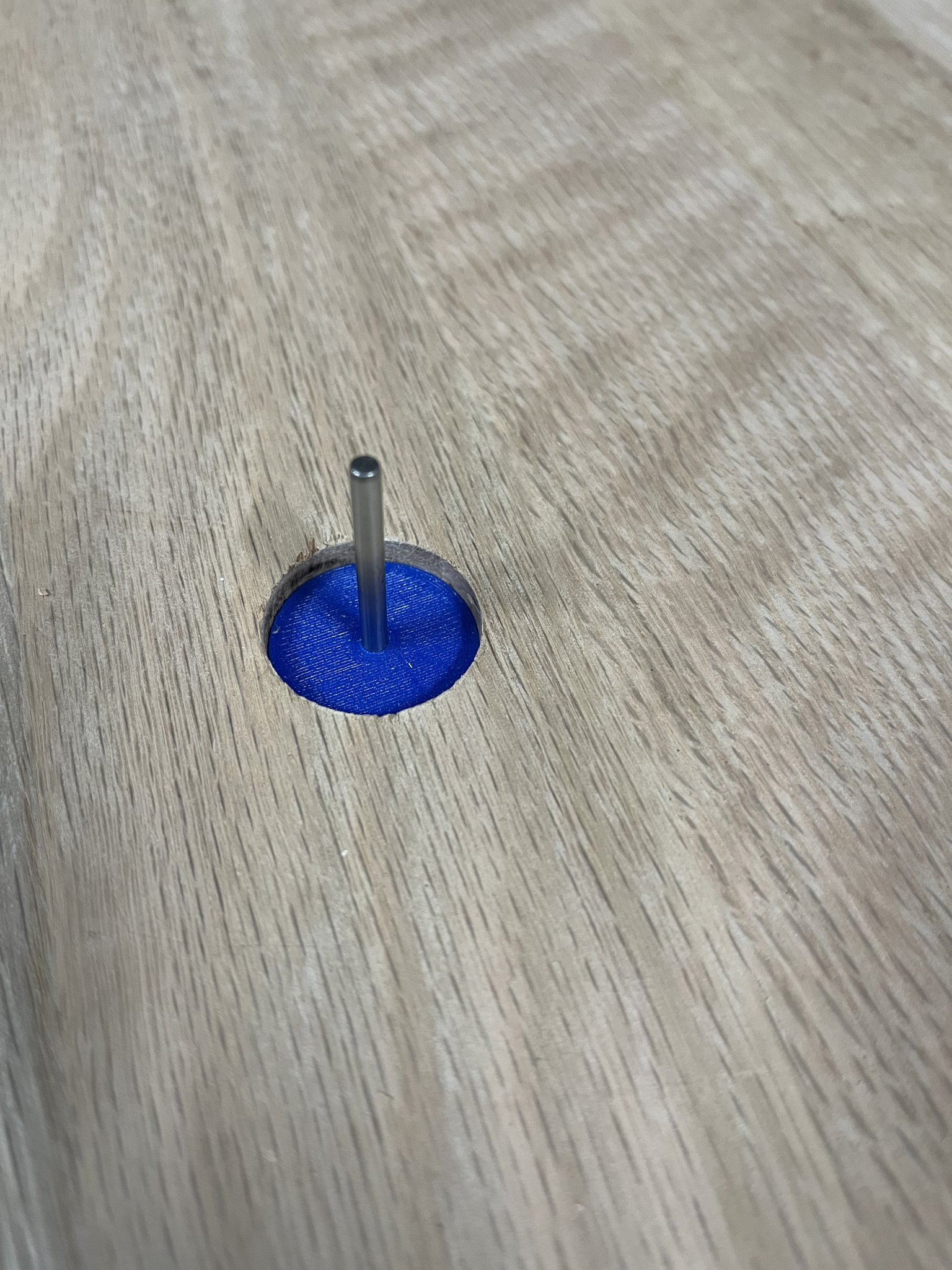

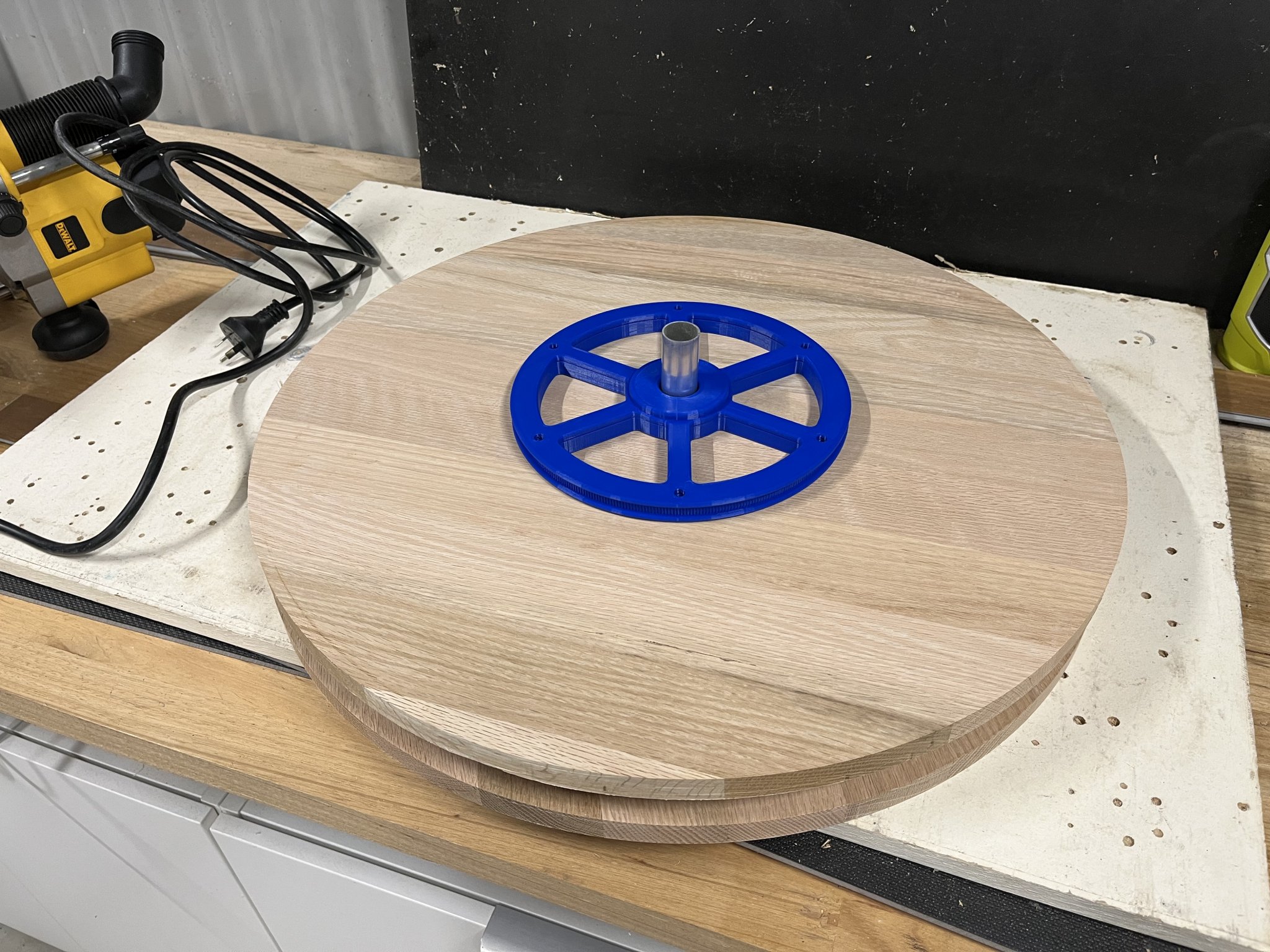

I spent most of the day fixing a stupid mistake I made transferring the centres on the oak discs. The 3D printer saved me with a plug to centre a circle jig so I could cut them down to be the same again. Now the discs are 10mm smaller 🤦♂️
Now I need to devise a mount to hold the aluminium tube square on all sides. The drilled hole was not good enough.
We all learned from our mistakes ! At least it obligate us to be creative or tried to be...
Your top plate looks like a piece of furniture 🙂

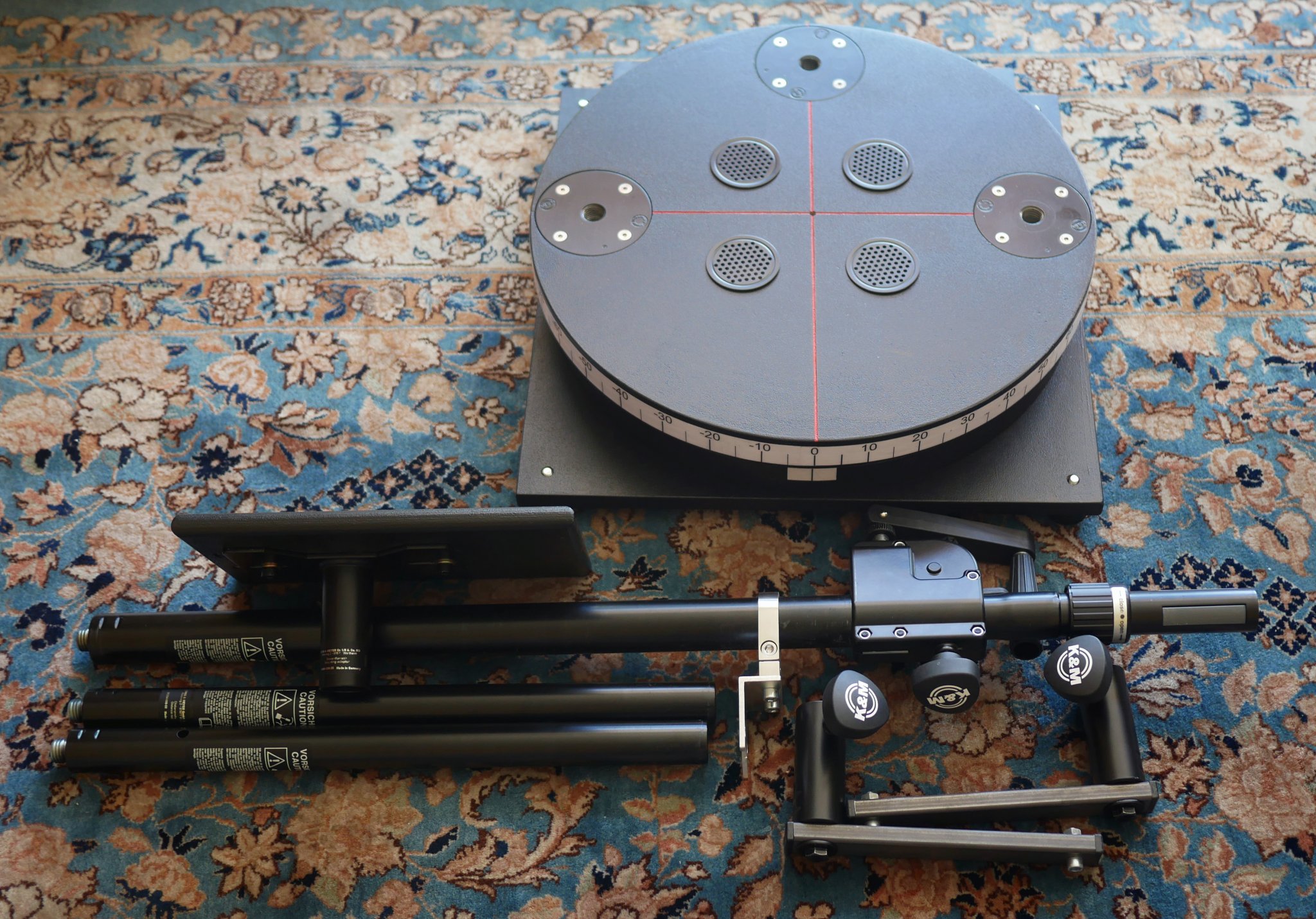

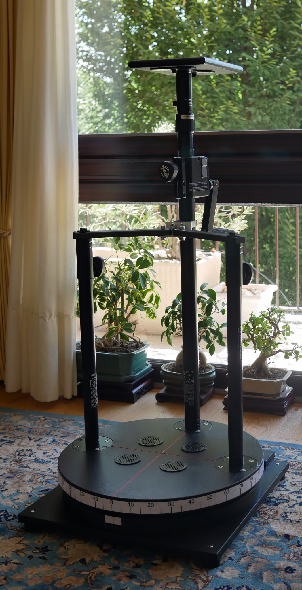

On my side, I have now completed all my retrofitting and upgrade to my existing table, the main constraint was to use the less space possible when not in use (WAF acceptance)
I do notice that with the holding torque current, the temp inside the small chamber where the stepper motor reside is getting high (ambient 22°C, inside temp 45-50°C). So even if it is acceptable, I have now four 53 mm diameter ventilation holes that prevent eventual excess temp.
Well, time to go to real stuff now...
- I double the top plate ans increased a little bit the diameter
- switch from an unreliable DC motor to a very precise stepper motor, again thank you Tom
- re enforce the supporting gear to allow heavy load
- Completely dismount-able in less than 5 minutes
- Full extension 1.70 m
I think you'll enjoy the final finish then, even though this is meant to be a tool and not a piece of furniture I like the make it look good if I can.Your top plate looks like a piece of furniture 🙂
The retro fit looks good. How much current did you set to end up with that temperature?I do notice that with the holding torque current, the temp inside the small chamber where the stepper motor reside is getting high (ambient 22°C, inside temp 45-50°C). So even if it is acceptable, I have now four 53 mm diameter ventilation holes that prevent eventual excess temp.
