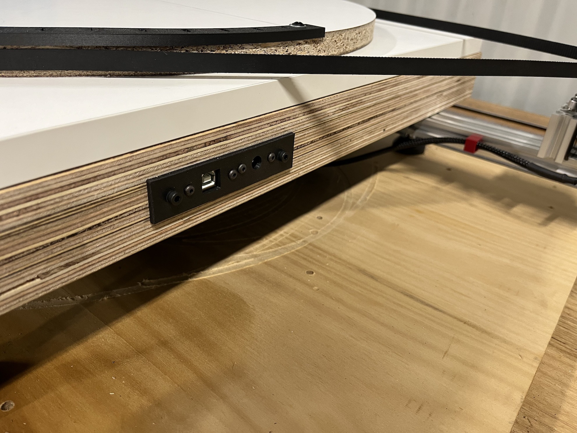

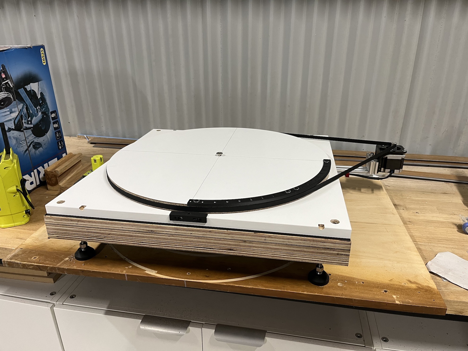

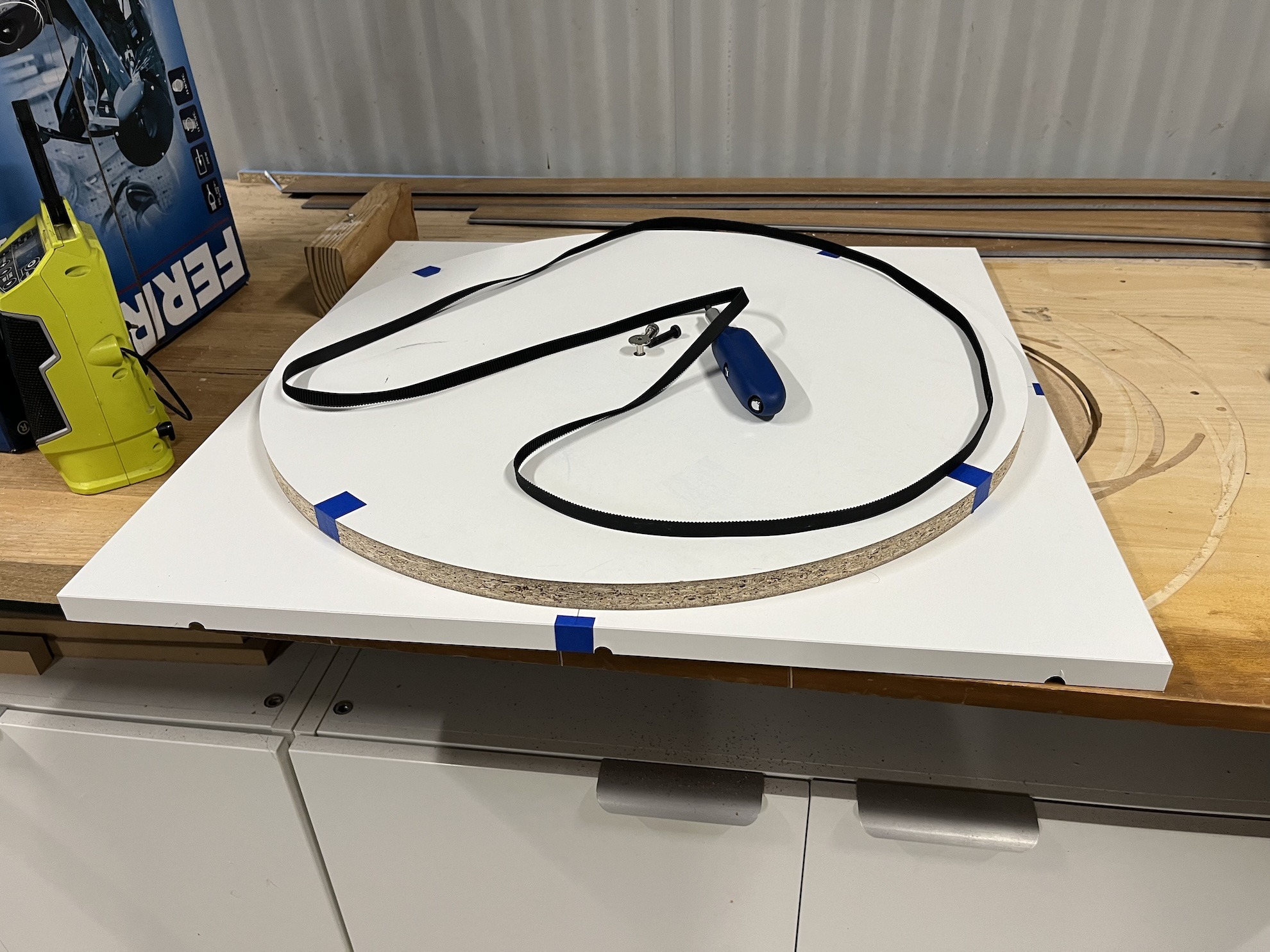

I spent all day thinking about it and decided to give the two sheets of melamine a try, I had some leftover IKEA shelves and I already have a long belt and pulley from an earlier idea. So far even without any grease or lubricant the spinning is considerably easier than the slewing ring. The belt is a bit long as it was sized for a 594mm disc and I didn't have anything quite that big in stock to cut a circle from that would spin.
Reactions: pulexirritans

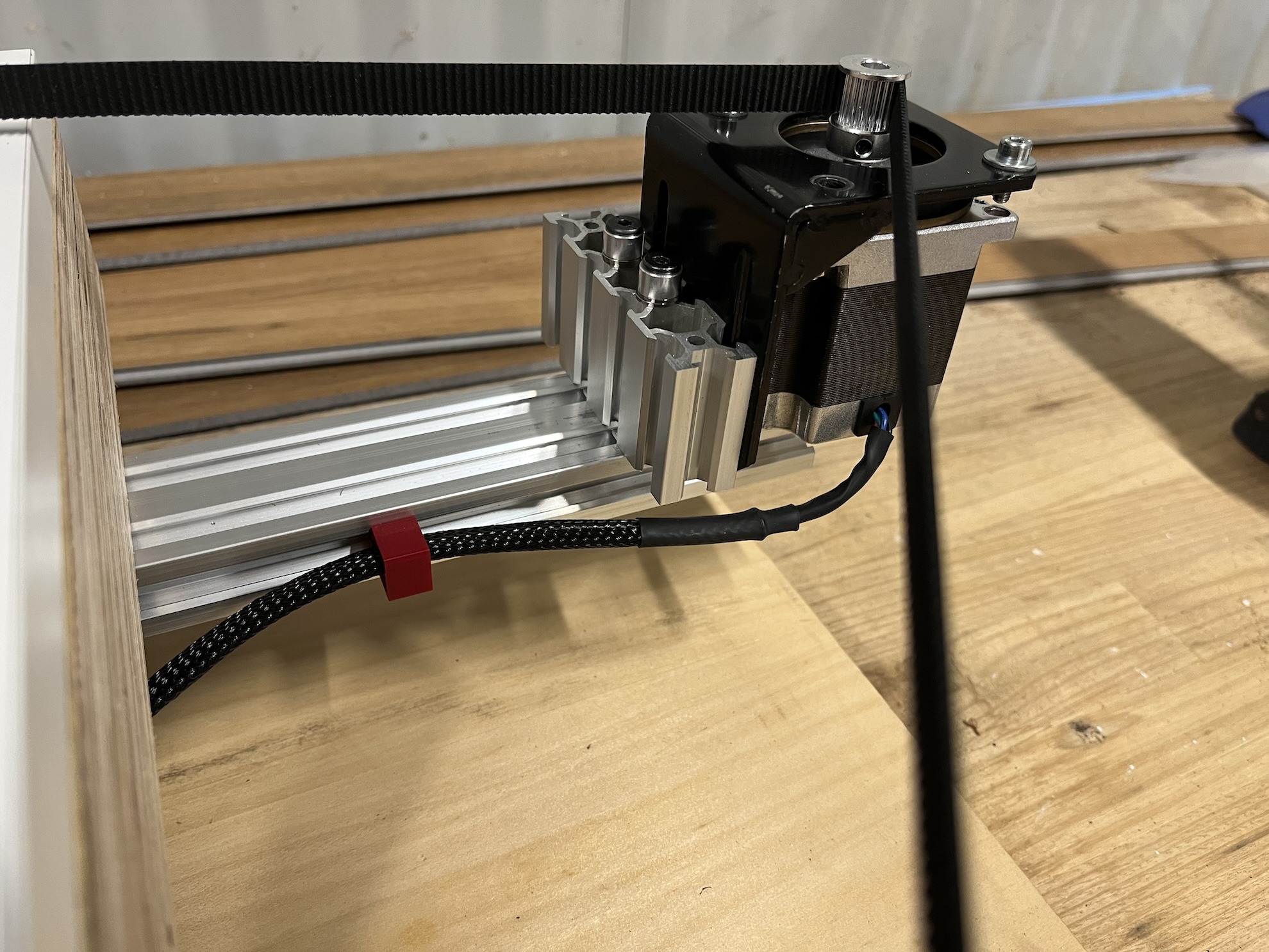

The belt driven version is alive. Due to the gearing it is much slower, but very smooth, I still need to work on what the gear ratio should be, the theoretical value is not quite enough. The good news is that it is repeatable backwards and forwards and comes back to zero nicely, although it takes it's own sweet time to do it 🙂 I had enough offcuts of aluminium extrusion and random fixtures and fasteners that I was able to make quite a nice tensioning setup with two bolts. I used 1/4 microstepping this time as it did reduce the vibration, it is a trade for electrical noise while the motor is moving but goes back to being virtually silent while stationary with holding current applied. I need to fix up the electronics in a separate enclosure as there isn't enough cable on the stepper to reach inside anymore. It is almost too heavy now which is not a bad thing for stability.

I have changed the speed and acceleration but not by significant amounts, once I have the correct gear ratio worked out I can up the speed and see what it can do. Even at this speed it is still only 6 minutes for a 180 degree measurement set in 10 degree steps. My first concern was repeatability, were any steps being missed, that was what I ultimately didn't feel happy about the slewing bearing I had in the way I mounted it, it could get stuck. It's still not clear to me quite why that was happening.
I haven't tried a heavier load yet that is still to be done. The gearing of the belt should allow it to move a pretty heavy load without any issue.

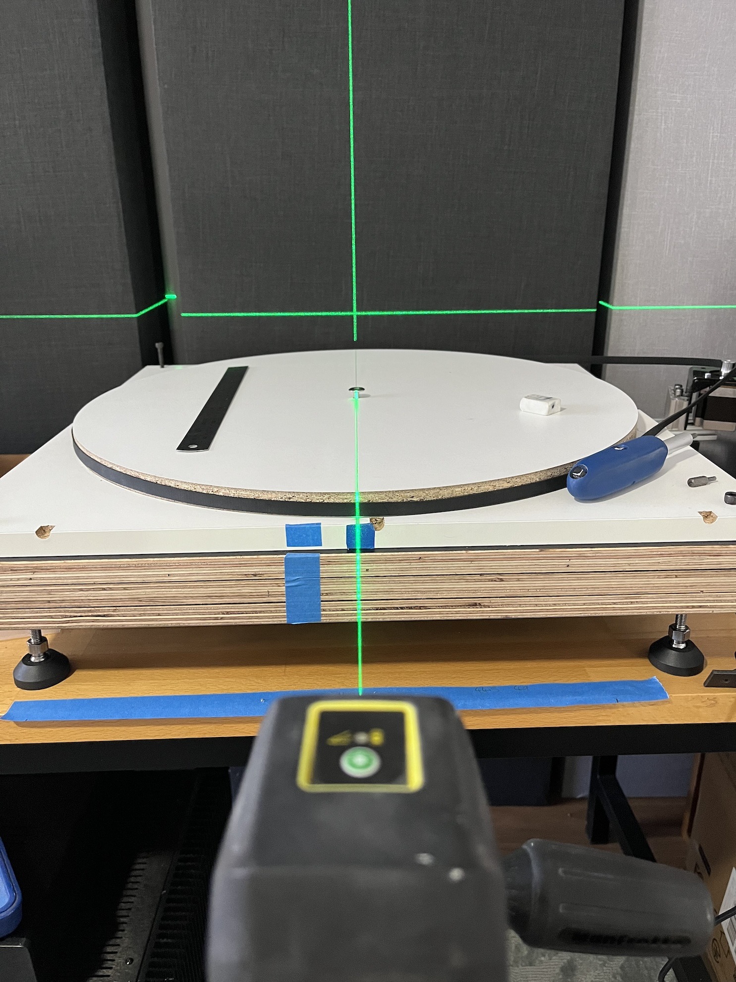

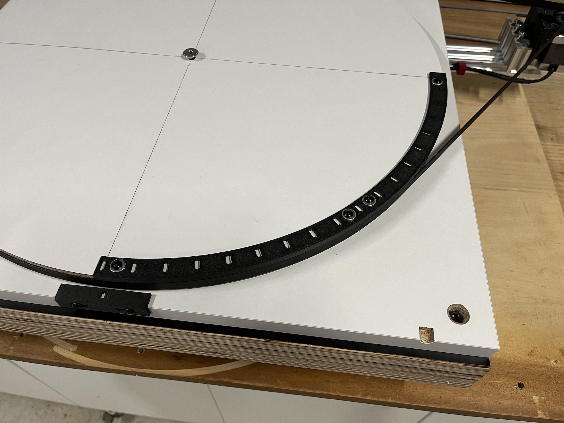

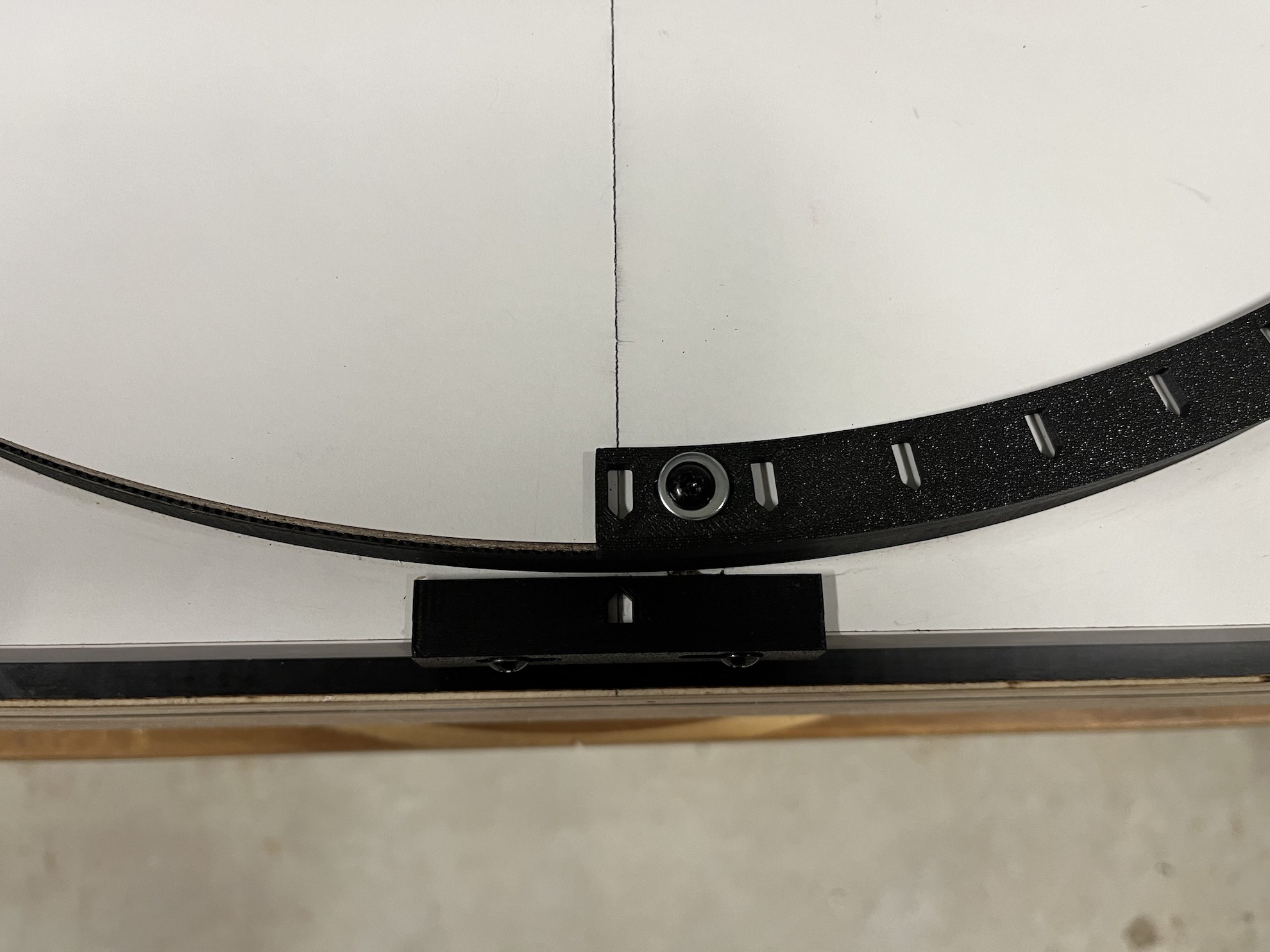

I have calibrated the belt which turned out to be much more time consuming than I thought it would be. Marking a line dead straight through the centre of rotation and lining that up with a laser ended up being quite the game. I stuck with the 1/4 microsteps and upped the speed quite a lot. I now have ARTA set to pause for 4.5 seconds between measurements instead of 12. This also had the benefit of reducing vibration more. The overall noise is much less annoying. I can now rotate backwards and forwards between 0 and 180 degrees very accurately, at least within the tolerance of a laser line. The circle ended up being the equivalent of an 851 tooth pulley. Marking angles was too painful so I printed a marker scale for 5 degree increments between 0 and 90 degrees so I can check that everything is staying in check. Apart from building a platform to raise the DUT up and checking with heavy weights I am calling this done. I might add something to keep the belt where I want it to run if that is needed after I have got to use it for real.

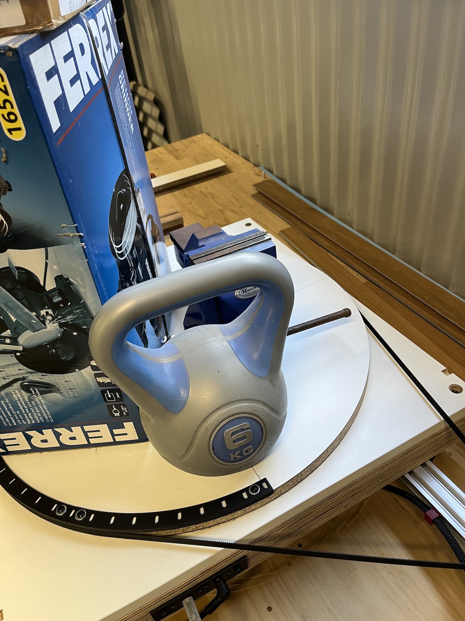

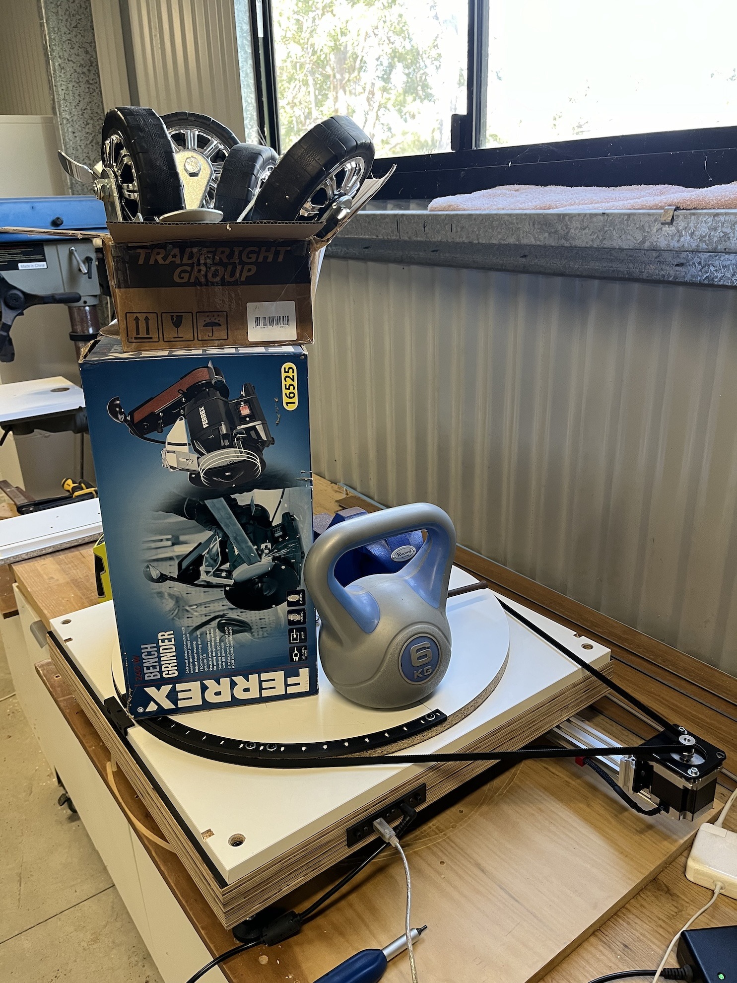

I have tested the turntable with as much weight as I easily had available, a 6Kg Kettle Bell, a bench vice, a bench grinder and a box of very heavy duty castor wheels. The Kettle bell is the lightest. The table moved them backwards and forwards from 0 to 90 and back again accurately, there was a small amount of motor strain heard but nothing much. 1/4 microsteeping seemed a good choice as trying full steps just ripped the belt around without moving the plate at all. The marker scale was a bit of a fail as it was hard to tell when it was lined up, I will have to try a different version of that idea.
