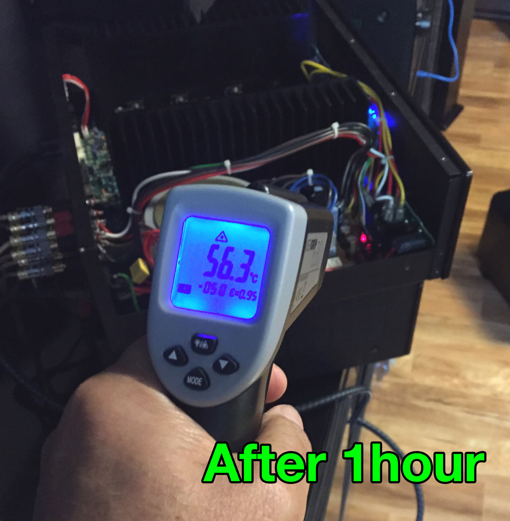

I have ordered an IR Thermometer, will arrive today noon. I’ll be posting accurate temps by tonight.
Also working on extending Heatsink sizes. I’ll update soon.

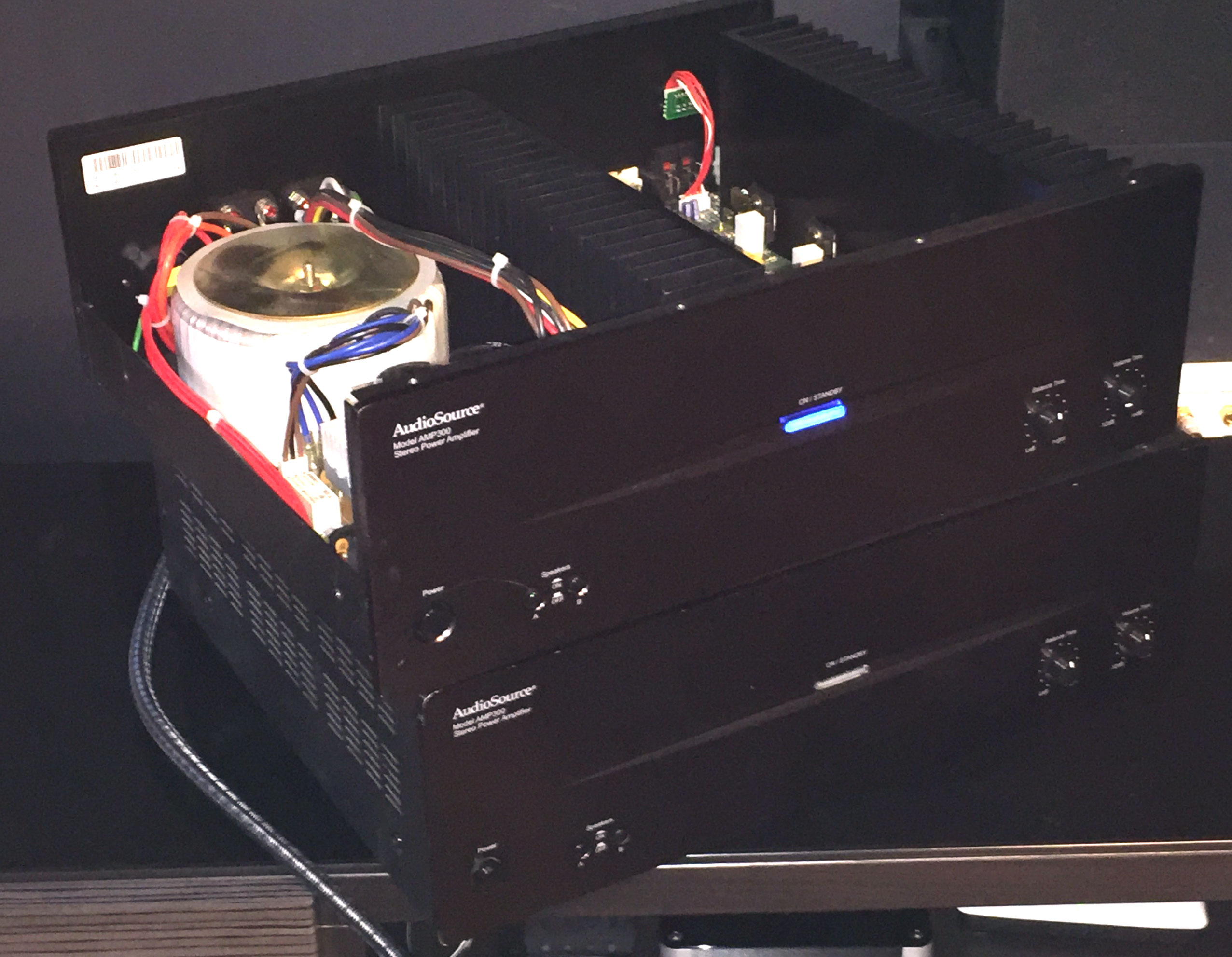

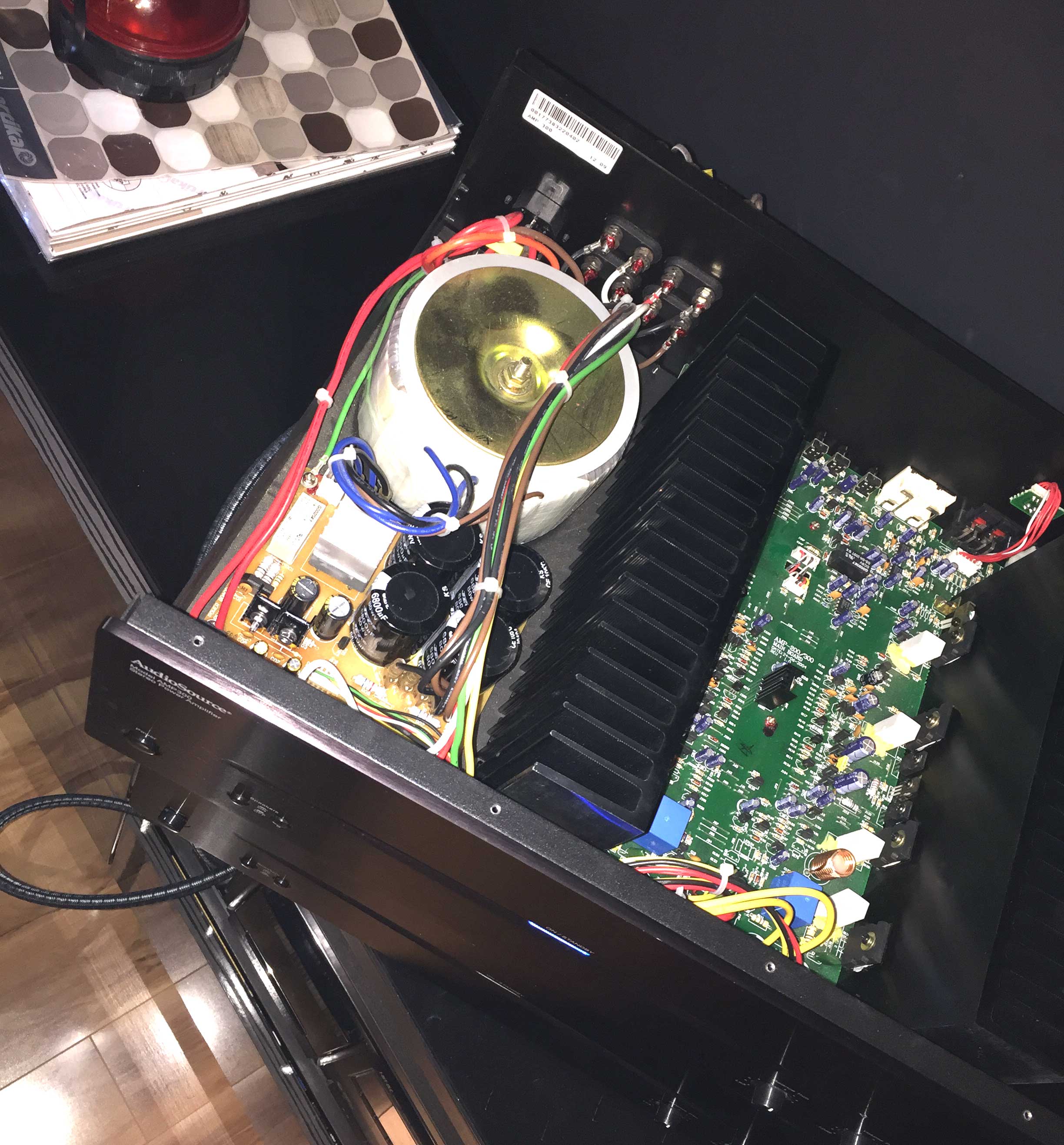

I acted on your advice and made both Heatsinks upside down but added one each heatsink to the opposite side to make these both side finned.
I understand why you asked me to put these upside down.
Yes the heat always travels up. 🙂
Another thing I did is, I replaced both ICs with:
L7915CV-DG ~ IC REG LDO -15V 1.5A TO220 by STMicroelectronics
L7815ABV-DG ~ IC REG LDO 15V 1.5A TO220 by STMicroelectronics

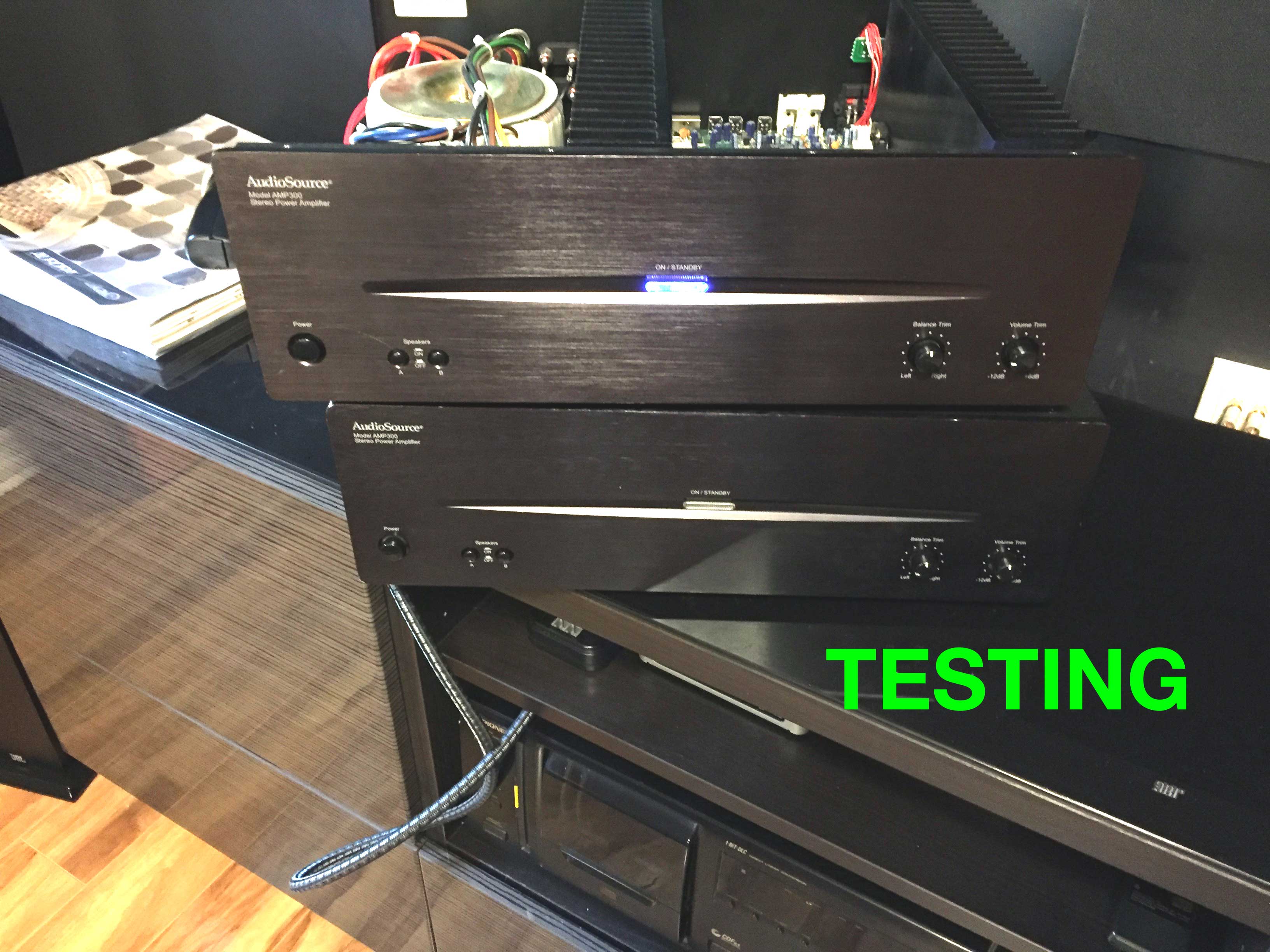

And finally put the Amplifier on test. Its running for past 4 hours.
Temp is stable between 56-57ºC (132-134ºF) even after 4 hours.
AMP is running a full load of 4 ceiling speakers (125W@8Ω each).
Those 4 transistors Q104, QA104, Q204, and QA204 are at 50ºC on both the channels. So planning to put some heatsinks on these 4 transistors.
Your comments please.
Best Regards,
Ash

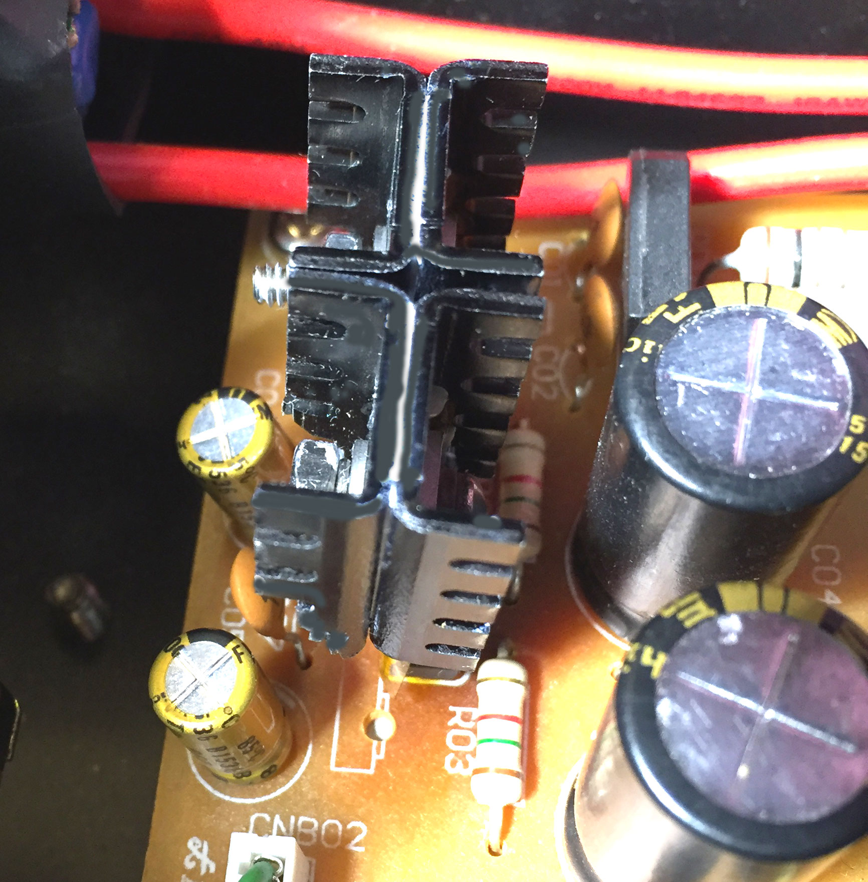

I plan to replace all disk, 100uF and 1000uF Caps, the bridge rectifier and both IC's (adding heat sinks to each) as well as the 1r fuse resistors. The other resistors all check out on the DMM and look good.

do the heat sinks need some type of thermal paste? if so, recommendations? I have Artic Silver from my computer build if that will work.
Thermal compound wouldn't hurt. Arctic Silver is electrically conductive but shouldn't be a problem here as the heatsinks are isolated.

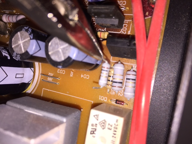

I have a problem...installed all the new components.
Left the amp board unhooked, both low level power connector (CNA02) and the rail supplies (+/- 63Vdc).
Checked all the resistance and power on the low-level connector and the only odd thing was that the -15v was reading -18v and the 24v was 28v.
Figured that was because the relay didn't trip, so maybe current wasn't flowing through everything to drop the voltage down.
Plugged in CNA02 and Rail voltage plugs and turned it on and the front blue LED came on for an instant and then off.
Now the 1r 1/4 watt resistor fuses are blown again.

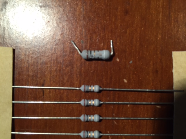

Question - my other AMP200 has the same PSU and those 1r resistor fuses. They appear to be at least 1 watt, not 1/4 watt as in the schematic. Also the ones I removed look to be 1/2 watt
Is there a chance the schematic is wrong and I need 1/2 watt or even 1 watt????
Pics of the comparison, 1/2 watt I removed/replaced is on the top in 1st pic (compared to 1/4 watt) and on left in second pic (compared to AMP200 resistors).
