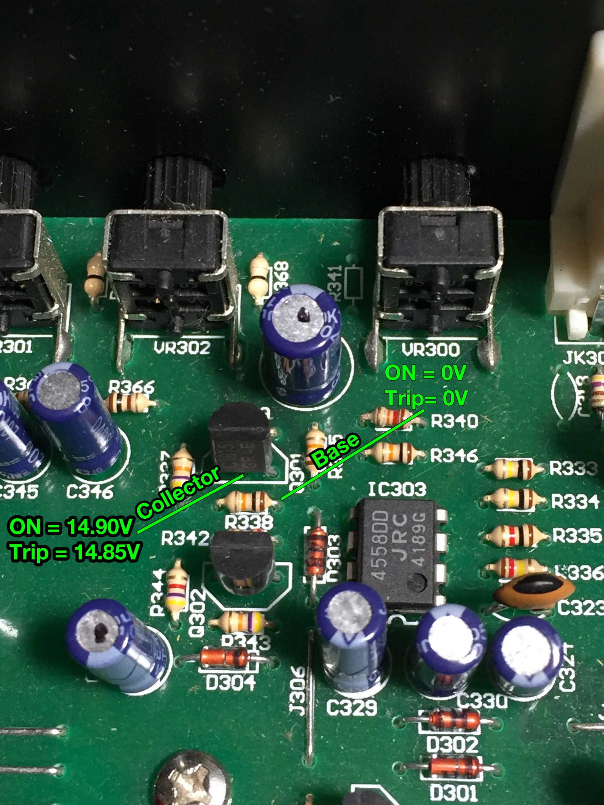

That is what i expected too.
Now, check pins 5 and 6 of the same IC.
Edit: Patience. 🙂
Edit-2: When it trips, short the Base of the Q301 to the ground with a wire. ( OR, you can simply short its base and emitter with a tweezer carefully since its emitter is already connected to GND) and see if the relay releases.
Edit: Patience. 🙂
I think i am not allowed to edit a post more than 3 times. 🙂
You can omit "edit-2" since it will most probably not make any difference.
instead, check the B and C voltages of Q301. also when work, when trip.

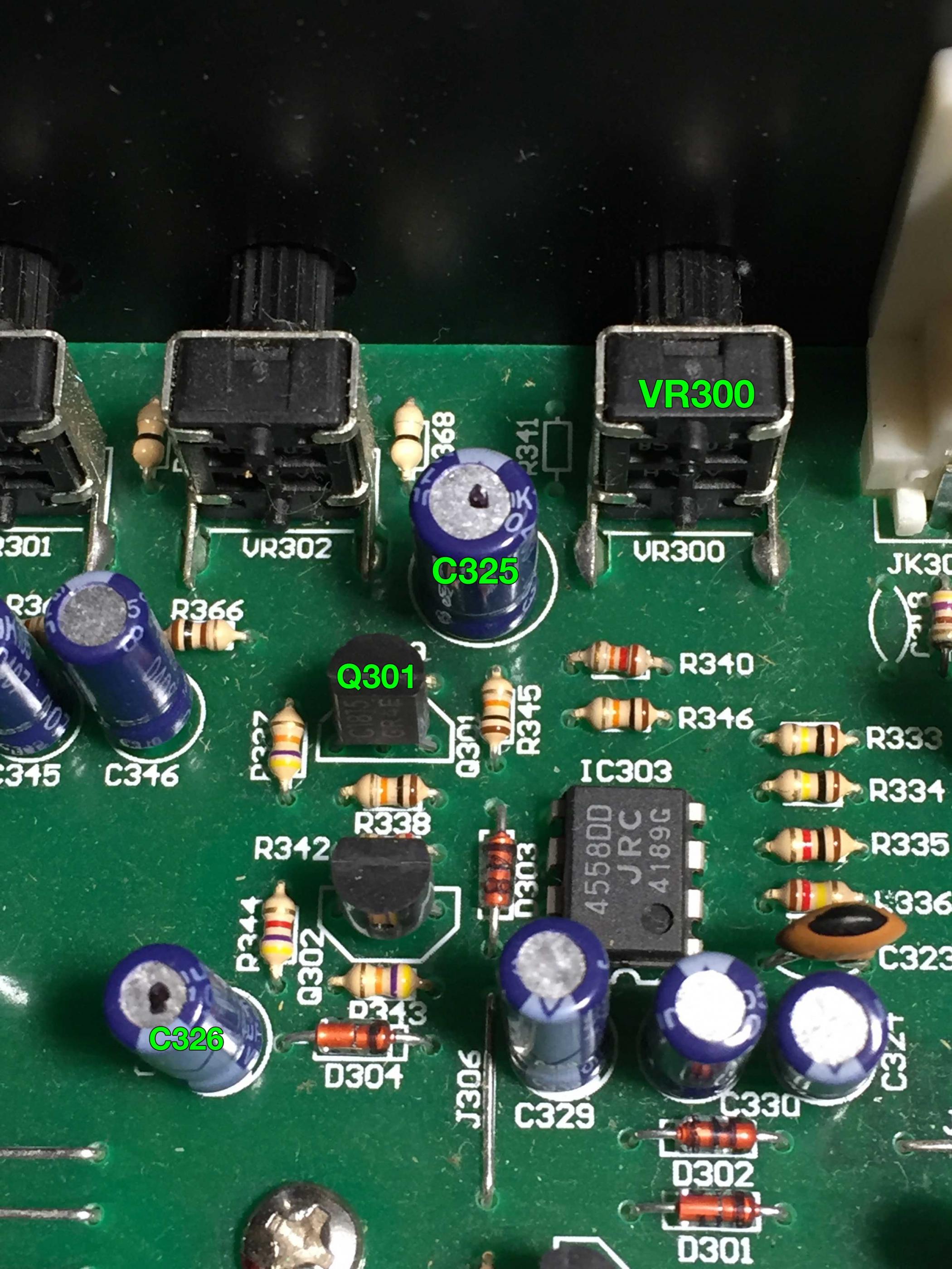

--- If you have a capacitance meter, check C325 and C326 values. ( (when the amp is turned off)) Both are 100Uf. Do this after removing at least one leg of each. If you dont, just replace them with a new one.
---Check the resistance of VR300 (when the amp is turned off)

IC303 at Pin5 - ON is DC 0V and Tripped is DC 0V
IC303 at Pin6 - ON is DC 0V and Tripped is DC 5.45V

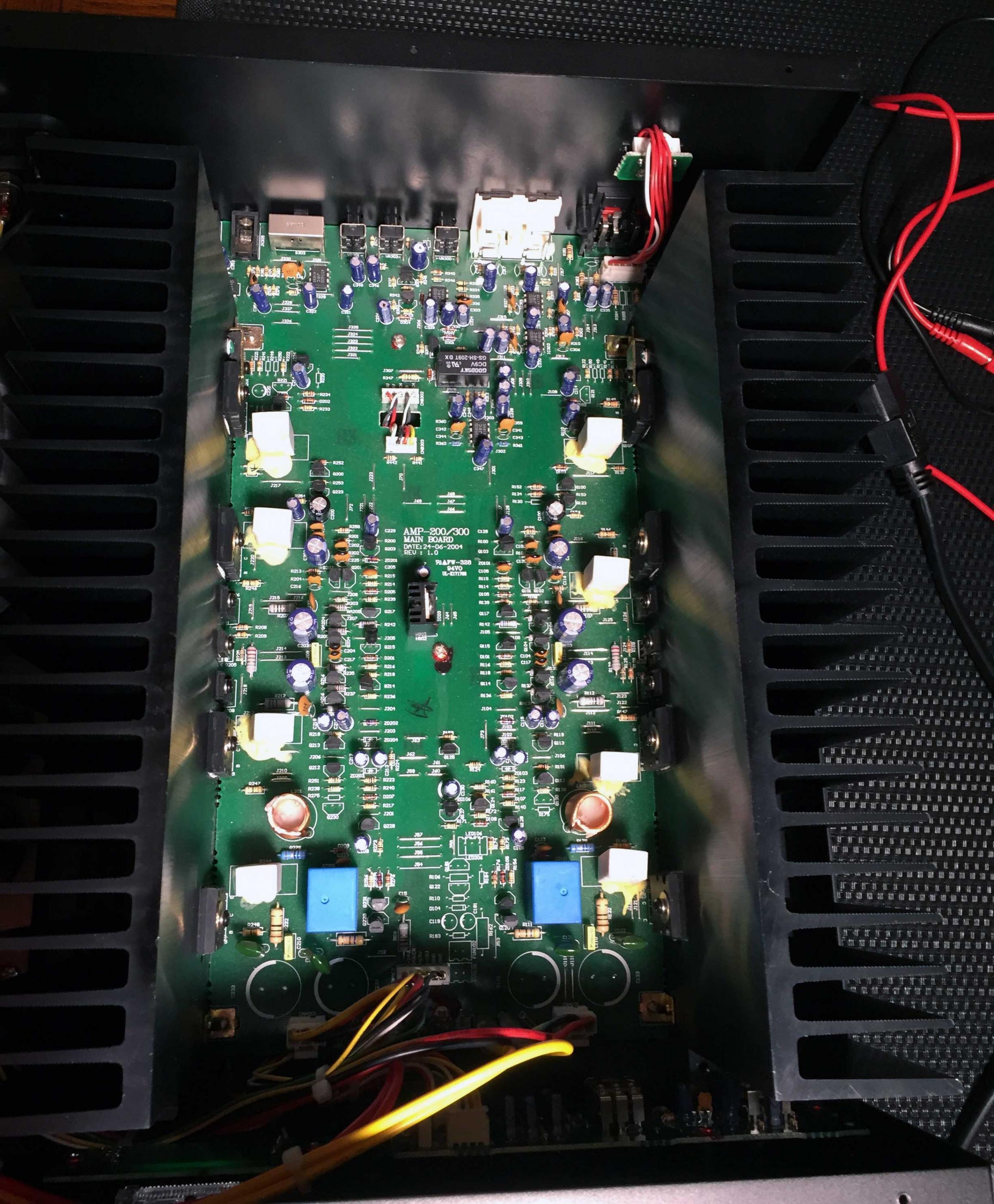

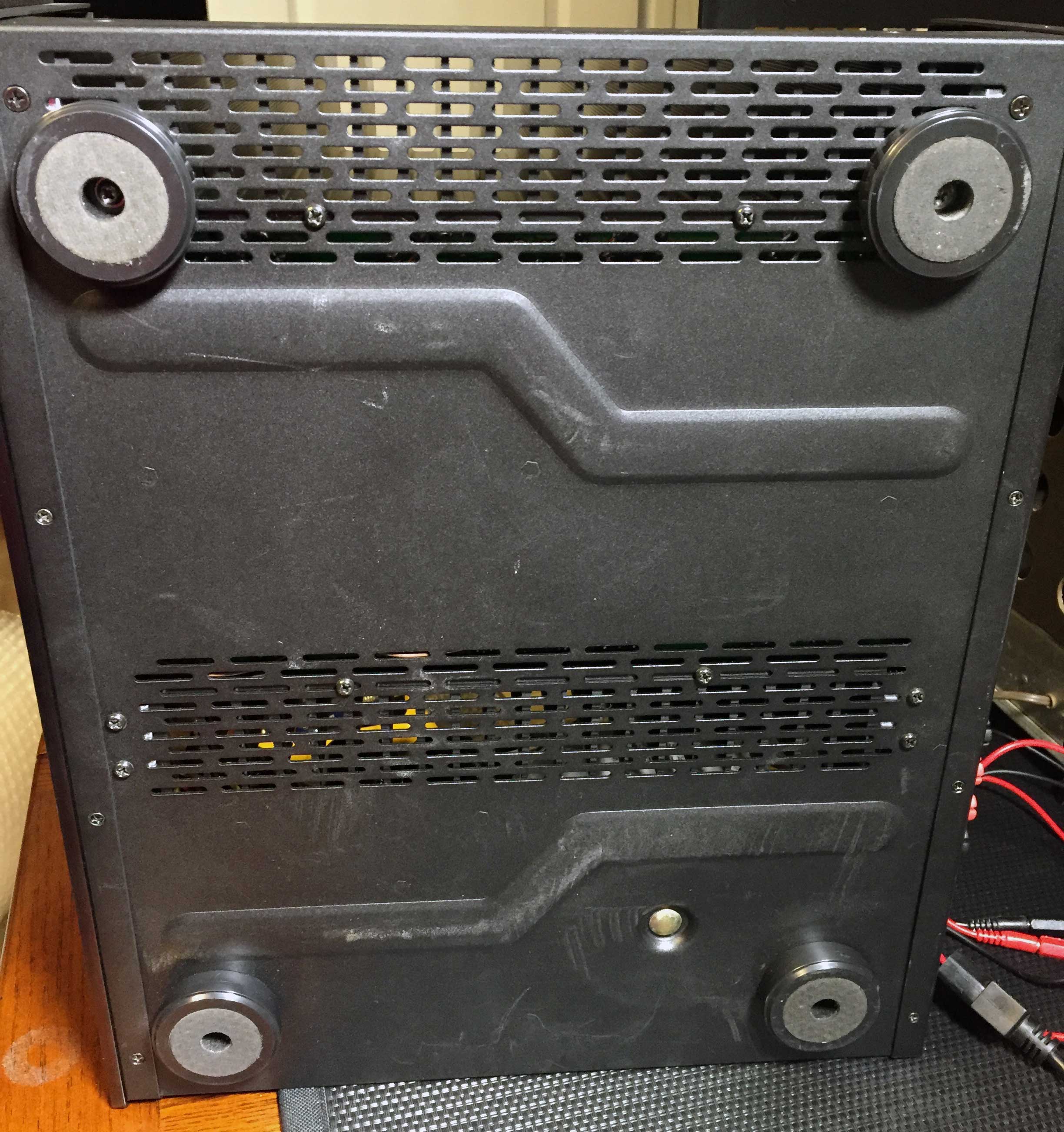

Now rest of the test are impossible right now because there is no easy access to the soldering side of the PCB. I’ll have to dismantle whole lot of things to reach the bottom. For this I need time to work on the weekend, if my wife permits 😀
See the images, its a bad design of the AMP that they haven’t given any access from bottom.

Pin 5 should be 7,5 V. Check R345 and R345 values. Solderings for cold joint.
You almost found the problem.
Check the resistance between 5 and ground.
For Q301 B and C check, you canmake tests from component side at the resistance legs going to the transistors. (R338, 339)

Value of R345 = 6.13kΩ (Power OFF)
IC303
Resistance between Pin5 and GND = 6.12kΩ (Power OFF)
Q301
At Base - ON = 0V, Trip = when it trips it shows 6.7V and rapidly goes down to 0V
At Collector - ON = 14.90V and Trip = when it trips it shows 6.0V and rapidly goes back up to 14.90V

OK, there are three relays in this amp. One for the high current voltage for the amplifier circuit, one for the input signal detection and the last one for speaker protection. Which one is de-energizing after the short time period?
IC303
Q301
B voltage is probably 0.67V , not 6.7V.
Anyway,
Make a connection from pin-3 of IC303 to the GND with a short wire and see if the amp works OK.

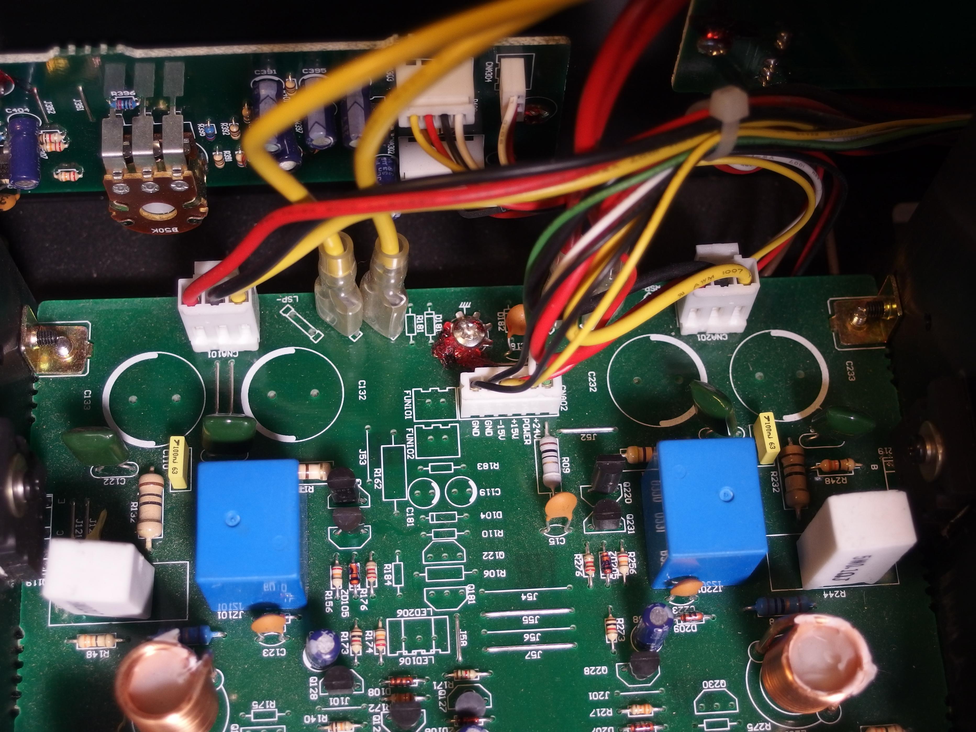

When the Amp trips, For both channels DC 64V supply remains on.
See the pic. These 2 Blue relays seems to be tripping.

OK, those are the speaker relays. Since both relays are de-energizing it has to be something common to both channels. Check your +/- 15 VDC supplies and the +24 VDC supply.
