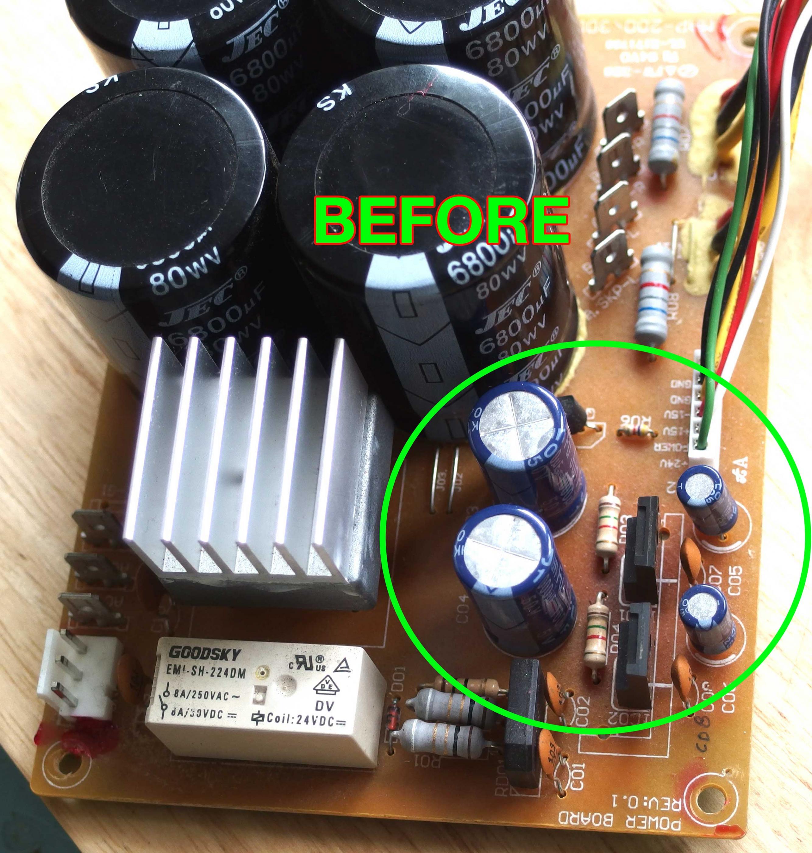

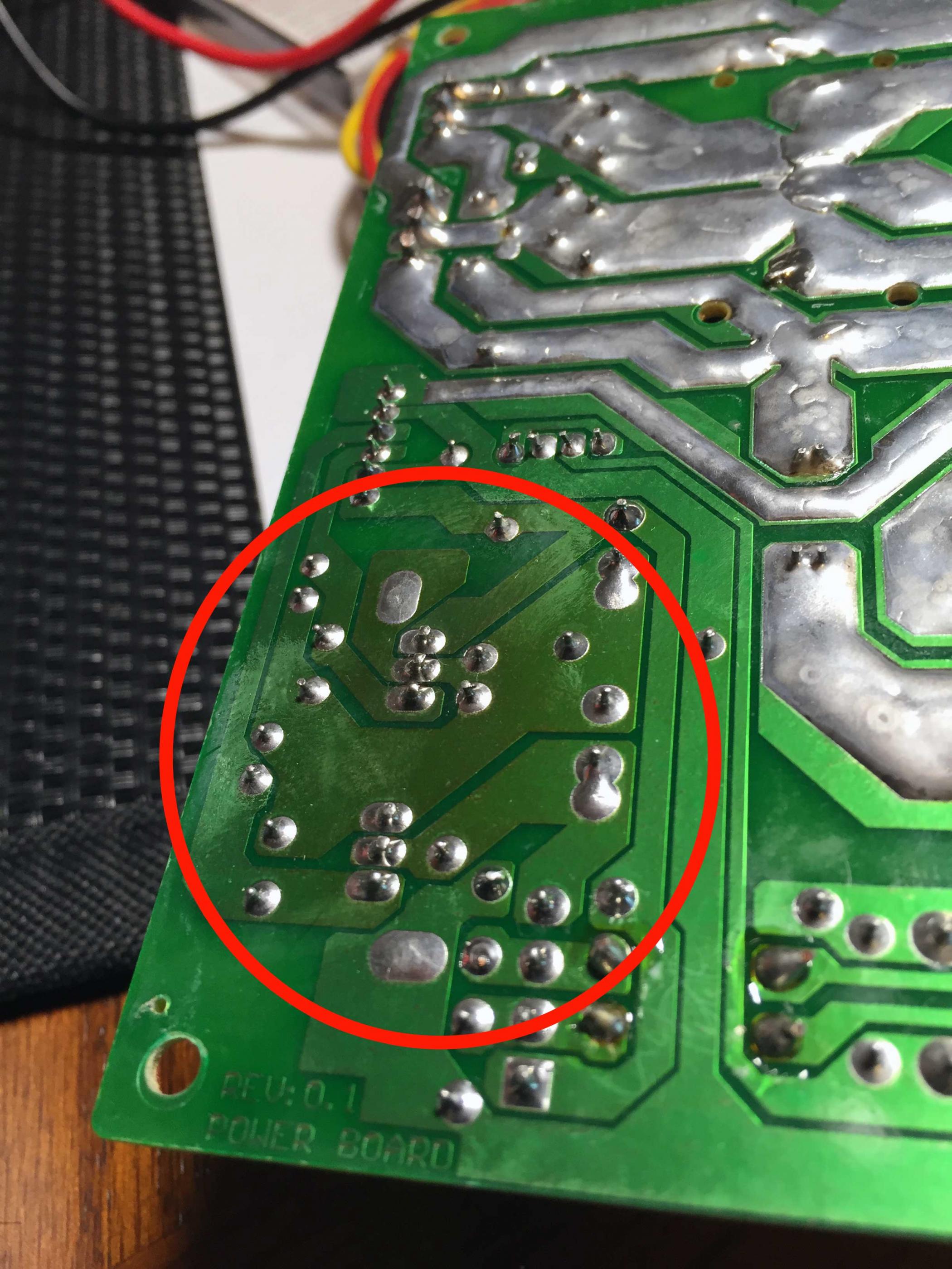

Just a little concern. I have taken out the power board and can see a over heating stain under IC01 & IC02. I have checked all the resistors, they are very accurate to the values. And I’ll be replacing caps C03, C04, C05, & C06 along with IC01 & IC02.
Is there any thing else you want me to do?
See the pic.
Ash

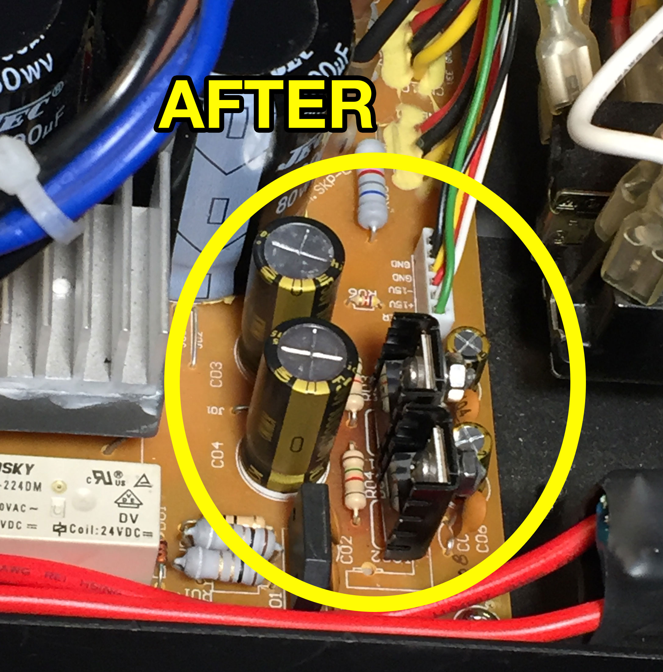

I replaced 4 Caps C03,4,5,6, IC01 and IC02. Added HeatSink to these.
Amp is not tripping any more (tested for an hour) without input or speakers.
In spite of installed HeatSinks IC 01, & 02 are running quite HOT. I can touch these but it is quite hot.
Do these run this HOT? If yes, can I connect speakers and input to test the AMP?
Voltage at -15V and GND is (-)14.97V and at +15V & GND is (+)14.70V
Please advise.

The heat dissipated depends on a couple of things, the input voltage to the regs and the current draw from the regs. I tried looking for a way measure the current draw but there are no series resistors to measure. Those regs are rated for 1A so if all of the opamps add up close to that they may run hot. Both are the same temp? Now with it running correctly go ahead and do a finger test on all of the opamps to see if there is a warm one or if you have an IR thermometer use that.
Let it cook for a while then try using it, if the same problem occurs you already know the protection circuitry works.
Craig
Just looked at the pictures, can you flip the heatsinks around to get some of the fins in free air? You can see the outline of a heat sink silk-screened on the PCB, I wonder why there wasn't one installed at the factory. That's a clue they run on the warm side.

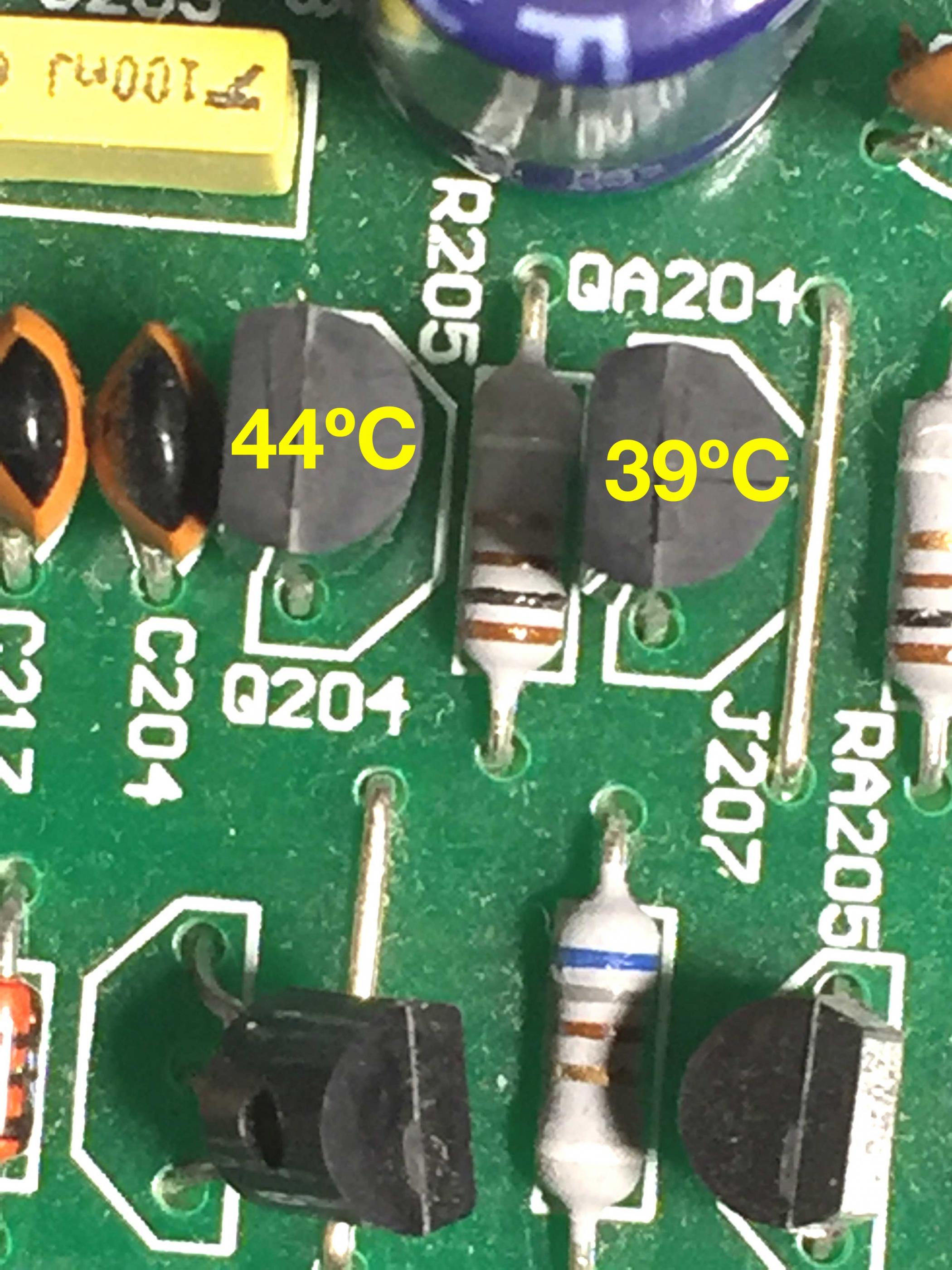

1. I tried HeatSink fins the other way but its not possible because of those 100µF caps. Thats why I have put these as per the documents. I wish I can get a thicker Dual adjustable HeatSink.
2. Temp at IC01 reaches to 74ºC (165ºF)
3. Temp at IC02 reaches to 54ºC (129ºF)
4. All the OP AMPs are running at room Temp, then I tried touching all ICs and Transistors.
5. Q204 is running at 44ºC (111ºF) and QA204 is running at 39ºC (102ºF). Rest of the Amp is fairly stable at room temp.
Your advice please!
