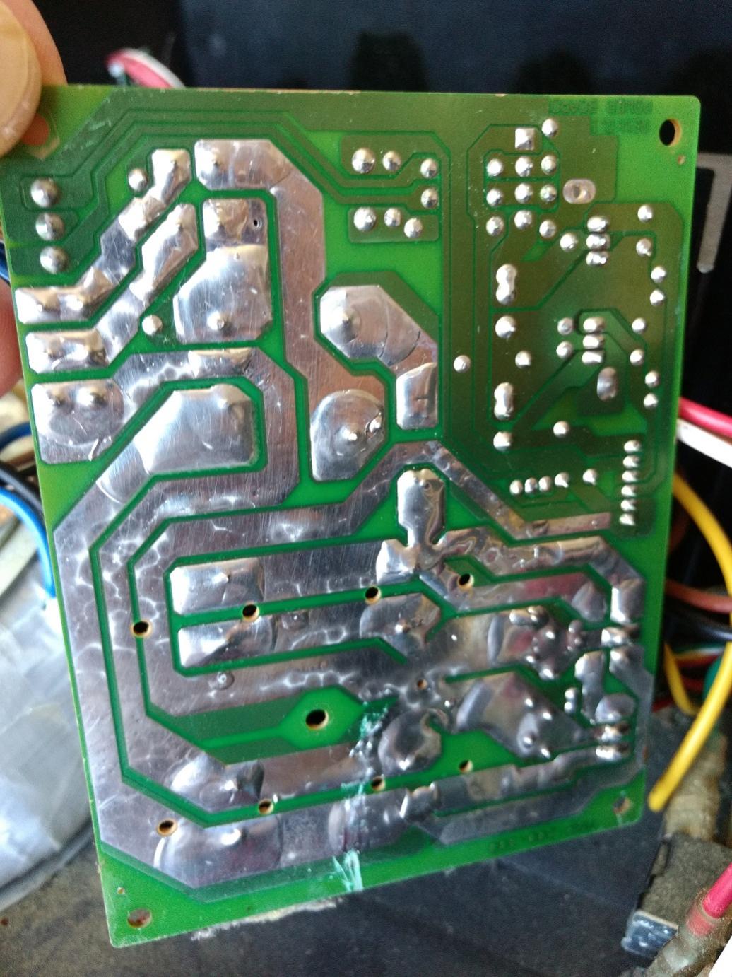

Please see the bottom side of the circuit board. Thanks a lot for your help.
I don't see anything wrong with the soldering - but my experience tells me it's the +/-15 regulator (IC01/IC02), because I have repaired 4 of these amps and all four had a bad -15 voltage regulator as the problem.
I would replace both 7815 and 7915 and buy some finned heatsinks (see pics in this thread) and you should get many years of service from the amp without a problem. First amp I fixed is going on 5 years since repair and has daily use in the HT without an issue.
