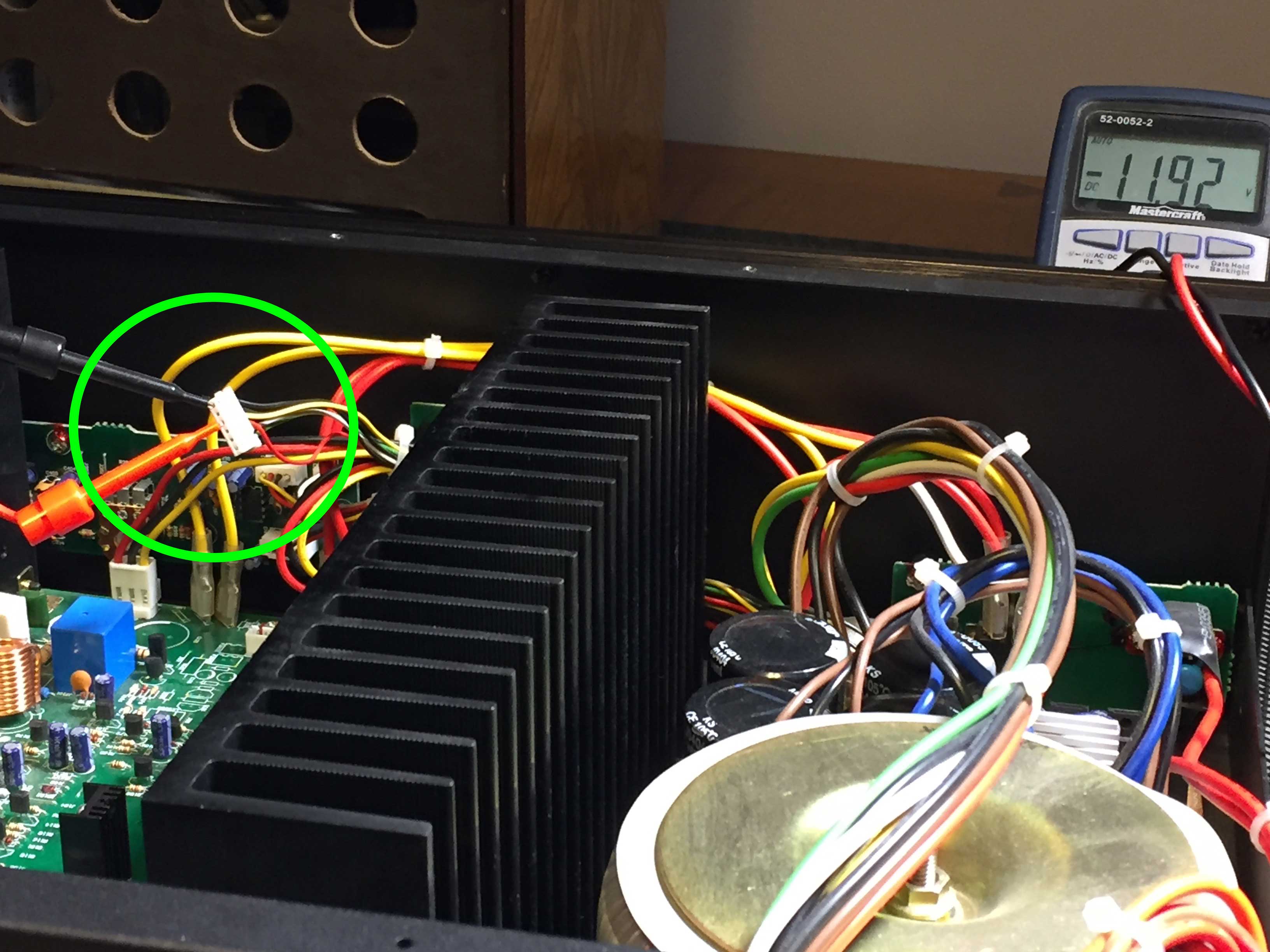

Hi Craig,
I disconnected CNA02 and eliminated power amp section. See the pic attached.
-15V started with -12.40V and started falling on its own. In 35 minutes it went down to -11.72V. It was still falling slowly when I switched off the AMP.
I think IC02 has gone weak or gone bad because after the above, I disconnected CNA302(input section), and powered the AMP, It tripped again like always. May be IC02 is not able to handle the load.

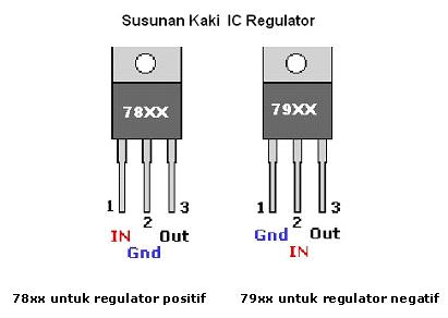

Looking at the face of the device left to right, 1,2,3. The 78xx series, +, are easy to remember, input on the left, output on the right. The 79xx series, -, are different.
Units without removable bottom covers suck the big one. Absolutely a PITA to work on.
Craig

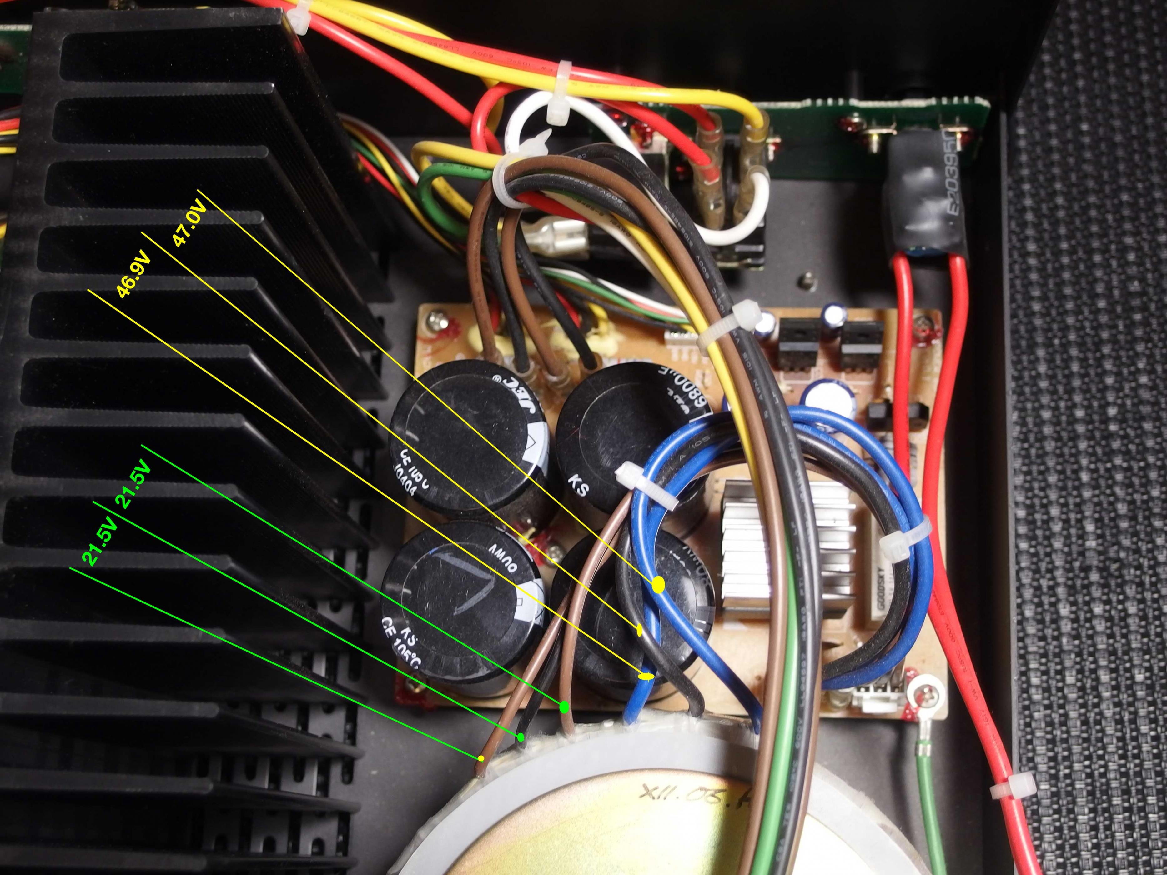

I checked the voltages.
Transformer wires are Blue/Black/Blue – 46.9V and 47.0V
Secondary wires are Brown/Black/Brown – 21.5V and 21.5V See image
Input Voltage at IC01 7815 ~ (+)28.9V
Input Voltage at IC02 7915 ~ (–)29.0V
