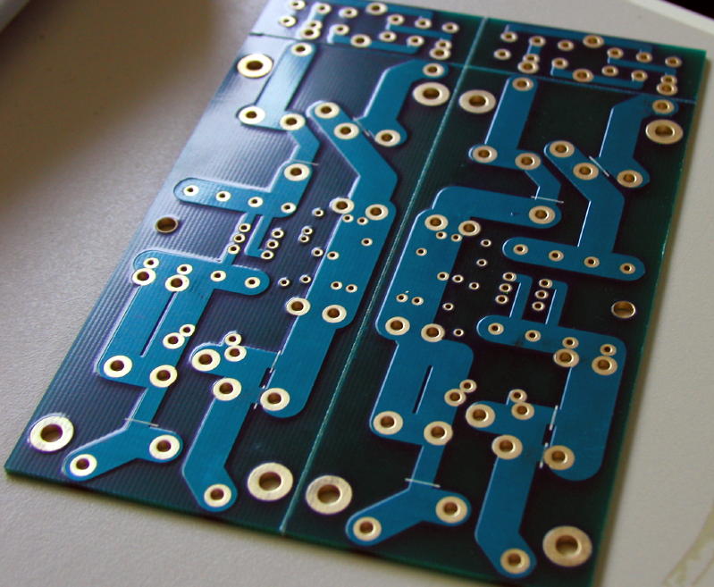

on your audiosector PSU boards, do the lines on the front side of where the diodes go mark the locations for the common-cathode diodes? If I use these, do I still need to populate all four locations (I would assume only 3 of the four are necessary)? Also, if you use the Jensen 4-pole caps, then you need to cut the 5 traces on the back and then just use the output pads on the far right of the boards? Finally, is there any reason that I cannot "share" the input pads between the bridge and the first capacitor for the R9/R10 that NP uses on the F4? This is a 2.2k resistor that goes from the rail to ground before the first capacitor ... I would then bring the excess leads up from the back to connect to the rectifier portion of the board...

Those boards have been described here: http://www.diyaudio.com/forums/showthread.php?postid=1237660#post1237660 The dual lines mark the metal tabs of TO-247 diodes. While you only need 3 of dual cathode diodes to build a bridge, the board requires 4 of them (unless you modify connections). The reason for that is compatibility with other diode types one may choose to use here.
If you use Jensen caps, to implement 4 pole feature properly, you need to cut traces underneath in 5 spots, marked by white lines (see attached pic). That will separate input and output pads for 4 pole configuration. In that case output is taken from far right pads (V+ and GND).
If you want to use 2.2k resistor, it's best to install it accross the pins of first cap, (separate resistor per each bridge).
