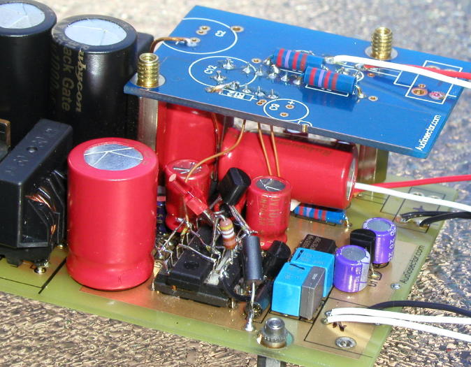

Ok new pics 🙂 All in the proper place *LOL* Not quite as perfect as the first time around but clean enough for me. Was a pain de-soldering the caps and re-installing them

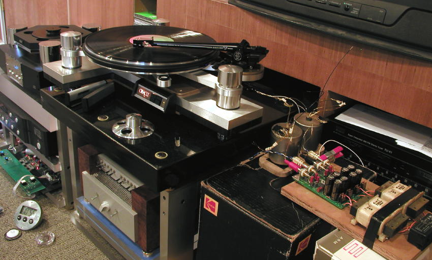

Below picture of my original setup.
I'm glad you like that phono amp. For anybody intersted, the circuit was described here: http://www.diyaudio.com/forums/showthread.php?postid=1123520#post1123520 (RIAA section based on VSPS)
It was actually the first phono stage that I've built recently and the one that I still have the biggest sentiment for. I later tried phono cube clone (the real one) and Pass Ono, but none of those played that good without the need for extensive mods and tuning. In fact, none of that is completed yet.
