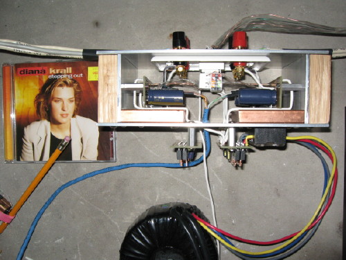

Final version with lightspeed attenuator
I worked all day Sunday on the lightspeed attenuator. It was pretty tedious work to test couplers to come up with two pairs with matching specs across the attenuation range. I installed it all and took a leap of faith by hard wiring onto the chipamp pcb without first testing the circuit.
Got a good night's sleep and then double-checked all my work with a clear head. With some trepidation, I hooked it up and powered up... whew. It came to life and sounds glorious.
I'm not an experienced audiophile, so I don't pretend to have all the critical vocabulary to describe the results, but my impressions follow so many other posts I have read but never personally experienced. There is a whole new level of sound on all my CDs. Soloists take a breath between notes. It's like they are alive and in the room with me. It's up close and personal now. At even modest volume I got a spooky feeling in my spine as notes kind of startled me. Bass is fully extended but controlled.
Drums are drums. Cymbals decay in the background as the music carries on. Bells and triangles ring as if they are in the room.
I played Dianna Krall. The placement of instruments is precise. Her voice is up higher than the piano and comes from deep BEHIND the stone wall of the fireplace that the amp is sitting on.
Again, hearing her breath is spooky.
The mechanical sound of the digital source has left. After an hour or so I realized that I was not listening to the stereo any more but was listening to the music. I figure this is what the whole goal is.
Here is a picture of the finished amp. The optocouplers are at the end of the blue cable and their signal leads are soldered to the input spots on the chip amp board. Their input leads go to the CATV via 3 fine silver wires on positive and one 24 gauge copper on negative. The blue cable goes to a separate power supply and cheap pot that acts as a dimmer switch for the LED’s to control the resistance of the photodiode. It was easy to wire in a balance control without losing any quality as it is not in the signal path, its in the dimmer circuit. So Cool!

optocoupler attenuator
Here is the final pic. It's the attenuator under construction. A simple design following the design by georgehifi on this forum. Thanks George!
I used the version modified to include a balance control.
http://www.diyaudio.com/forums/showthread.php?s=&threadid=80194&perpage=10&pagenumber=59
My innovation was to wire it directly to the chip amp board. To facilitate this approach I simply glued two sorted couplers together rather than putting them on a separate board. I guess it reduces the flexibility of having a separate passive attenuator component, but my design goal is to produce a single integrated unit with all the characteristics of the best preamp, amp and DAC I can build on a budget. I don't plan to be changing components a lot, and I like the idea of one compact unit without a bunch of interconnects. I also came up with a rig to do the testing of all the optocouplers at once which took hours off the project. I'll post pics if anyone is interested.

Where did you get the optocoupler for the lightspeed attenuator. Last time I check, they were very hard to get.

I ordered them thru Allied.Algar_emi said:Where did you get the optocoupler for the lightspeed attenuator. Last time I check, they were very hard to get.
Thanks...
http://www.alliedelec.com/Search/Pr...ESC=NSL-32SR2S&R=699-3011&sid=46B90780C26617F
I am in Toronto. I placed the order on Monday, and they were delivered Thursday.
I ordered 8. They were all from the same batch and I got 3 matched pairs out of 8.
