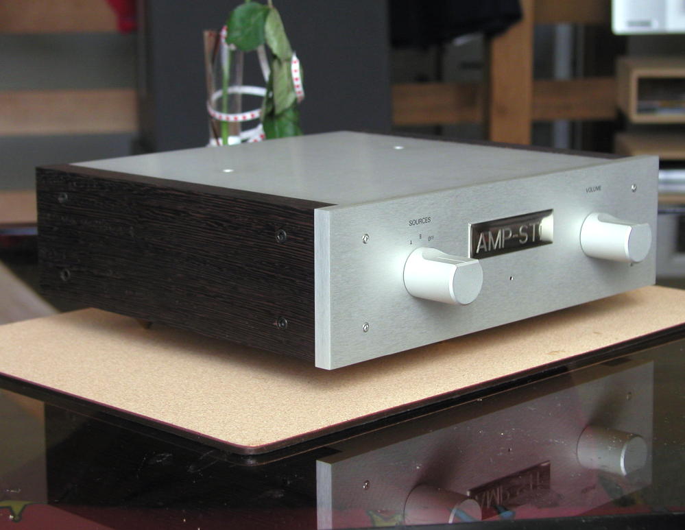

Whats the word on those chassis do you offer those still? Saw it in the beginning of this thread and that one with the burl looks excellent. If you do offer them whats the cost?
Dougie085 said:Hey Peter,
The chassis pictured here: http://audiosector.com/chassis_integrated.shtml is available as a kit at $250. All accessories are extra.
Mardone Burl is hard to come across and I can't really offer it with a kit, but most other wood choices are possible.

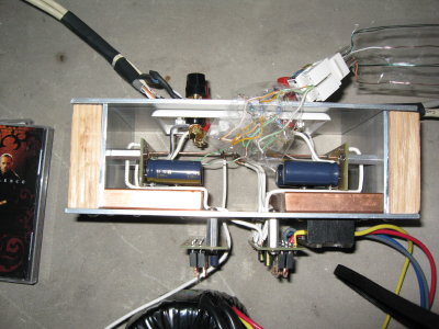

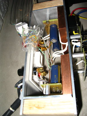

Query about grounding LM4780 kit
Hi all,
Ive recently built peters LM4780 kit, and have found the results fantastic!
Everything working great and now considering more tweak.
I am unsure what to do grounding wise when i move to a aluminium chassis (next week, wood at moment).
I have the speaker grounds going to the OG points on the pcb, and my input grounds going to the SG points on the pcb. At the moment (i know i shouldnt do this) the ground off the mains socket is not connected to anything.
In the aluminium case, i am planning to ground this to the case, but i am not sure where to take the ground from on the LM4780 pcb or the power supply pcb.
Im using one power supply pcb and one lm4780 board in stereo.
Adam

Thanks for the info,
I believe ive got things correct now.
Above post is a great source of info, thanks

Another Peter Daniel amp springs to life
Peter,
I am pleased to report that another of your kits has sprung to life and you have another very happy customer.
I really took my time to build your kit, as I wanted to get it right the first time out of the gate, as I am new to the DIY hobby.
I have to report that I am very happy with the results. After reading all the threads and looking at many pictures of the many creative designs I finally committed to a build. I attach pictures of my work in progress. I wanted to have a solid chassis design. I used solid copper blocks for heat sinks and encased the chip amps in aluminum sheet metal. I kept the layout simple to really reduce signal length.
I put the rectifier just on the other side of the heat sink so the path for power would be short, but fully shielded. I sprang for a Plitron transformer with 24v 300va spec, and I am most pleased with the choice. When I turned it on I wondered if it was working, as there was NO sound from the speakers. Until I hit play on the CD and great sound started. It took 2 - 3 hours of burn in before the sound started to open up, and after 100 hrs it still keeps getting better.
In the pictures the attenuator is a temporary shunt with cheap metal film resistors to verify that it would work well with a passive attenuator with 8k impedence. My next step is to build a Lightspeed attenuator based on Silonex optocouplers. I plan to put the couplers very close to the board, as I understand that the attenuator is part of the feedback loop and it just seems right.
Ultimately I will build a Peter Daniel NOS USB DAC and hard wire it to the amp with short signal paths. The whole thins will go into an old case from an integrated amp.
I plan to use solid gold signal wires 3x30 gauge on the + and 24 on the neg in accordance with very interesting posts on audiogon. In the mean time my source is a 20-year-old sony cdp and it sounds unbelievable to my ears.
Speakers are also recycled 20-year-old Boston acoustics that I refoamed and rewired. It was amazing to me what a difference wire can make. I am using all CAT5 Teflon in the speakers and cables and its pretty good. Ultimate plan is for silver on the speakers and gold on the interconnects.
One innovation I am proud of is the use of a CAT5 connector in place of RCA plugs. I did a lot of reading and came to the conclusion that RCAs are just too massive. Some of the expensive and exotic connectors available commercially are merely very low mass in the out of date form factor. The CAT5 connector deals with megahertz data paths and should handle the delicate audio signal. To me it was a great step forward and only $5. I use pins 1 & 6 for left and right positive and 3 & 8 for ground.
I'll post a couple more pics and follow up once it’s all in a case.
