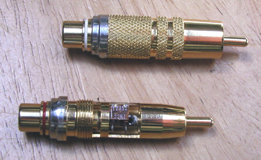

Andrew Rothwell does some good in line attenuators. They also can make them to suit the attenuation you require.
http://www.rothwellaudioproducts.co.uk/html/inline_attenuators.html
