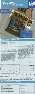

Below test report on Premium amp (kit) published recently in Hi-fi news.

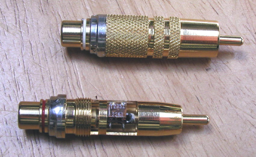

Peter Daniel said:Changing the gain by adjusting R3 may affect sonic signature of the amp. Placing 22k input series resistor (in place of R1=220R ) shouldn't probably have that much effect.
I didn't try any of those methods though, as I'm not using any active preamp and more amp gain was always desired.
I don't use an active pre either, but I have very efficient speakers and I've had trouble with too high gain earlier. I guess the best thing is to try both methods. After all, some resistors won't ruin me.
Frode

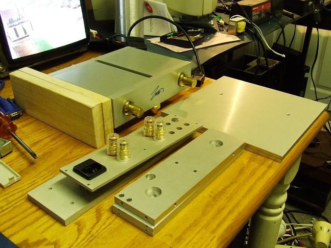

hi peter i just started unpacking some of my audio from the move and i have lost the screws to my Integrated Chassis. i was wondering if i sent you a money order to buy the high end dac 1
chassis for $220 would you have any screws i could get off of you? im in a real pickle here i should have kept it together🙄
if so ill e-mail you with your webpage e-mail for your mailing adress
thanks
dave
