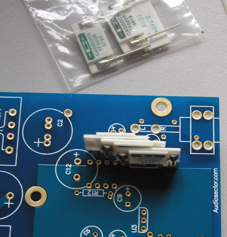

Actually R8 and R9 are first to be replaced. Those are I/V resistors and if you check the traces underneath, they both connect with output coupling caps. In some setups using Caddocks here, in place of Rikens, may be beneficial (but may still require choosing different output caps).
Recently it's been brought to my attention that placing Caddock TF020 for R7 also improves things a bit, so you may try it as well (1k5)
All 3 Caddocks will fit in top layer, R7 needs pin properly formed.

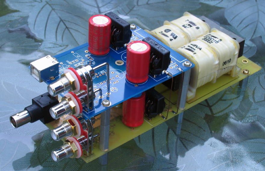

I made a similar setup, in case both SPDIF and USB DACs are needed (and fed from common supply). I didn't want to go into switching I2S lines, not to compromise the performance.
The rectifiers and C1/C3 are common to both DACs, everything else is separate. The supply connections are done through pair of wires on each side, from the pads sideways to rectifiers (now you know what they were intended for 😉
You may install 2PDT switches on each side to disconnect power from DAC on top.

It looks like the PCB cut could be made to feed the second board from the first transformer secondary (so the PSU diodes, caps and inductors would be duplicated); or you could cut it right behind the inductors and make the connection at R1,2,3,4 (so none of the PSU would be duplicated). To switch the PSU between the two boards would require a 4PDT switch? Any suggestions?
