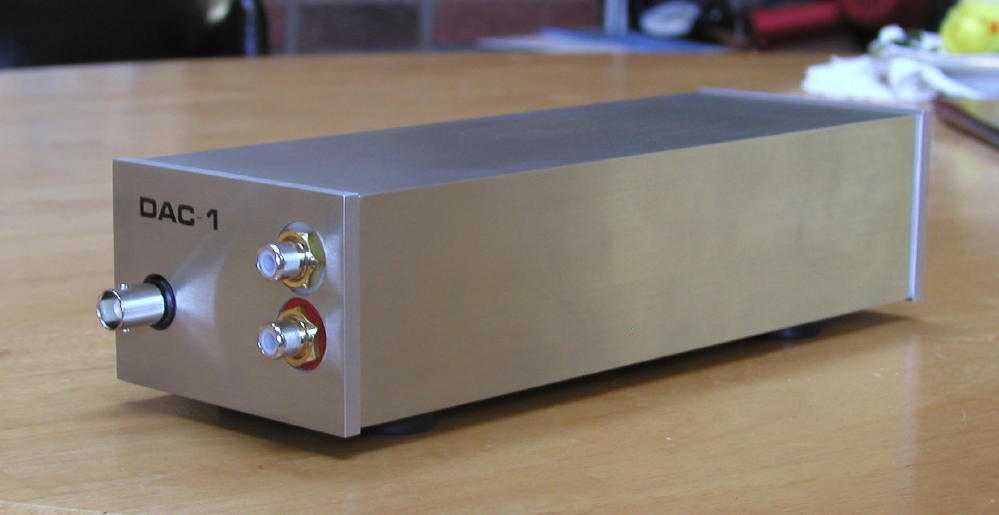

Would you sell that chassis for your DAC-1? Or do you even have them. Probably be expensive though.
Dougie085 said:How much is your DAC-1?
$1,295
http://www.6moons.com/audioreviews/audiozone5/system.html
Ha! Talk about value.
