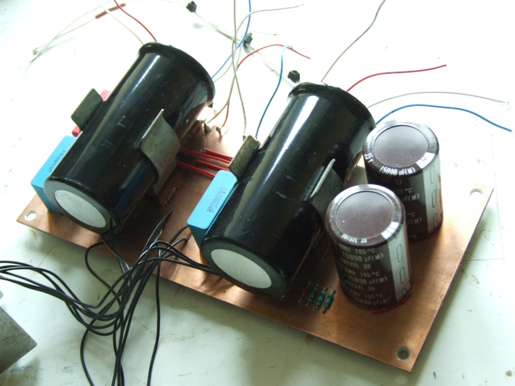

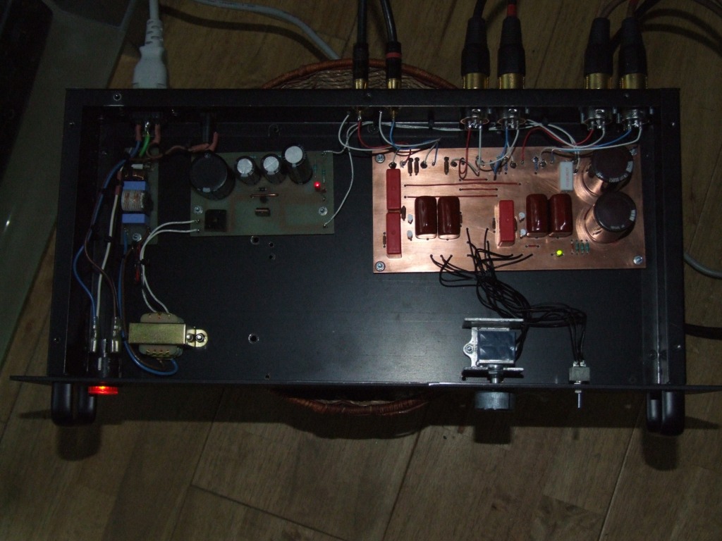

I went through this exercise with my Pass B1. I started with Wima, then onto the AudioPhiler and then onto Obbligatto. There is an audible difference but it is very small.
