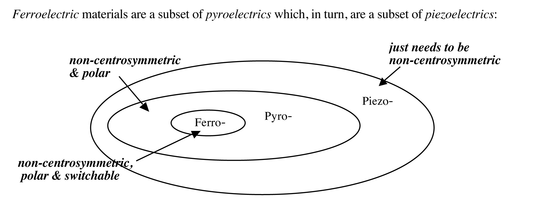

Piezoelectric effect is complex enough to hide it under the carpet, note that PTFE capacitors are quite microphonic because PTFE is quite piezoelectric.
Are you sure ajout NP0 being piezo ? Kemet says : "Note that there are no measurable piezoelectric effects in Class 1 capacitors, such as C0G or NP0"
Mike Turner from Kemet says
sic "All ceramic caps exhibit some form of piezoelectric effect."
IMHO. The symmetry requirements for zero piezoelectric effect are huge, and of the 32 crystal classes, 21 are non-centrosymmetric.
Marketing strategies, manufacturers want to sell billions of caps, sometimes they lie.
