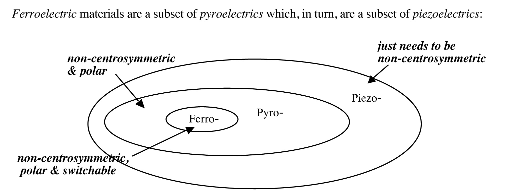

Crystal lattices lacking a center of symmetry can exhibit piezoelectricity.
There are four possible crystalline phases for PVDF, α, β, γ and δ.
In the α-phase, PVDF has the crystallographic point group symmetry 2/m, which it is centrosymmetric, then it cannot exhibit direct piezoelectric effect, however, it exhibit flexoelectric effect, i.e. polarization induced by the strain gradient, second term in (*)
In the β-phase, PVDF has the crystallographic point group symmetry mm2, which it is non-centrosymmetric, and then it exhibit direct piezoelectric effect, first term in (*); even more, into this phase PVDF is ferroelectric, and hence it is also pyroelectric.

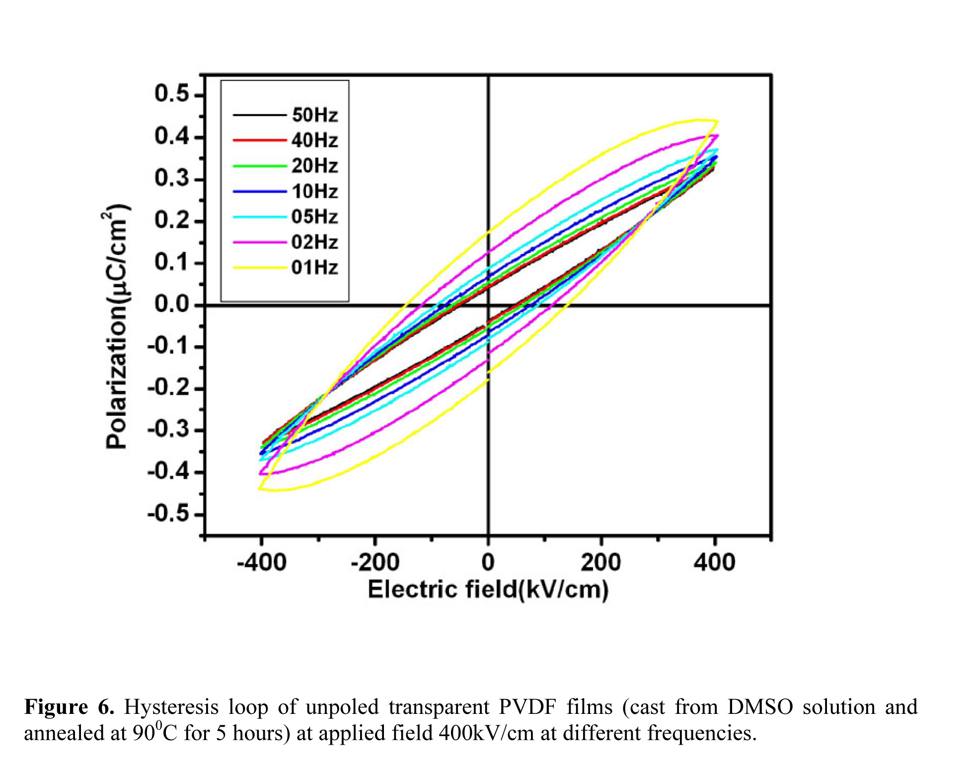

The most conventional method for production of β-PVDF is uniaxial stretching of α-PVDF, or annealed above 80 ºC, poling is not always necessary.
