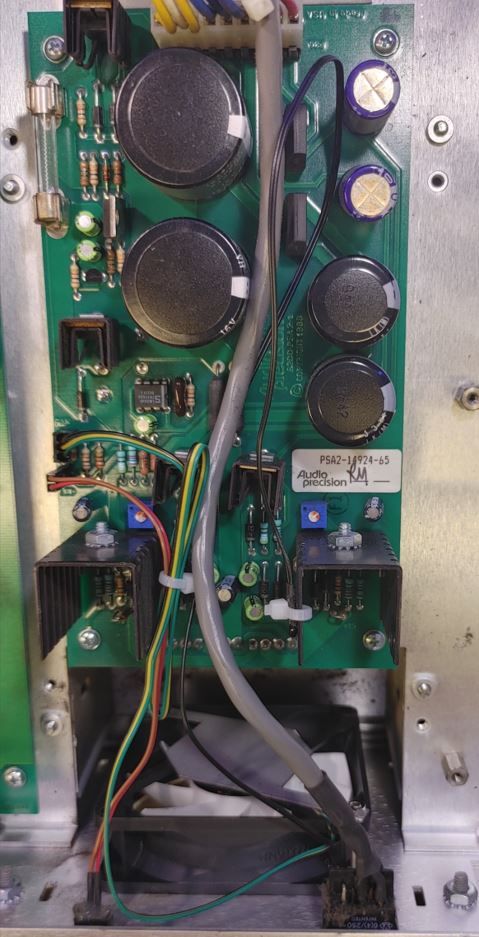

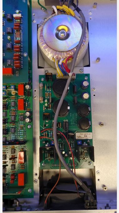

My experiece replacing the annoying fan in the AP-S1.
It turns out to not be too difficult. First get one of these: ARCTIC F8 TC - 80 mm Case Fan https://www.amazon.com/dp/B0037AUS4S?psc=1&ref=ppx_yo2ov_dt_b_product_details Its a temperature controlled fan (slows down when cold) that is an exact fit and has the same specs as the original fan (also available from Jameco still but why?) Its also at least 20 dB quieter.

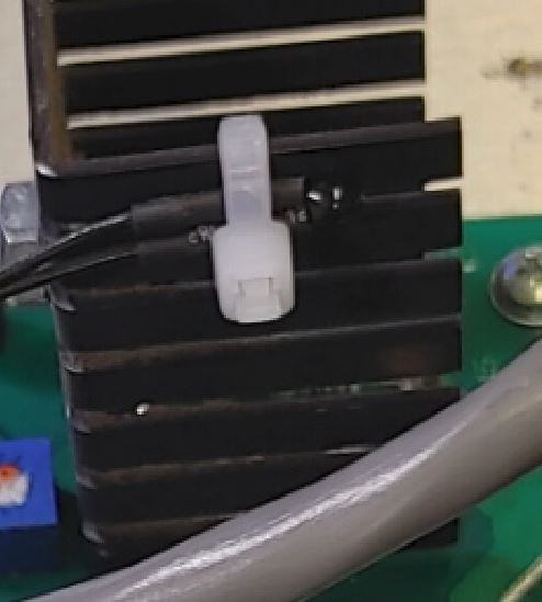

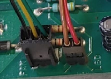

Disconnect the cables and power cord (you will be working close to the power) Turn it over and open the bottom and remove the center shield to expose the fan. The fan has magnetic shields on the front and back (odd flat pieces of steel blocking some airflow). These are important since the fan can radiate a lot. They need to go back. The fan is held in place with two screws. They can be hard to remove. I think there is locktite on the threads. The nut lower inside is challenging to reach. The new fan has a 3 pin connector for power. You can ignore the third pin and it reaches and plugs in where the old one came out. Insert with black on the same pin that was black. I attached the thermistor to one of the larger heat sinks assuming its a suitable hot spot.
Pictures attached.

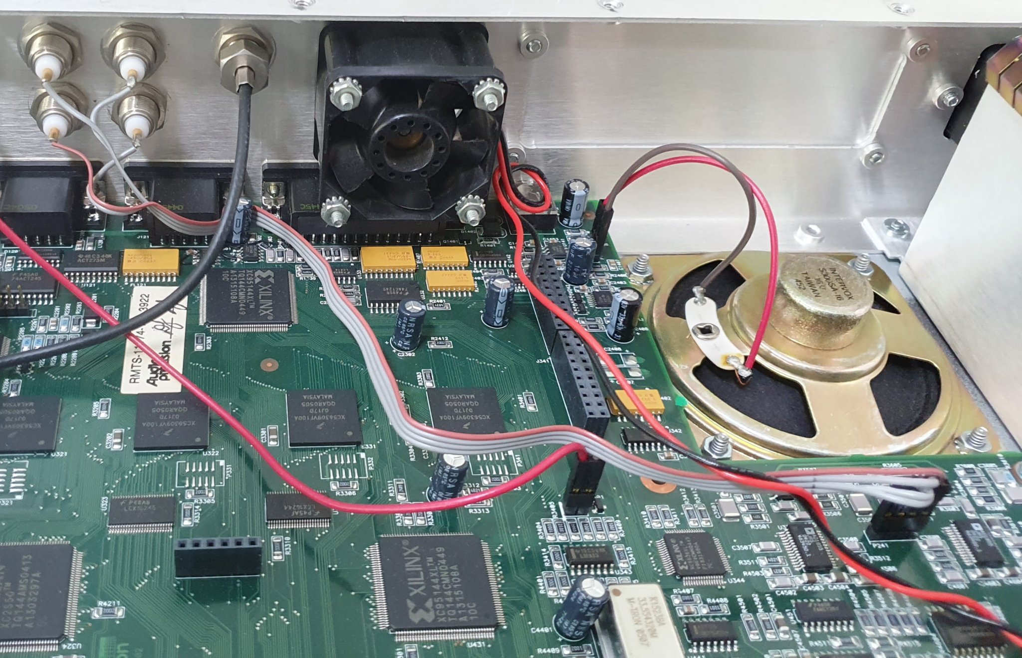

Demian, I just acquired an almost-new ATS-2 (can't stay away from these critters!) witch has a very loud fan, probably because it has been sitting still for years. After several hours of runtime, still very loud.

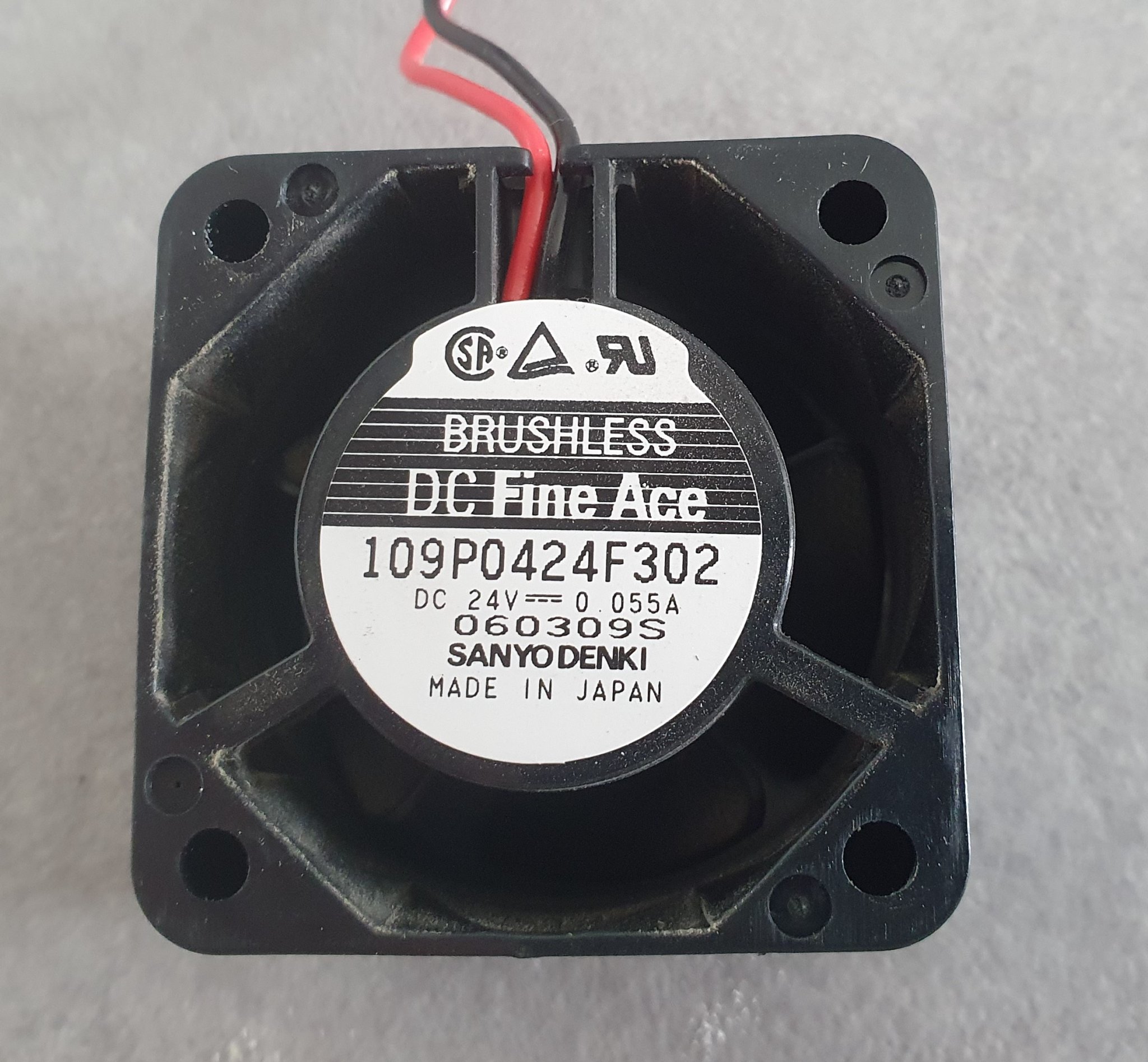

It's a 40mm one. I will dismantle it (easy in the ATS-2 since it has only a single level board) and see what it says.
Jan
Jan
Silicon lube doesn't really help, but what is apparent is that the mechanical contact to the enclosure produces most of the noise.
A couple of grommets work wonders.

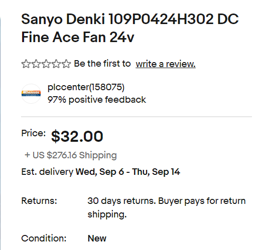

@jan.didden These small but thick Sanyo Denki are typically very loud (and very reliable), they are commonly used in hot-pluggable server power supplies (12V versions).
