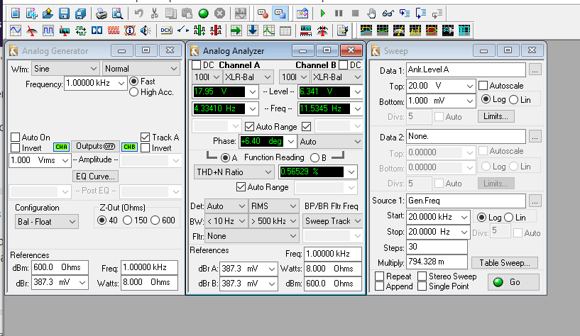

Maybe by measuring phase shift and/or phase noise? That's simple with an AP. How would you do it, with a multimeter?
You have a very strange idea about an AP.
It's a measuring equipment. It can do all sorts of measurements that are hard or impossible to do with other equipment, and as such is very valuable for serious designers. It is too expensive for most diy-ers, but then again most diy-ers are not interested in the details of designs either.
To each his/hers own.
Edit: maybe you are confused because you don't see any knobs or meters on the AP box. That is because it is all controlled from software.
Download and install the software and run it in demo mode. Or read the user manual.
Your life will never be the same again 😎 and you will no longer ask these strange questions here!

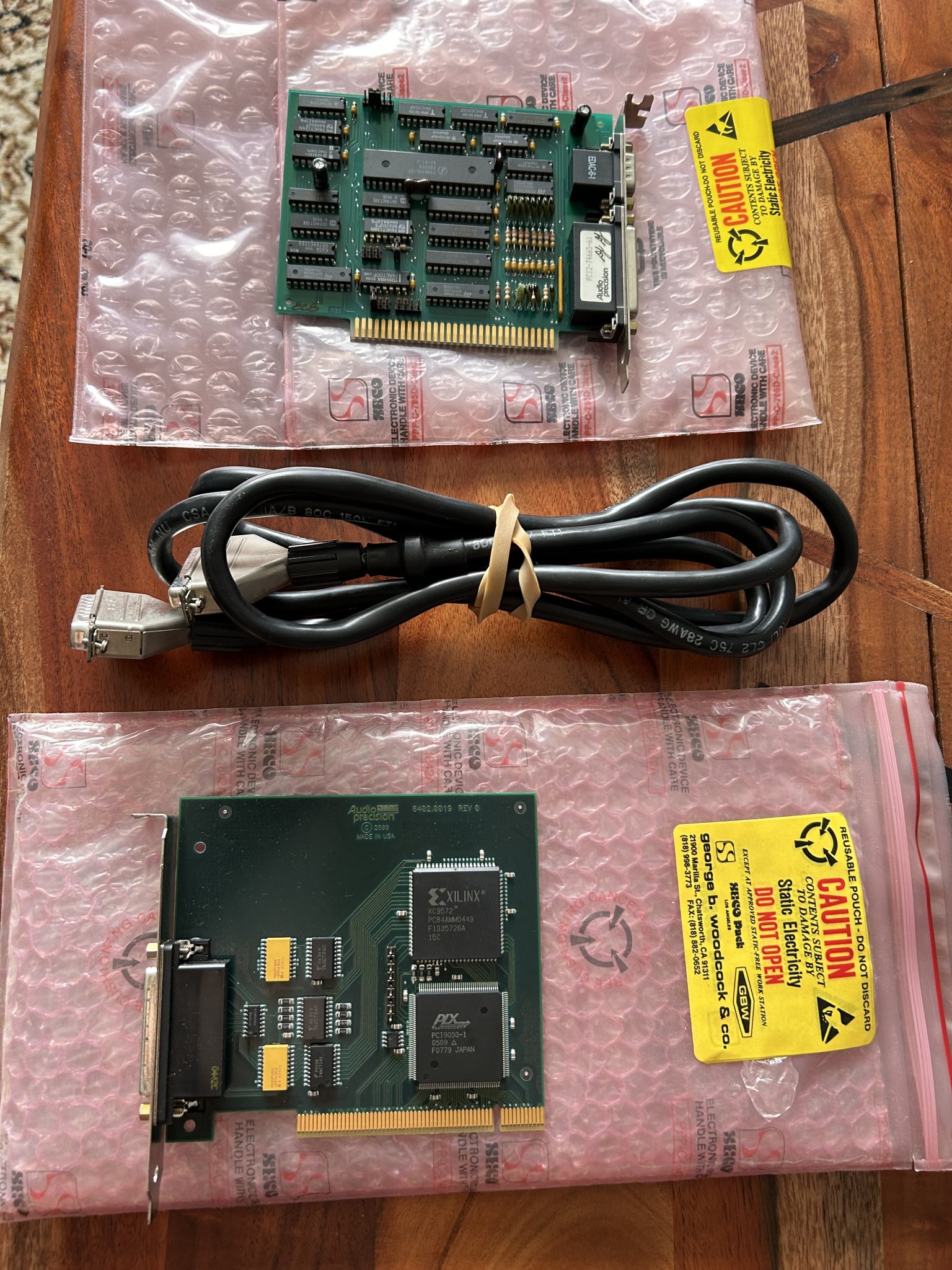

Hi Bob:
I have both ap interface cards. The ISA card (top board) only works with DOS version (S1.EXE). The PCI card (Bottom card) works with windows version of ap software. The AP interconnect cable is included.
You need to have a pc mother board with PCI slot.
Asking price for the APIB PCI card with cable is $600.00
Art
