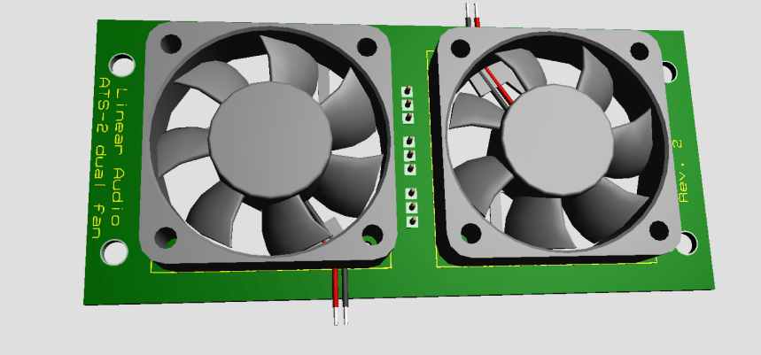

I got two of the low noise fans, put them in series on 24V and they run fine. Looking at the voltage division there's some wobbling but no more than 1V so that seems OK.
I also noted that at the back of the ATS-2 there's a cover on a slot which probably is for some option connector.
It is almost - not quite, but good enough for goverment work - as wide as the fan dimension, so they will be mounted on the outside.

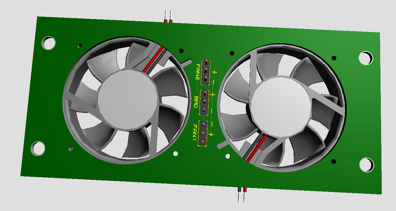

I will replace that cover with a custom PCB holding the two fans so I get almost the original air flow but almost inaudible.
The PCB will also have the headers for the necessary connection.
The nice thing is that I can convert back to original with no changes to the case.
Sometimes you need to go off on a tangent I guess ...

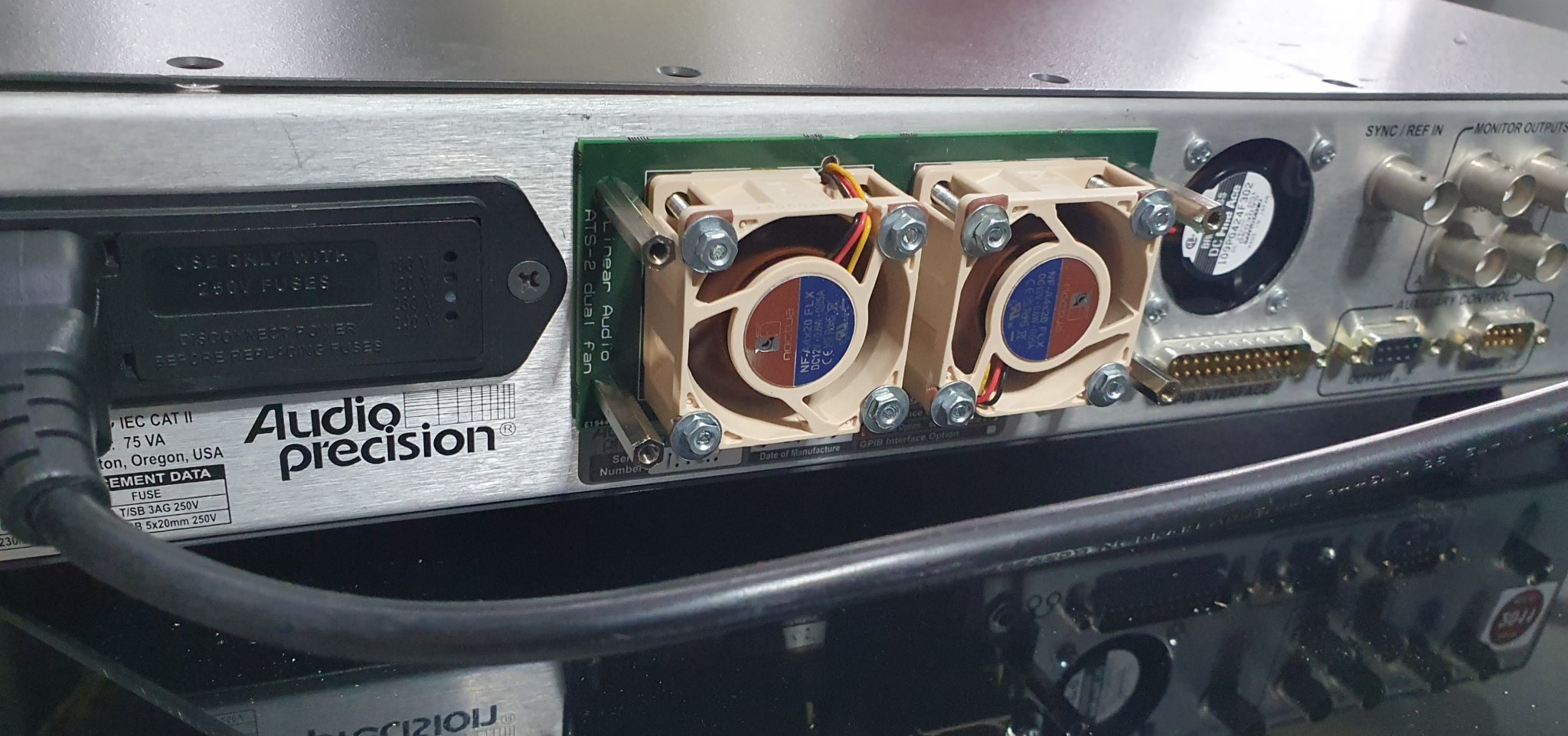

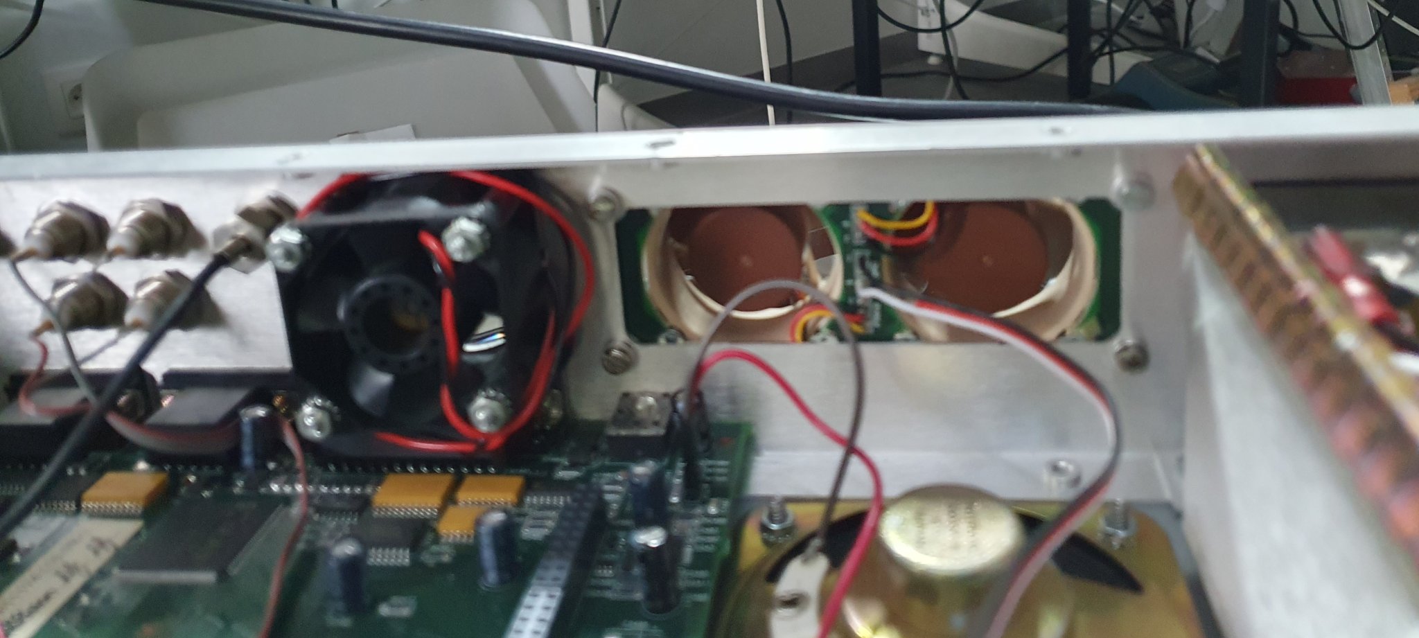

It's alive! Mounted two low noise fans where the GPIO slot sits.
It's running well, although I do hear a slight beat as the two fans don't run at exact same speed.
But the noise is much, much lower now.
I just have to keep an eye on the air temp initially to make sure the air flow is sufficient.

Hi Jan
During the development process I calculated the power and then put a few DALE POWER RESISTORS inside an SWR box and ran thermal testing. This lead me that, the box size needed to change and fan was requred.
If you can place your under side of your arm flat on the cover of the ATS2 after 30-40 min of power on you fans are working GREAT.
The ATS2 runs about 45 watts and without a fan the MTBF is poor.

Hi Duke,
Actually the only part of the ATS box that becomes appreciably warmer is the rear right side where the power supply regulators are bolted to the side wall. The rest stays almost at ambient.
Interestingely, I had one case when the fans didn't immediately start up but oscillated between the two.
Took a few minutes, then they both got up to speed.
I'm thinking what I can do to prevent it occuring again, maybe a 15V zener across each to avoid one hogging all the voltage?
