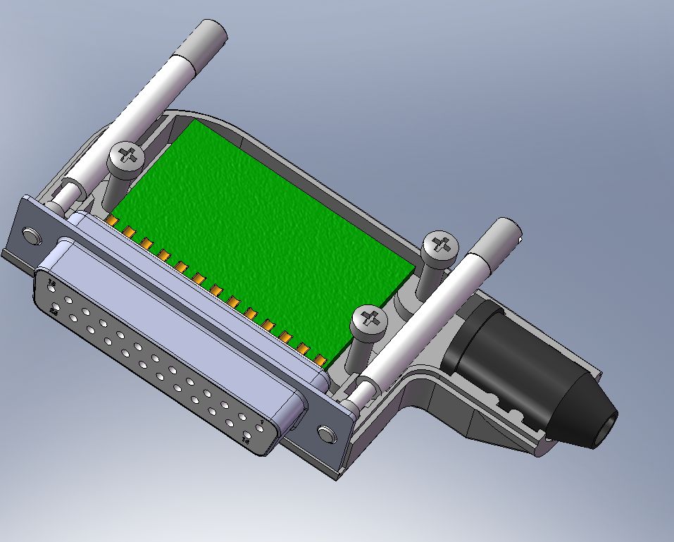

Would be nice if the hole circuit can be built into the connector housing.
(The attached picture shows that the print dimensions should be smaller than
25 x 35 mm)

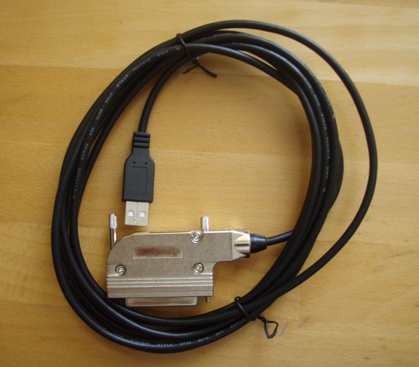

Update April 2016:
Meanwhile the USB adapter development has been finished 🙂
Some photos of the adapter can be seen on page 2 -
actually the hardware was the fastest part!
The adapter works with APWIN 2.24 and supports S1 and S2 up to Cascade
and any peripheral which is supported by APWIN 2.24.
Supported operating systems are Windows XP, Vista, 7, 8 and 10.
The greatest delays were because of missing hardware for testing.
During development tests my S1 shows various signs of dying slowly.
This was caused by connector contact problems.
John helped me to repair my S1, and now it is working like new 🙂
Michael and Duke helped a lot with finding remaining errors in S2 and
in optimizing the speed. Evan did a lot work on reverse engineering the bus timing.
Many thanks!
Anyone who needs an adapter: please send an email
with your shipping address to apusb@krebelder.at
Thx,
Udo

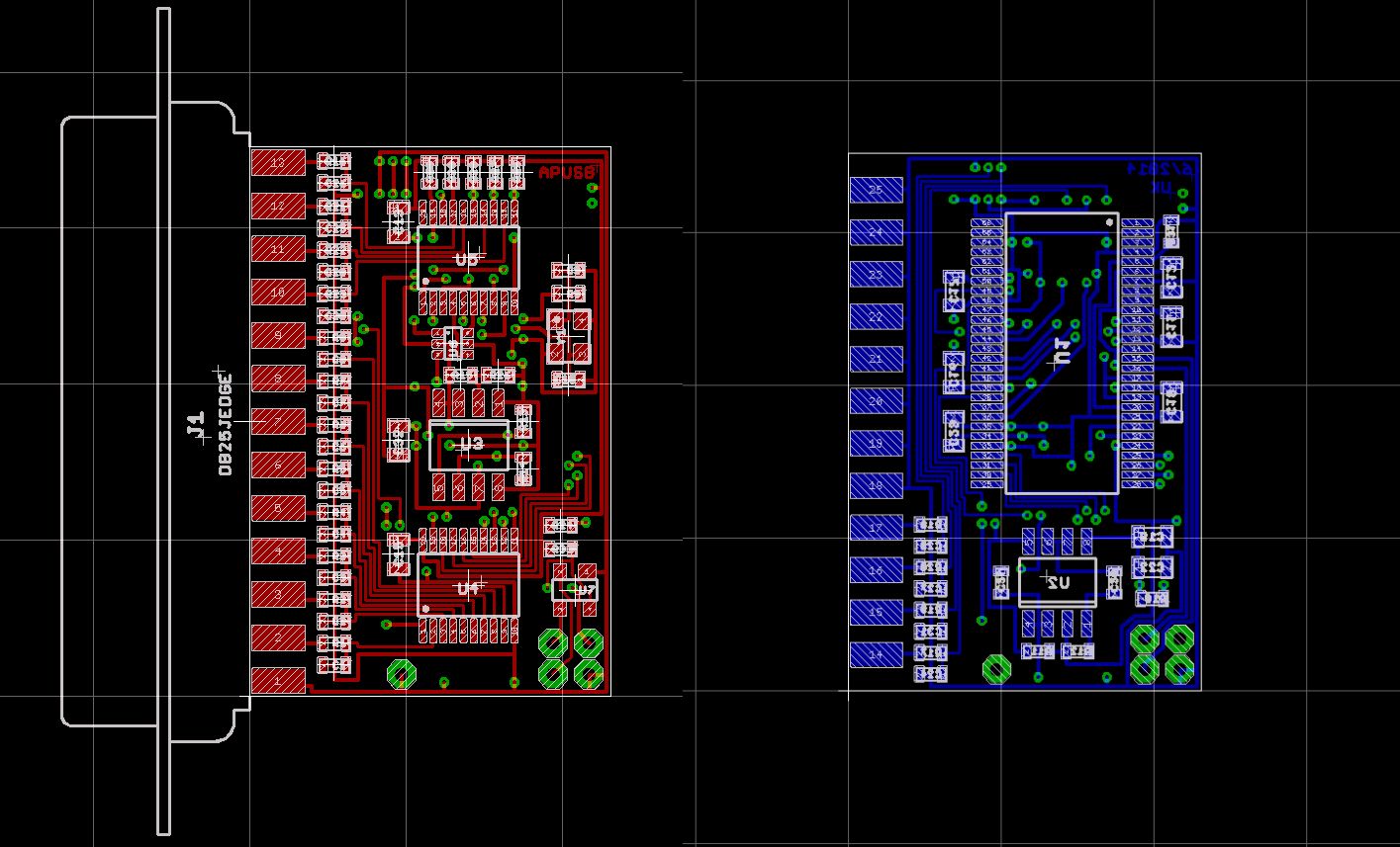

I had a lot of work and the project stalled. But now the first PCB is ready and i can start working on the firmware.
The PCB has two layers and it was rather difficult to put everything in the small housing.
The DB25 connector is solderd on the leftmost edge. Its a Norcomp part.
The resistor and capacitors are 0603 SMD with the exception of the 1uF power supply caps. No elkos or tantals are used.
Caps and resistors are quality parts from Murata and Yageo (former Philips).

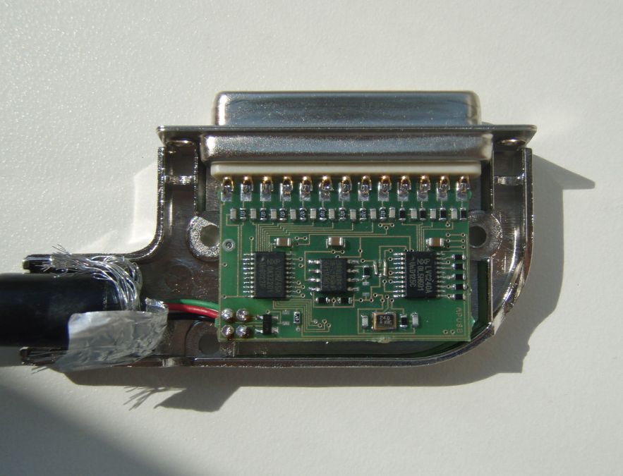

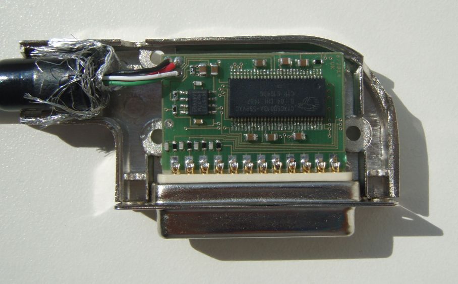

The left side shows the top side with the line drivers and the EEPROM in the middle. The 24 MHz crystal is rightmost.
On the bottom left are the USB cable pads and the USB ESD protection IC (from NXP).
The right side shows the bottom with the FX2LP USB 2.0 interface IC and the voltage regulator at the bottom (LP2951 with Reset output).
Each data outputs has 2n2 to ground and 22 Ohm in series for damping bus reflexions.
Because of availability and size reasons i stay with the LVC parts for now (74LVCH245APW and 74LVC240APW).
Thanks for your interest,
Udo

Yesterday i found time to solder the components on the PCB and to build the hardware together.
At first i thought that the connector may be clumpy but after looking at the result it looks very good.
I attached some pictures.
The best think is: When i connected the cable for the first time to the laptop a windows dialog popped up to install the driver!

Their USB box is not too bad🙂 But having one simple interface cable is somewhat more elegant...
I have taken a closer look to the AP software. From the driver strings i suspect that AP uses the FX2 USB chip too.
Do you have a preference regarding the length of the USB cable? At first i thought that 3m is good, but after having seen 3m i now think that 2m are ok.
It is still possible to extend the cable with an AP interface cable.
Thx - Udo

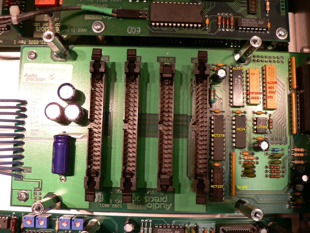

I want to share new information about Sys2.
Evan has done great work in analysing the AP Sys2 bus interface🙂
I think it is ok to share this information here as AP is not
supporting Sys2 any longer.
In Sys2 the bus is not terminated by 2.2 nF as in Sys1.
Instead Sys2 uses basically 50 ohm source termination.
The Sys2 termination is better with longer bus cables.
The data rate can be higher too.
The logic type has changed to 5 Volt 74ACT245 for the data and
74HCT125 for the status lines.
With the help of discrete resistors the data receivers have some hysteresis added.
The strobe lines EA, EW, ER go to 74HC14 schnitt triggers.
Not 74HCT version - so the use of 3.3 Volt LVC Logic may not be a safe bet in Sys2.
A forum member (Altor?) suggested 74 LV logic, which is a modern well tempered 5 Volt logic.
At first i thought that the 8mA drive capability is too low, but the bus drivers come with 16mA.
74LV logic is indeed a good choice as the AP bus is not high speed.

I think 2m should be fine if the PC and HW are near each other. -RNM

KSTR: Thanks for your offer to test the thing.
RNMarsh: 2m is now the standard cable length.
